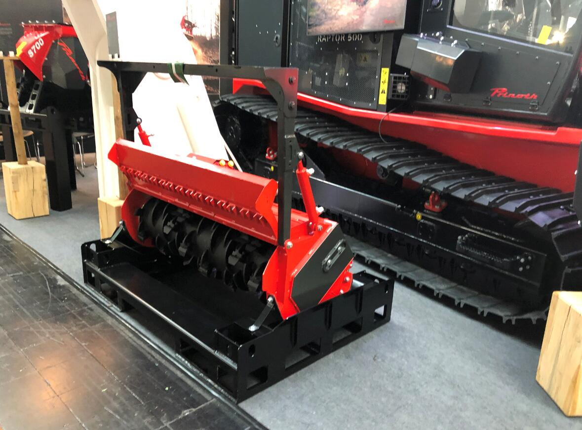

Hi,
I m curious how much the price will change your mind from "rent" into "buy" ?

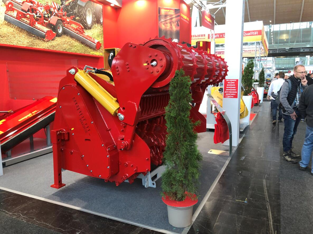

These forest mulcher is much more bigger than we thought, I can feel how big they are when I stand next to them. It's expensive to rent them, $1800 or $3000 per day, and the contractor cann't promise you how much job will be done every day, sounds tricky. But it's even more expensive to buy one, $22K is big money.

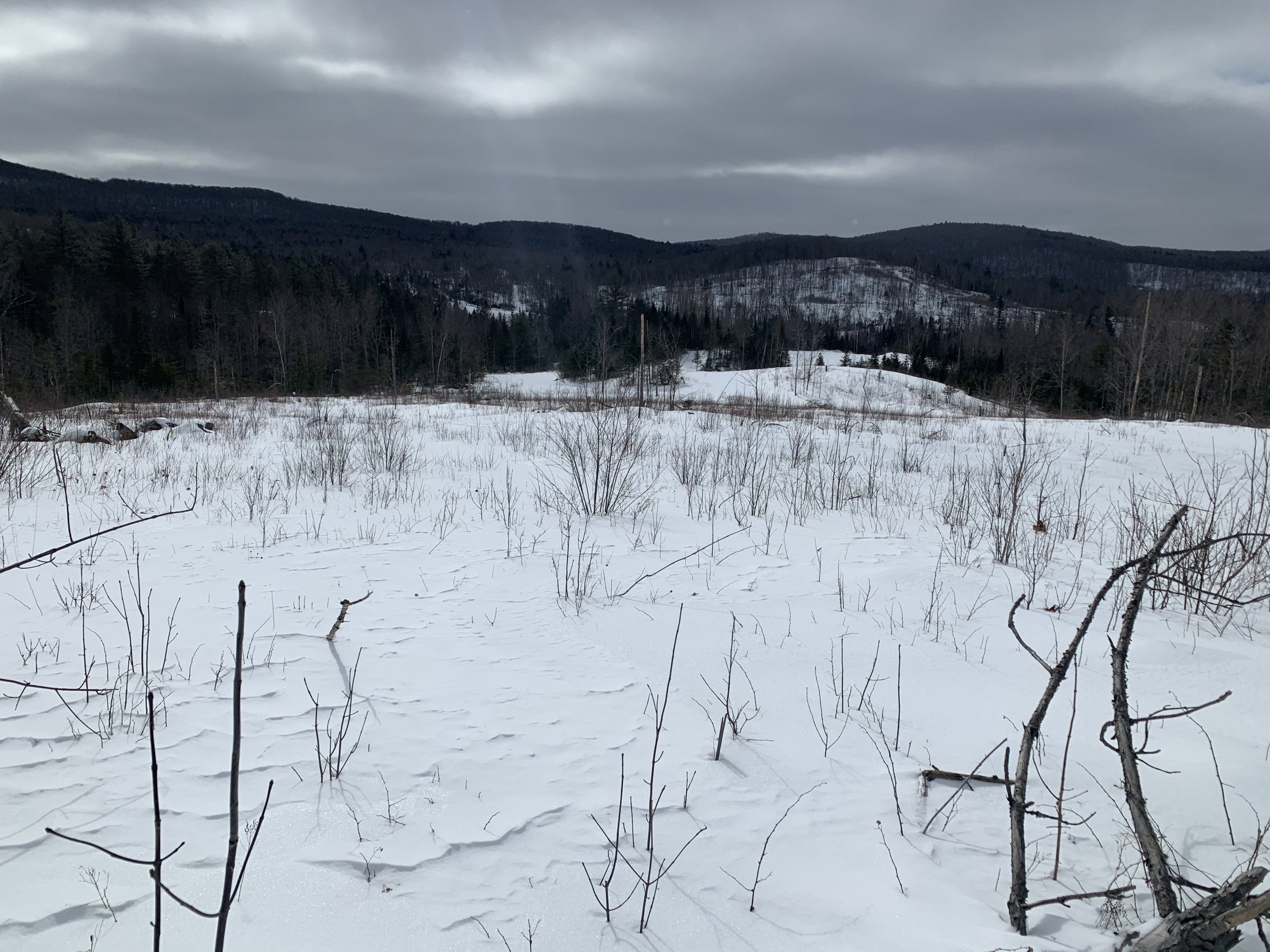

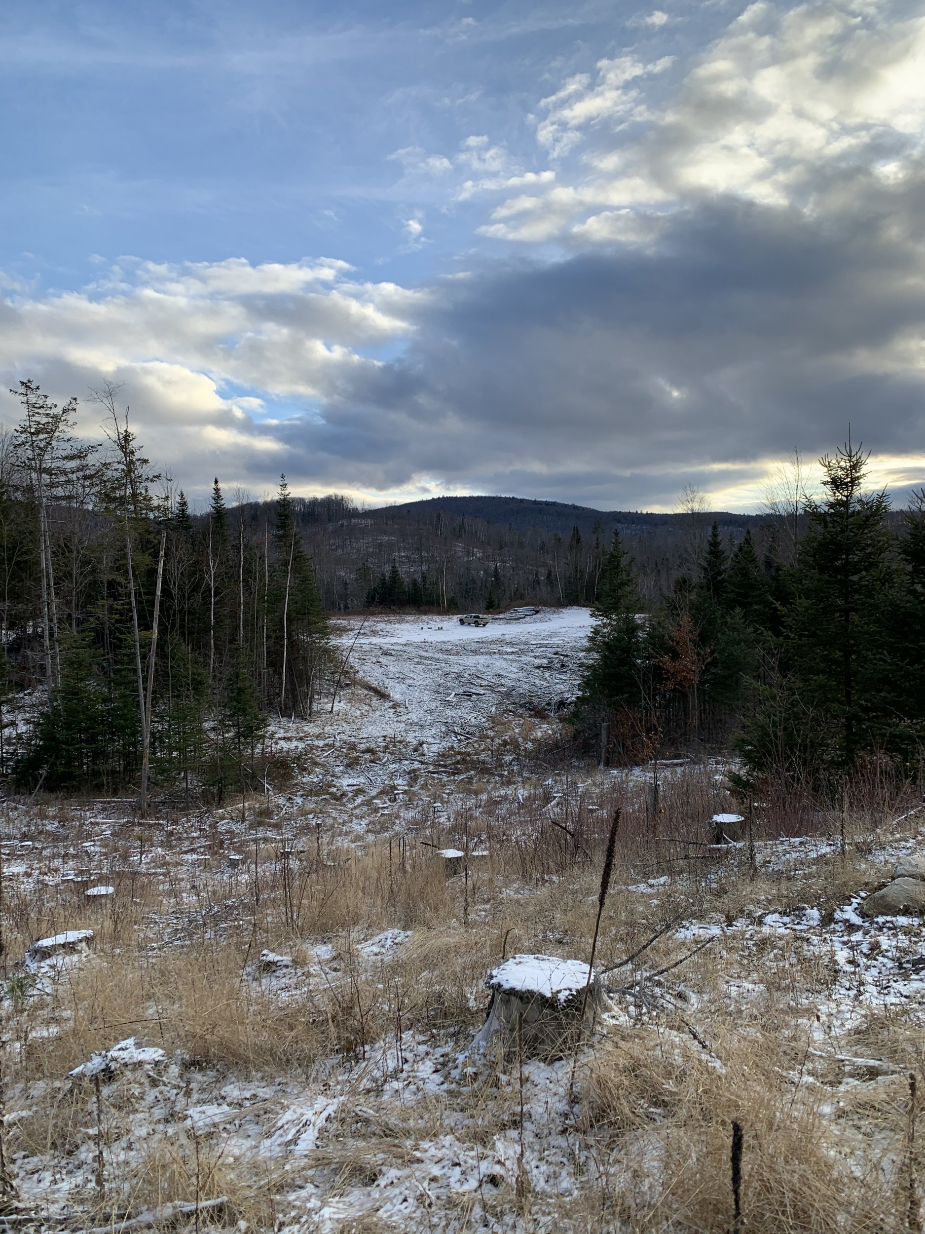

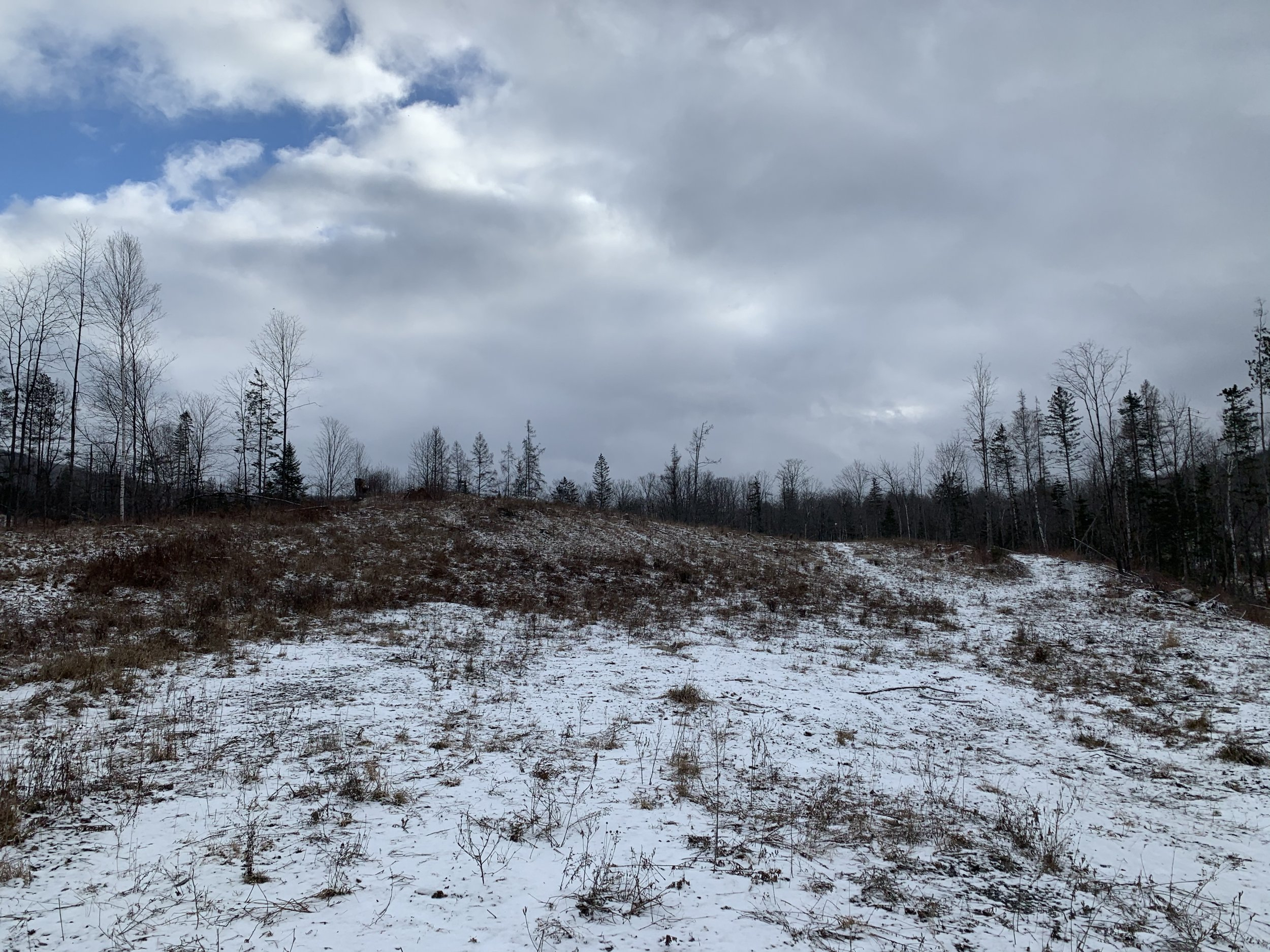

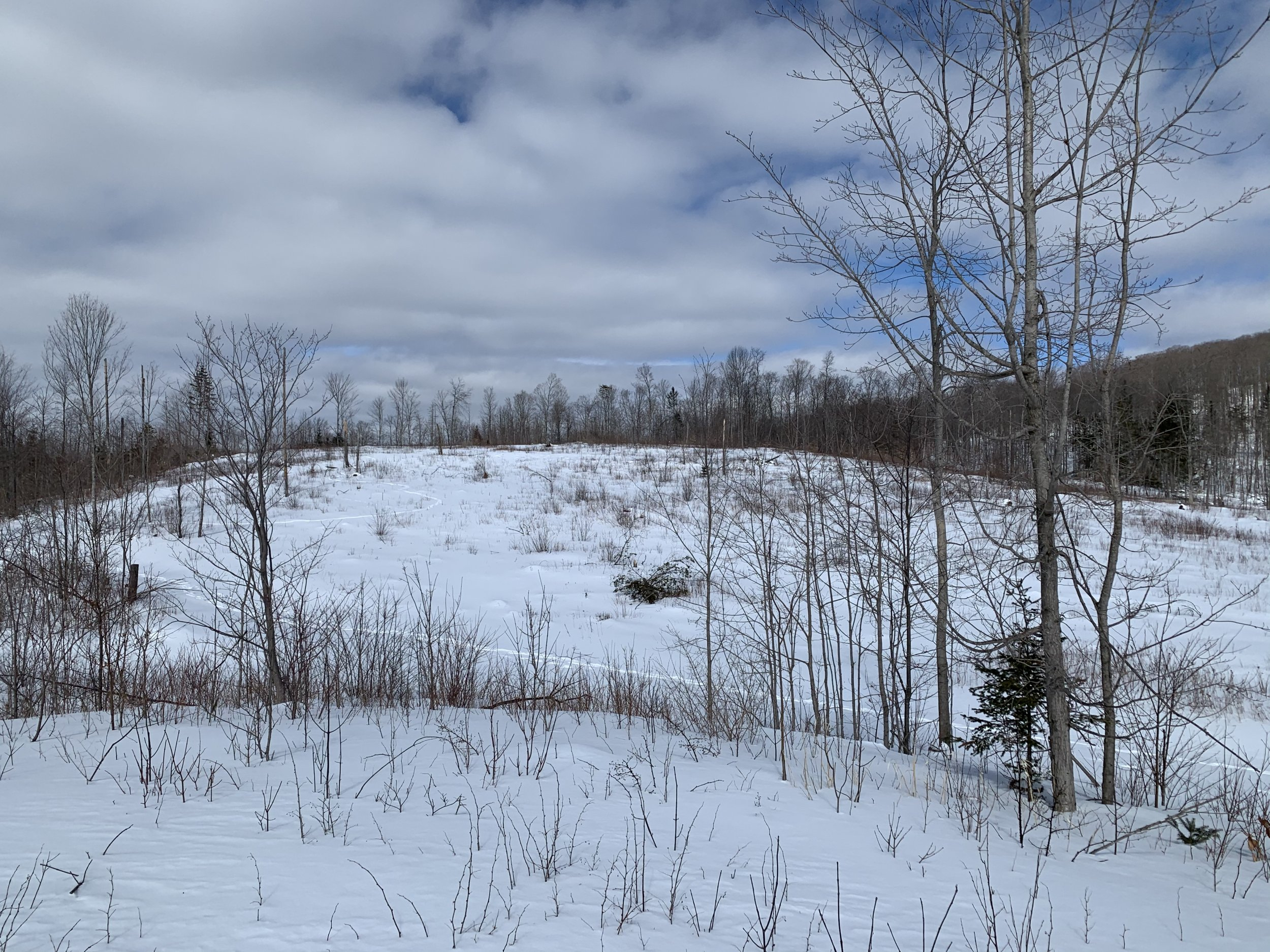

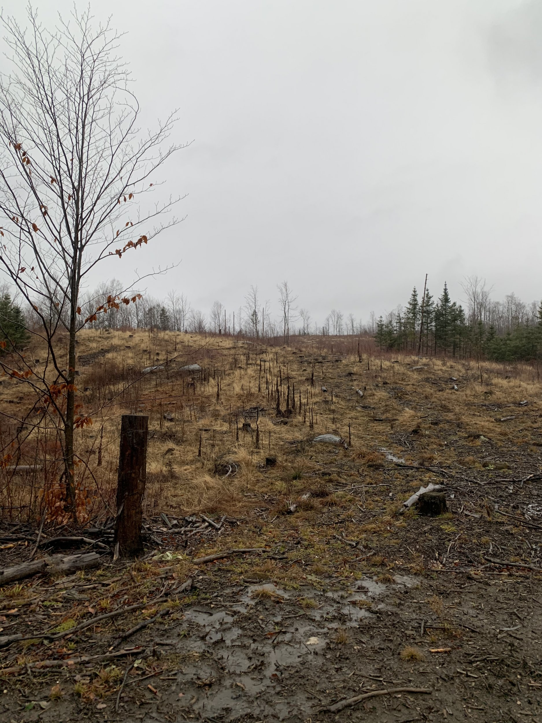

Thanks for the reply. I meant to add some pics (they were on my phone). The pics below show the maine clear cut (about 12 acres) that was a red pine plantation. It was cut around 2017; the stumps aren’t starting to rot yet, but they seam a big looser, drier and more forgiving than if they were 1 year old or less. There are a couple other clear cuts (native red spruce/balsam fir, rather than plantation pine) that Im also thinking of slowly improving and keeping open (say another 15-20 acres in total over the next 5-7 years). The hardwoods (sugar maple dominated, ~120 acres) weren’t logged as heavily and I want to manage that part of the wood lot for sugaring.
There’s still about 2’ of snow in the field (finally starting to melt, as it’s south-facing) but I did get a few pics in December before I bought the property.
My understanding is the logger took a huge feller-bunch and then sent the trees through a delimber, and chipped the slash which he either left at the log landing or sold to the local biomass plant. So there’s little mess in the way of slash—nothing that can’t be taken care of over a long weekend with my root grapple. What’s left (besides the stumps) is mostly deadwood. Here in Vermont brambles and hardwood saplings sprout like spring wheat, so the recent undergrowth itself is much of the clean up job (and likely necessitates mulching). The stumps will be the main headache.

OK - those pictures help a whole lot. If you plan on keeping the areas open & clear that are shown in the picture then use these implements. A good heavy duty PTO driven rotary cutter and a PTO stump grinder. Both will work easily behind your new Kubota. Plan on clearing areas that are now forested - add a chain saw and PTO driven chipper. Sure - it's not as fast as a hydromulcher but not anywhere near as expensive either.
BTW - very nice looking acreage.
