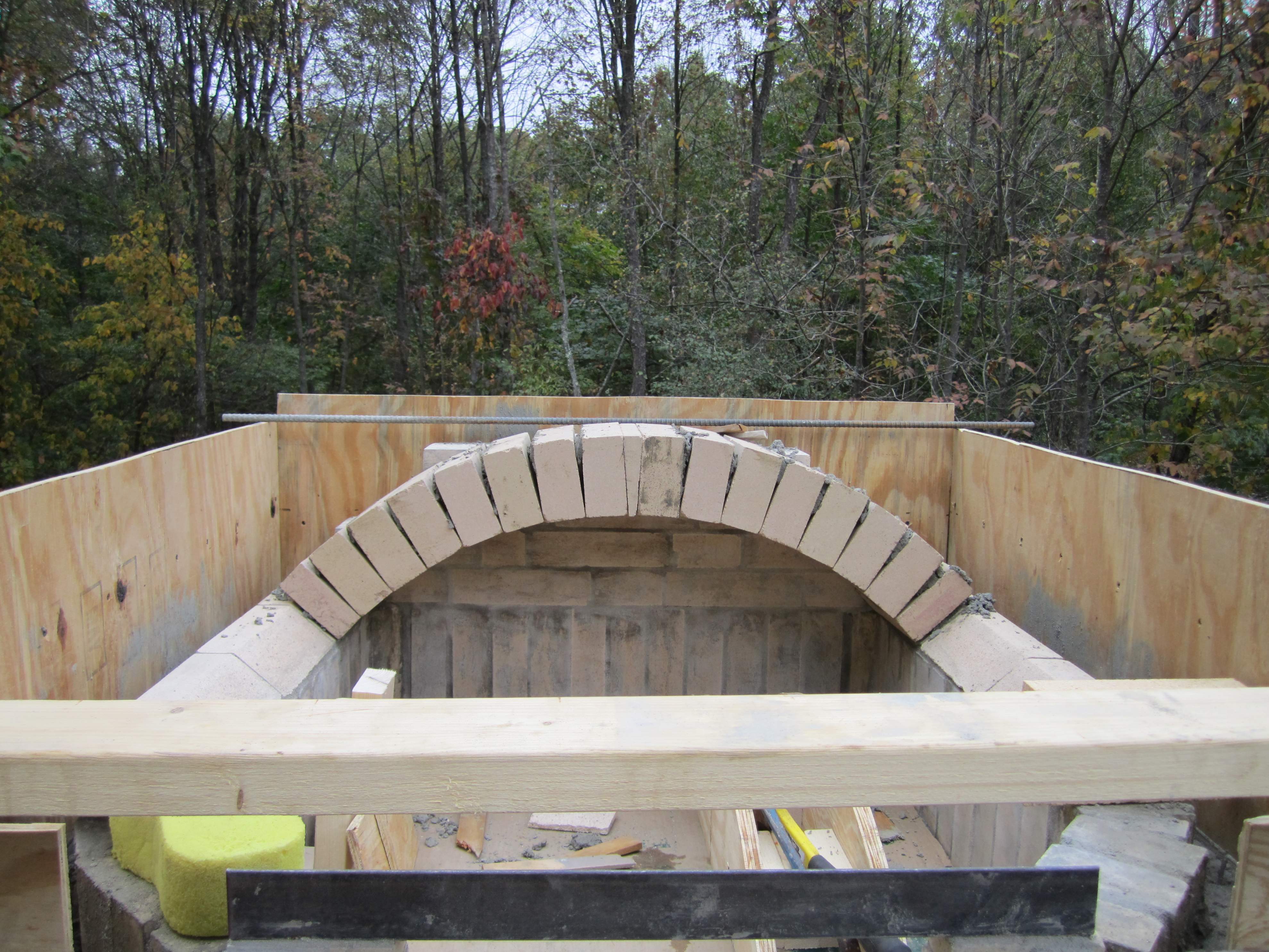

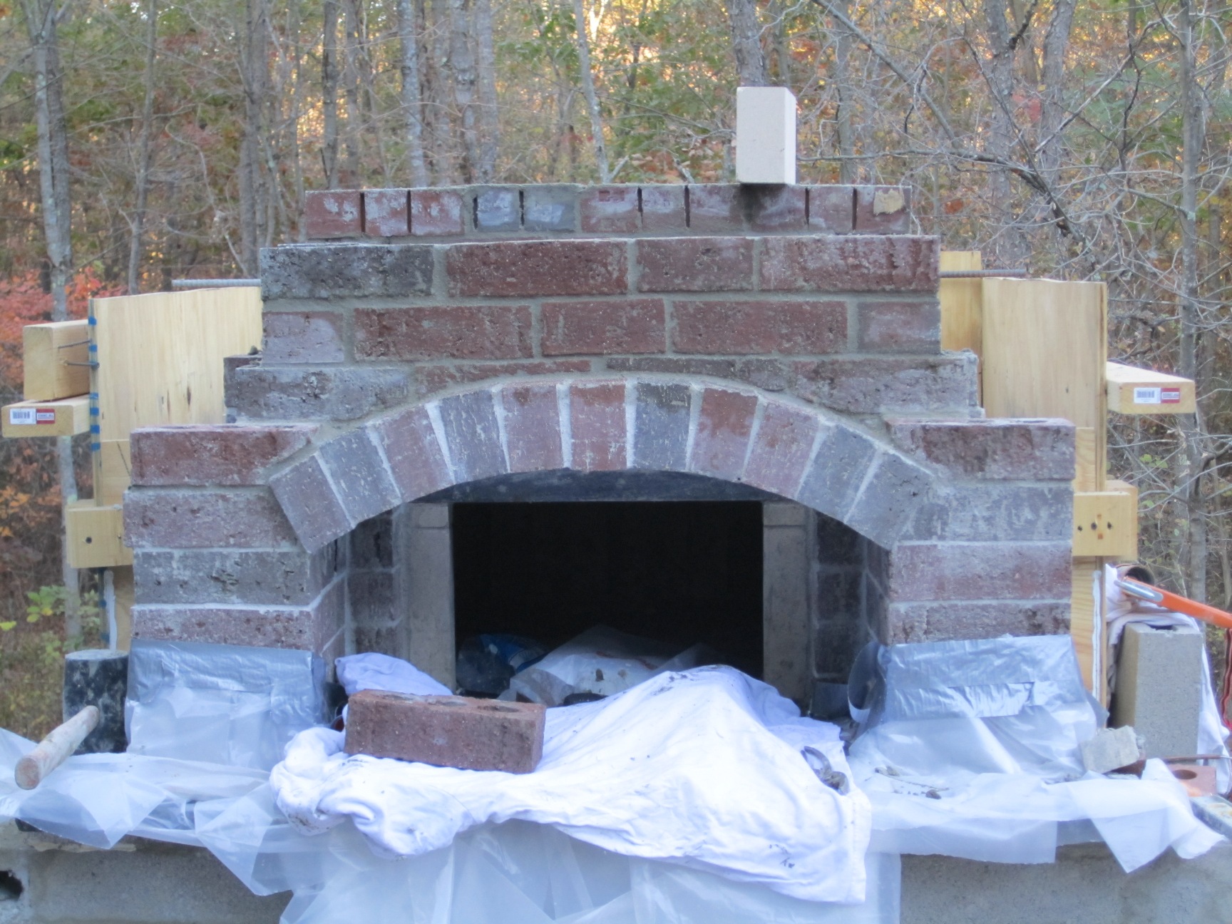

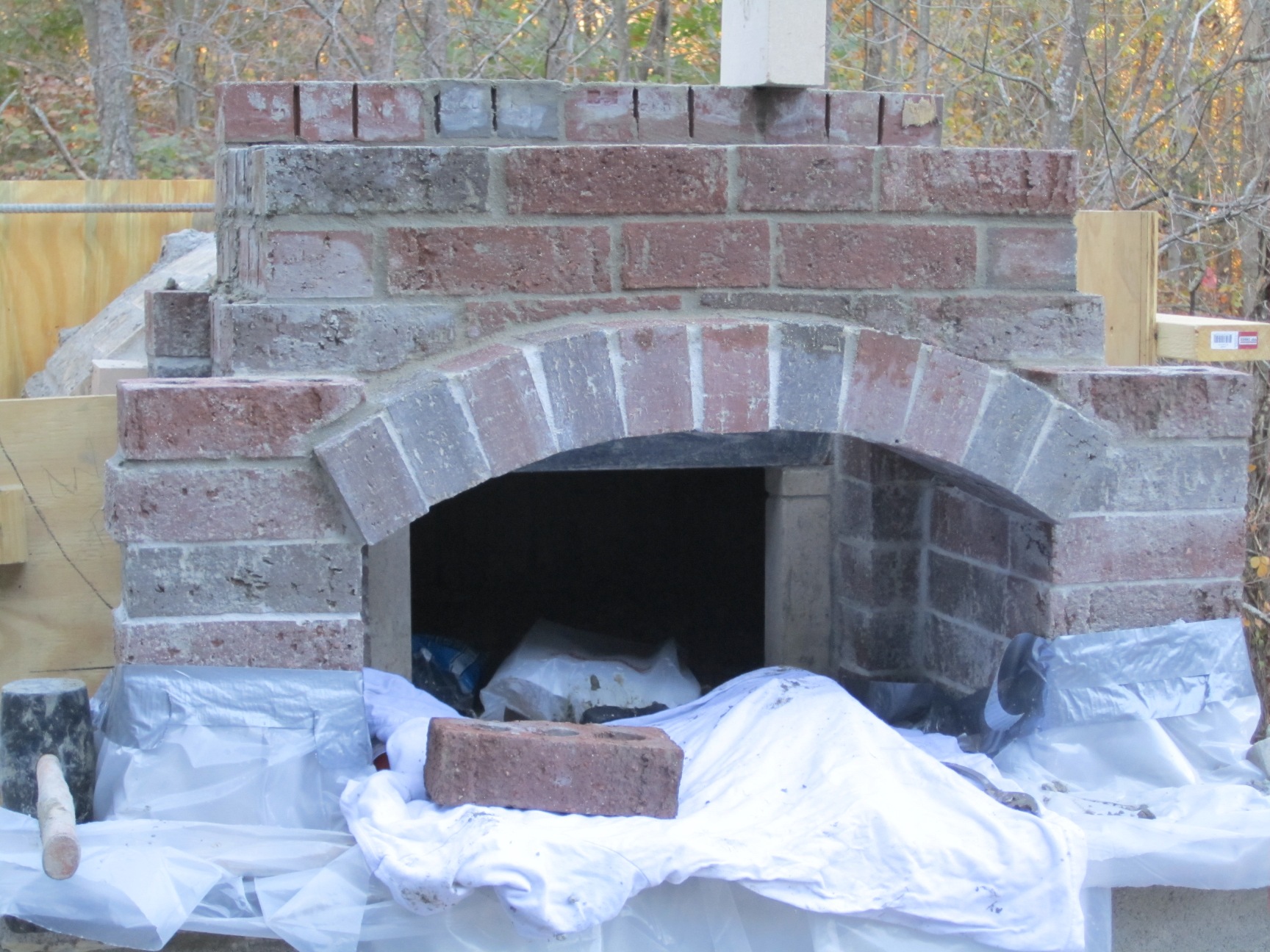

Now that the entry way was in place I could continue with the construction of the chimney and outer arch. This photo shows the outer arch completed. I used the same radius as the inner arches, but this arch is a little shorter. The chimney space will be between this outer arch and the doorway.

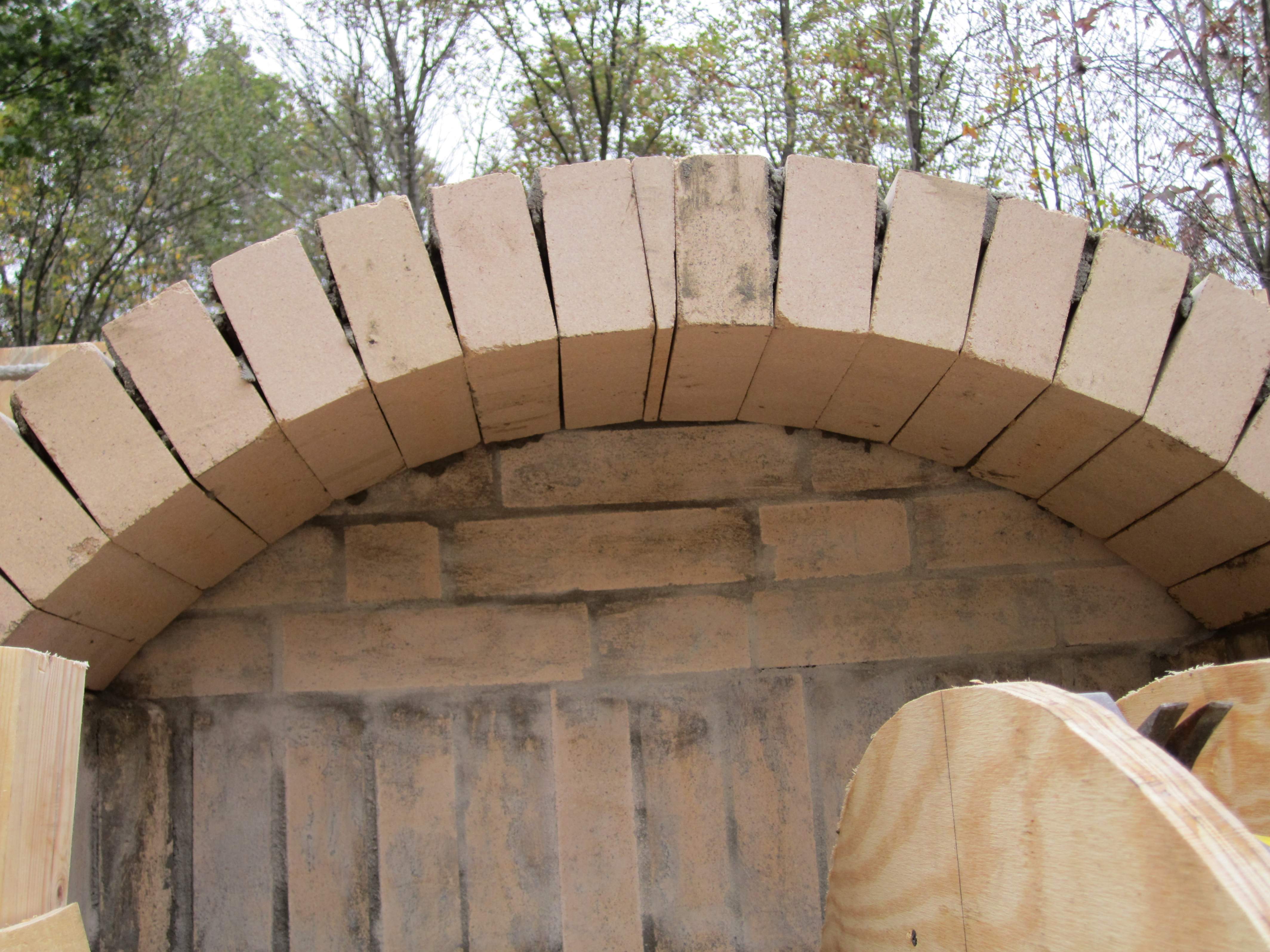

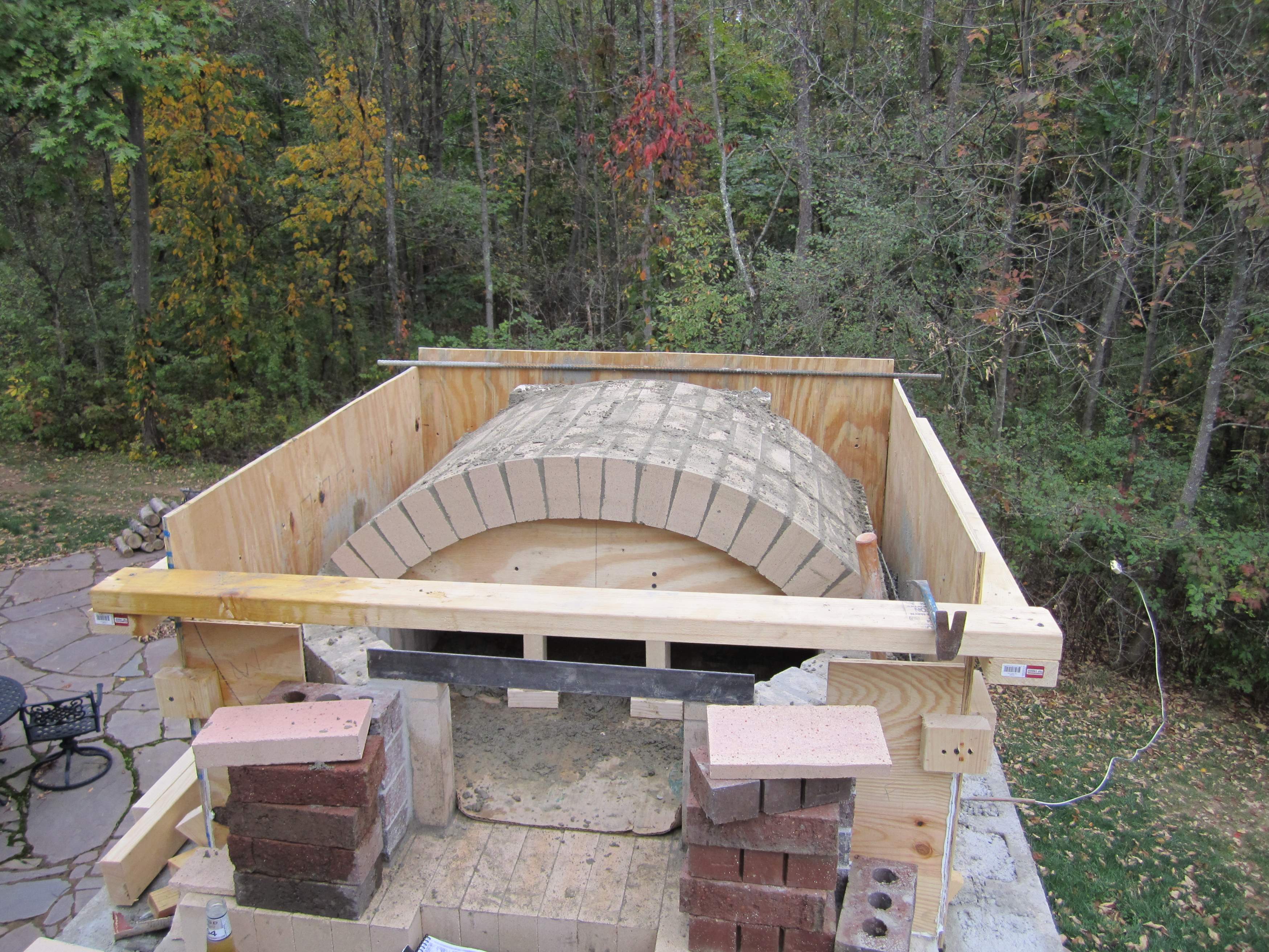

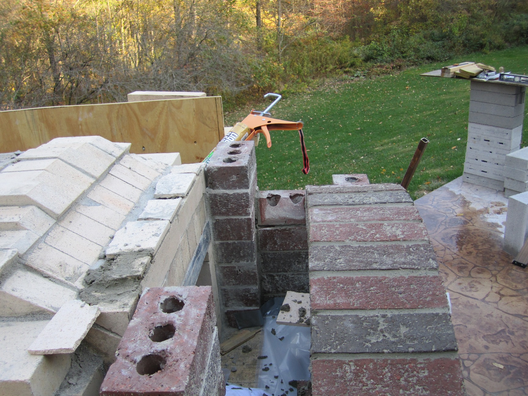

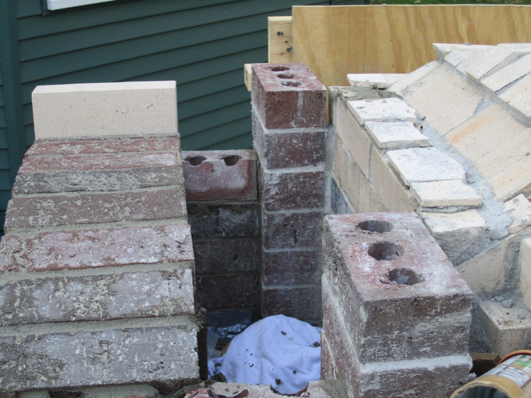

In the following photos you can see better detail of the chimney and the brickwork that leads to the outer arch. It's starting to look like an oven now.

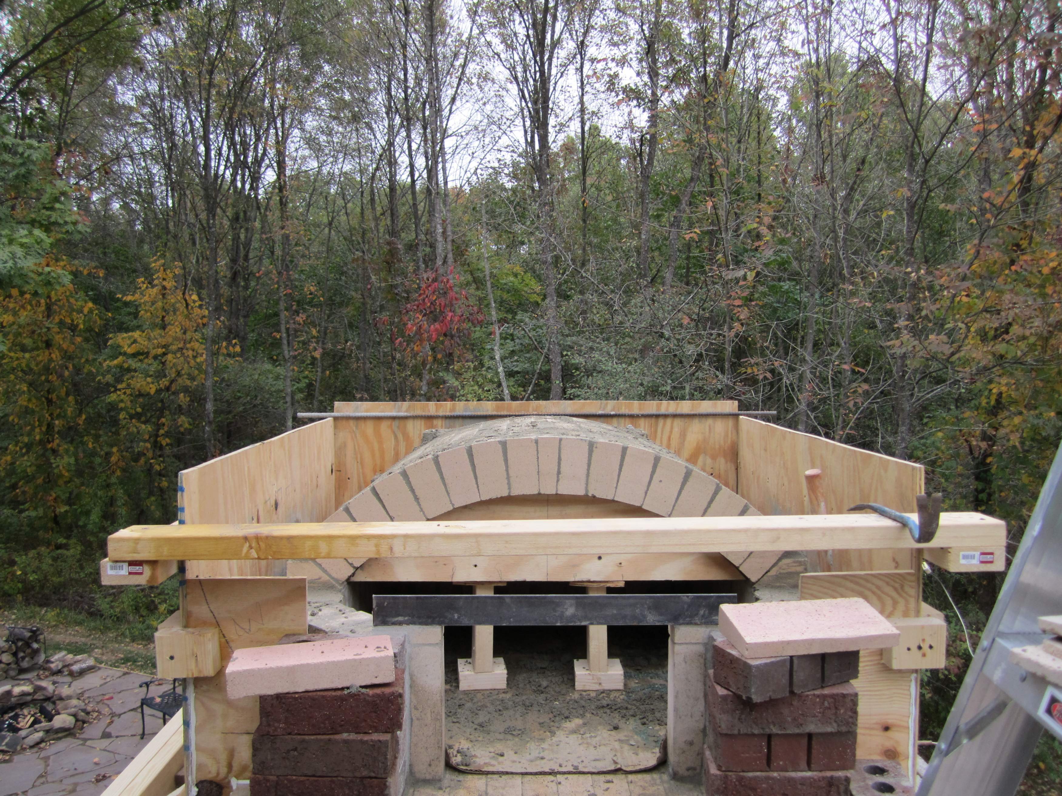

Well, I'm sitting around eating trail bologna and cheese, waiting on the Super Bowl. So I might as well post a couple of pics while I'm doing nothing.
These next few are of more progress on the chimney including the support for the flue tile.

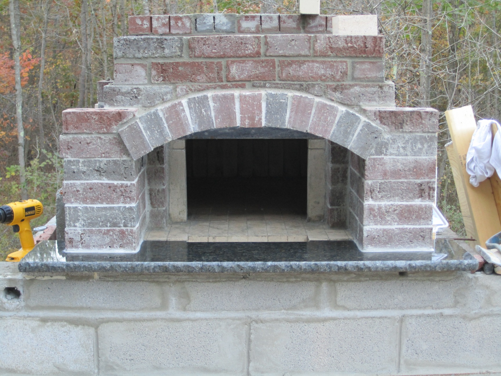

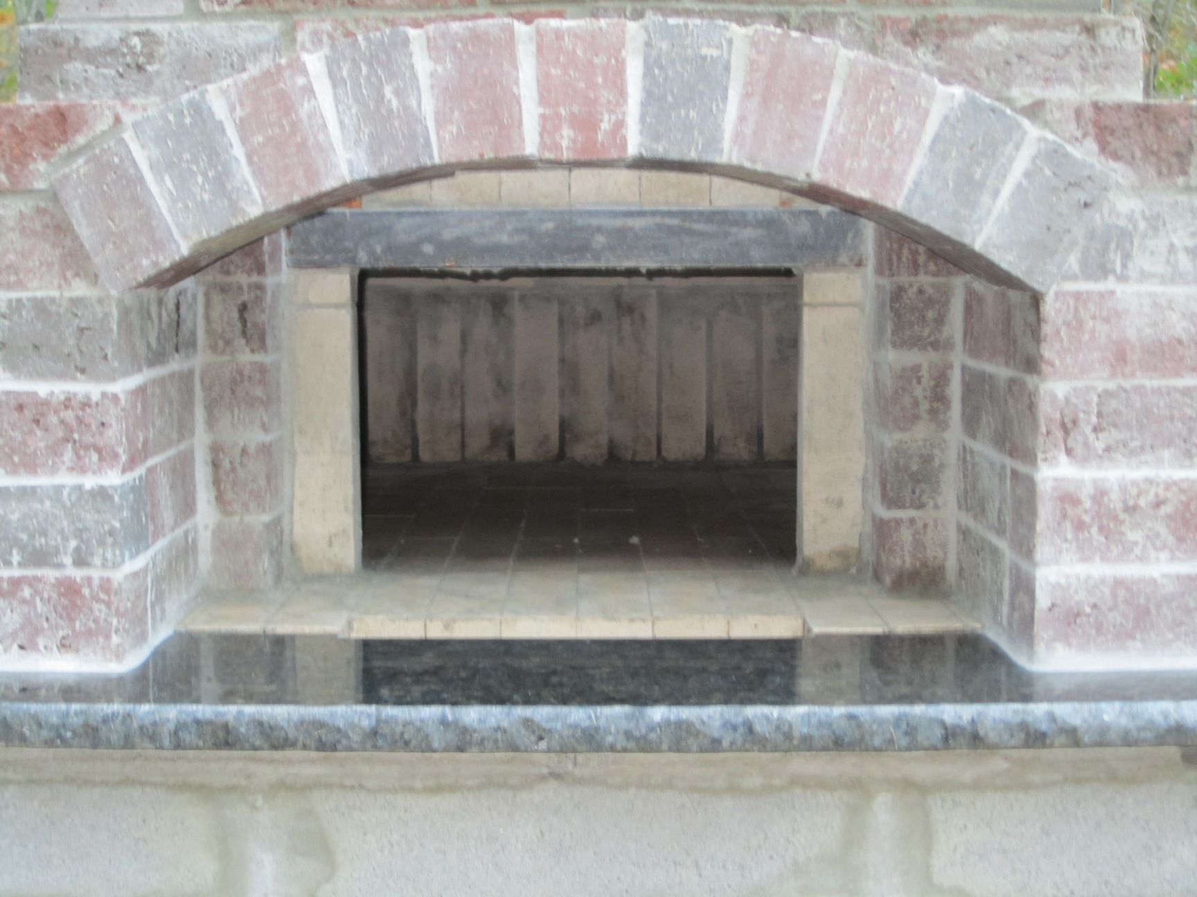

A couple with the plastic removed and things cleaned up. Really coming together now, but the heavy work is yet to be done.

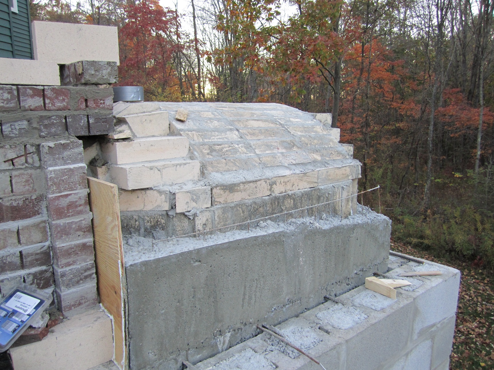

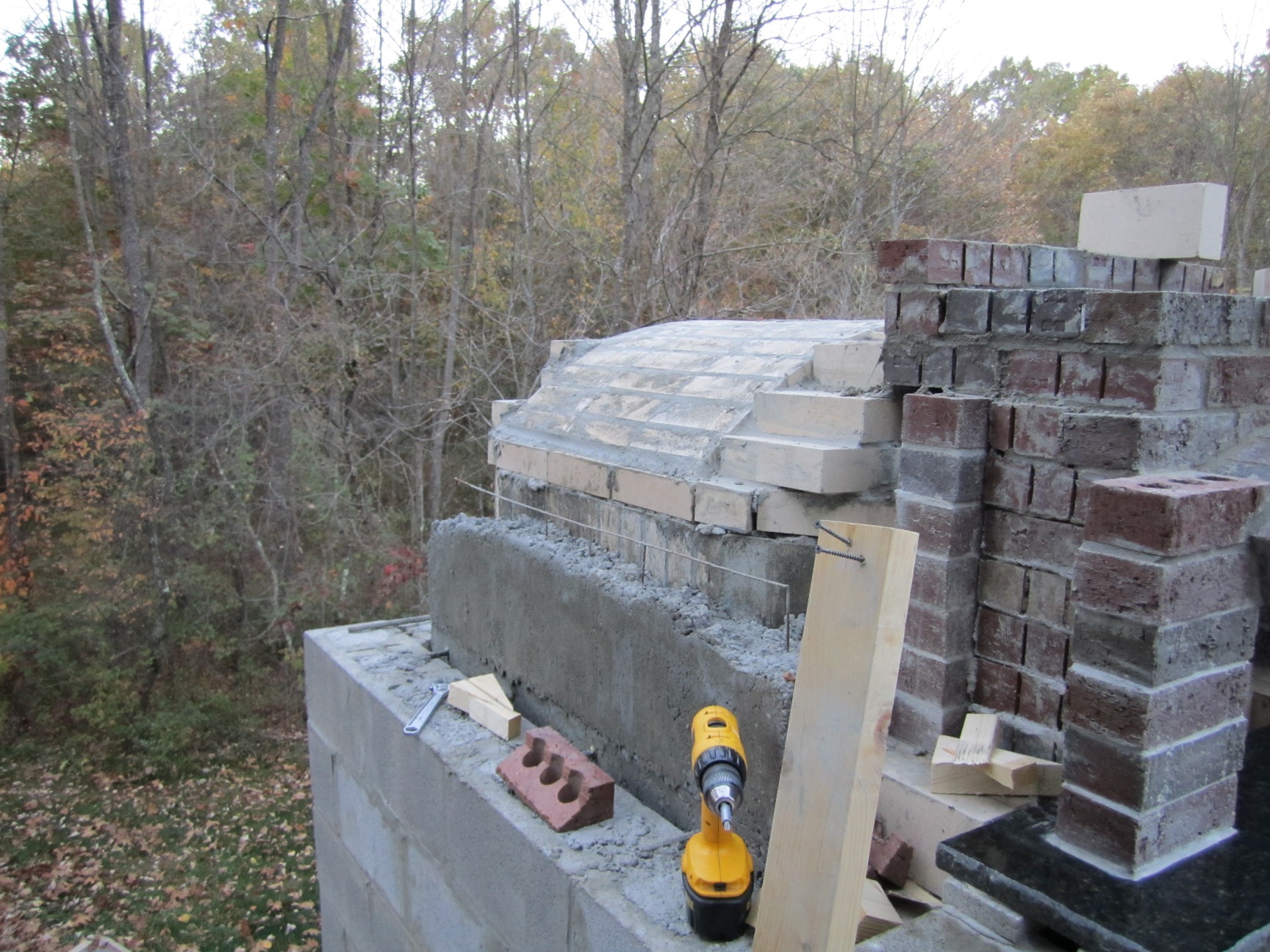

Now things get a bit more interesting. I removed the forms to clean up around where I had poured the first part of the oven's cladding. This oven works by heating the mass and then allowing the mass to radiate the heat back into the oven chamber. More mass = longer available cooking times (as long as things are insulated well). This cleaning is in preparation for the rest of the cladding.
In these photos you can see how the oven is supported on the blocks with the rebar.

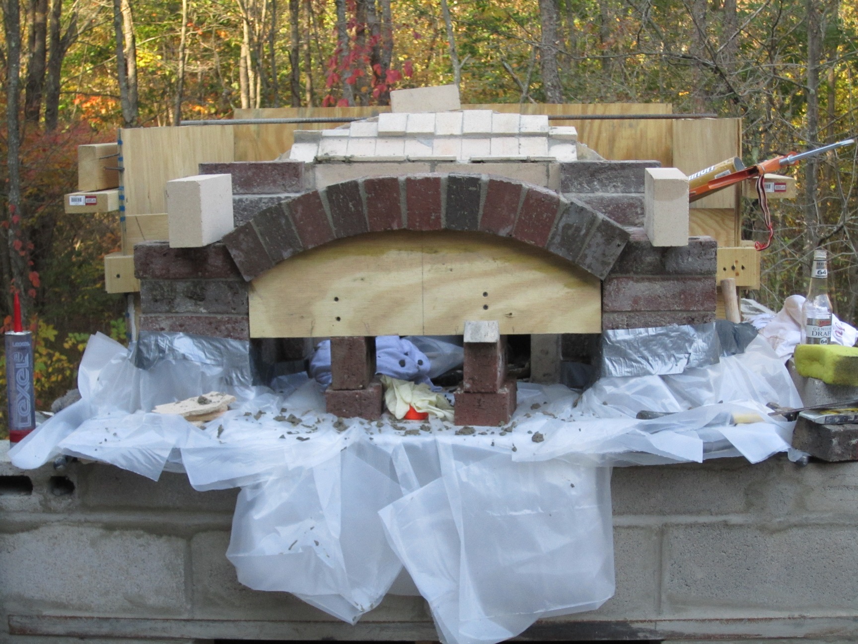

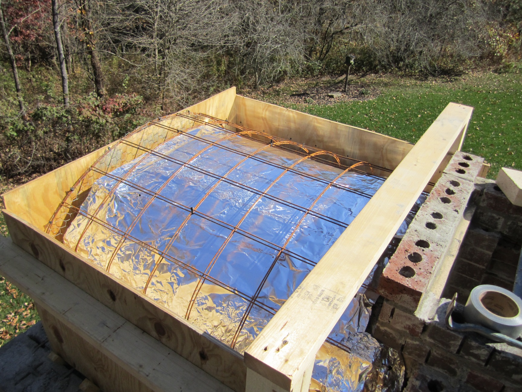

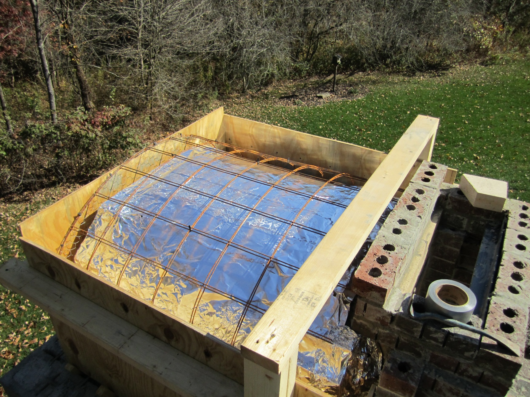

These next two photos show the forms back in place and ready to pour the rest of the cladding. The tinfoil is there to provide a slip barrier for the 3" to 4" of cladding I am about to put on top of this baby. Without the foil there would be considerably more cracking when the oven was heated up. Wire mesh is in the concrete for support.

Great job. I have really enjoyed following the progress of this project. One thing I am curious about is all that weight being supported by the rebar. Is that the only support for the oven? Looking forward to the final product.

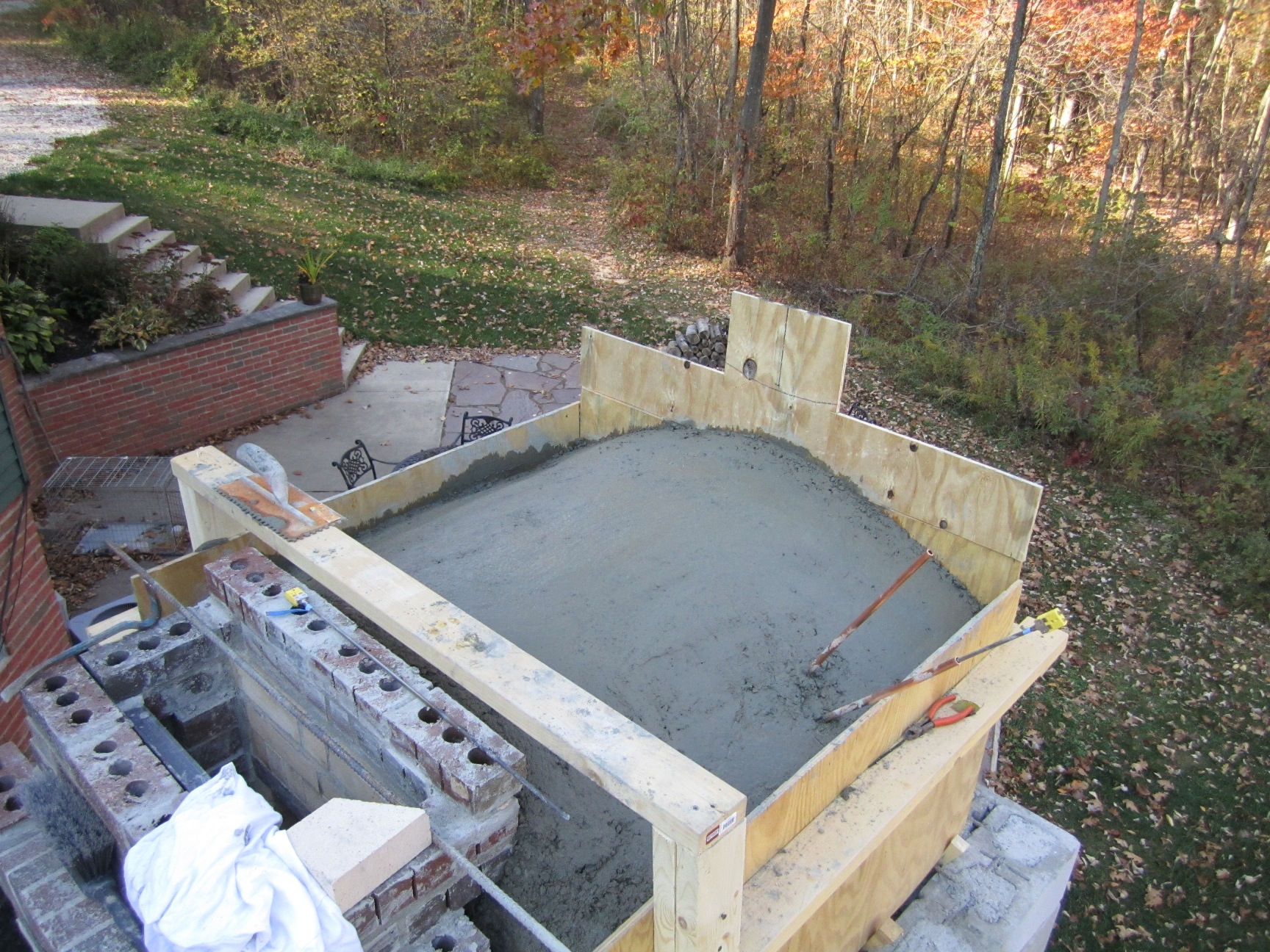

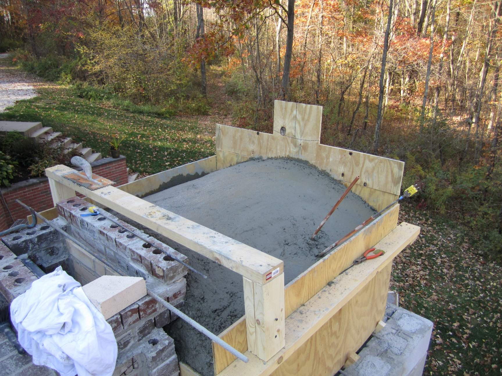

#99
They say the rebar is all you need, but I left supports under the oven as insurance.
