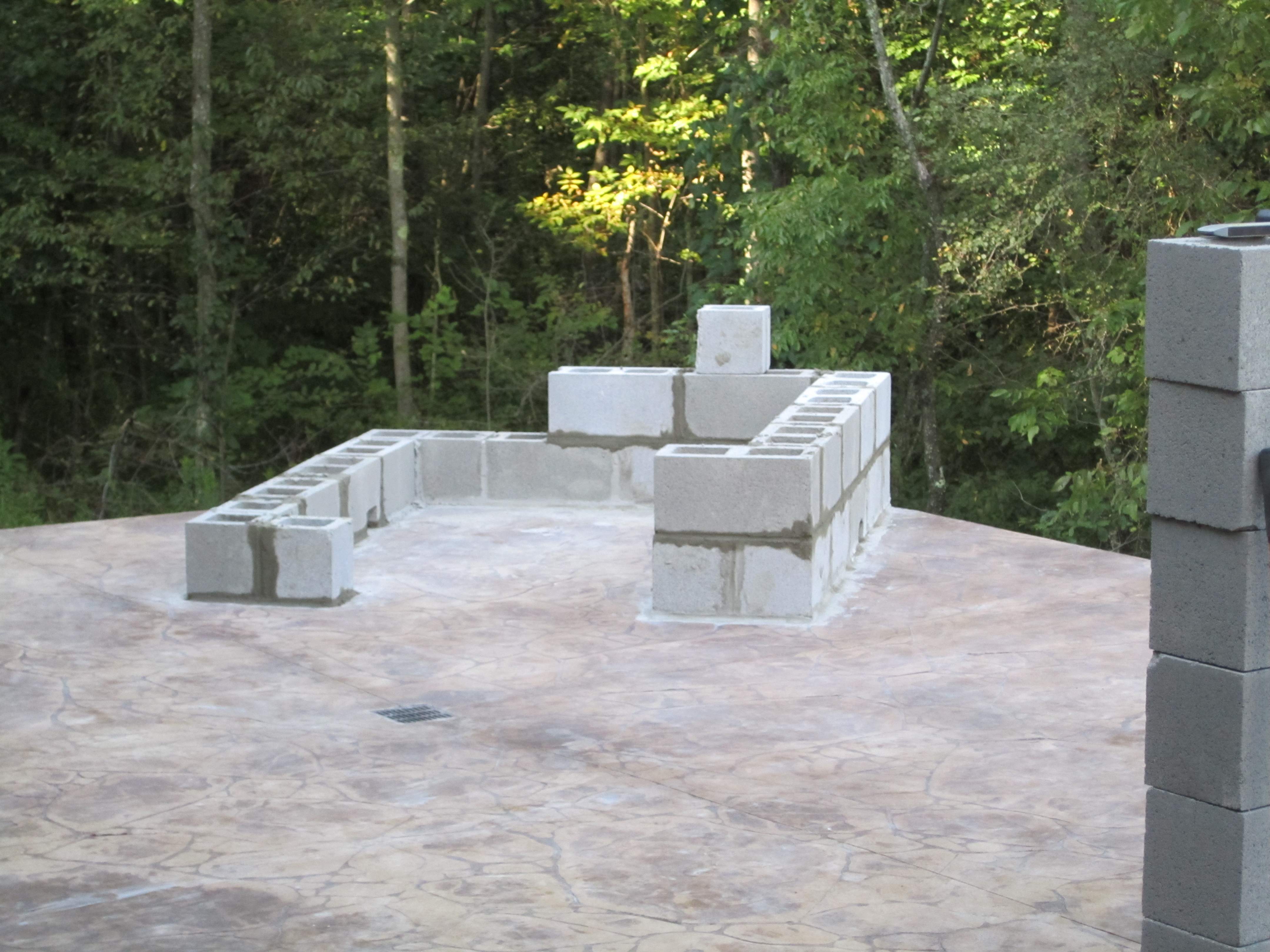

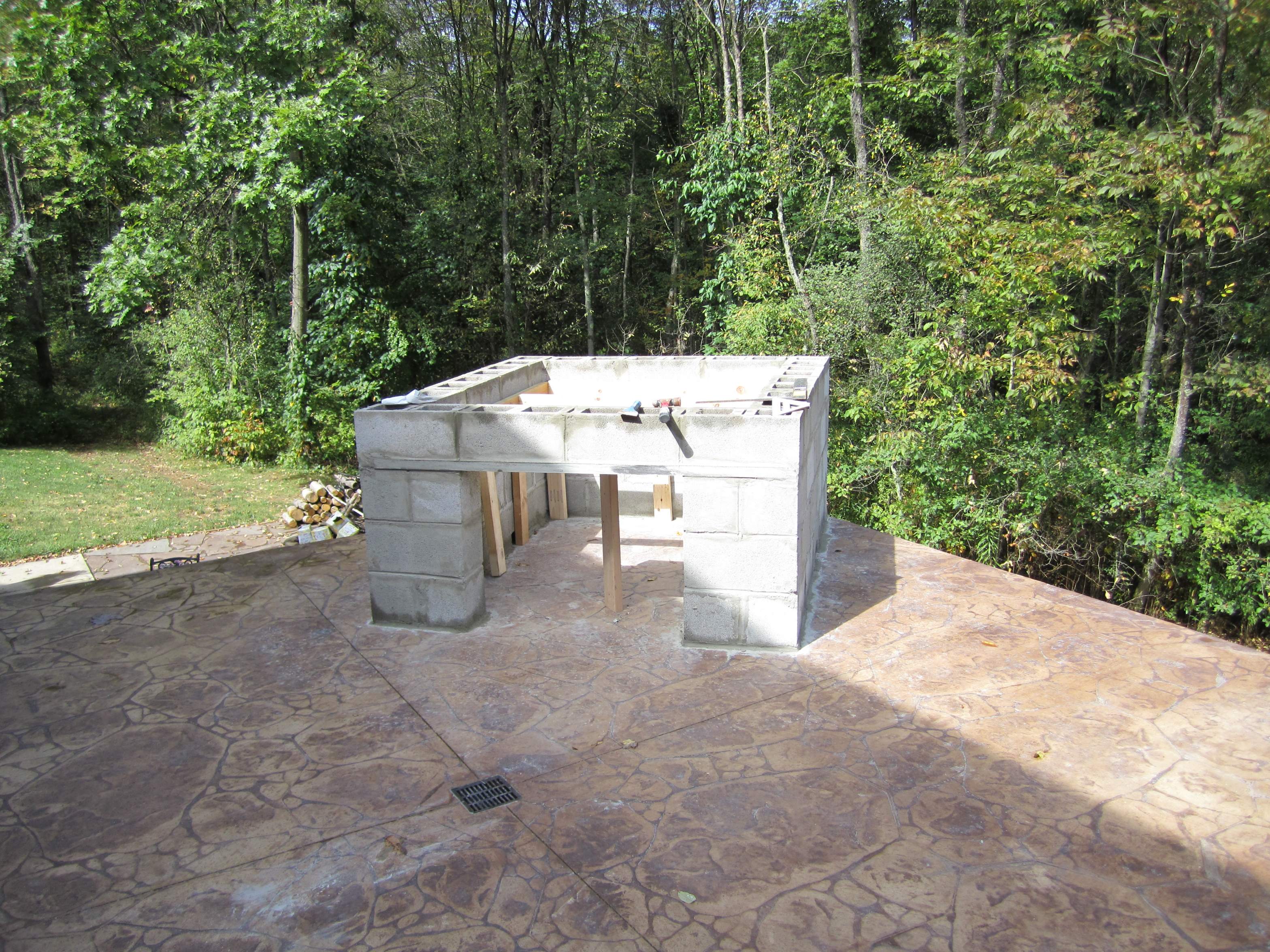

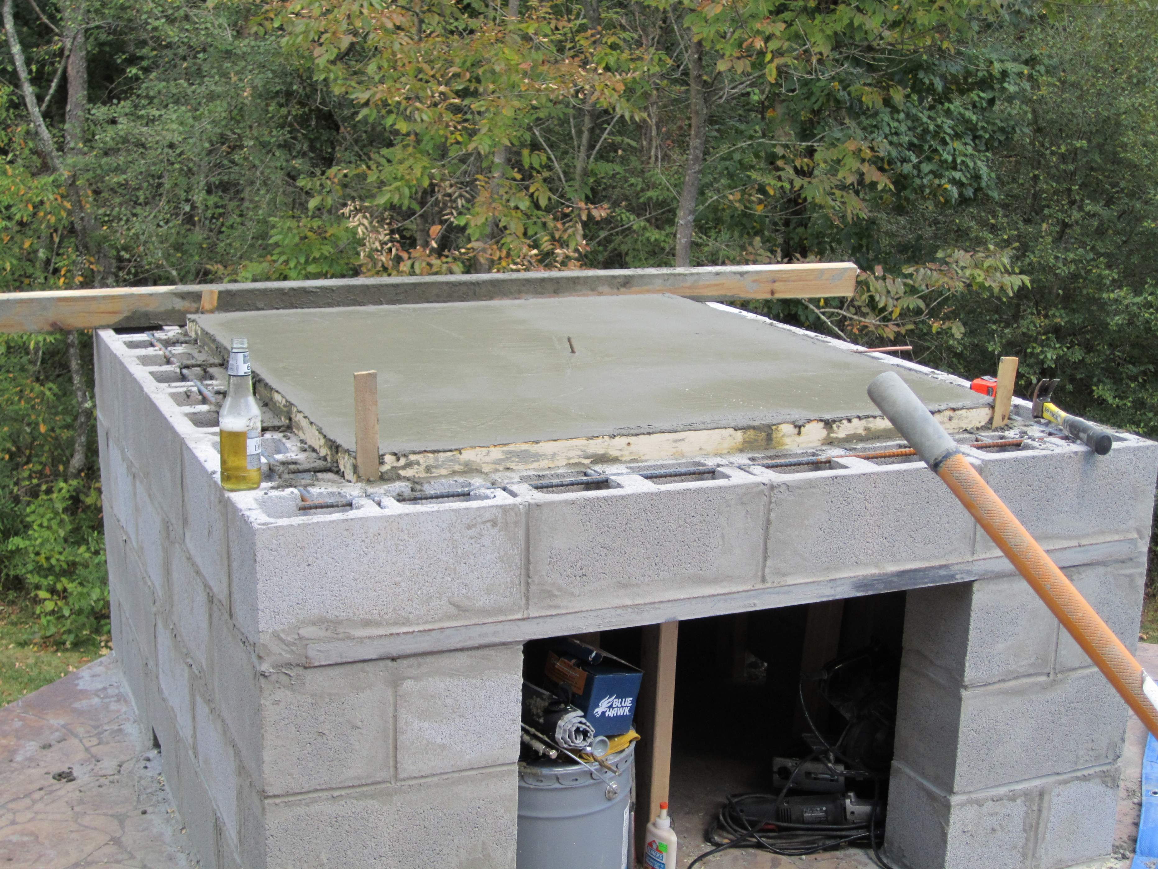

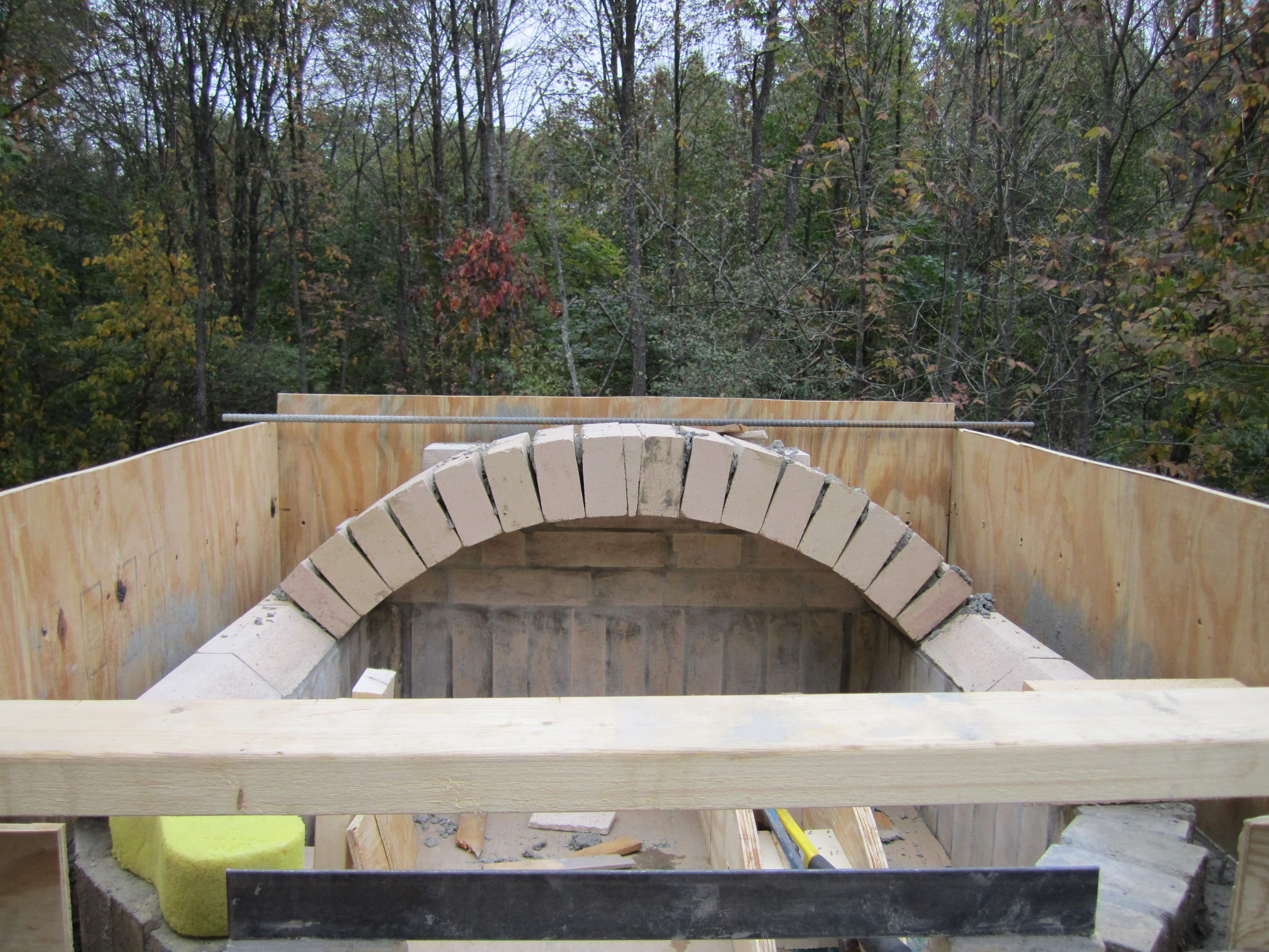

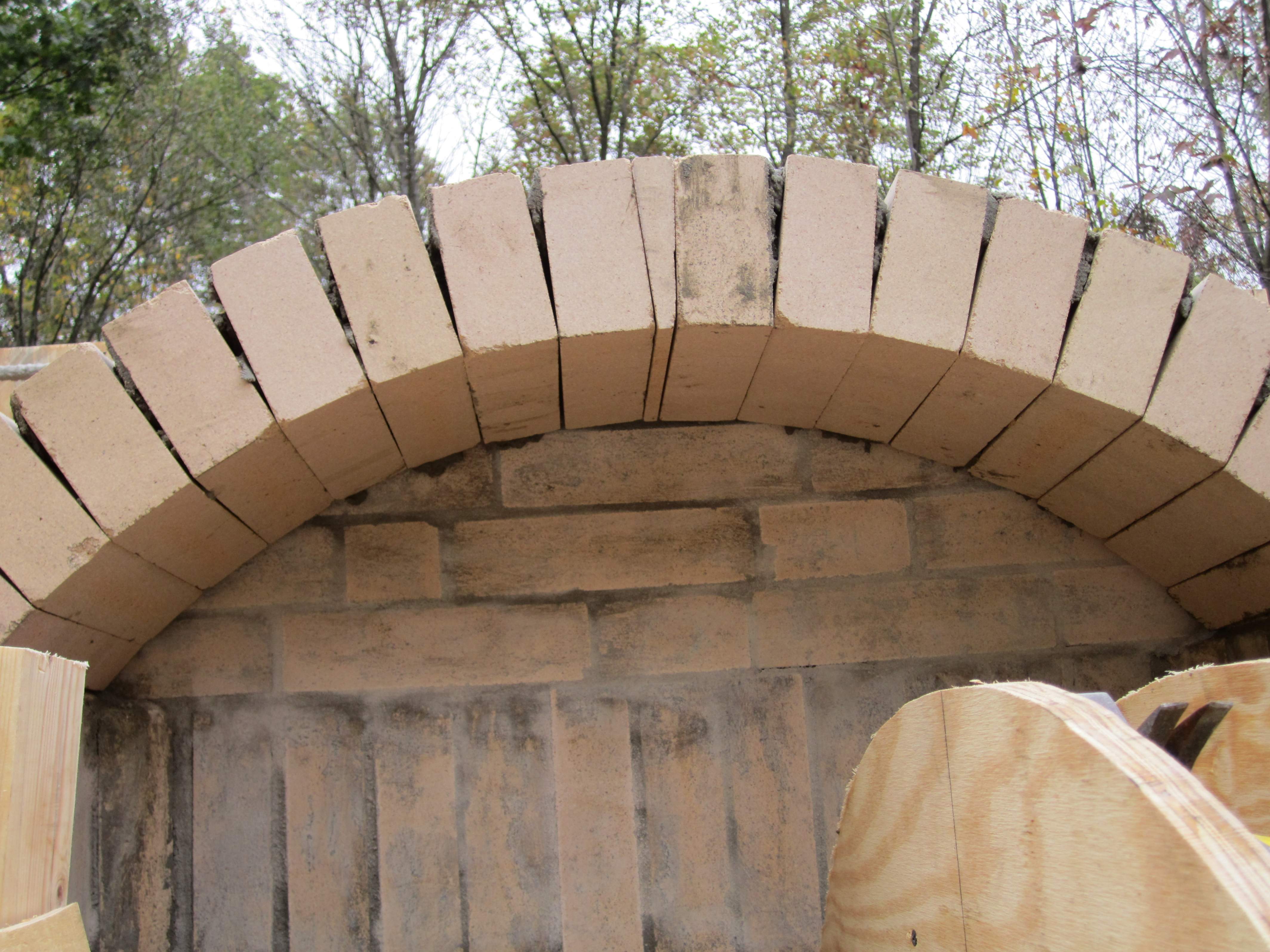

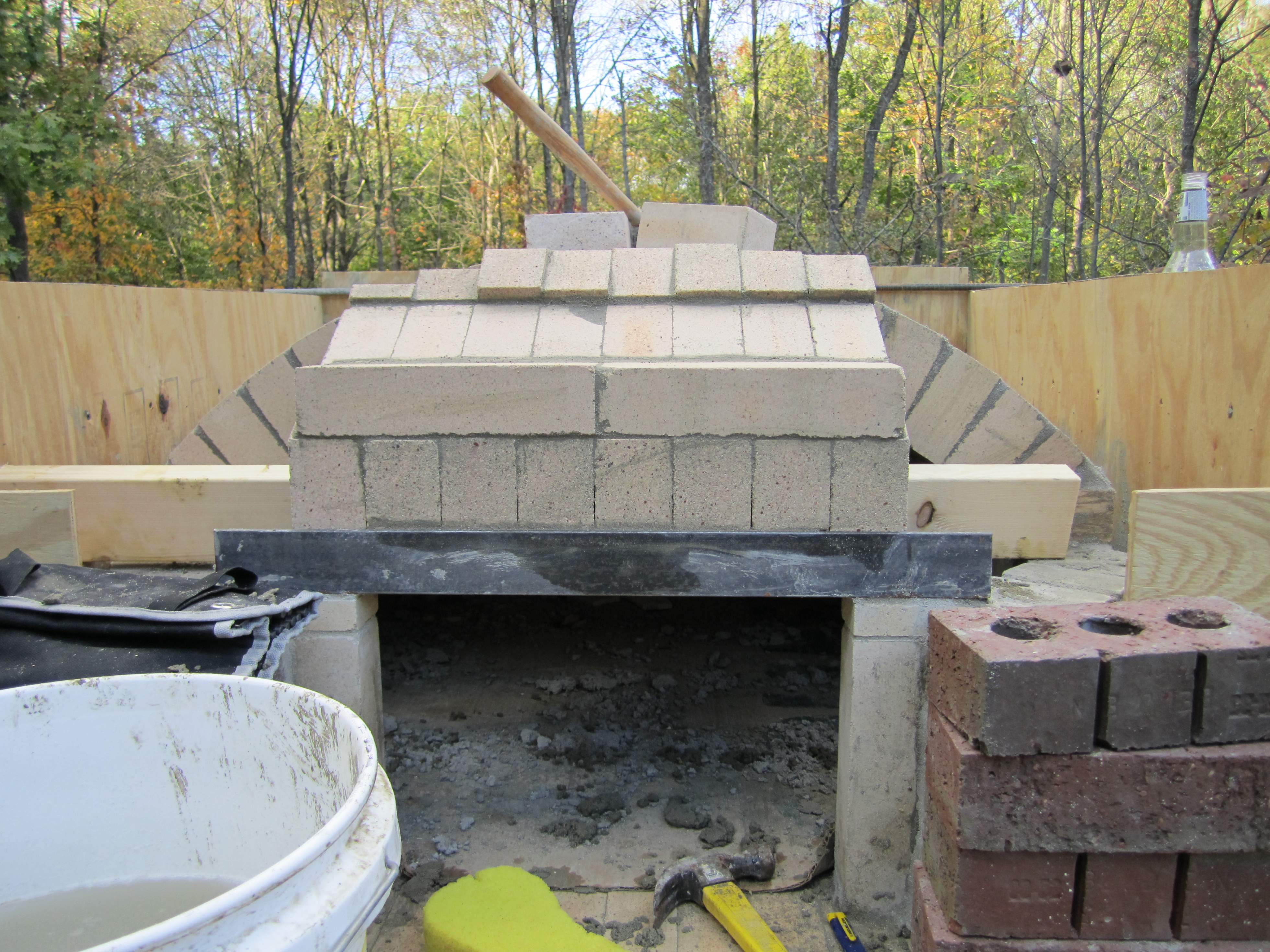

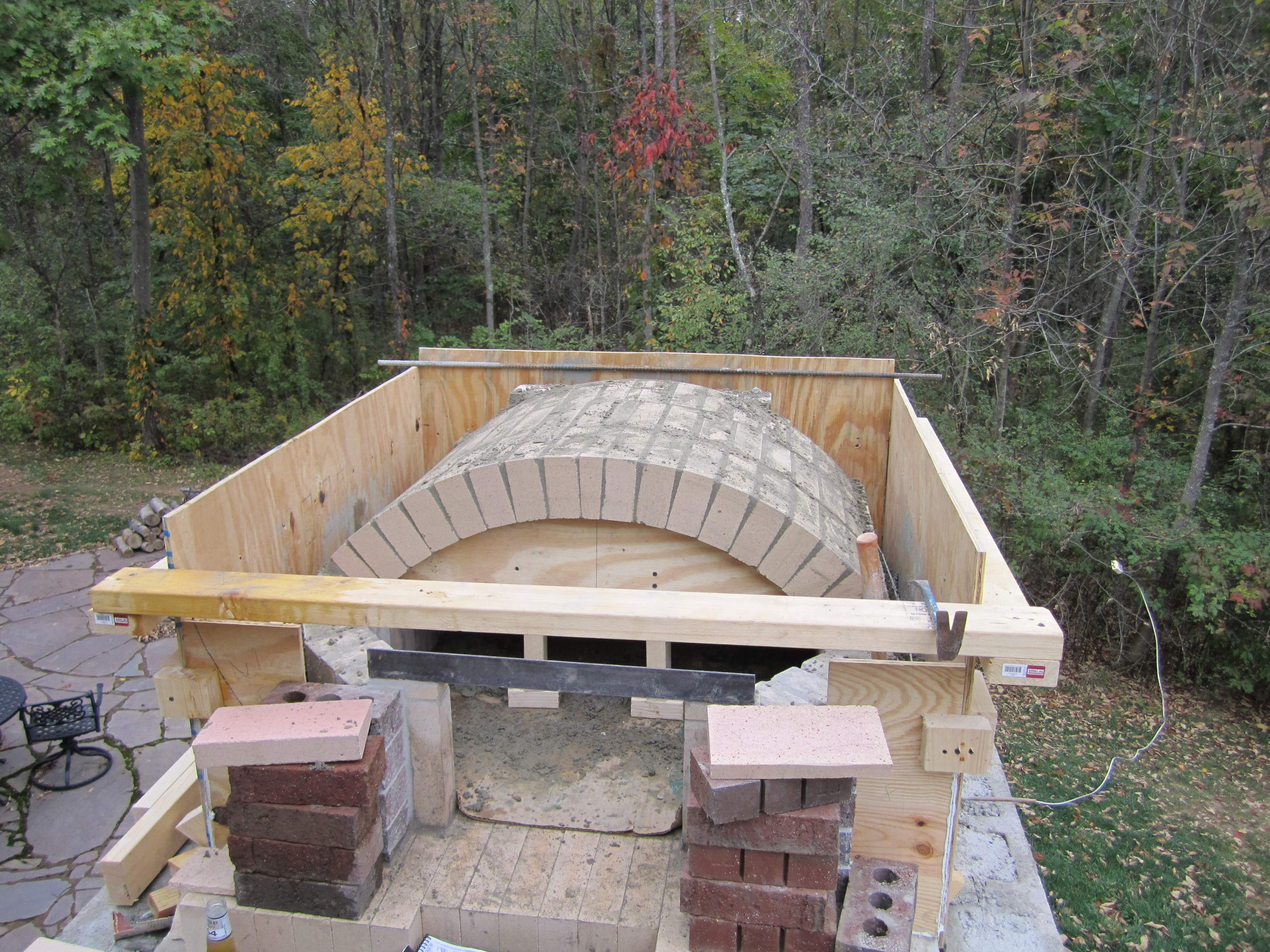

Arch construction continues!!

Those arches are great. Nice job. I can't wait to see what the finished product looks like.

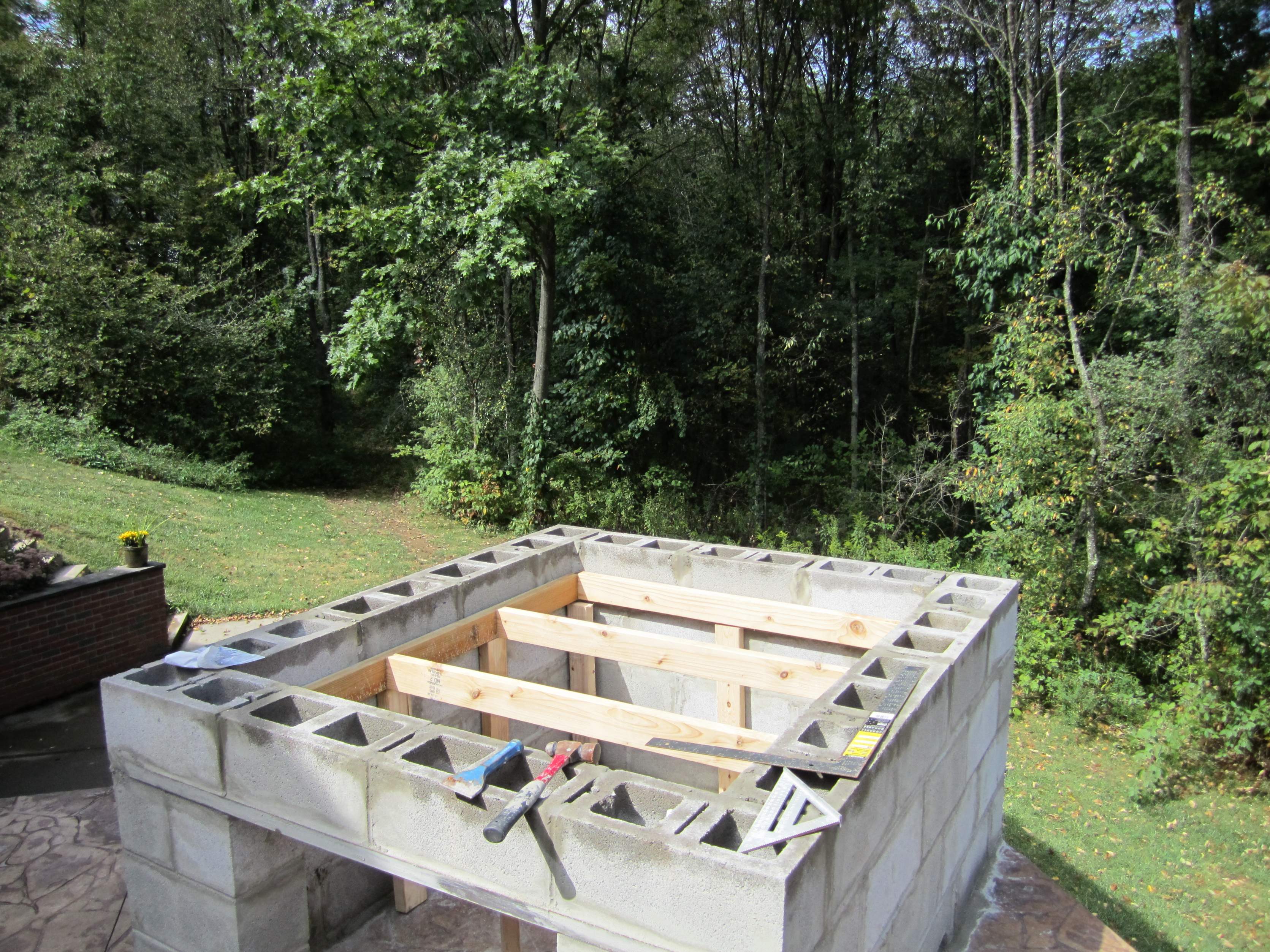

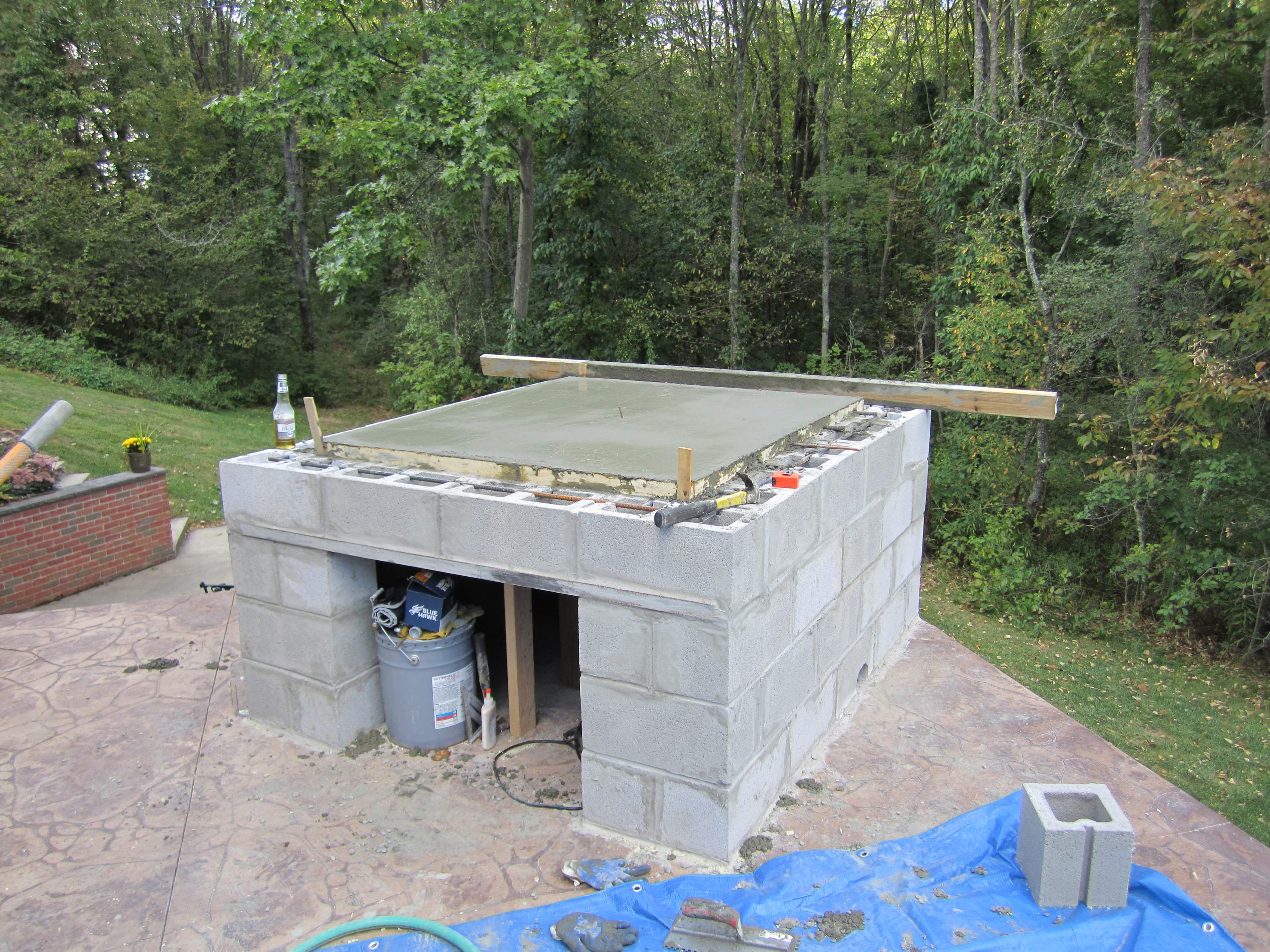

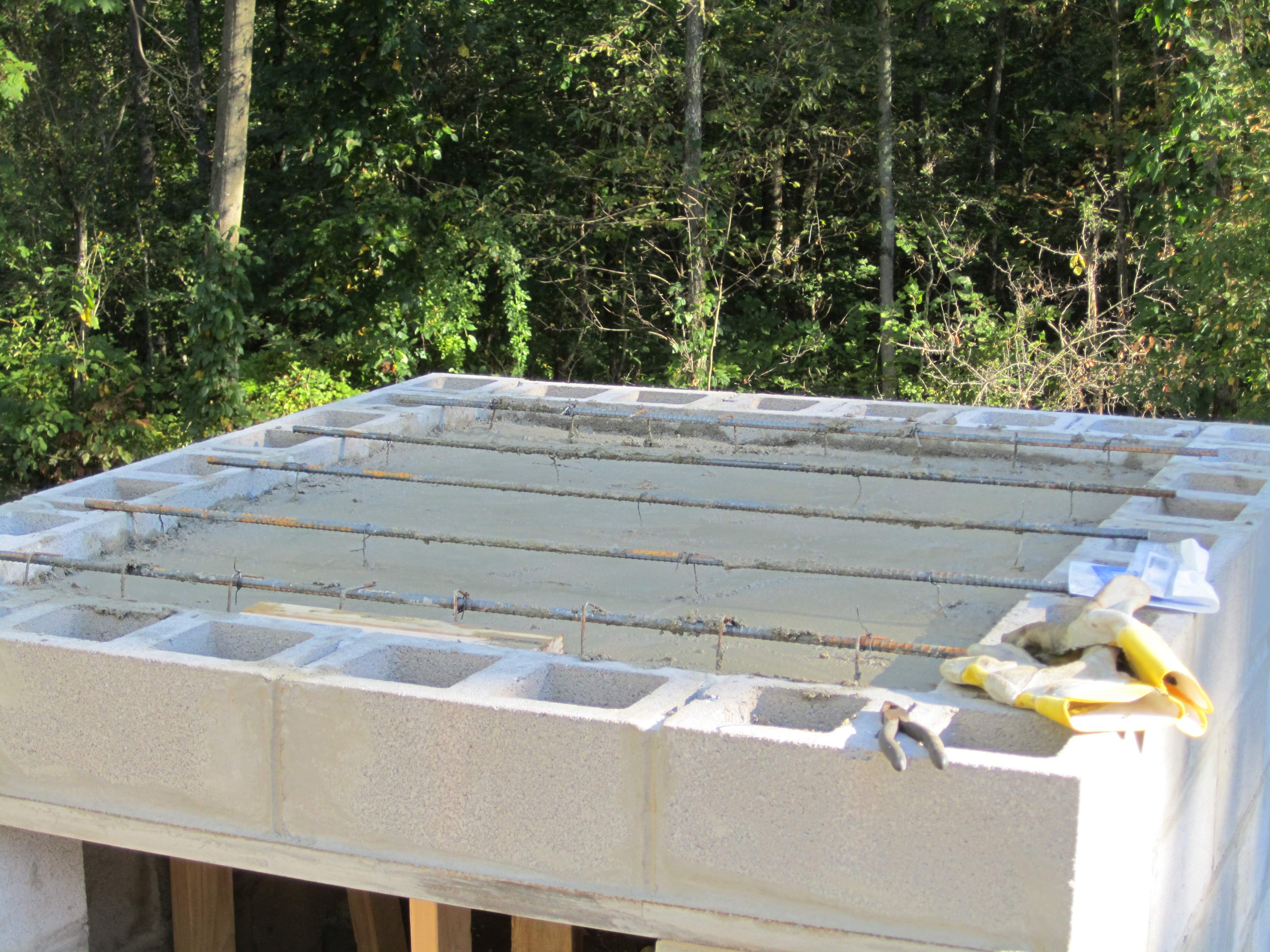

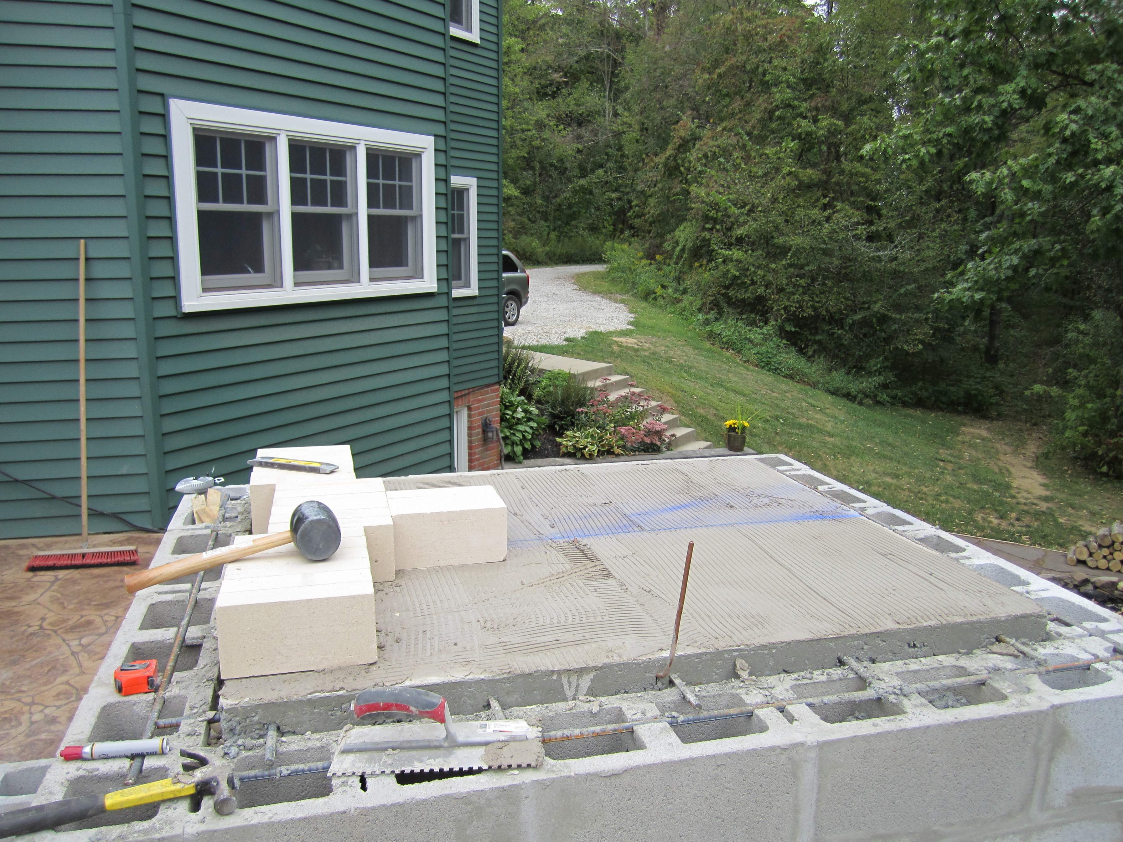

In the last pix, it looks like you have concrete in the blocks now?

Good looking job, went heavy with the fire brick, that can't hurt.
Questions:
1 Are you using a special high temperature mortar?
2 Traditionally there is a vent for the combustion products I was wondering where this will be but I am sure you have that planned out?
3 Also you live in a frost area, will you be using glazed exterior bricks?
My uncle built an outside fieldstone fire pit oven and it did not weather well, the frost in the porous rock and mortar broke it up in a rather short period of time. Just curious, I love the project so far and am waiting for update pictures.
Yes, the blocks are filled at this point. I missed a few picture taking sessions during the construction and forgot to point that out. Several of the voids are filled right down to the floor, the top course is filled completely, all around.
Only posting a few posts with pics each evening. I'm using a Sony notebook on wireless internet and it takes forever to upload photos.

1. Mortar is a "home brew" of sand, portland cement, and fire clay. Good enough for casual weekend use. If you were to build one of these for daily use you would want to go to a refractory mortar.
2. The vent will be out of the front of the oven, it will become mre clear as construction progresses.
3. No glazed bricks. The entire area will be under cover and protcted from the weather when it is done. You are correct though, this oven needs to be kept dry.

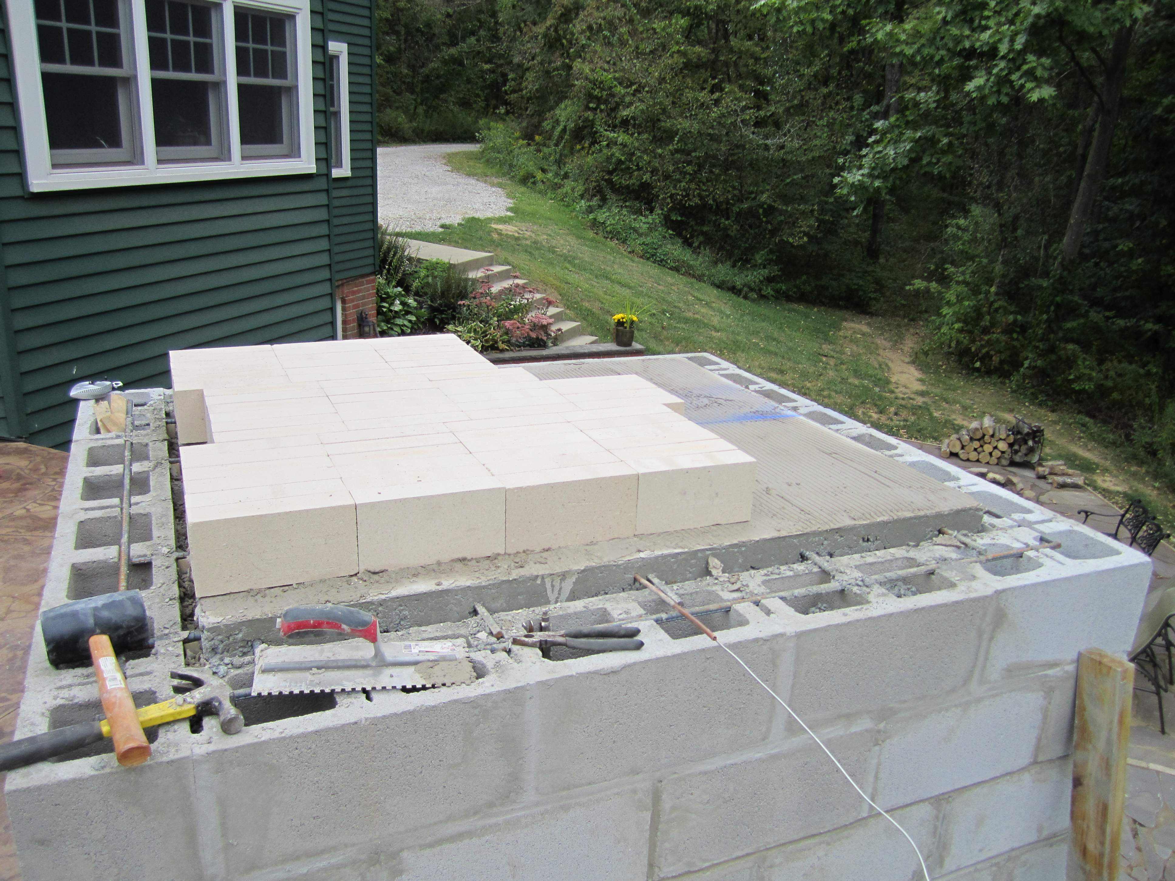

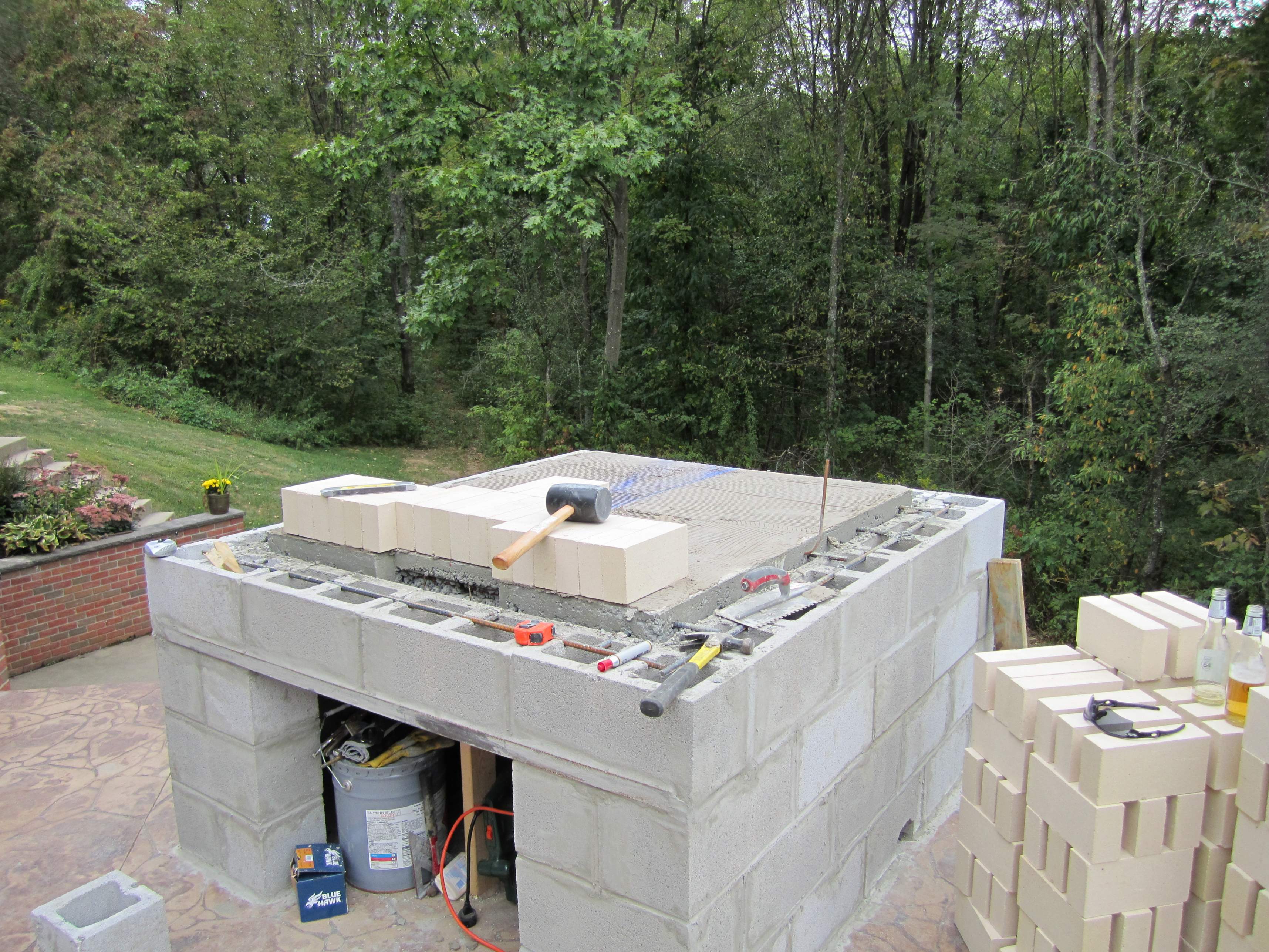

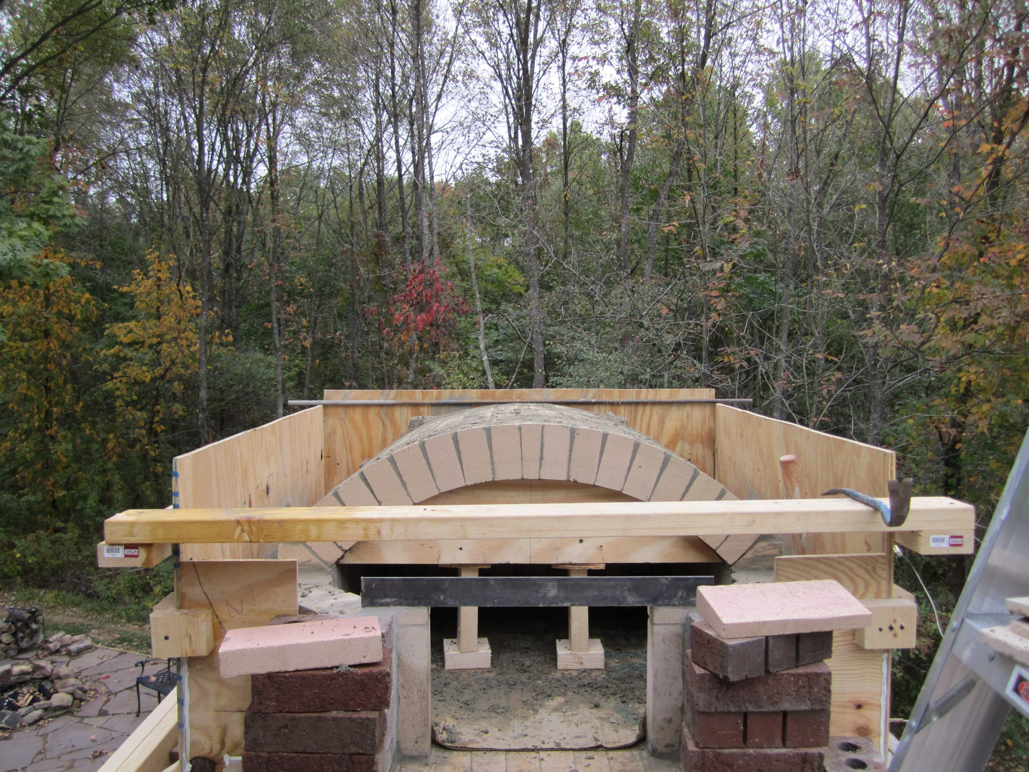

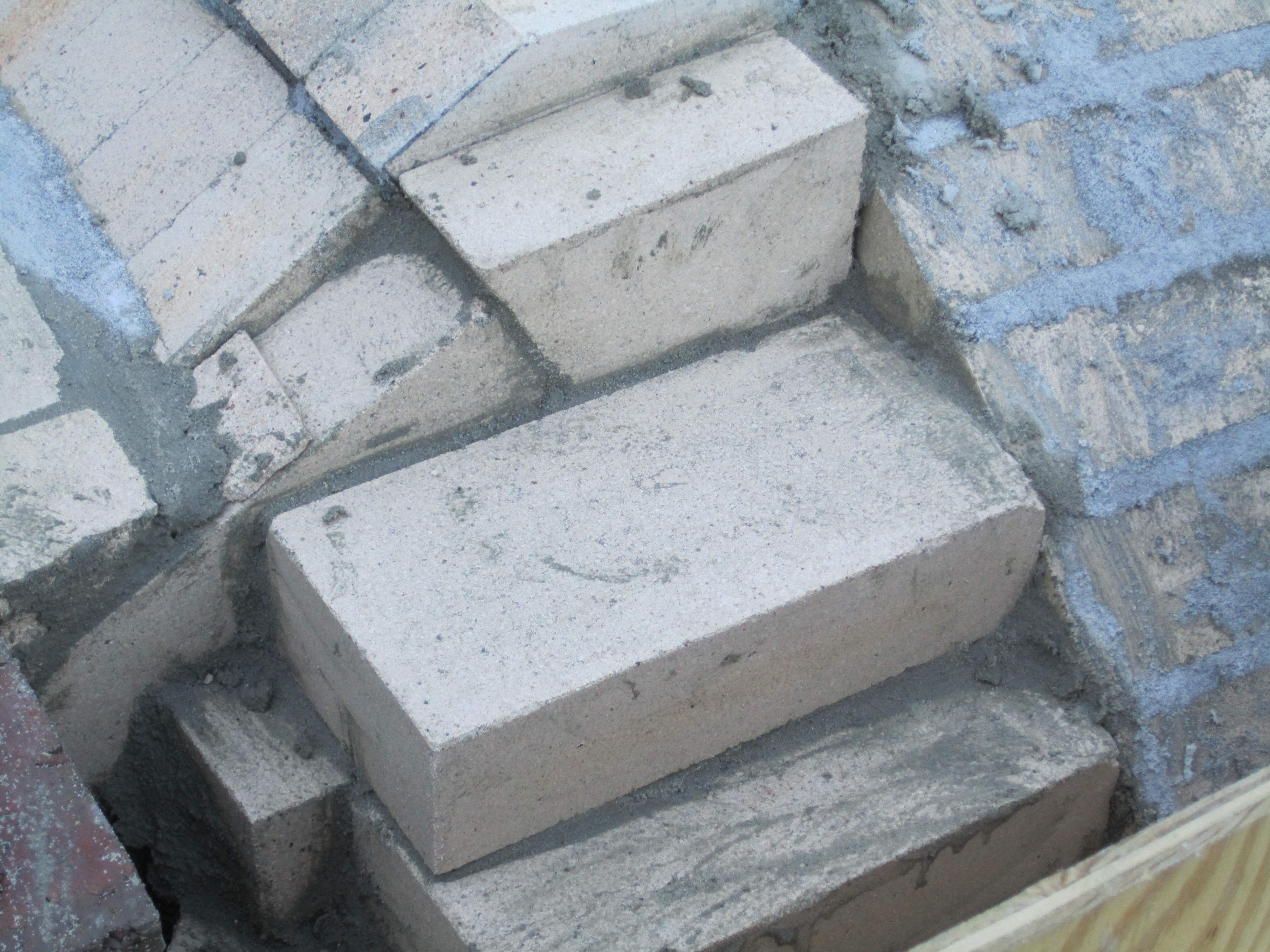

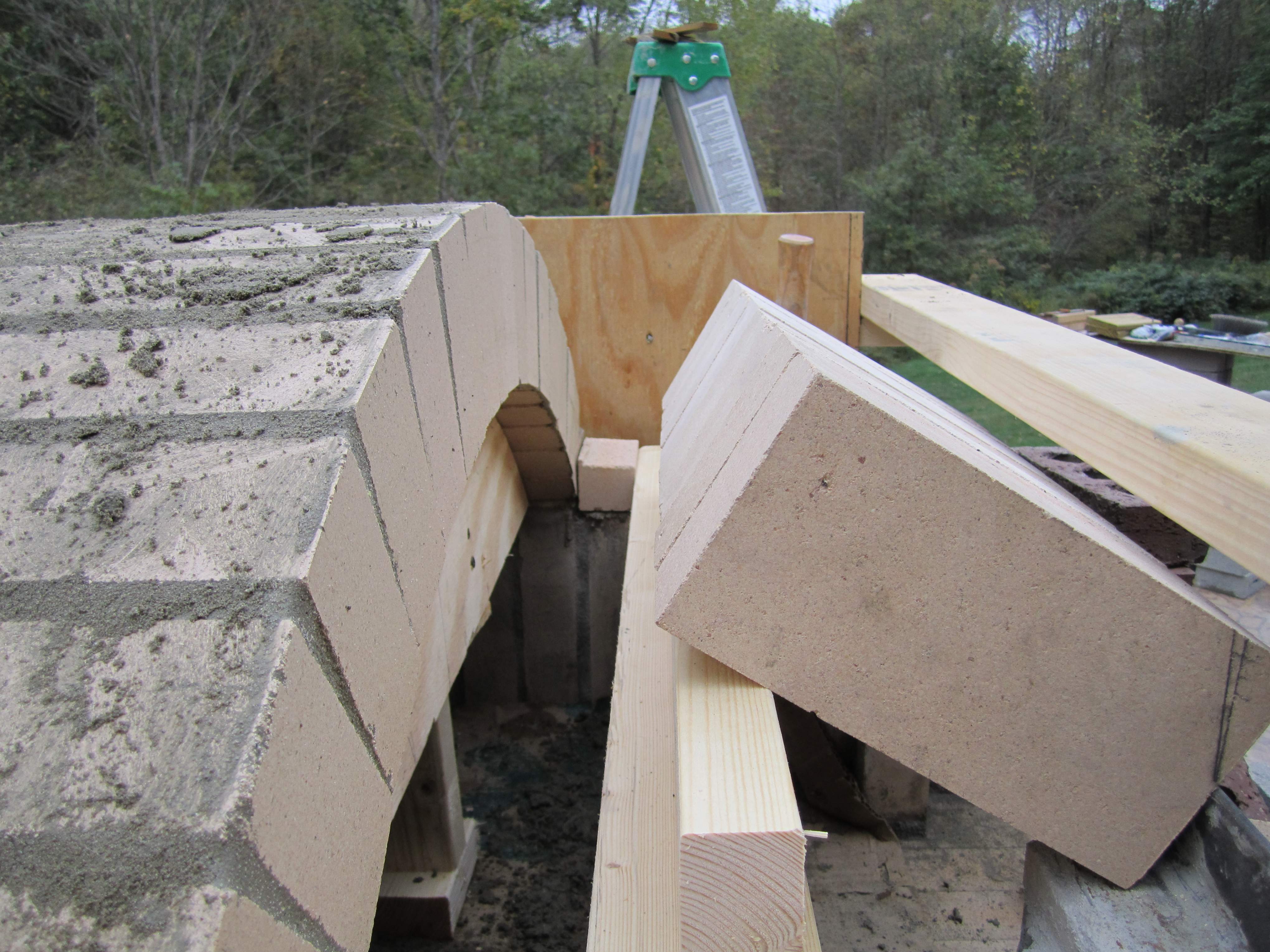

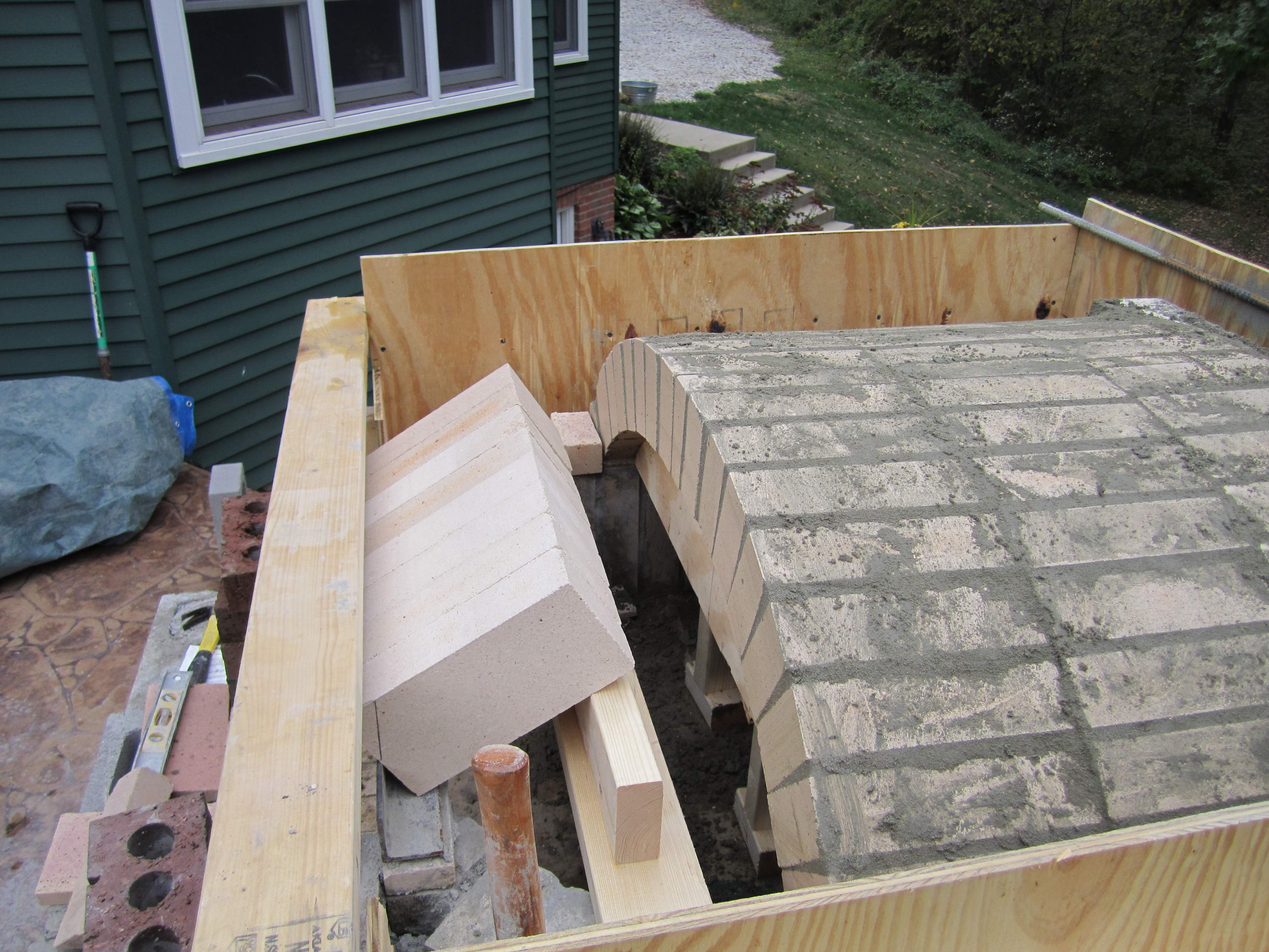

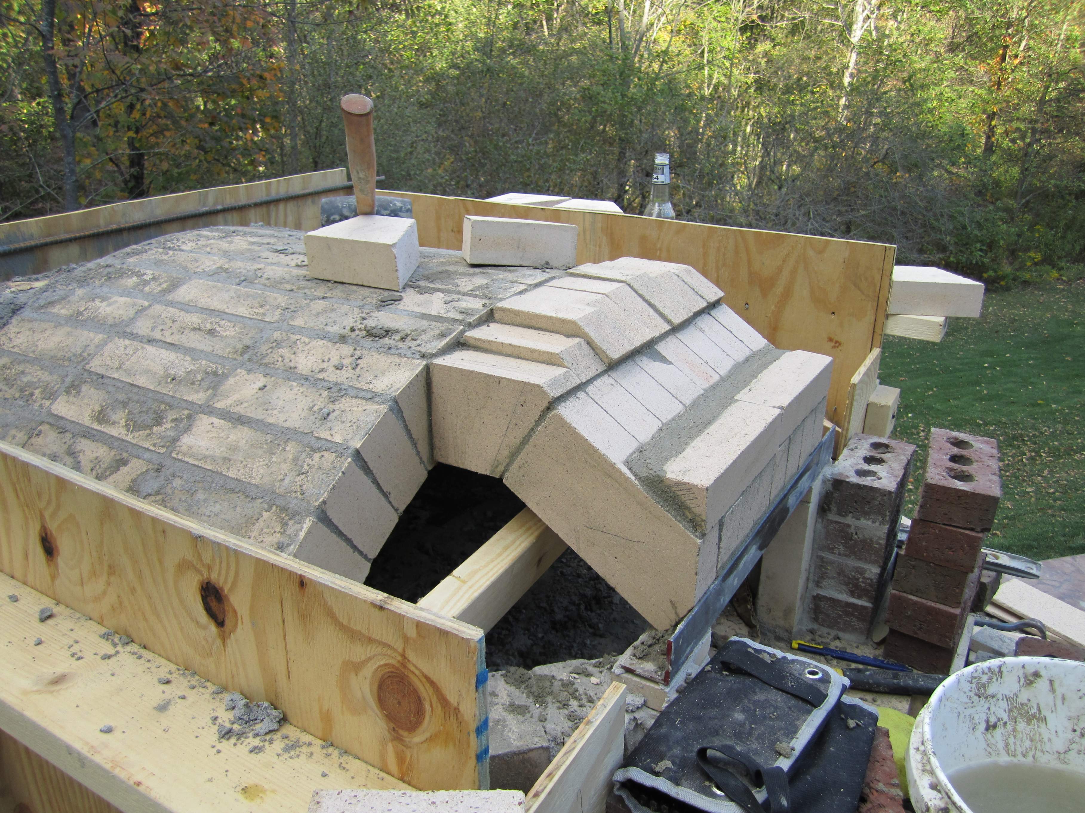

OK, a few more installments.
After the arches were in place the transition to the oven's door had to be built. This is not so cut and dried and varies from oven to oven but the principle remains the same. The transition needs to take the arch shape down to the door. here are a few shots of the process.
/ Patio/Outdoor Kitchen Project
#59

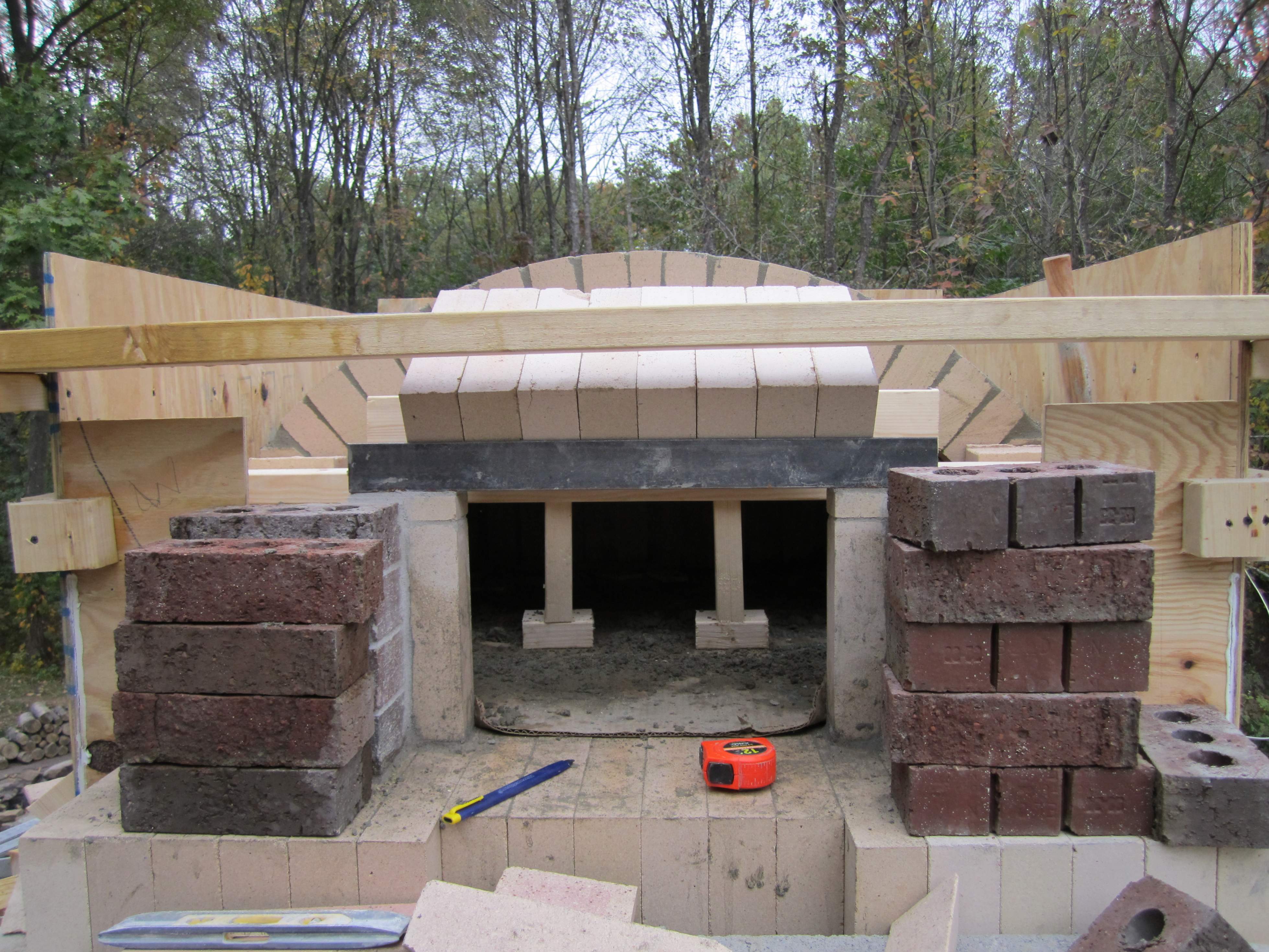

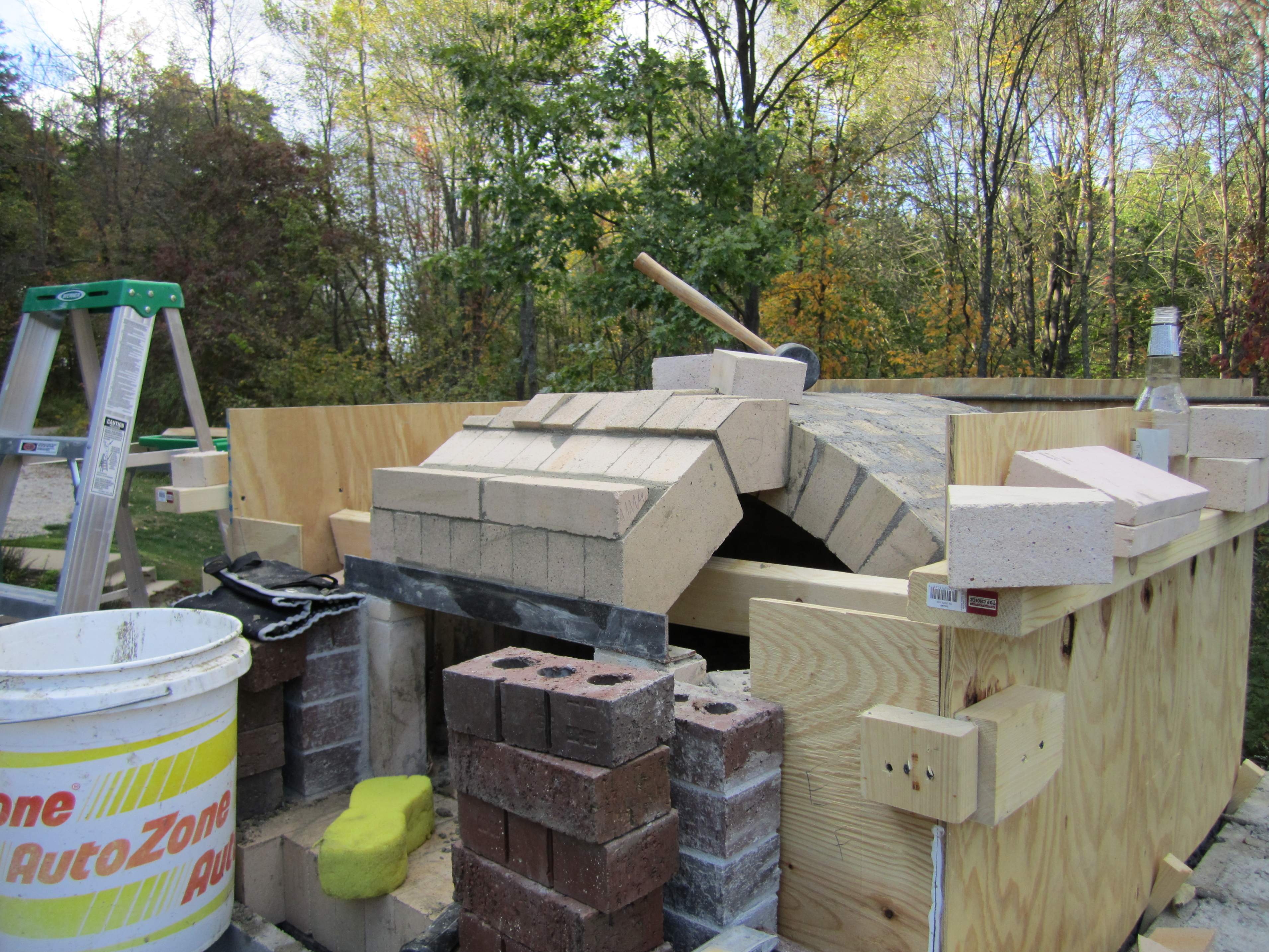

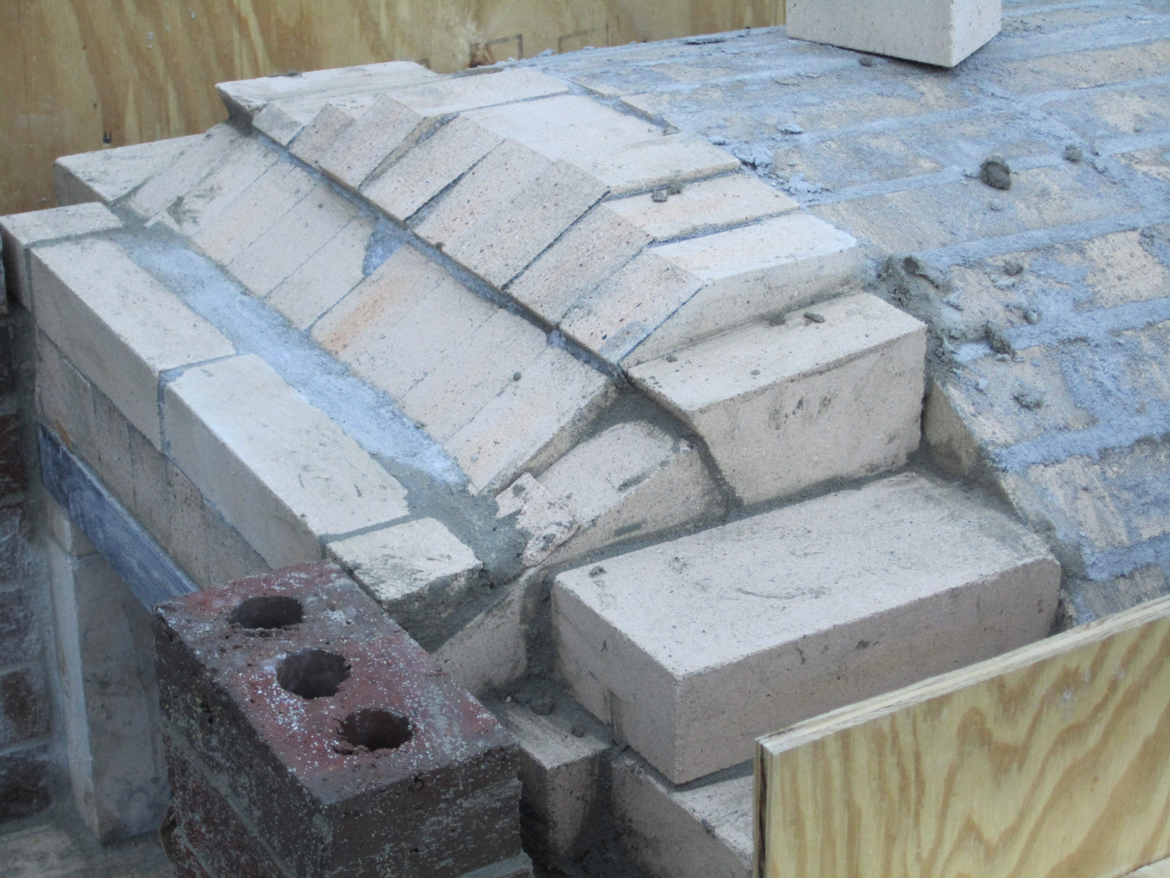

As you can see a 2X4 is laid across the front of the last arch and bricks are supported from the angle iron lintel to the 2X4. Once those bricks are in place and grouted measurements are taken and bricks are cut to fit into the reamining space.

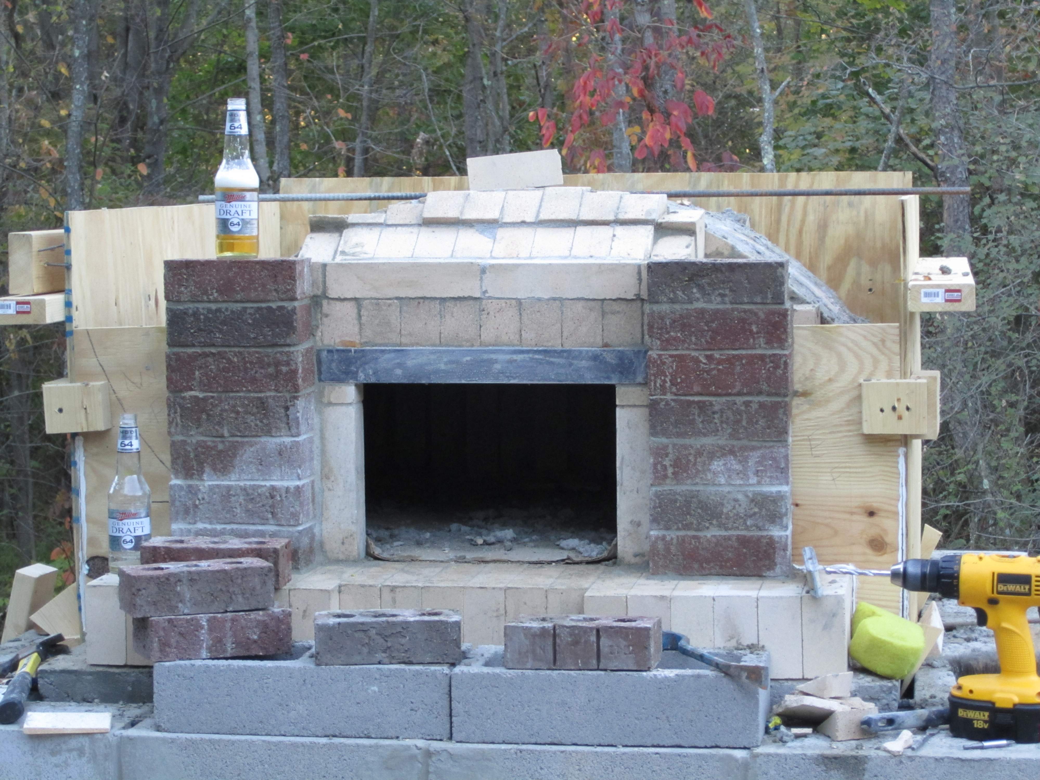

I know what your thinking, not very pretty. Understand that none of this will be visible when the oven is complete. It is strictly built for function at this point.
Once the top transition was installed the next step was to close up the openings on the two sides. This again is up to the installer to complete and the instructions are vague "Close it up" so I did.
