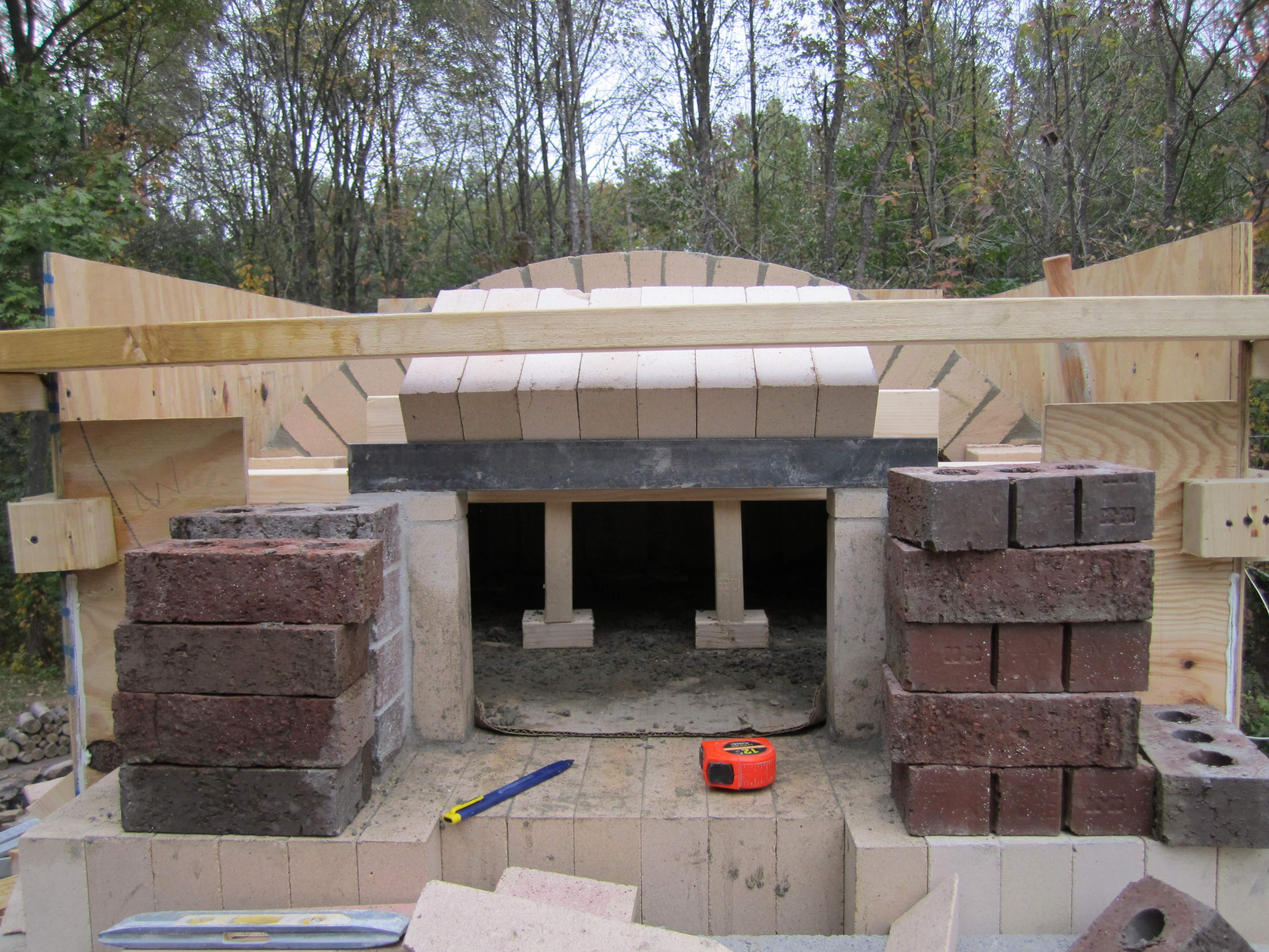

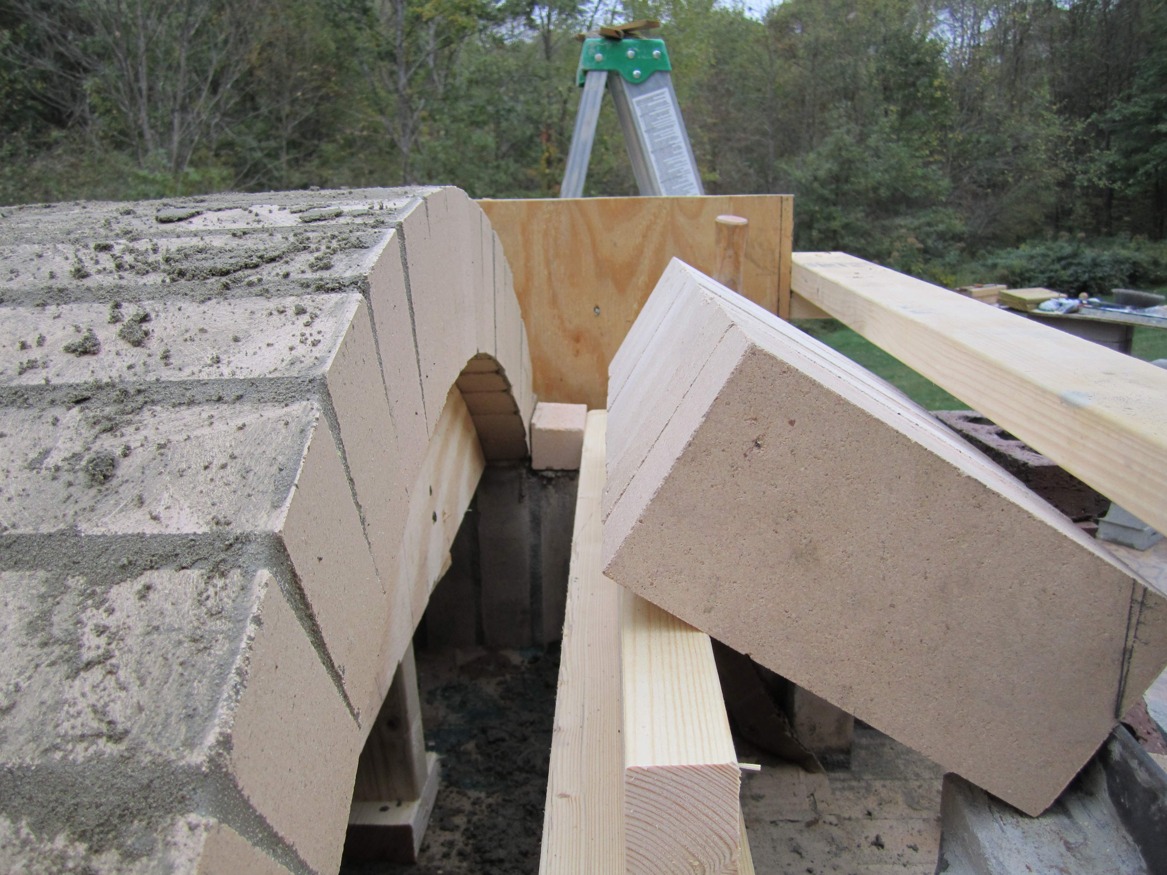

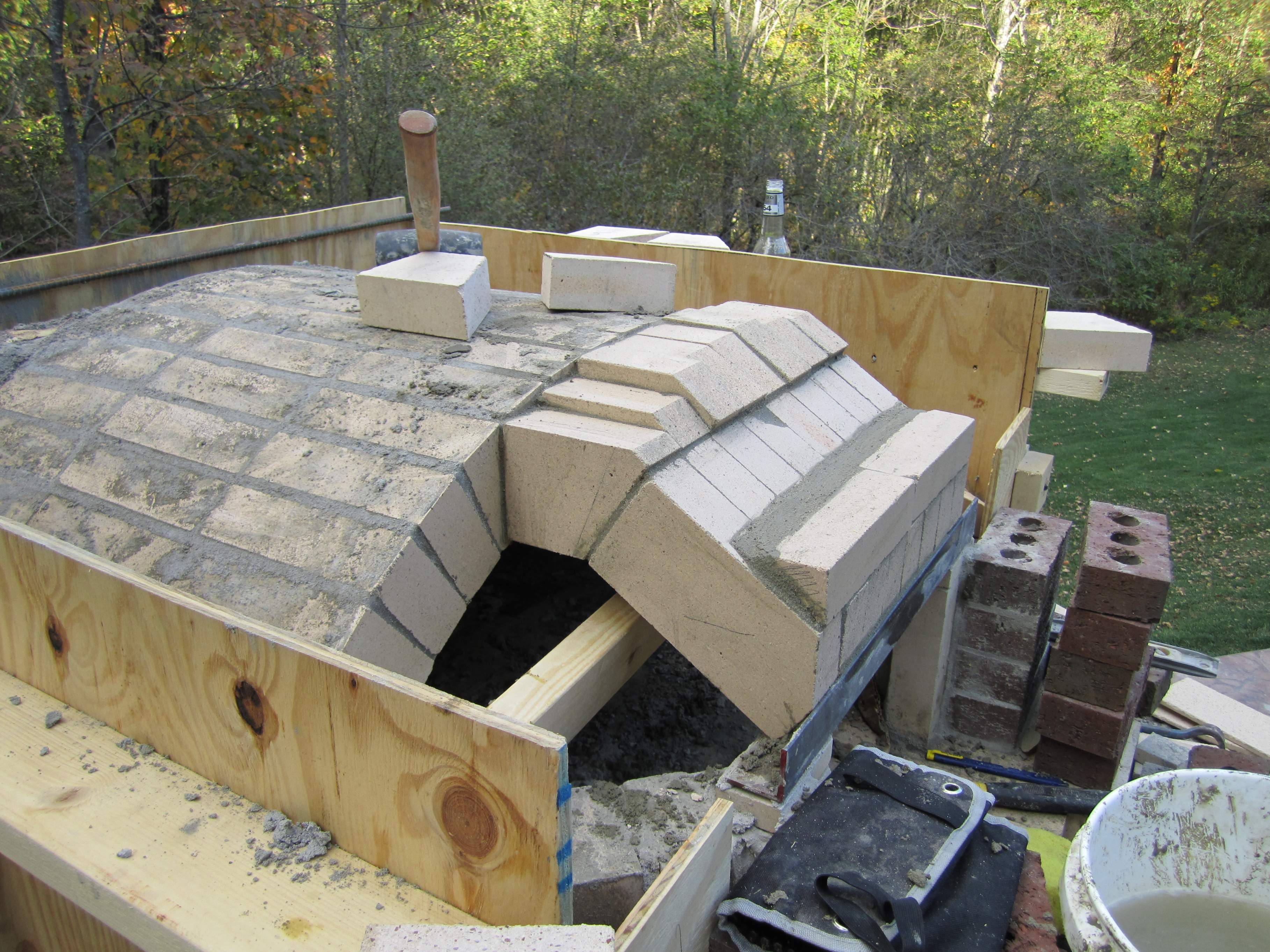

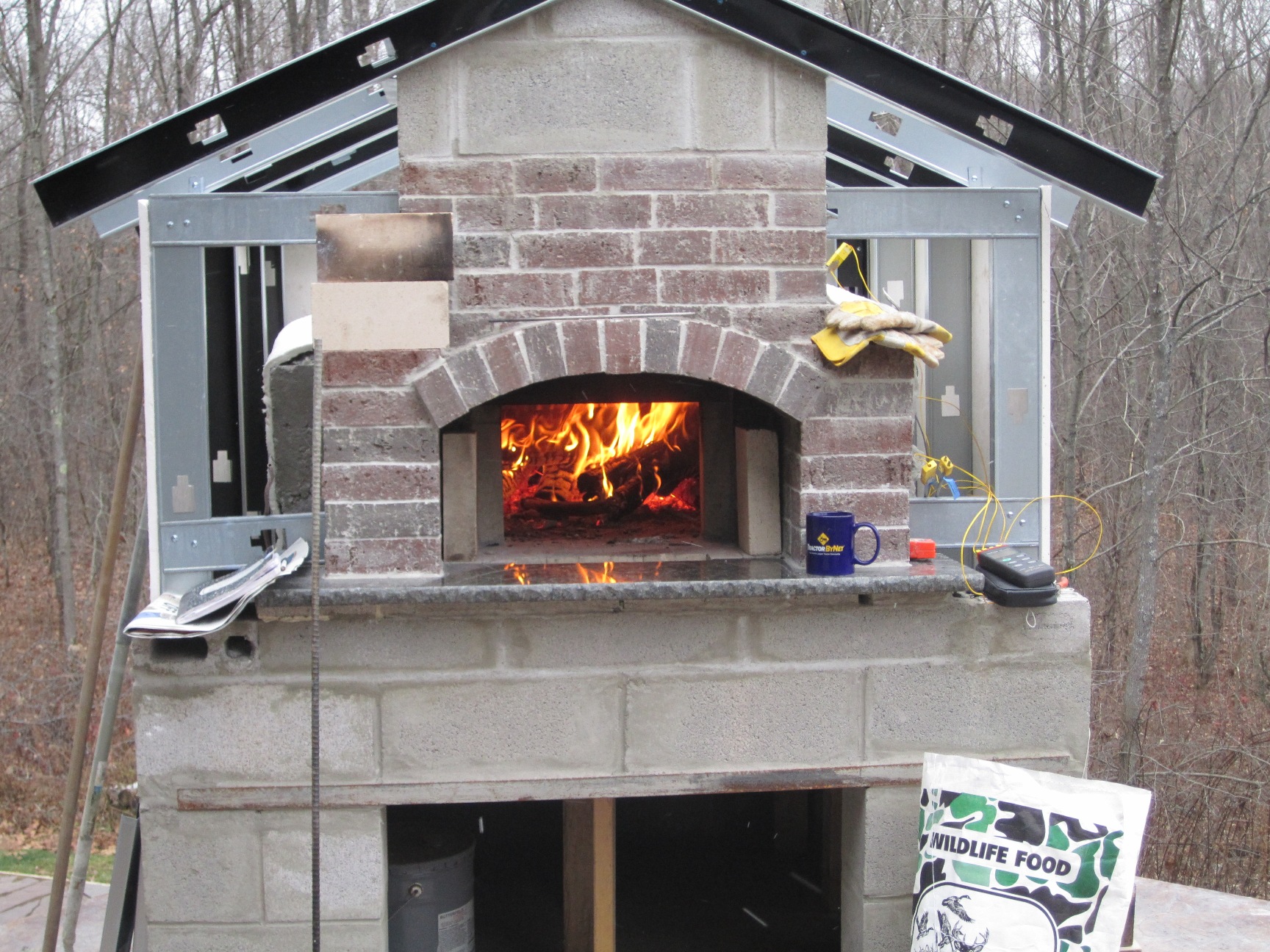

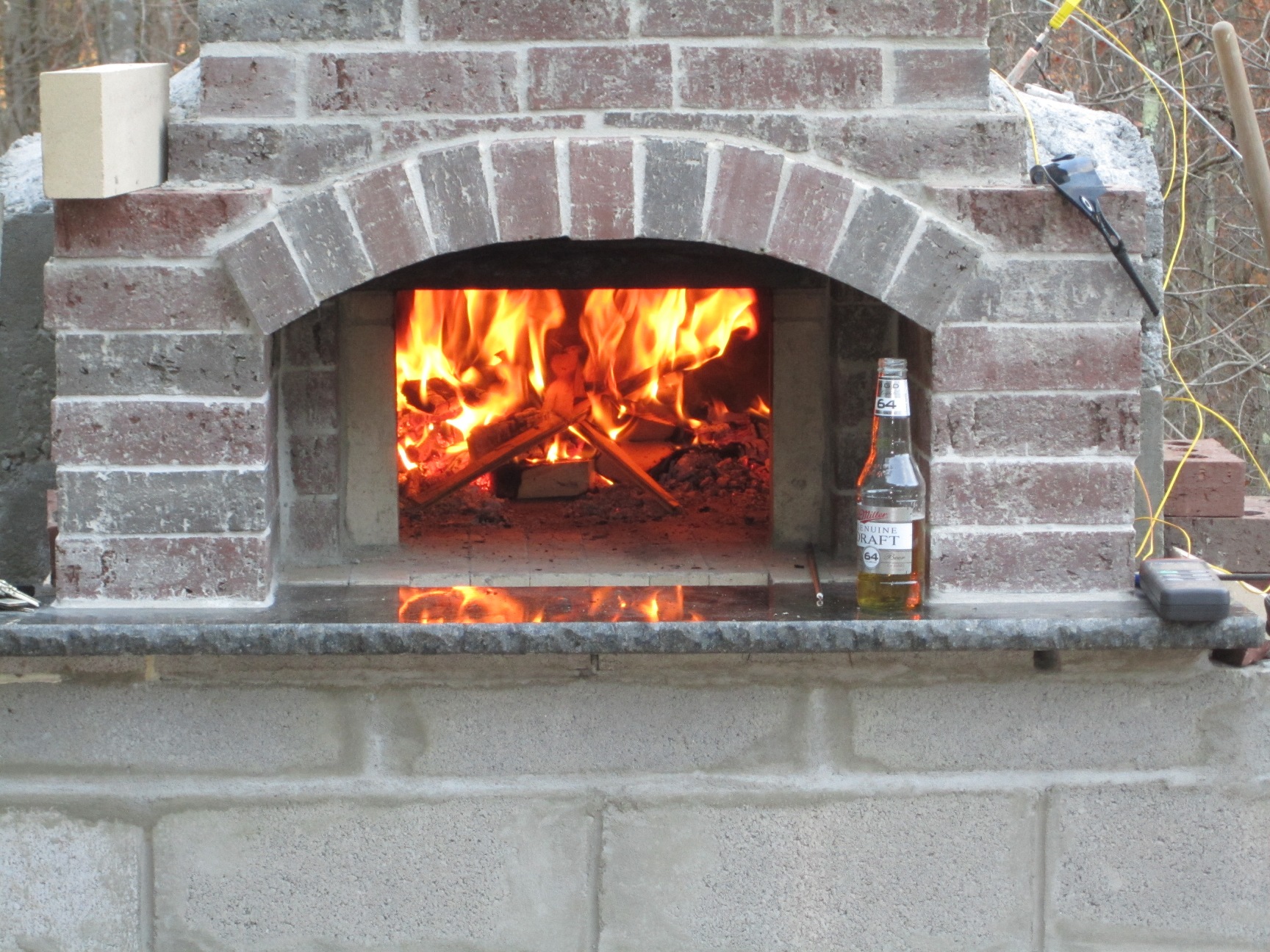

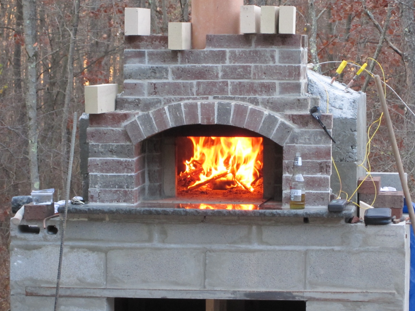

OK, now I'm back home and have access to my pics. Here we go, back to oven building.
At this point the oven has had 3" to 4" of concrete cladding added and the curing process has begun. I kept the concrete wet for the first few days and then allowed the concrete to cure for a little over two weeks. After a couple of weeks I started lighting small curing fires.

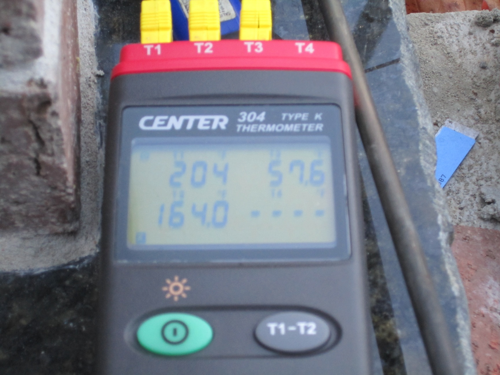

It is extremely important to start out slowly and work the temperatures up with successive firings. I had installed three thermocouples during the building process so I could monitor temperatures. #1 is located one inch deep in the middle of the hearth area, #2 is one inch deep into the arch brick, #3 is at the junction of the firebrick and cladding.

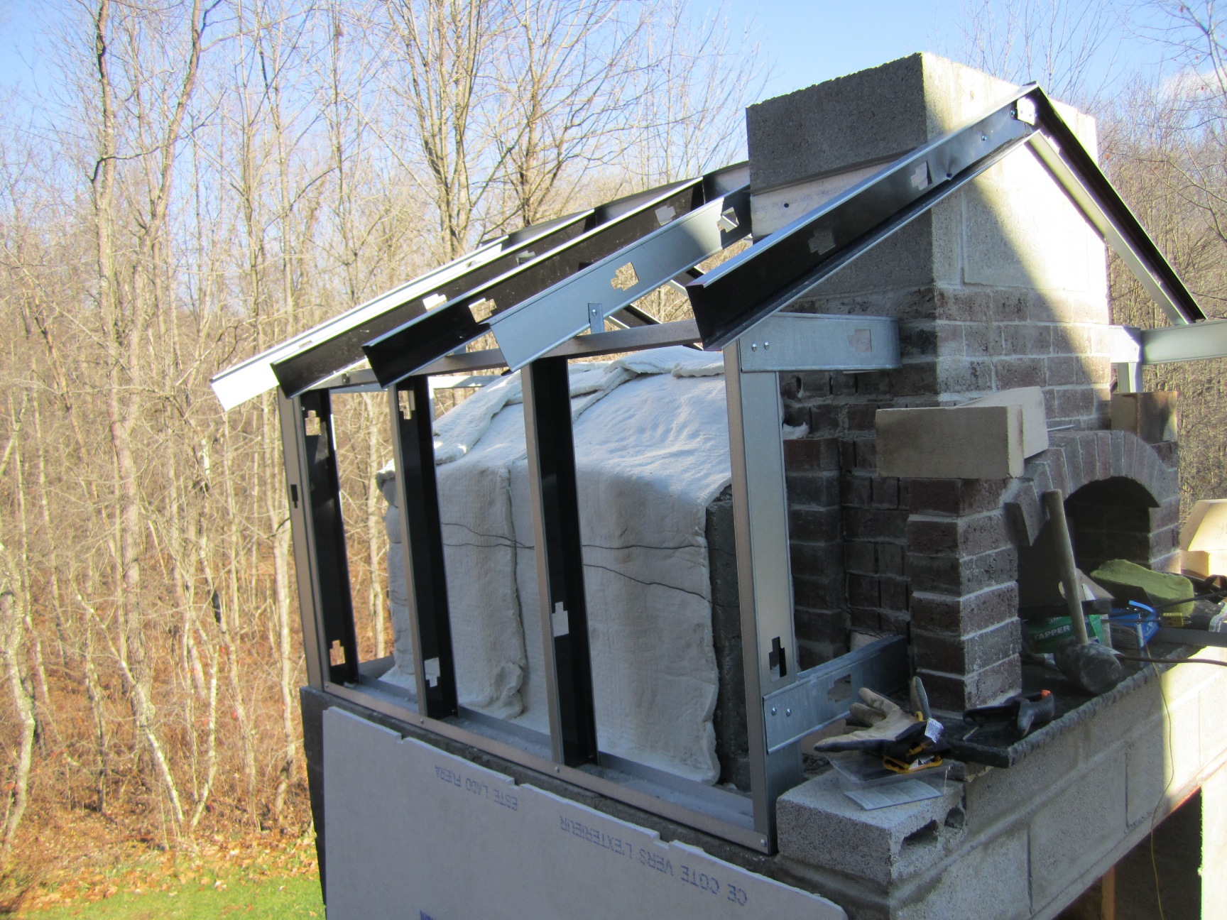

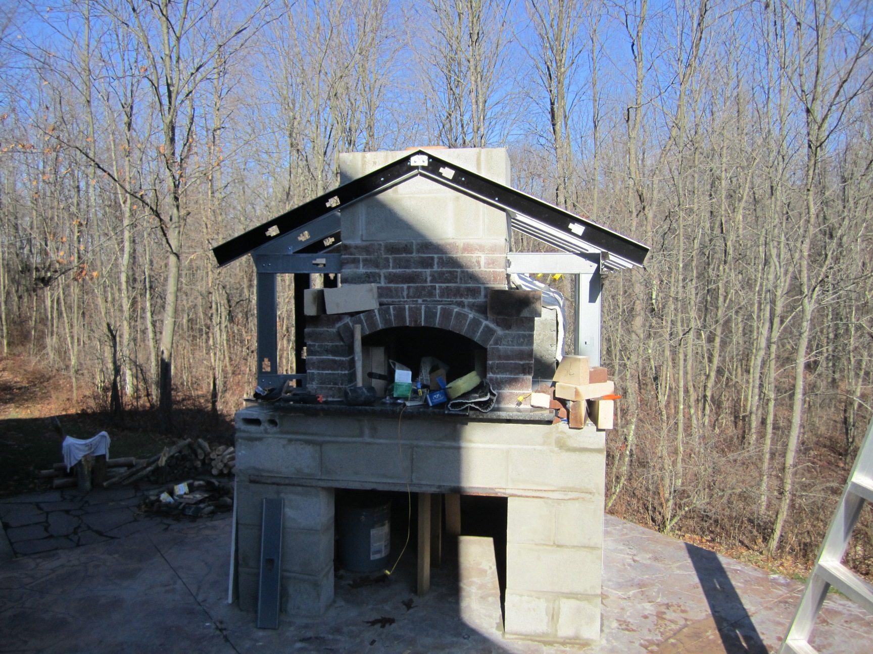

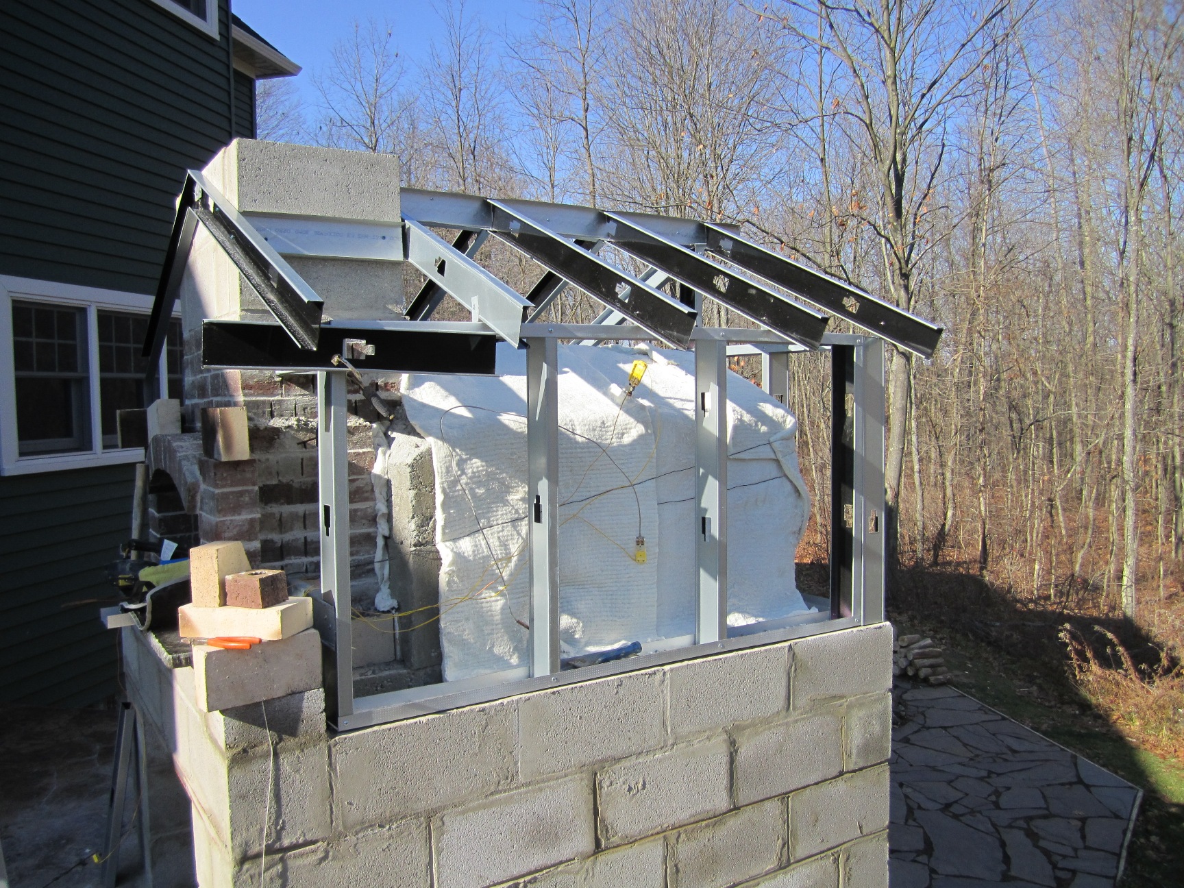

After the oven was sufficiently cured I turned my attention to the oven's enclosure. I built the frame from metal studs. Once the frame was up I could wait no longer, I had to get a fire going to bake some bread.

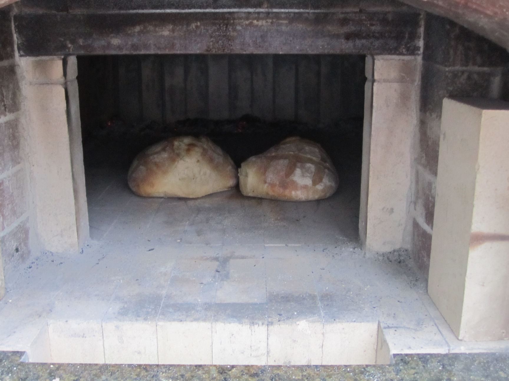

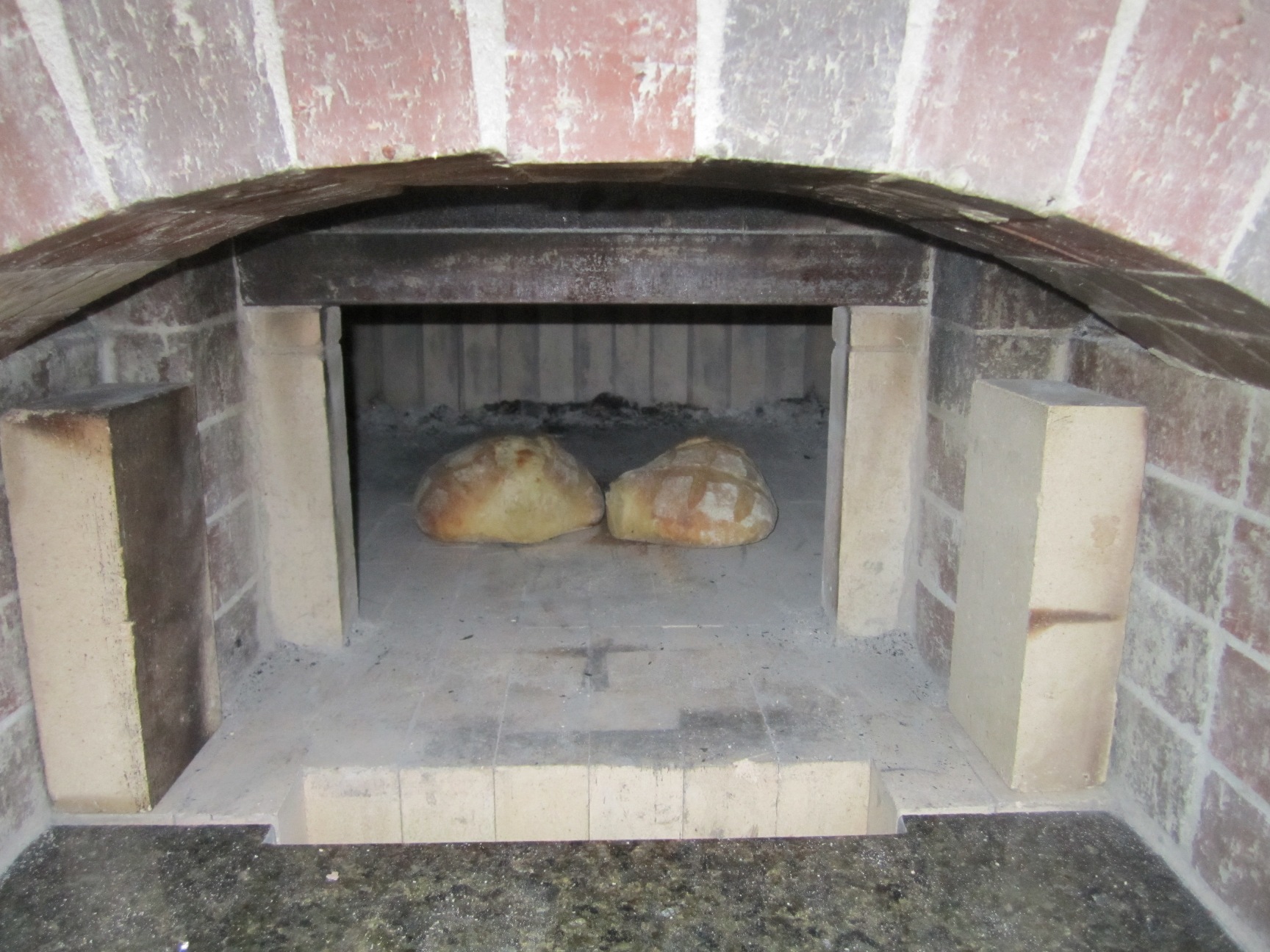

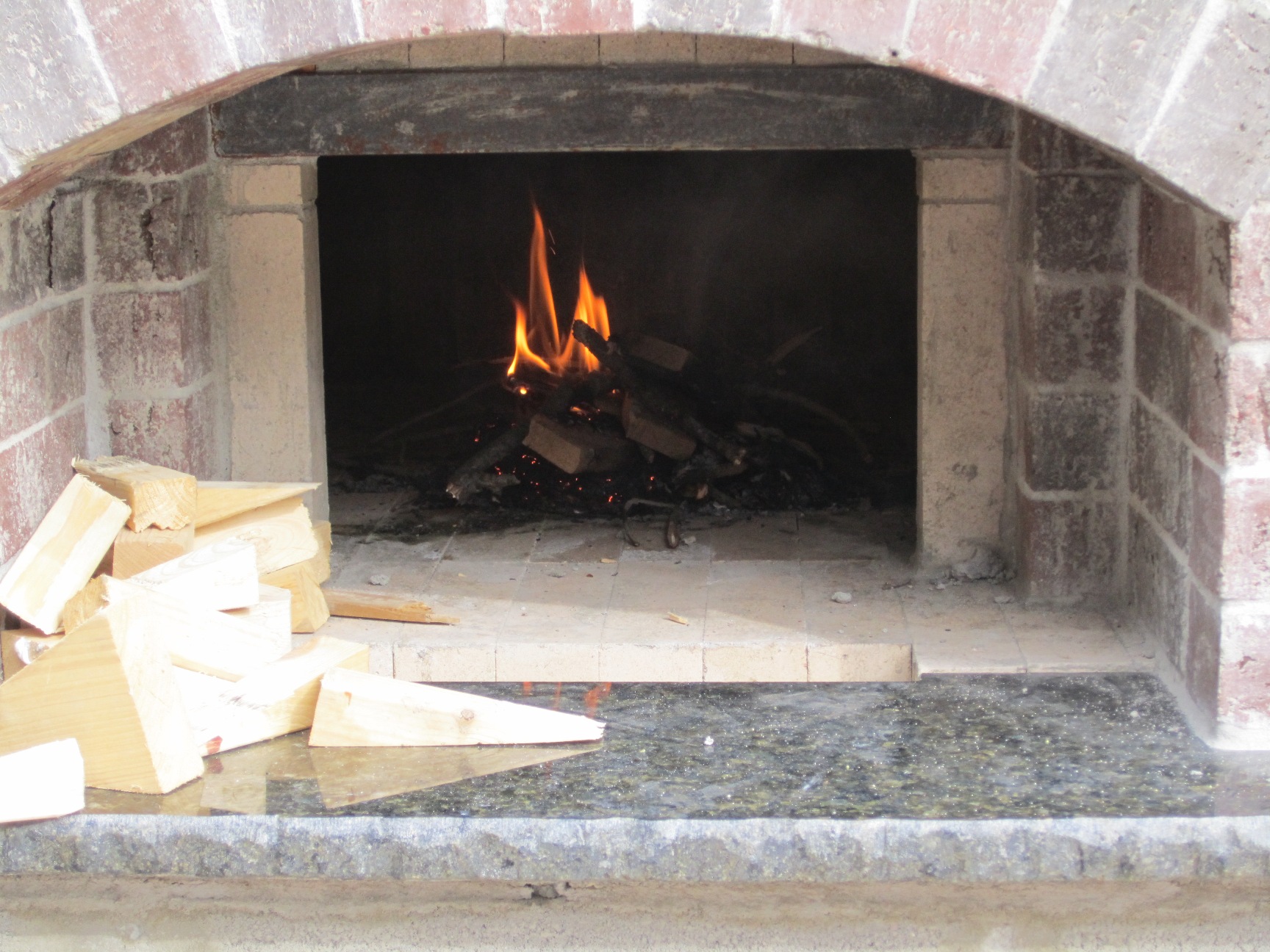

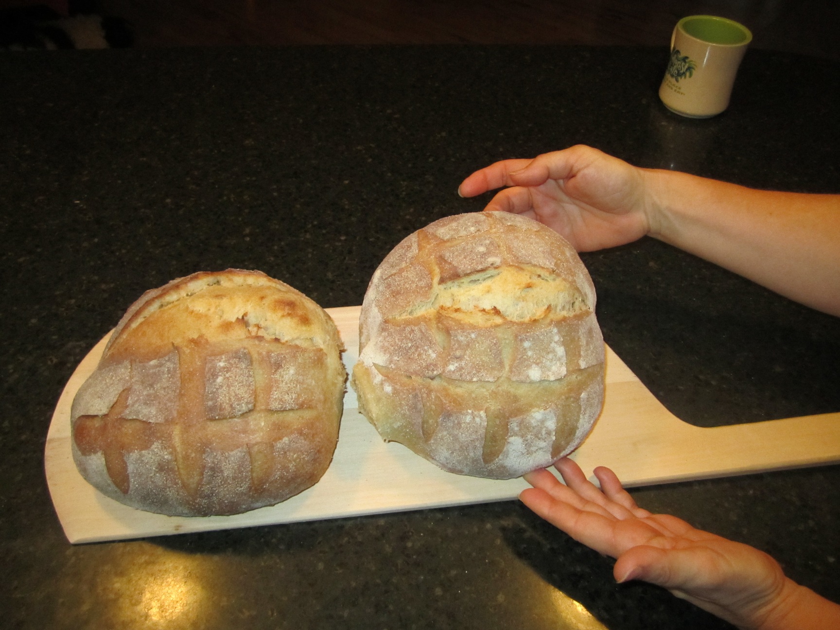

The firing process for baking is fairly simple, but it takes a while if you don't know what your doing (me). Build a fire at the front of the oven and gradually push the fire to the back. Allow the fire to burn until the arch is cleared (soot is burned away and bricks are white again). In my case the oven is heated to about 650 degrees. Put the oven door on and let the fire die out.
After the fire is out and only coals are left, remove the door and rake out the coals. Once the coals are out, put the door back on and allow the oven temperature to stabilize to the temperature you require. In my case I bake starting at 500 to 550 degrees.
Slide the loaves into the oven, apply steam and put the door back on. In order to create steam I bought a garden sprayer and spray water mist into the hot oven ever couple of minutes for the first ten minutes of baking. The loaves take about 25 minutes to bake.

Wow! that looks like that was a project. A rewarding one at that though. How do you hook up thermocouples? I am trying to come up with a cheap 3 ft probe thermometer and was wondering if it would work to put a thermocouple on the end of a rod with it able to plug into a display?
It depends on the temperatures you are going to be measuring. The thermocouples I am using are type K and are accurate up to 2200 degrees, that's a bit of overkill if you are reading lower temperatures. I'll look up the website I bought some of my supplies from and post it. There are a couple out there. I also have access to some supplies from work. For instance, the thermocouples I am using were used in a firing furnace and were changed and thrown away after routine maintenance. Picked them right out of the hopper and took them home. Probably would've cost me at least $25 a piece new.
OK I looked up the sites where I purchased thermocouple supplies. I got the meter from http://www.professionalequipment.com/xq/ASP/qx/default.htm? cid=PEBPGGL&CMP=KNC-Google&gclid=CObO54CN96YCFUdrKgodaE6eCg
The other stuff (thermocouple wire and plugs) I got from
http://www.omega.com/
