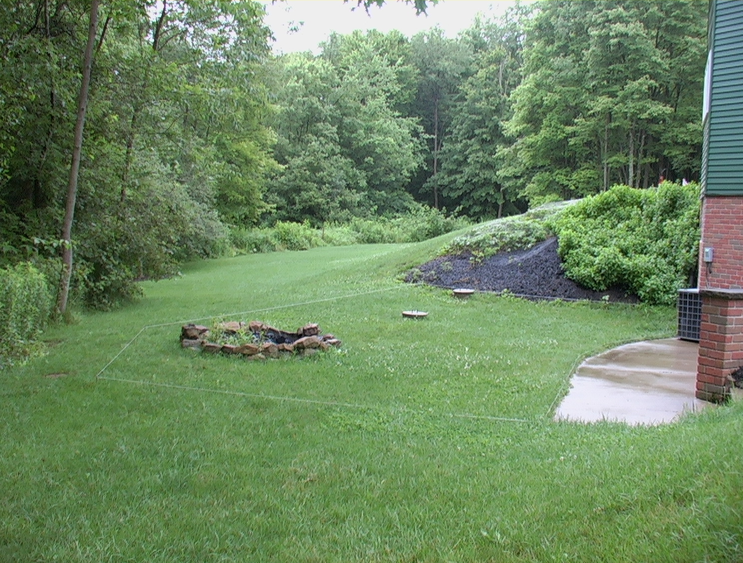

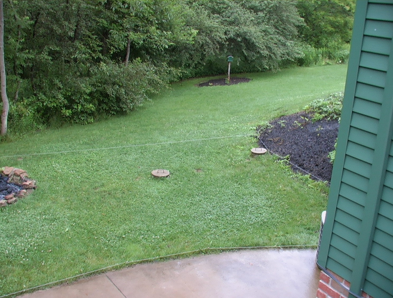

The first part of the project (flagstone patio) isn't terribly well documented, so be patient with me.
Here is the patio area laid out. Yes, those are the septic tank lids that you see. This was one of the little dilemmas I had to deal with.

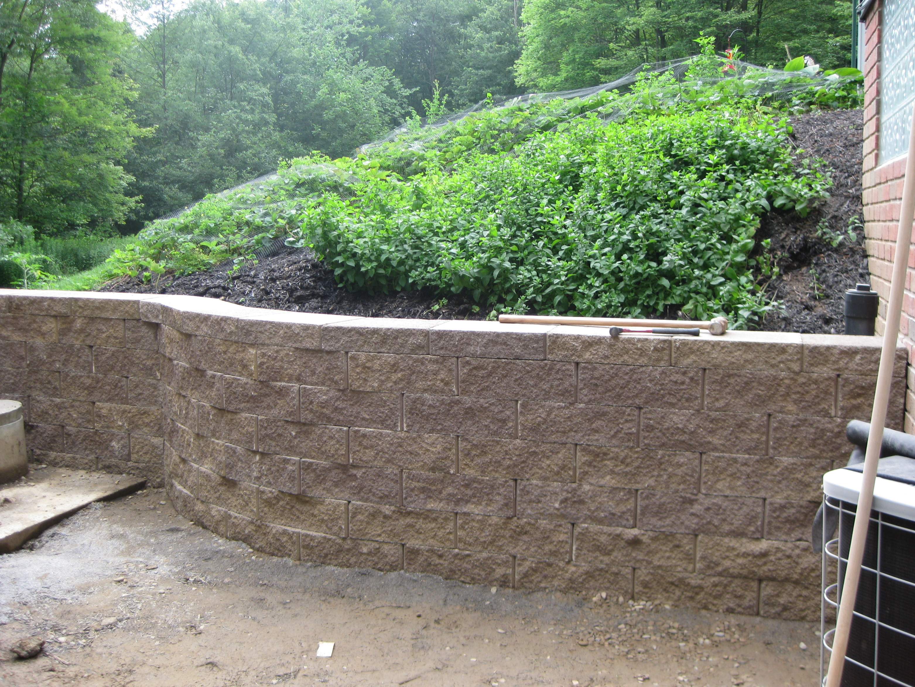

The first order of business (after removing 6+" of dirt) was to build a retaining wall against the hill. In the photo you will see this completed. It really only seems that easy:laughing:.
One of the things that I wasn't prepared for was the amount of dirt I had to get rid of While digging this out.
I used to have fleeting thoughts of digging a pond until I did this.

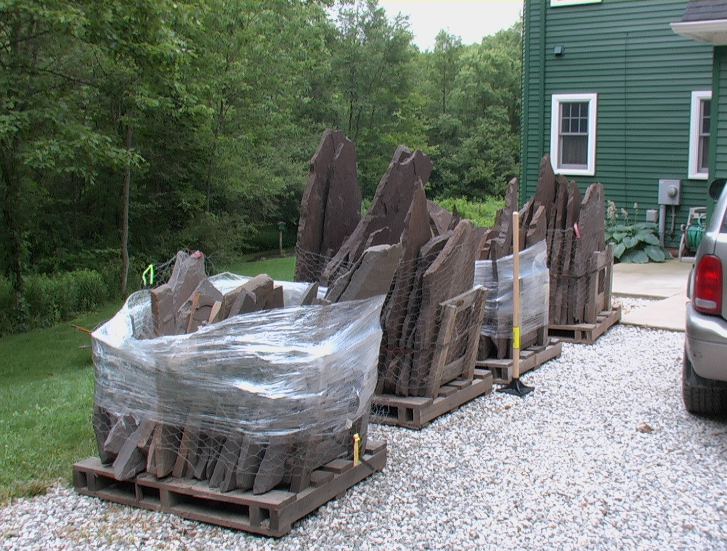

Can't be a complete description without a pic of the 6 ( yep, I said 6) tons of PA Lilac flagstone. My back has started hurting again thinking about it.

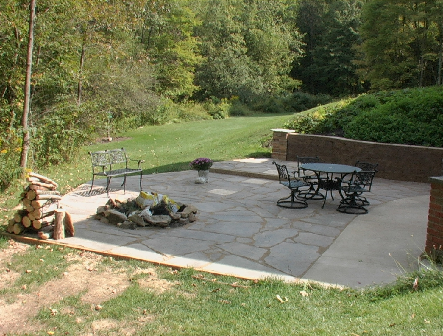

Unfortunately this is where the poor documentation begins. The next pics of the patio you will see will be of the completed patio.
I can briefly describe the steps, but there will be no pics to accompany them.
After digging out the 6" of ground to allow for the flagstone's base, I had to provide some drainage. This is a very wet area and during the process we had quite a bit of rain.
After the drainage was complete I laid 2" of gravel in the patio area. The gravel was tamped (by hand) and leveled. On top of the gravel I placed 2" of coarse sand and leveled it as well.
This is when the fun started. The flagstone pieces were brought down one a time by hand truck and put in place.
Here's a quick pic of the completed patio (with fire pit)

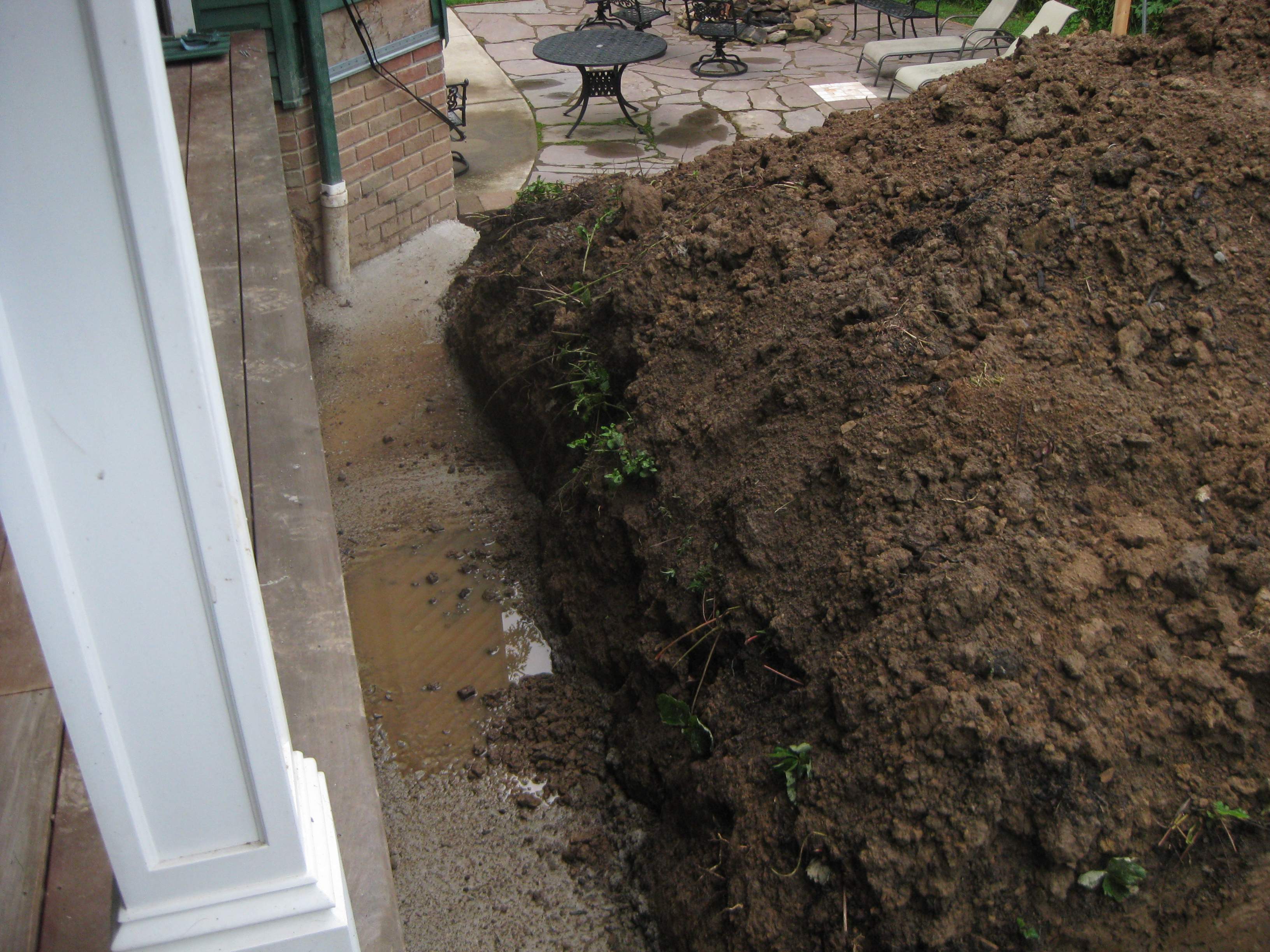

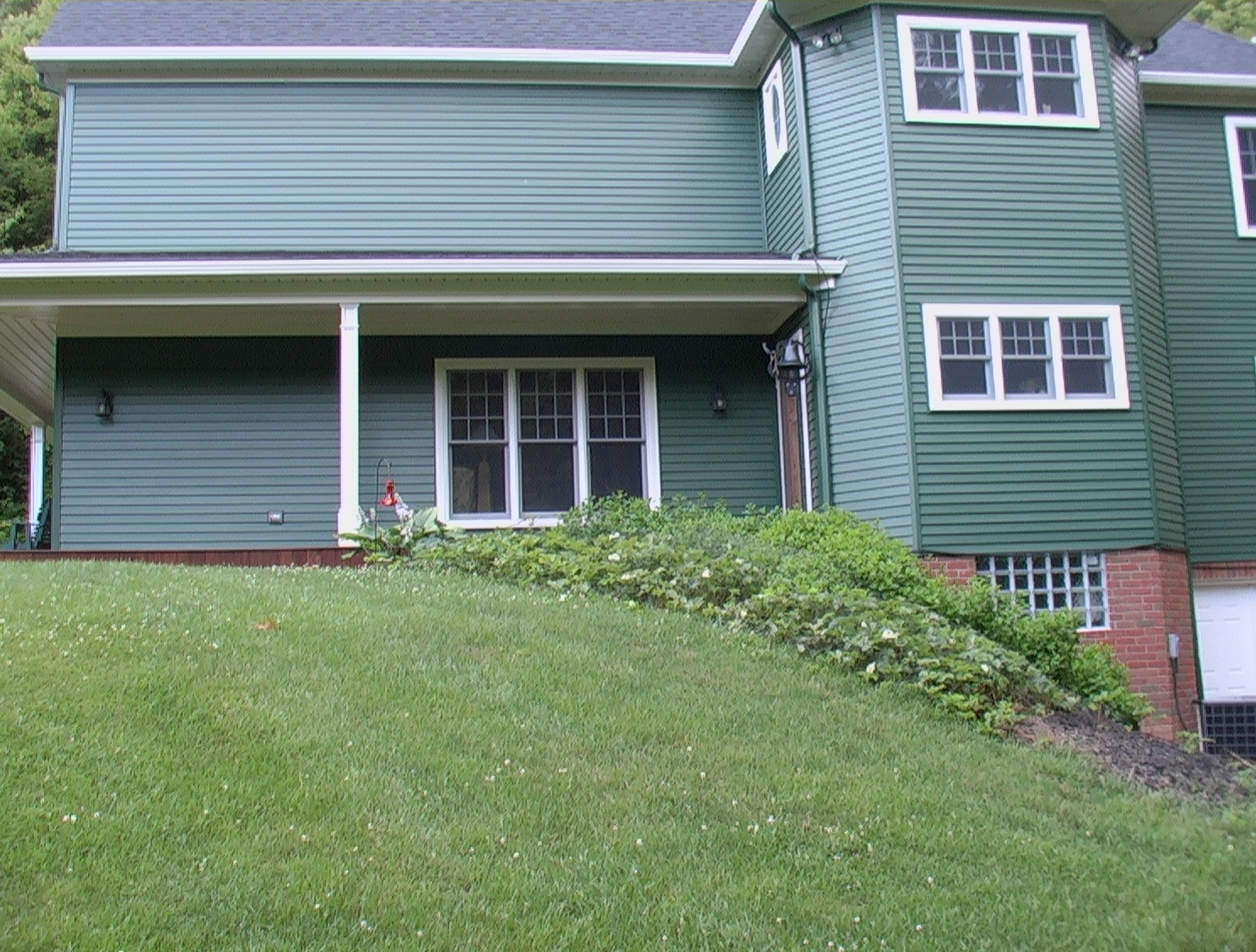

With the patio portion of the build done we set our sites on the outdoor kitchen. The first detail was to pick out a location. We decided on the area directly off the kitchen in the house. There is direct access via a door off the porch and it would provide a nice view down onto the patio and fire pit.
/ Patio/Outdoor Kitchen Project
#14

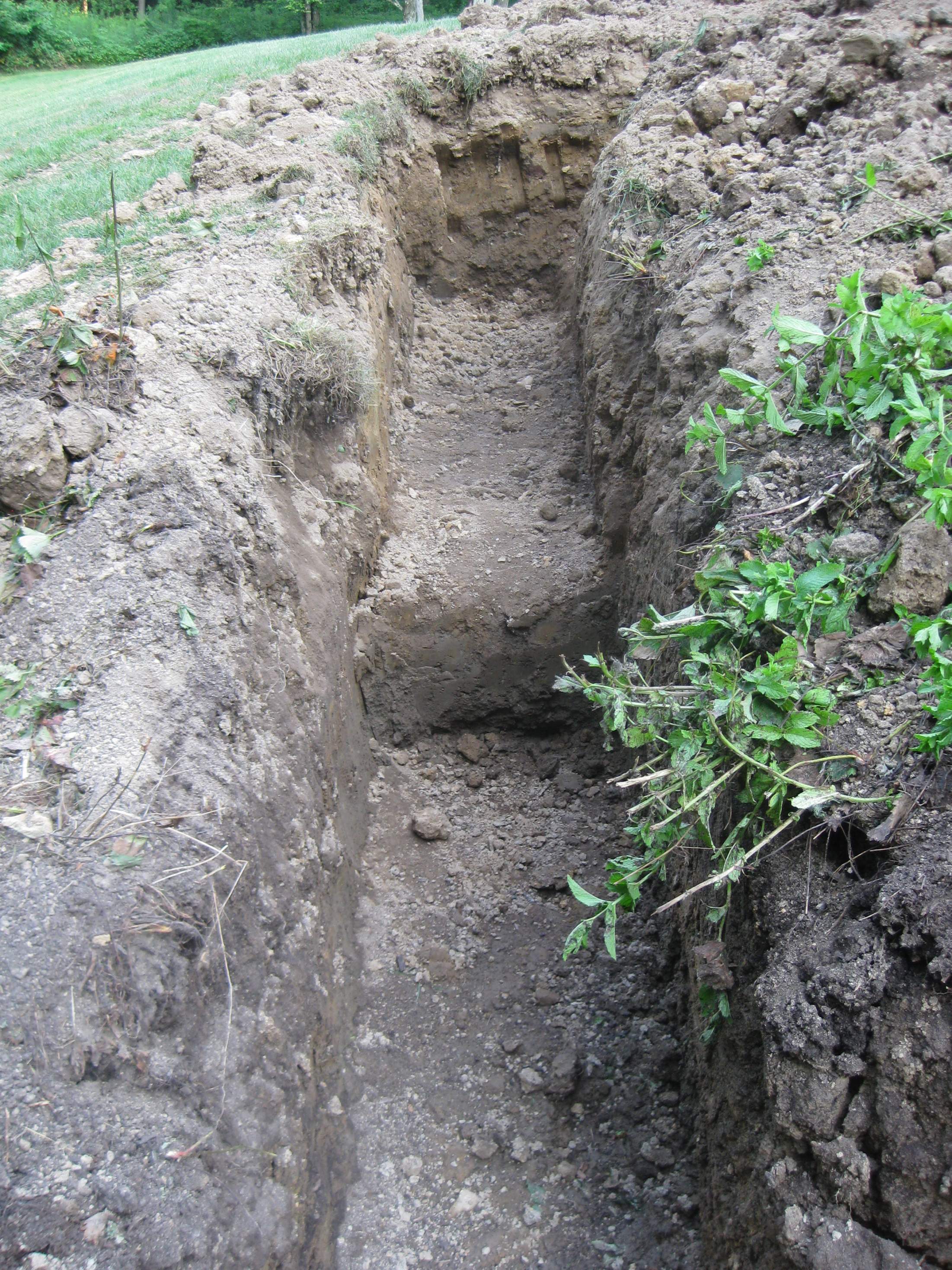

First we had to decide whether to stick with the decking board theme for the outdoor kitchen or go with something different for the floor space. The deck around our house id made of Ipe wood. If we kept with the decking theme it would have meant buying enough Ipe lumber to cover 300 square feet. This lumber is not easy to work with and we figured that we would have a lot of weight on this floor space. For these reasons we decided to have a block wall and slab floor put in for the outdoor kitchen.
I was not at all comfortable doing this work myself, so I hired a qualified contractor to do the work.
First the footings were dug out.
Please excuse our dog Cody in the second pic:laughing::laughing::laughing:
/ Patio/Outdoor Kitchen Project #15
Nice job Polo,
Flagstone can be challenging due to their uneven surfaces but you must have taken time flipping and turning as it looks great! I like the way you covered the septic too.. I have always liked the hardscape better than decks for the outdoors as they are low maintenance and realatively easy to change/make bigger :)
Your outdoor kitchen project looks interesting too, and from the slope it would appear you will either need to lower it off the porch a bit or build another retaining wall?
Have you considered a terraced set of steps tying the two areas together along that bank?
Also on the outdoor kitchen do you plan a trellis or framework around the cooking area for inclement weather cooking/shade?
Looking good!
Carl
#16
More footing pics

Thanks Carl,
Yes, the floor of the outdoor kitchen will be at the same level as the porch. You will be able to see as I post more pics. It is taking me forever to upload pictures from my little wireless notebook.
A set of steps is planned, but that is work for this spring. I am planning on putting a roof over the kitchen. May need some suggestions from the group here on how to accomplish that.
