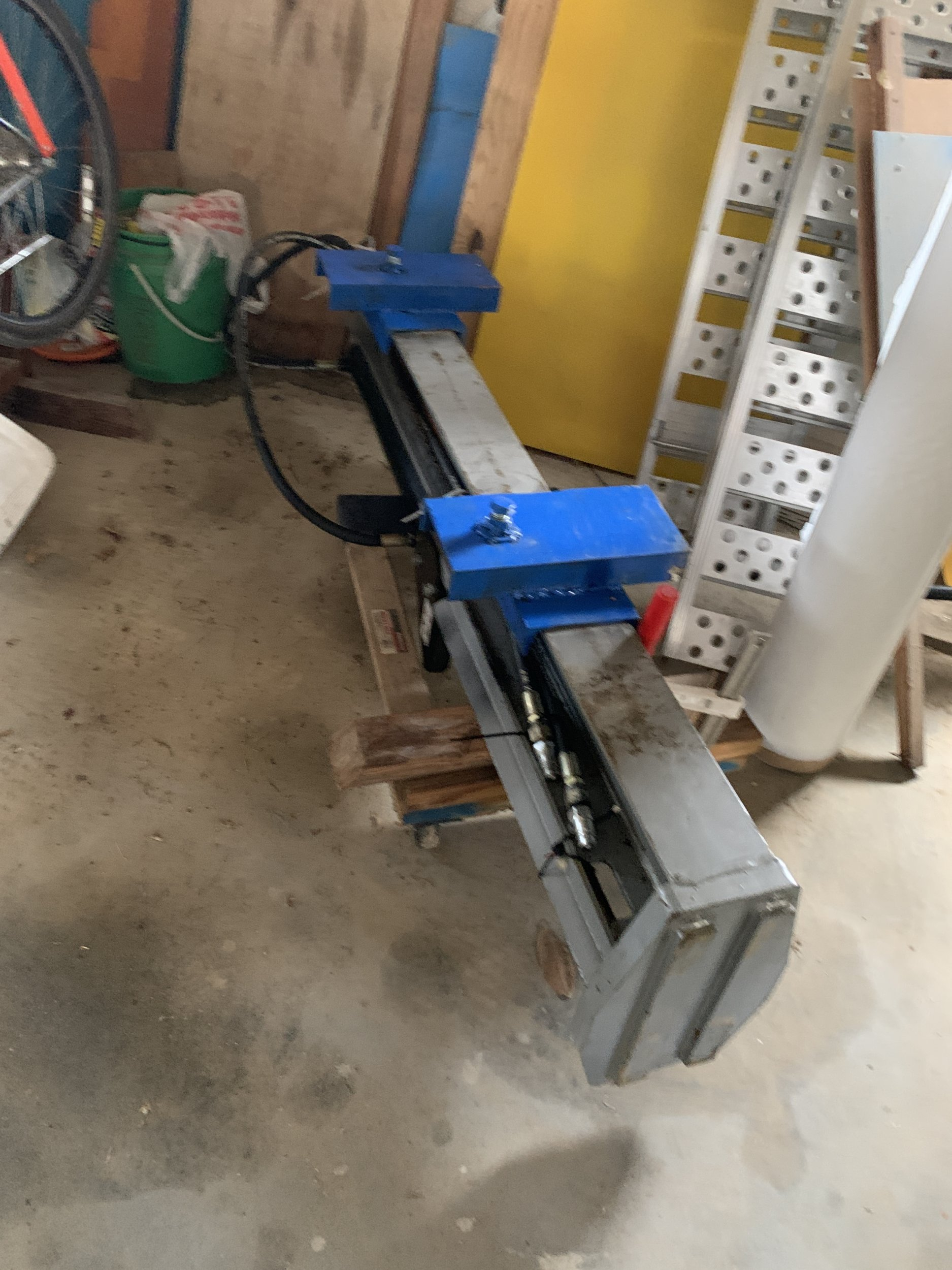

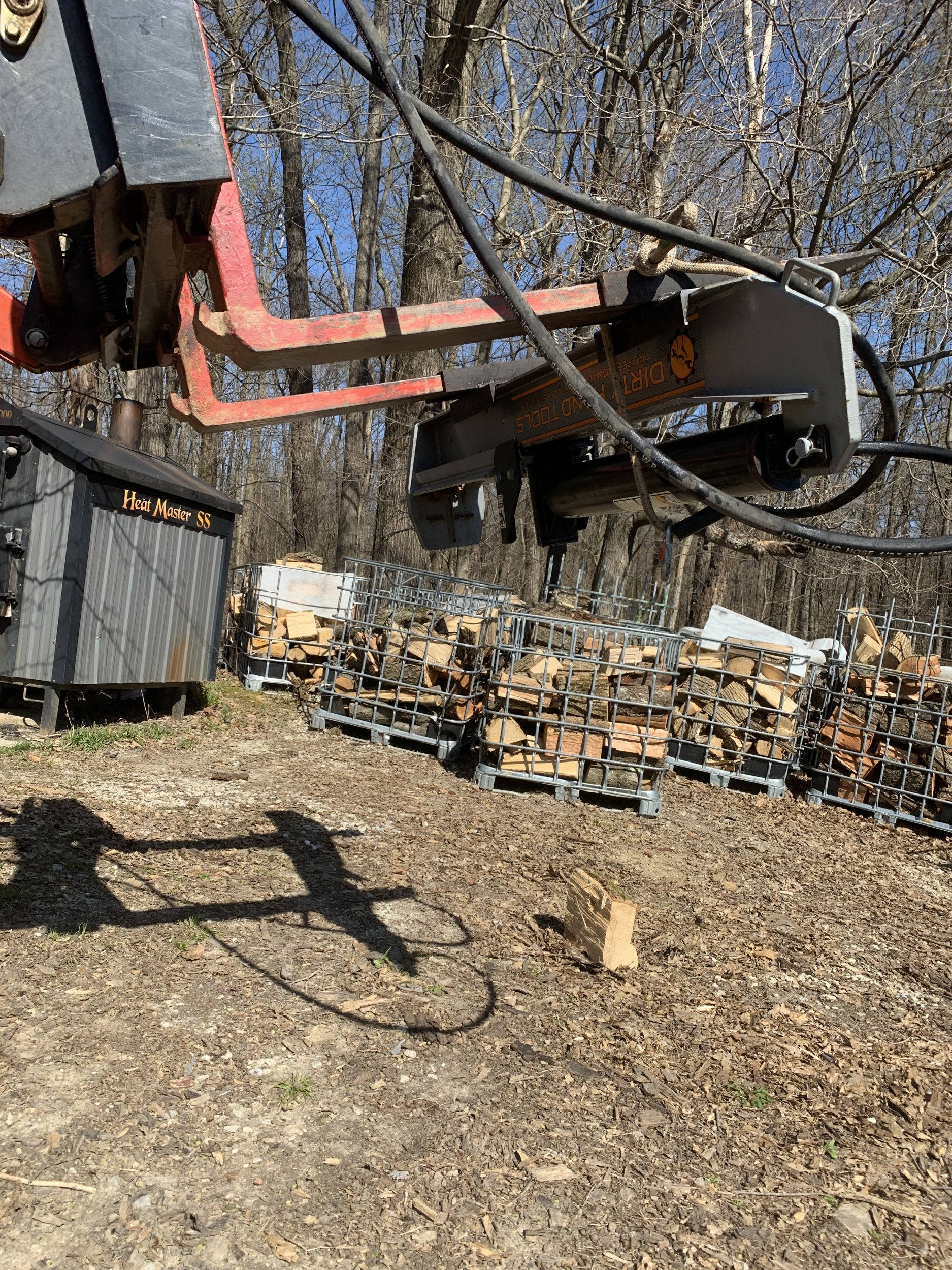

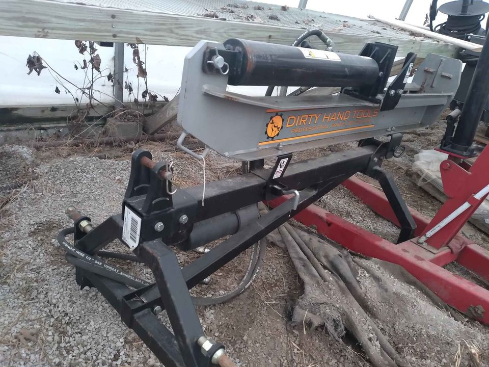

I ran across a picture of an inverted log splitter hanging from pallet forks. I found a 3pt log splitter on the internet for sale. This particular model was bolted to its stand. I unbolted it from the frame, removed the hydraulic plumbing and turned it over. I used the same holes and welded 6" C-channel to make the holder for the pallet forks to slip through. I added 4ft hoses and quick connect hydraulic connectors to attach the hoses on the front of the tractor.
I was able to stand a 4ft hard Maple slab on edge and split it -- it broke right in half. I still have to get on/off the tractor to position the pieces -- but this setup has been very useful.

A skidsteer version would probably be handier -- less off/on the driver's seat to position the wood pieces, but this works and can split stuff that I couldn't split otherwise (assuming I cut it down to fit within the opening first).

We have one very similar except mounted the pocket parallel to the ram. line up all the big rounds in a row, and split them until they are a manageable size for the normal splitter. How do you find the cycle speed running off the tractor hydraulics?

What's the cycle time on that?
/ Pallet fork Log splitter
It is pretty slow, probably 30 seconds. And the getting up and down from the tractor seat to line up logs adds more time. I can usually line up 2 or 3 in a staggered row. I use it on pieces that are unsplittable by any other means. I have an 8hp splitter that is faster but that means I have to do more wrangling. I have used the tractor to lower large pieces onto the log splitter in horizontal mode -- and the split. That is also a lot of up/down and when things split, they tend to make me jump out of the way to avoid getting hit or my toes mashed.
So -- I'm willing to trade slowness for safety.
