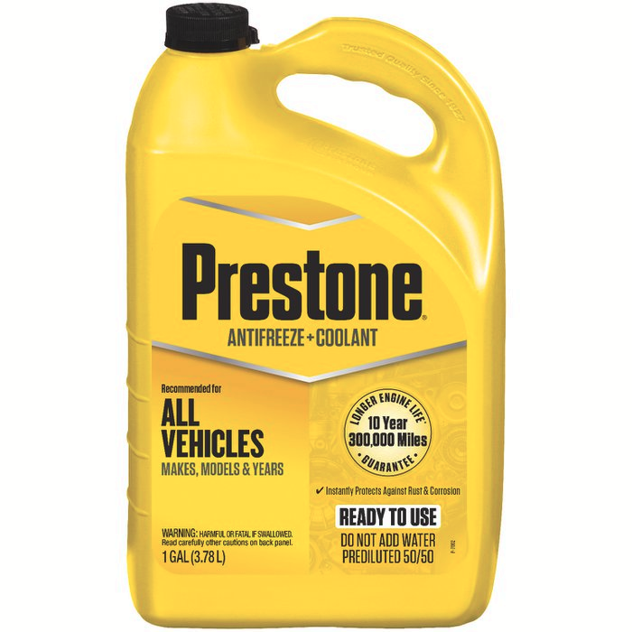

I too would agree. You can't even find the old school green coolant anymore.
Prestone makes a non-long-life formula for, All Vehicles and All Years. Its the closest substitute for classic vehicles and machines.

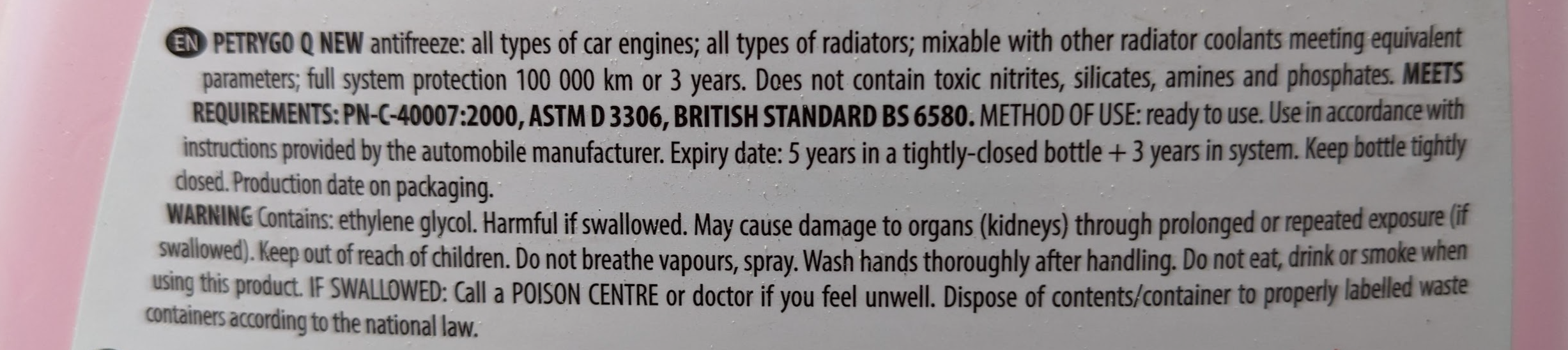

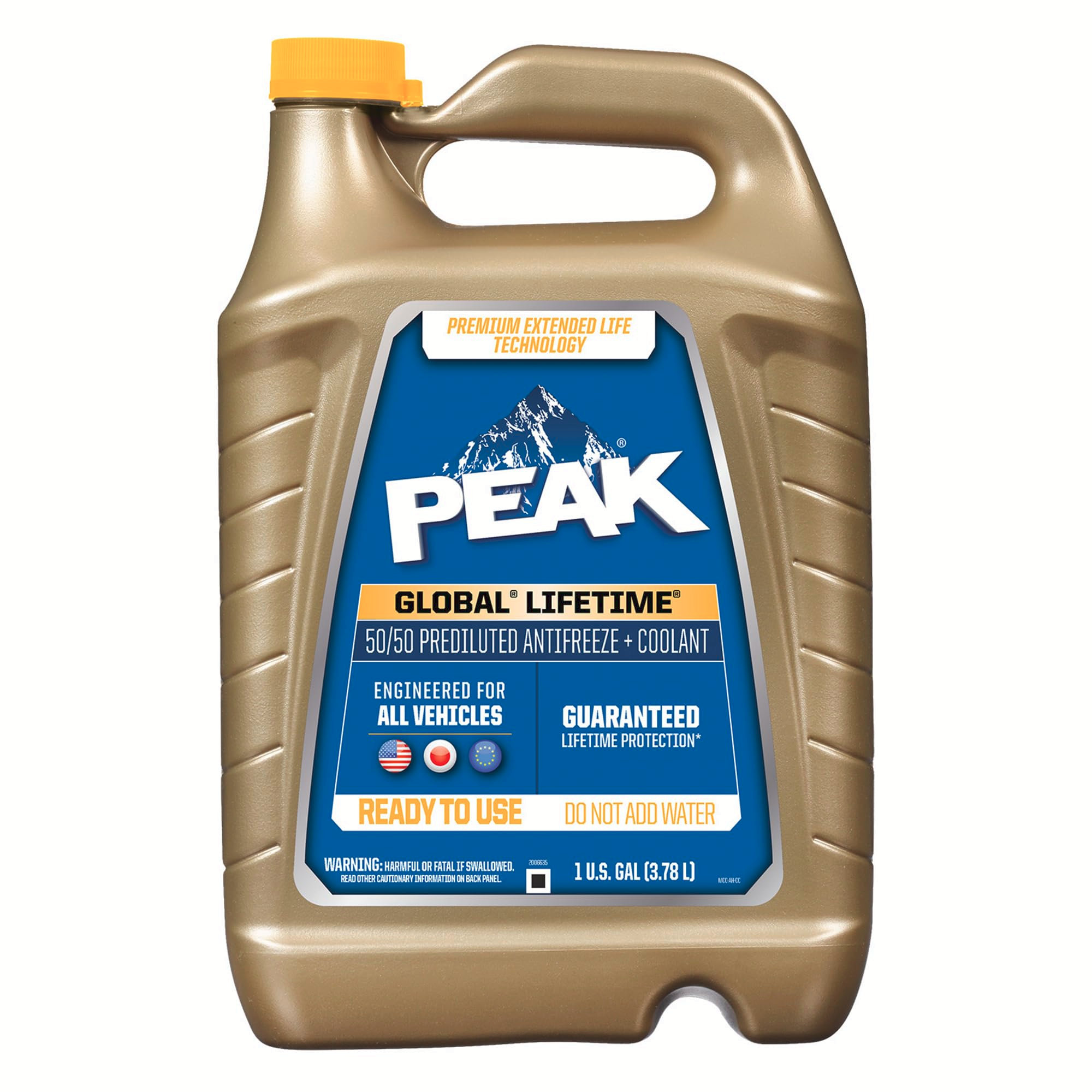

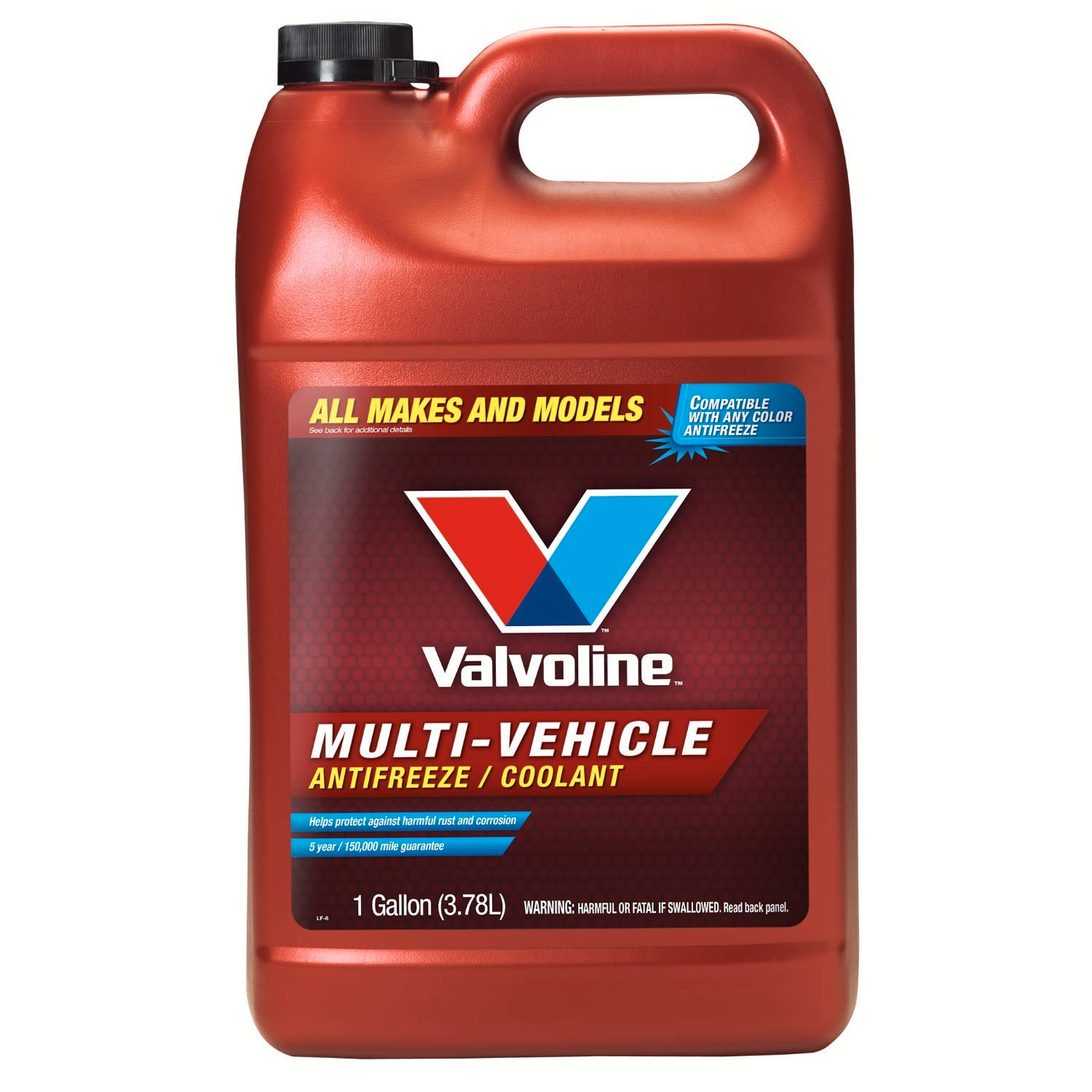

Some of those longlife coolants, like the poster images above have a limited shelf life in the bottle. Those coolants I would avoid totally. Yes, you are right, they get exposed to air with too much nitrogen and turn into SLUDGE ! Sludge will not cool any engine! I only use DI, distilled or twice RO water in a cooling system.
Ashland-Valvoline has this one, but I've never seen it in my area,
And PEAK,

Distilled water is steam vapor collected on a stainless hood into a stainless or glass basin.
DI water is De-Ionized. You can look up the process.
RO is Reverse Osmosis, going thru 2 times.
The three shown are the ones out there for ALL VEHICLES, FOR ALL MAKES AND MODELS. Meaning they are acceptable even of the old classics. These formulas are safer to use in the old systems, like your El Camino.
To flush out WELL TAP WATER, you will need to also use C-L-R. Well water is known to contain all kinds of things. My place runs both a sediment filter and then a 2-micron filter before the holding pressure tank. It's not quite RO.
As for preference, there is only one on the shelves in all the box stores, the Prestone. It in Walmart, Menards, AutoZone, etc.
The trouble maker coolants are the ones with For GM vehicles only or DexCool type formula. In fact the original GM DexCool formula had several Class Action Lawsuits for making sludge and destroying engines. GM with other woes then did a bankruptcy. The court then agreed with GM and gave a $500 voucher towards a purchase of a new GM vehicle as restitution. For the 17-million vehicle owners in the Class Action Lawsuit, it was the last day they would ever own another GM product. In fact, the boycott was very strong for a few years even after that. Only the 2nd US gov bailout saved them. Out of the 17-million owners, many were their own UAW and engineering employees. Entire generations of GM families walked away, swearing never to own their products ever again.
The original GM DexCool was also used in a few other selected vehicle brands outside GM too.
... and now you know the rest of the story, good day! -Paul Harvey

bmaverick, Thank you for the detailed explanation and the clarification of the 3 pictured bottles. The advice of the CLR usage when flushing is also appreciated! I have the Prestone fluid on hand. I also have my well water to the house reverse osmosis & filtered, but I'll just go buy some distilled to be safest. I appreciate hearing "the rest of the story"! Greg
