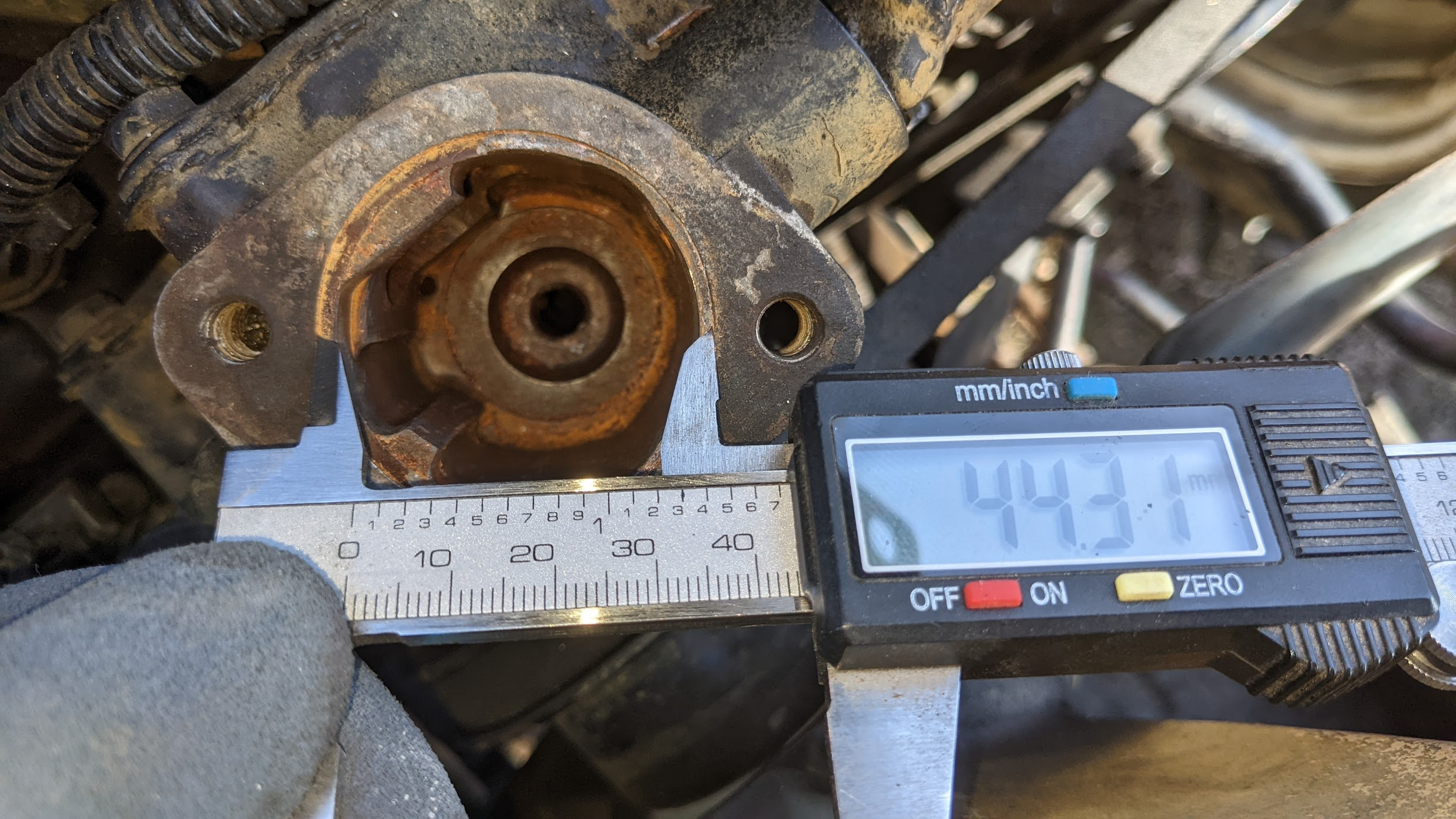

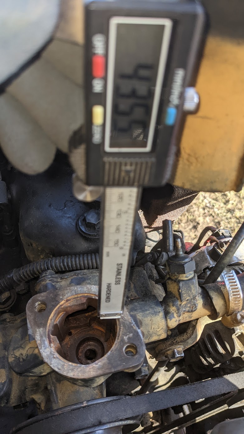

Do you guys know what thermostat will fit to Yanmar FX24D tractor? Or where to check it?
I've unscrewed the hose where a thermostat is placed and measured the diameter (44 mm) and depth (43 mm).
But what's left to check is opening temperature the thermostat should have. Is it 71C (160F) or 84C (183F)?. Does it matter much?
Of course I was searching the net, but there's no consistent knowledge about it.
Photos
View attachment 872769 View attachment 872772
84C (183F) is correct. (y)

Thanks guys for your replies. I will consider all your advices. As of now I bought the thermostat, which fits the following Yanmar engines: 4TNE88 3TNE88 3TNE84 4TNE84 4TNA78 3TNE78 3TNE68. It opens by 82 C (180 F).
My engine number is 3TNB84-UA and I couldn't find the thermostat exactly for it (by number), so I took a chance nad choose the most similar (by look) engine 3TNE84 and bought available for it thermostat. Of course, I know that looking for a missing part based on the appearance of the engine is not necessarily a good idea, but the diameter (44mm) and opening temperature (82C) are right.
