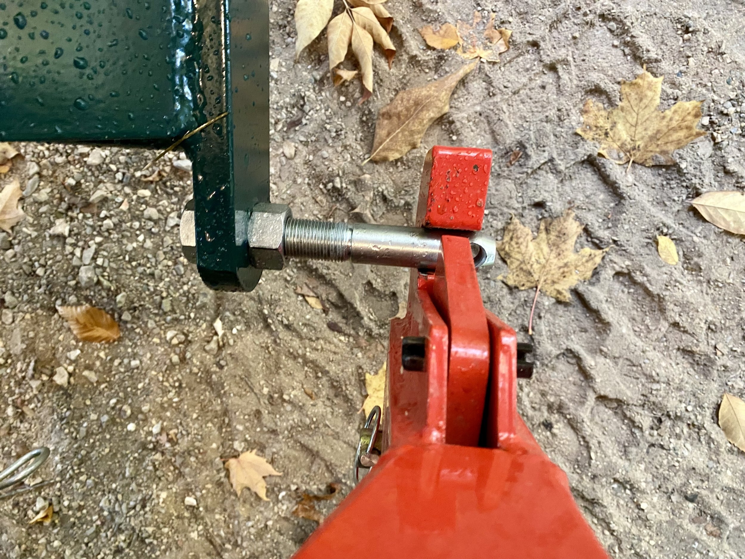

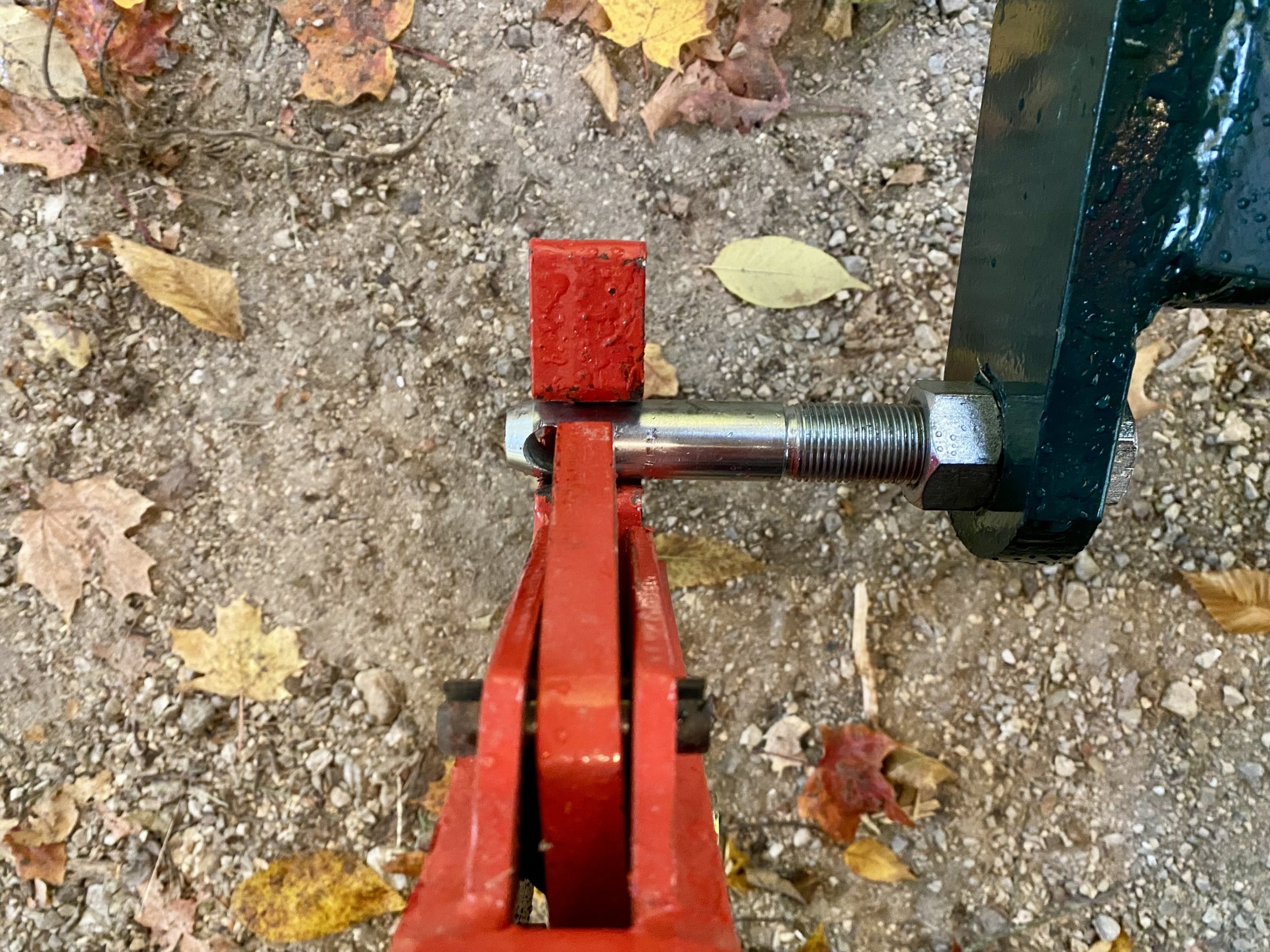

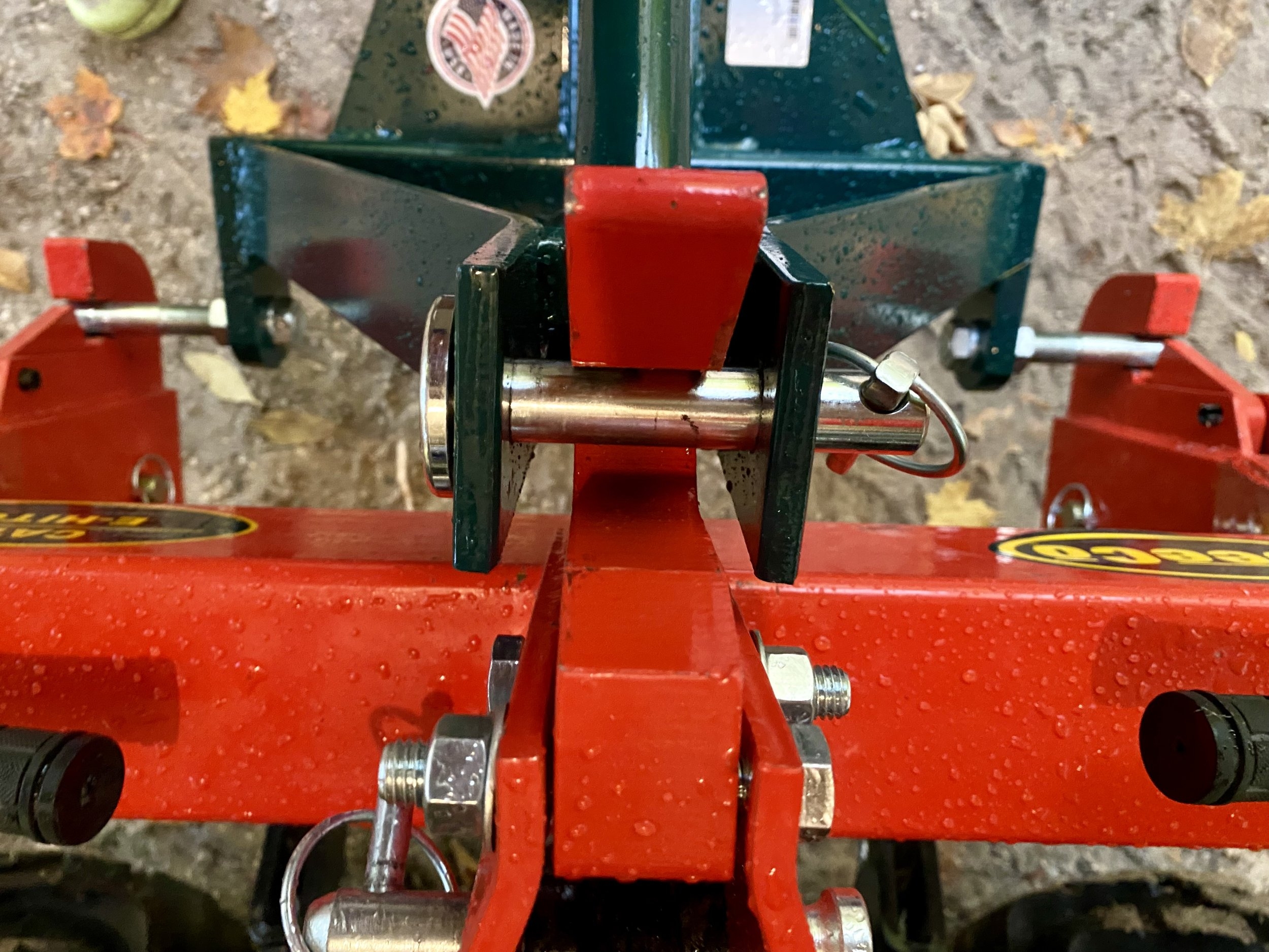

The “extra long” draw/lift pins arrived. They’re ~6.5 inches overall. They have two nuts not one, of course, which was key in this case.
Both the Summit LRX60 and RBX60 with these wider pins only overlap the SpeeCo QH by ~0.25 inch with the top link centered (see photos). That’s not enough, obviously.
So, I’ll keep looking for a better option.
(In the meantime, I‘ll try some bushings or, better, have a brace fashioned to address that gap. Maybe a simple U-shape drilled for the pins will strengthen the connection and take up some of that gap, which is substantial.
Had I done thorough research, I would have gone with a true Cat1 blade and rake route. In fact, King Kutter, the manufacturer, offers true Cat1 options of both...alas, they’re not available in Harvest (aka, Summit) Green ;-)

Put a piece of pipe over pins to close the gap.

Longer pins ain't the answer. First time you hit something with the blade you will have bent parts. I think it is time to get a different blade or re-fabricate this one.

Ultimately agree. I mentioned fabricating a welded-on brace that effectively widens/reinforces the existing 3-point attach points.
The wider pins obviously have a huge drawback if used on the QH as you pointed out. But they do have one benefit: quickly moving the implements around for storage/organization.

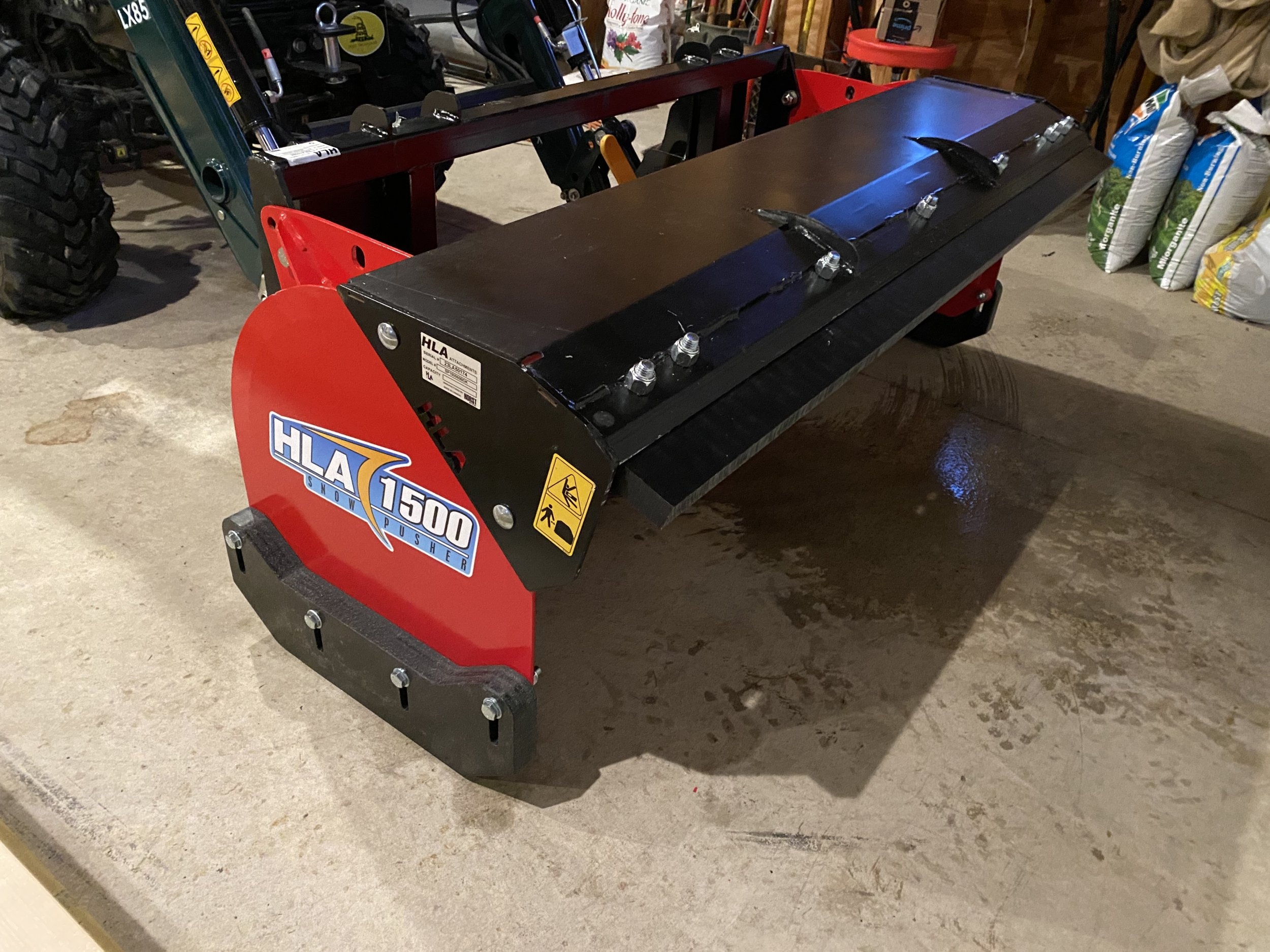

Hi, MAX-24-Dean.
Thanks for your question We haven’t had much snow, so I don’t have any feedback yet.
One suggestion, if you order from Good Works Tractors with UHMW consider ordering it assembled.
When factoring in the cost of the hardware, which isn’t included, and the time it takes to drill out the UHMW, paying GWT $150 to deliver it ready to push snow is a bit of a bargain.
For those wondering what it looks like in red, here it is. Worth the wait, IMHO.

I installed UHMW Polyethylene on my HLA straight plow and really like it. Last year added custom side plates with the poly edges to see if I can get by without a standard push box... No snow since I installed them.
Although the back drag pusher option is real appealing, every time I think about it I conclude I'm better off pulling snow away from the garage or cars with the rear blade for 20' then pushing it with the front plow. No turning the tractor around.
@isleview I do like that snow pusher setup! Is it 6' ?
