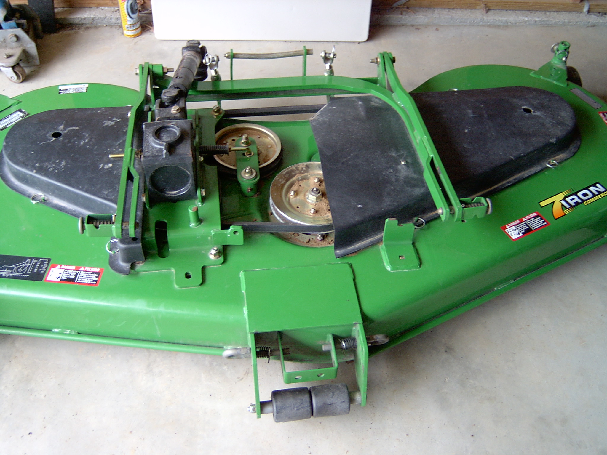

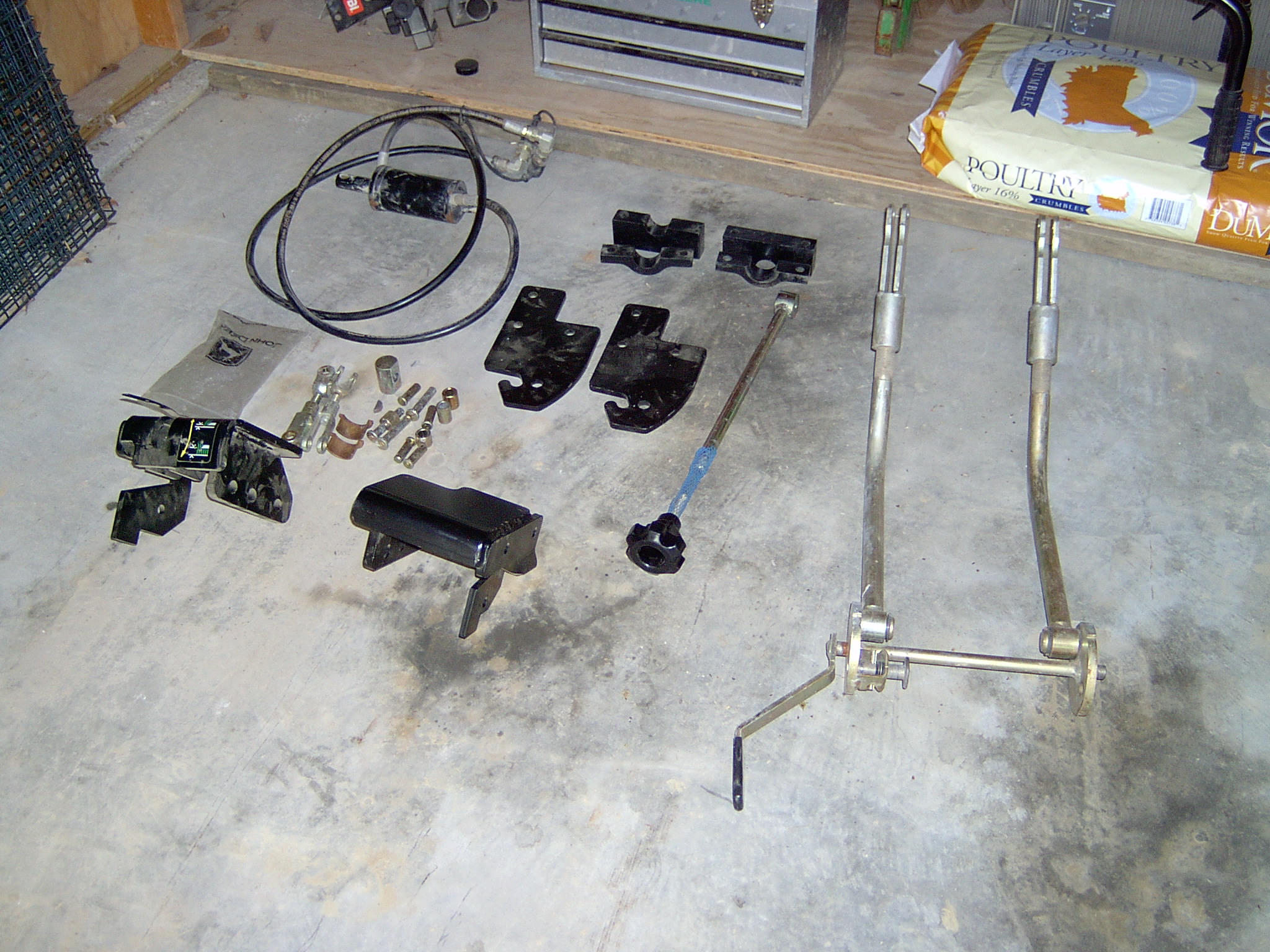

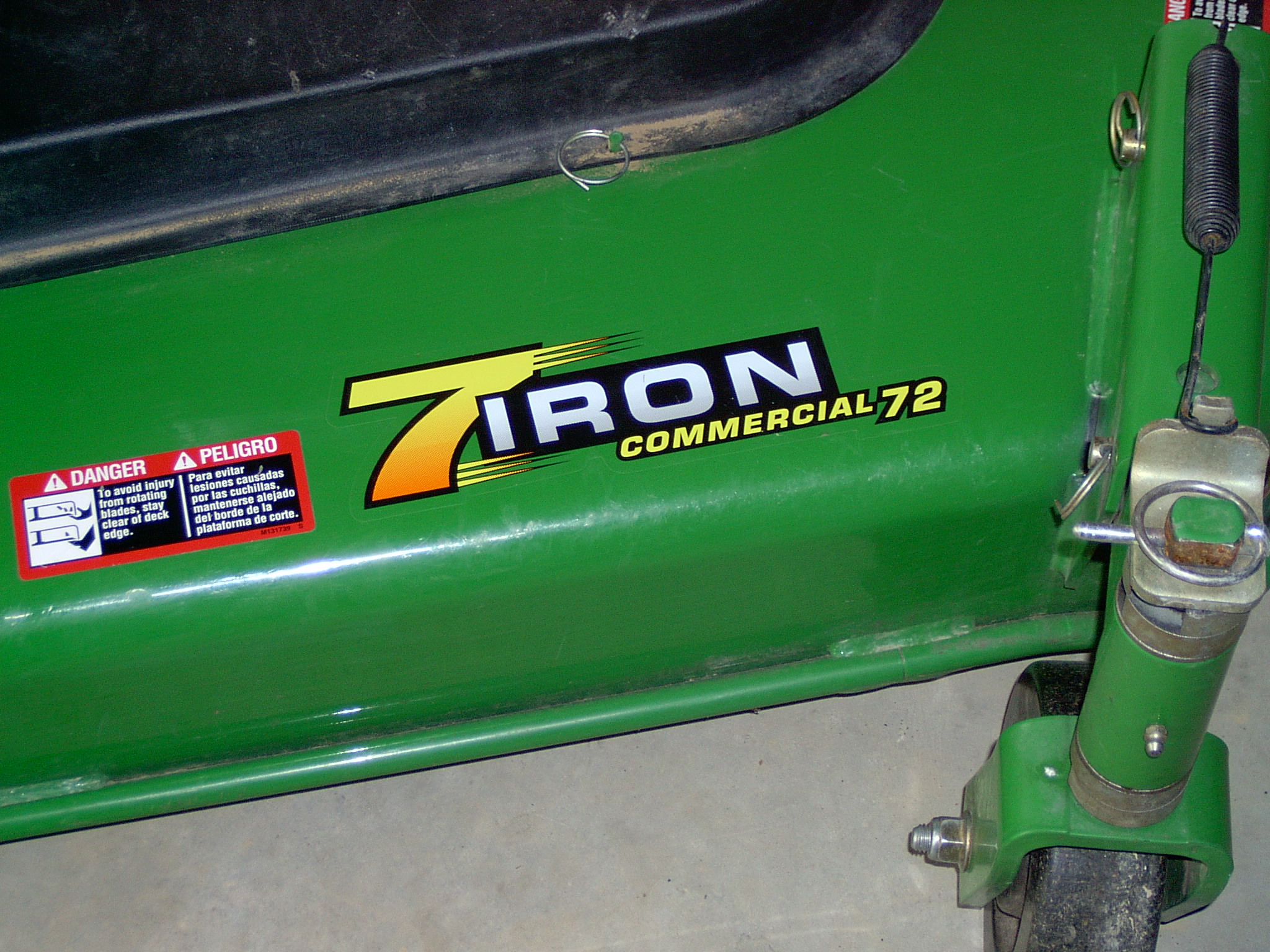

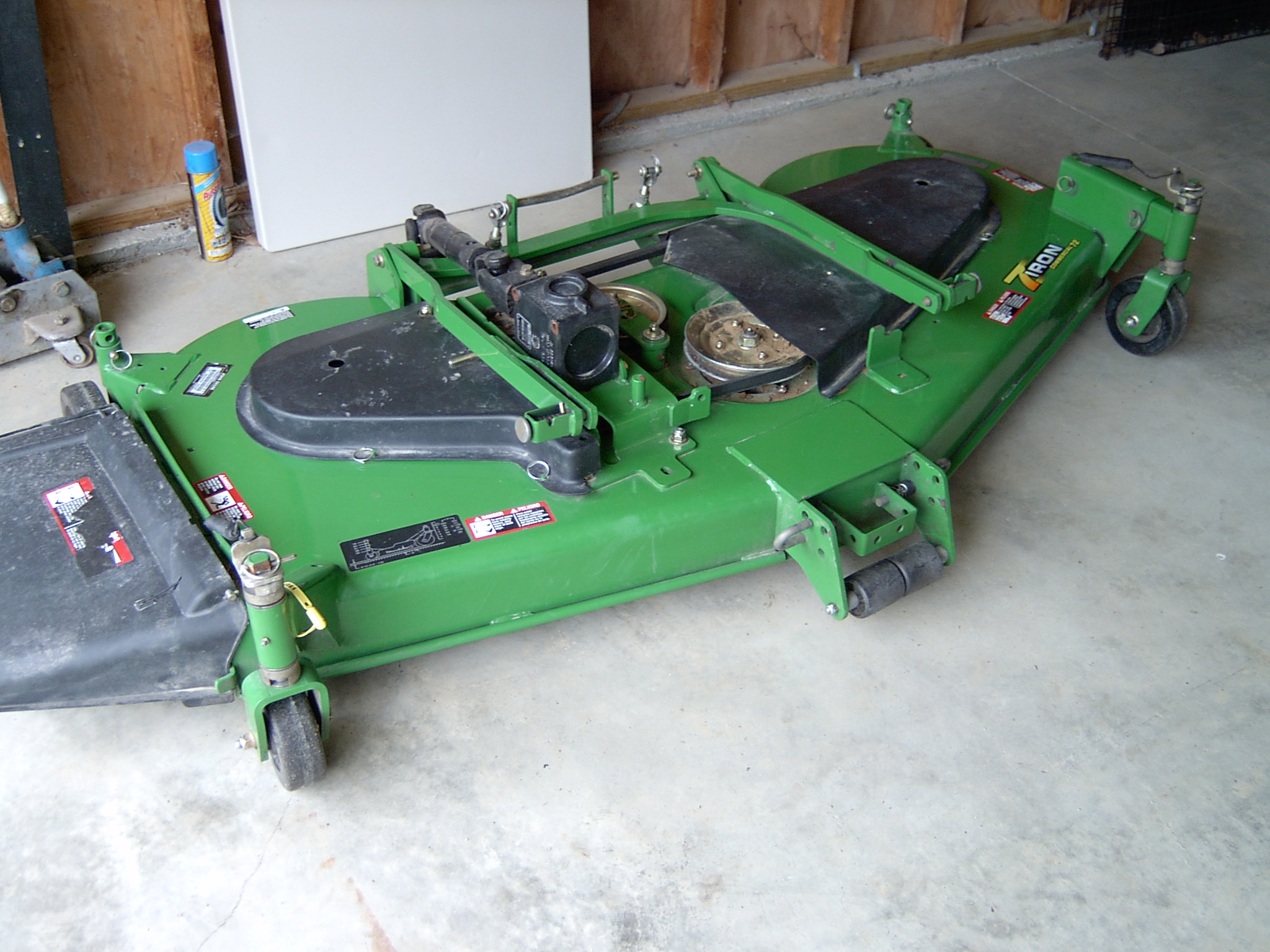

Just got back from the JD dealer with my deck. I was quite surprised, it looks almost brand new. They had everything to put it on my tractor except the rockshaft bracket. They couldn't find it. Dealer said they must have used it on another deck. So he ordered me a brand new one and will have it shipped to my house. I'll have to wait a few more days to mount it. Here are some picks..
