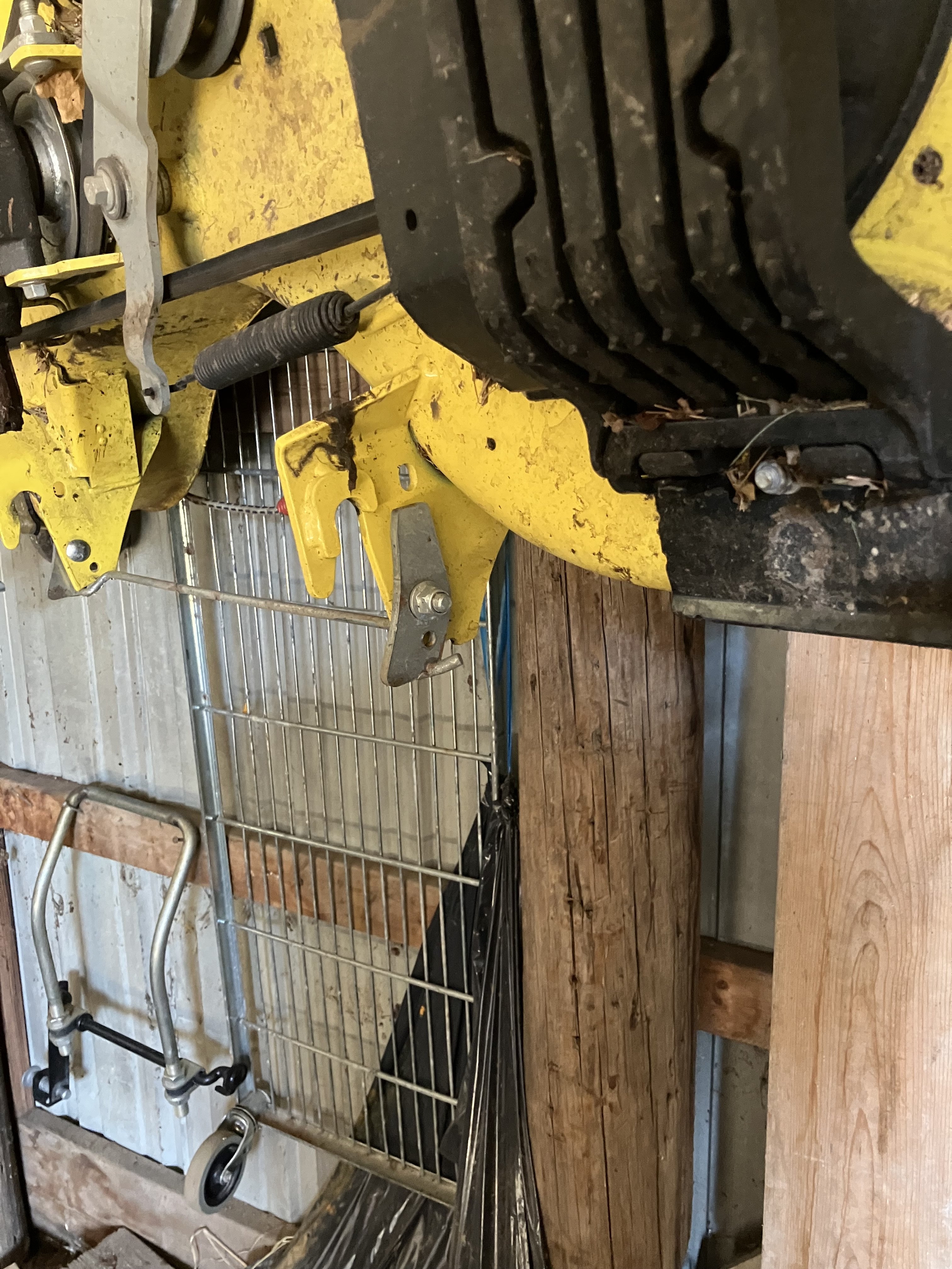

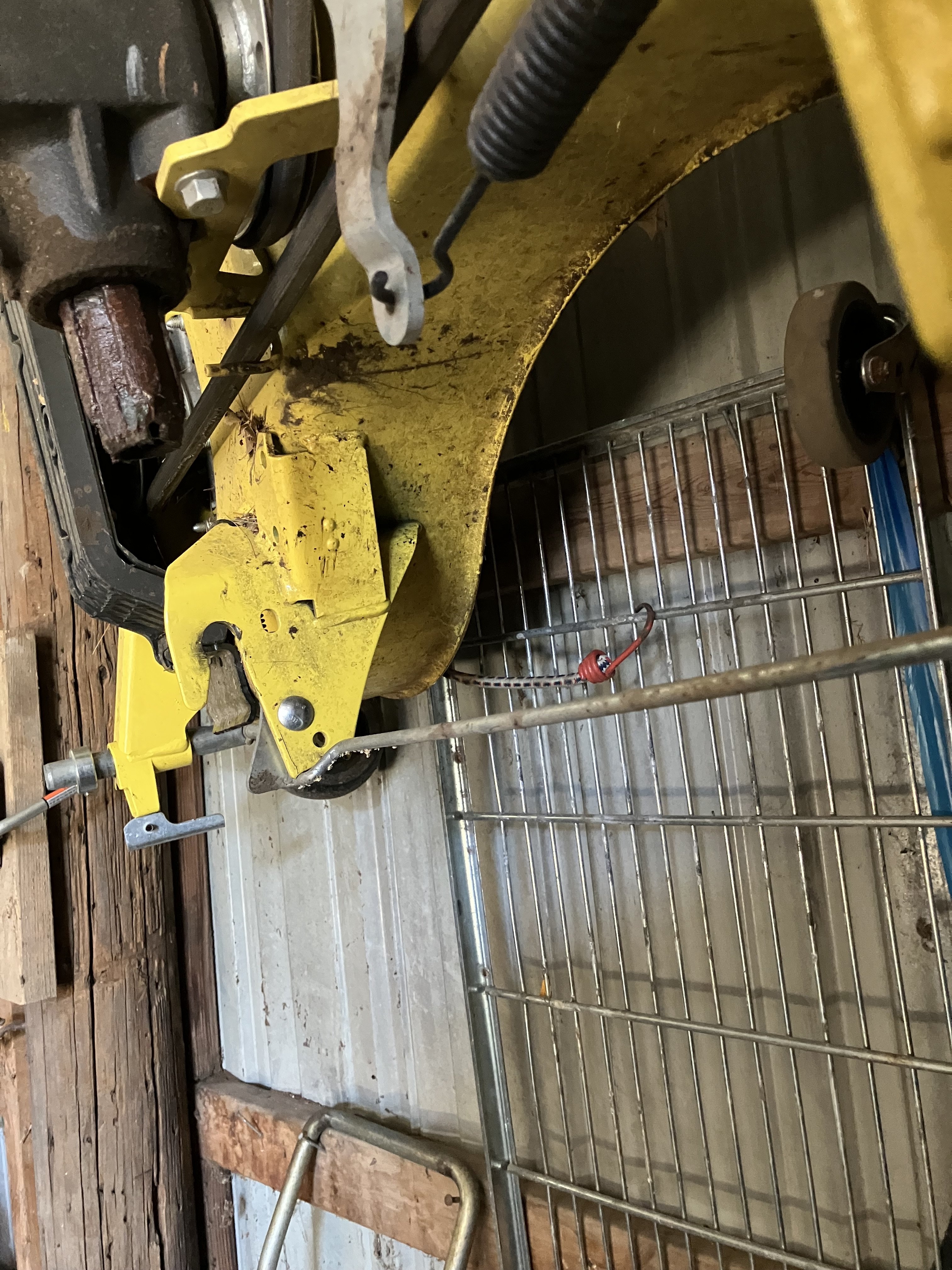

Here is a photo of the rear connections on my 54HC. Deck is hanging on wall of machine shed and photography is not my strong suit.
This is also the quick tach version for PTO. I don’t think that makes any difference on deck mounts though but could be 110% wrong in that belief.

Oh, Thanks (!) for those photo's, Oldnslo.
I see the difference now.
These are the new style where the lift arms are joined by the bar across them and it hooks into the deck mounts as you drive over. (Similar to a 1025R that I'm familiar with)
I see how the different brackets on the deck will need the different lift arm assembly now
I wonder if I can fit the new lift arms to the old X595.
You've saved me a trip to visit the X758 I was going to look at.
Thanks again. Most helpful.
