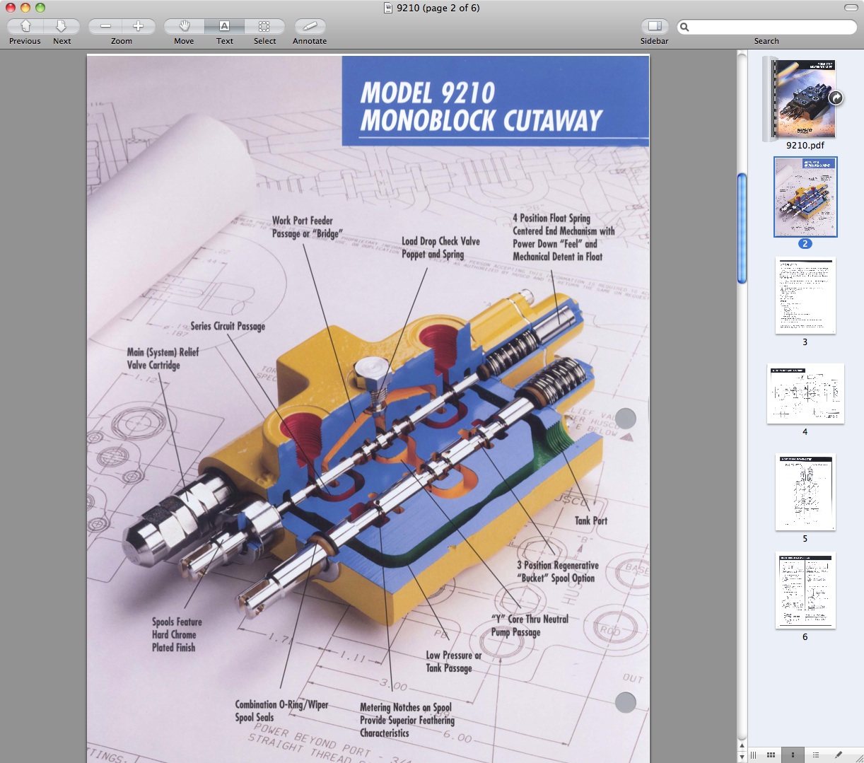

Do you have the valve schematic for your tractor. I suspect that in the "Float" position Ports " A", "B" & Tank are connected. Pressure continues to flow out the power beyond beyond port. While in float The oil being forced out of the base end of the cylinder is directed to the rod end and the excess flow is directed to tank. To prevent cylinder rod end cavitation the spool could be made to provide some increased flow restriction to tank while in the float mode.
my :2cents:
/ OK to use Float to lower bucket? #18
my :2cents:
I normally can read hyd schematics but mobile equipment valves for me can be confusing
I see no restrictor in the loader valve itself
/ OK to use Float to lower bucket? #19
WDCHYD,
You are correct the schematic does not show any restrictions but it does indeed show that "A", "B" & "T" are are all common while in float(position closest to the handle). Most valve bodies the center port is pressure, ports on either side of center are the "A" & "B" ports while the two end ports are Tank lines. Whistling oil noise could be from the oil being ported from one end of the spool - casting assembly to the other via the tank core connection.
Attachment below is a sectional view of a Husco 9210 loader valve. It may help show the oil path during float.
thanks for posting the schematic. picture is word a 1000 words.
