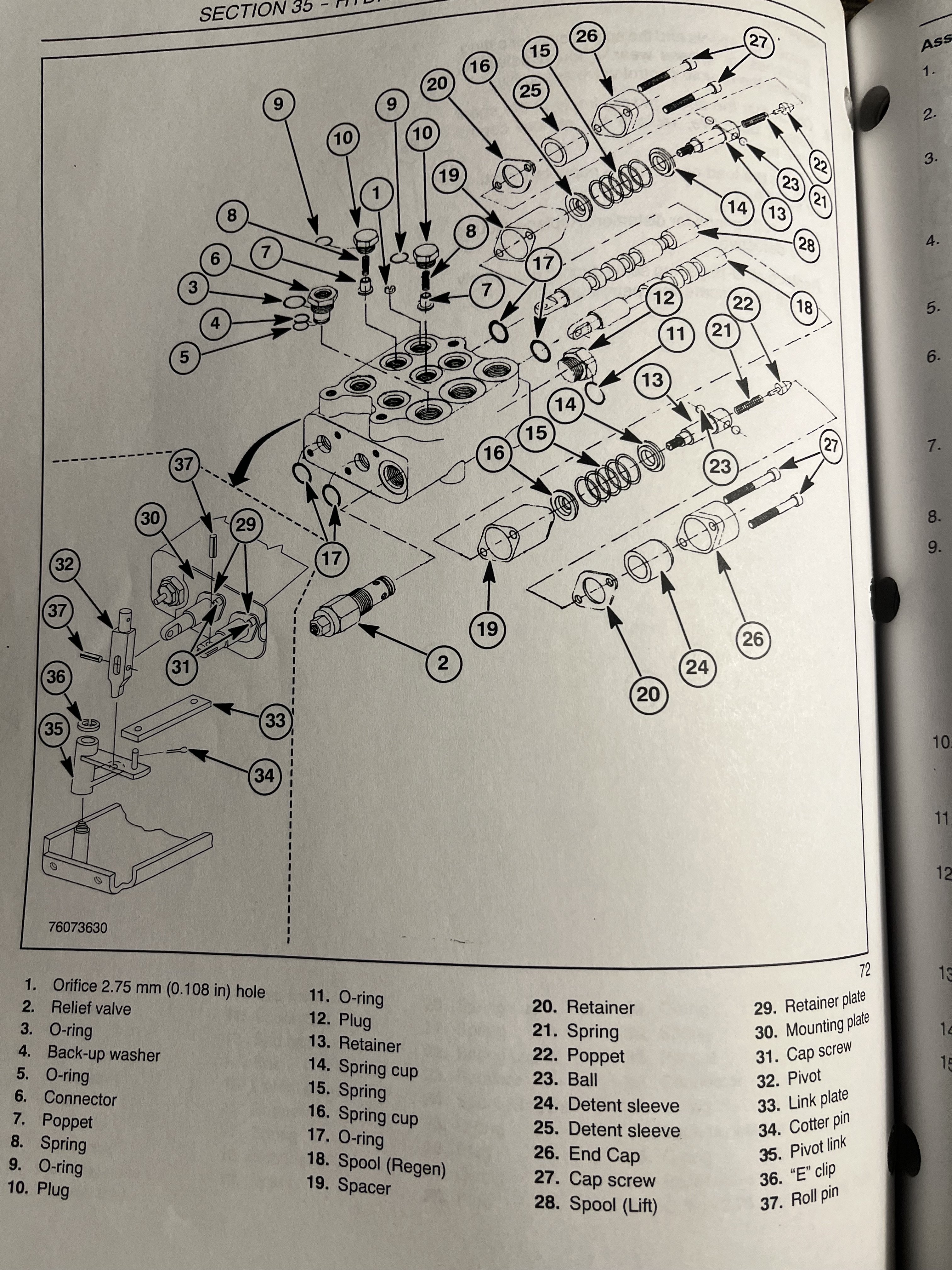

I have an idea if @rScotty's fix #2 doesn't work. Almost certainly the cap on that spool is a soft alloy, not steel. If so, over time, the balls could easily have worn away the "sharp edge" on the detent groove. Perhaps all you need is a new cap.
My T1520 has had this issue since I bought it new off the lot. I've always had to hold the stick in float and the detent is barely detectable when going into it. Stiffening 17 by shimming is kinda obvious isn't it?
Anyway, don't remove the cap by itself, lest the balls fall out. Loosen the two long bolts and remove the cap and outer sleeve to bench the sub-assembly. Be sure that 16 slides out with the the cap, sleeve, & outer spring all together.

Back to the detent and a possible stiffening shim, you have the advantage of me with the manual. Details of #17 and #18 are not shown. And as I look, it makes me curious about something else,,,,Why do you think that the cone, spring, and balls are also used in the bucket spool valve that does not have the ridge and and annular space that make a detent? For centering?
Shimming the spring is certainly an answer, but may not be the only one. The detent works because the balls are forced over a ridge. How many balls are there? How are they constrained? Can the number be changed? If so, would changing the number of balls accomplish anything?

Cone and four balls are also in the curl spool w/o a lip so that quick dump must be held vs detent to a fixed position. The cap sleeves are different between spools and could be switched with functions/connections but there's also an orifice to move over too. It's under a plug on the top of the valve by the capped end.
16, 17 & 18 are kinda crowded into the top B&W pic in post #4 with numbering arrows pointing to them. Here's another pic from the manual. 16, 17, & 18 are then shown as 13, 21, and 22 with 24/25 being the outer sleeves with groove or not. I call 22 the cone, and it's 21 that's weak and can be shimmed to hold the balls into the groove/lip more securely.

The KYB valve/info might only confuse us, & the old SB is in regards to that one. But in both cases it's the force keeping the balls seated that is lacking and the simple cure is to increase it with more spring pressure. That's our only and common issue.
Four balls in the Prince valve but only two show in cross section views, and what looks like a wedge is really cone-shaped. The balls on the curl valve don't have a detented position that stays, but must be held by the operator for rapid dump. Pretty basic and easy to overthink all this, but we'll get there. :)

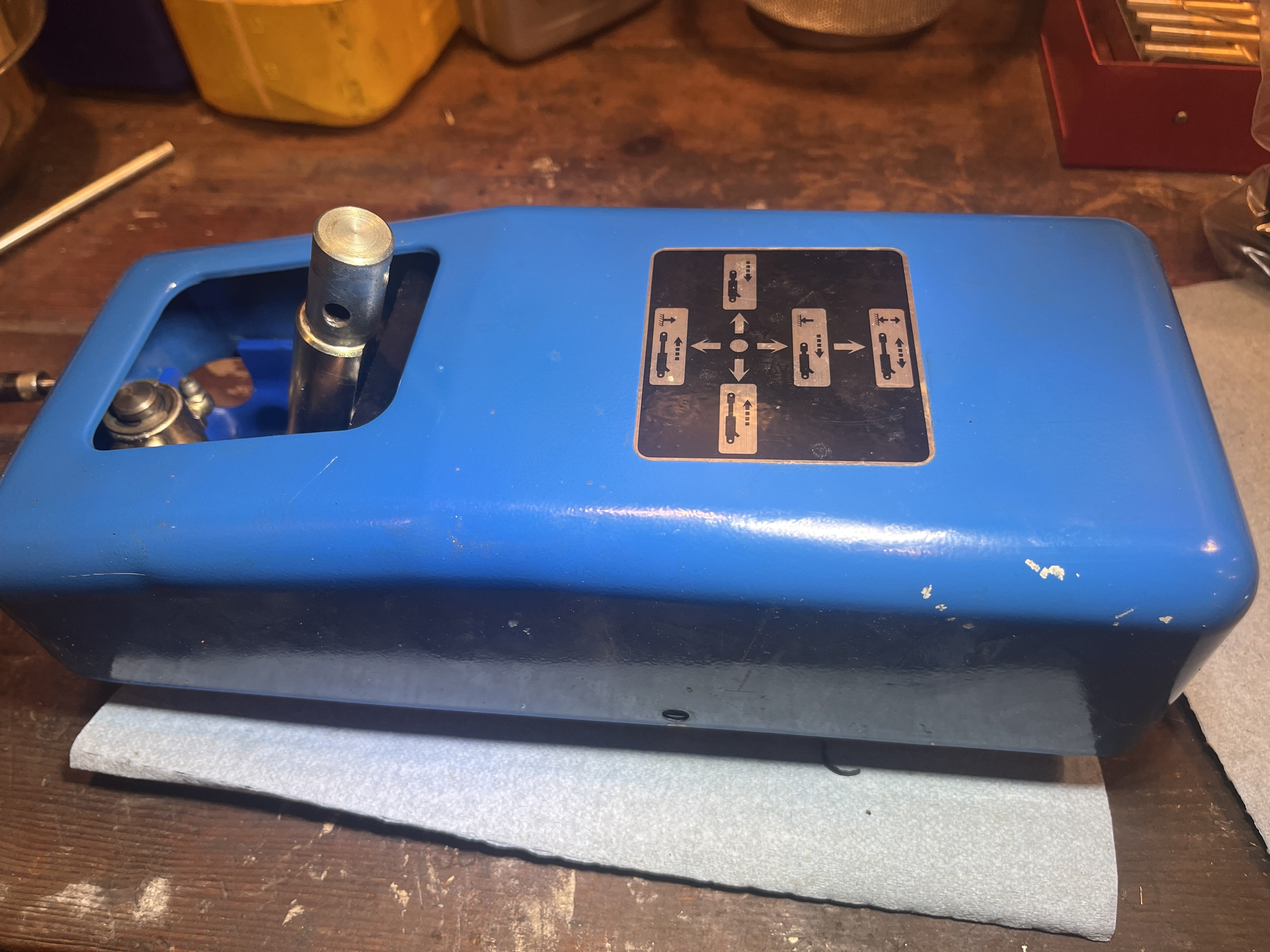

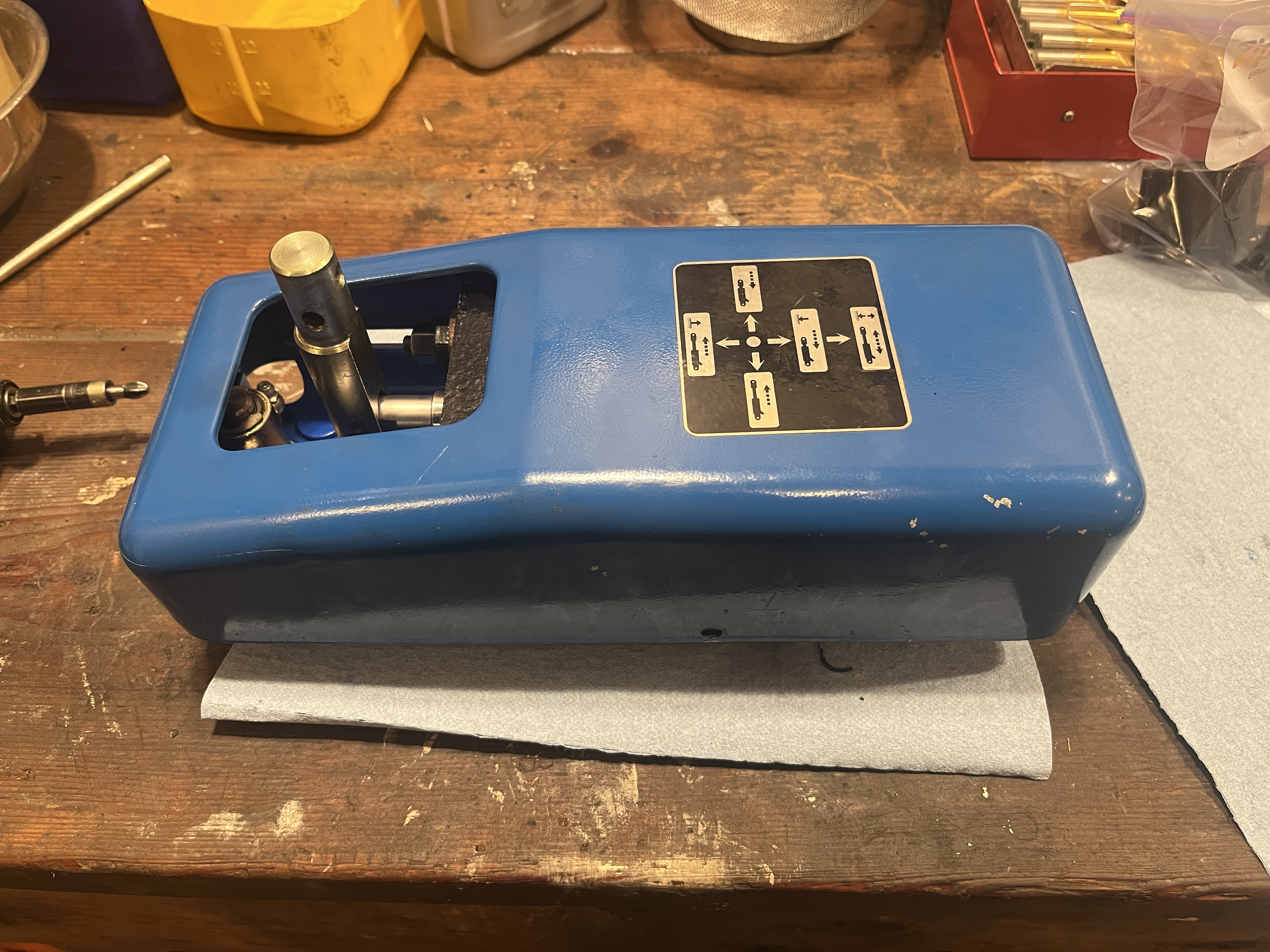

Regarding the handle clearance with the cover, I don't think that is an issue. Here are a couple photos of the valve with a cover minus the boot and handle. First is with valve in neutral position
Next is with the valve in the float position

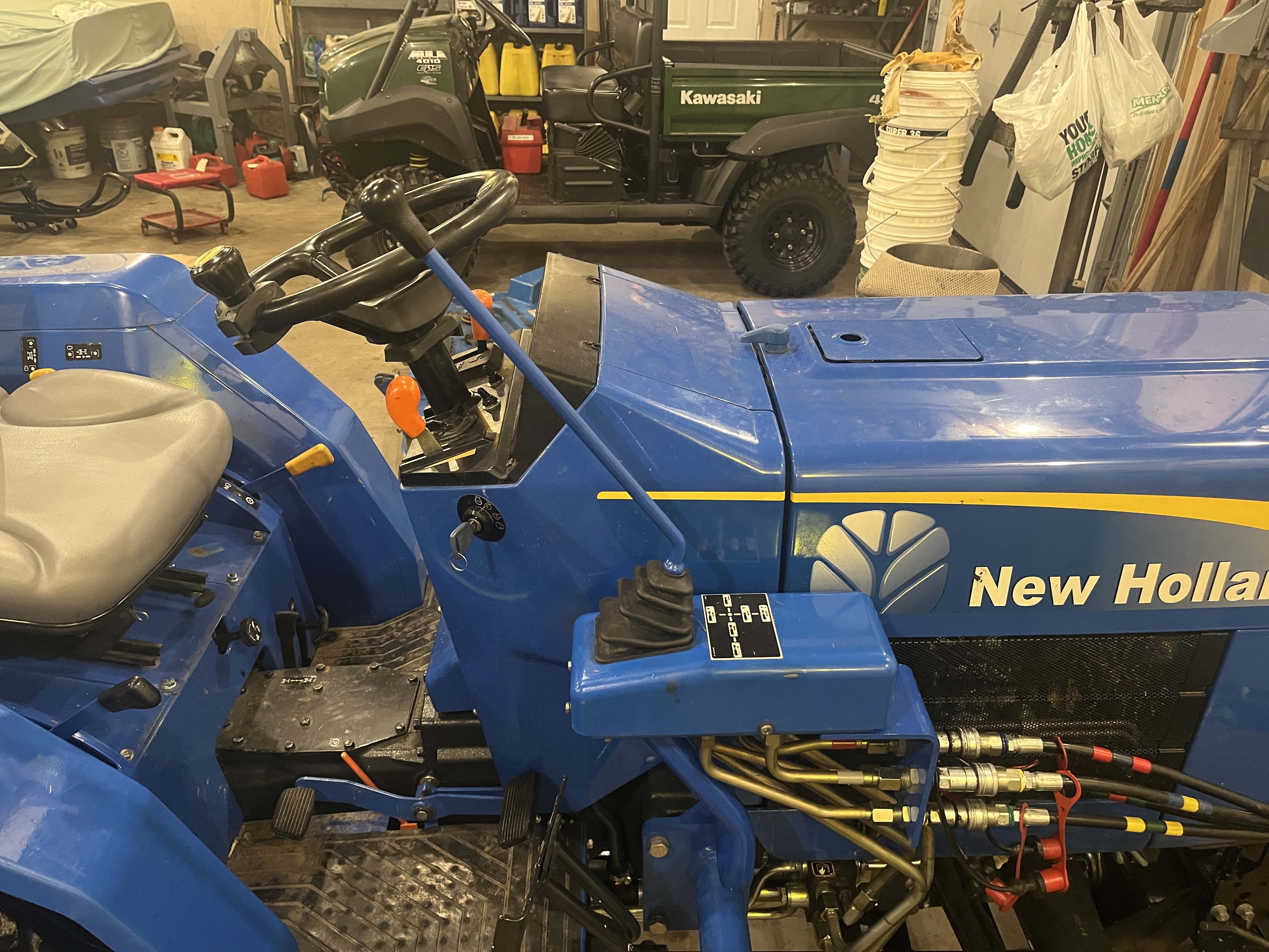

A thought that did pop into my head a bit ago, is whether the length & weight of the valve handle extension is helping to knock the valve out of float. The float detent feels pretty firm when operating the valve without the handle extension. The T1520 valve handle is about 19" long which is 5-1/2" to 6" longer than the handle on my old 1520 (with Kayaba valve fwiw). I know that it is enough longer that it is more in the way when getting on and off the tractor.
Nice idea. Will you be making up a lighter handle just to check?
