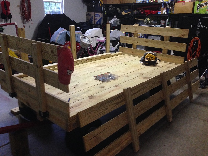

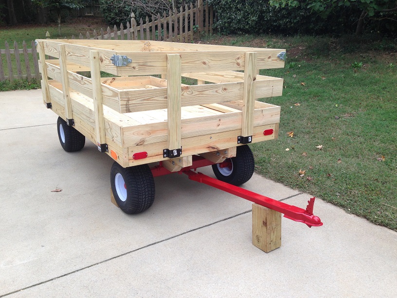

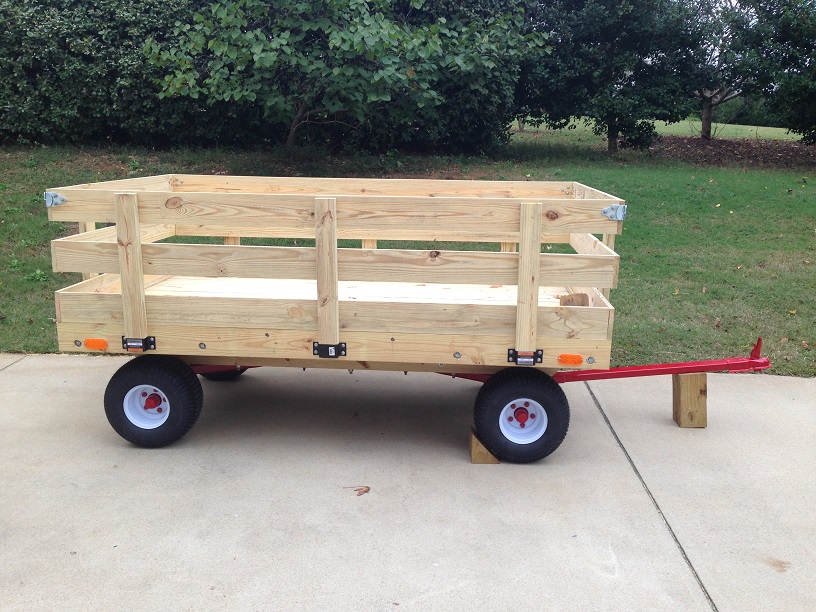

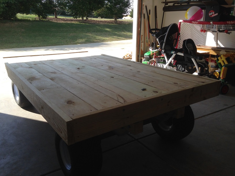

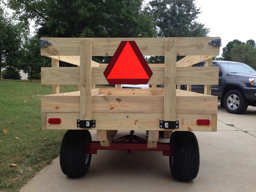

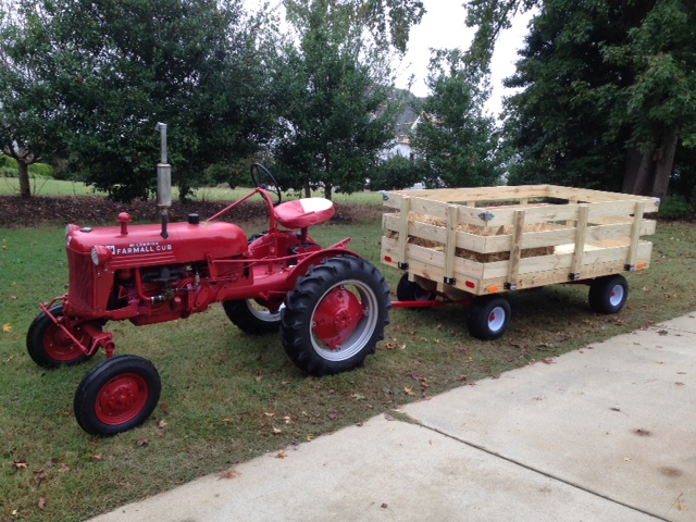

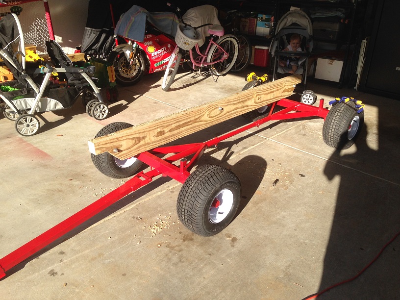

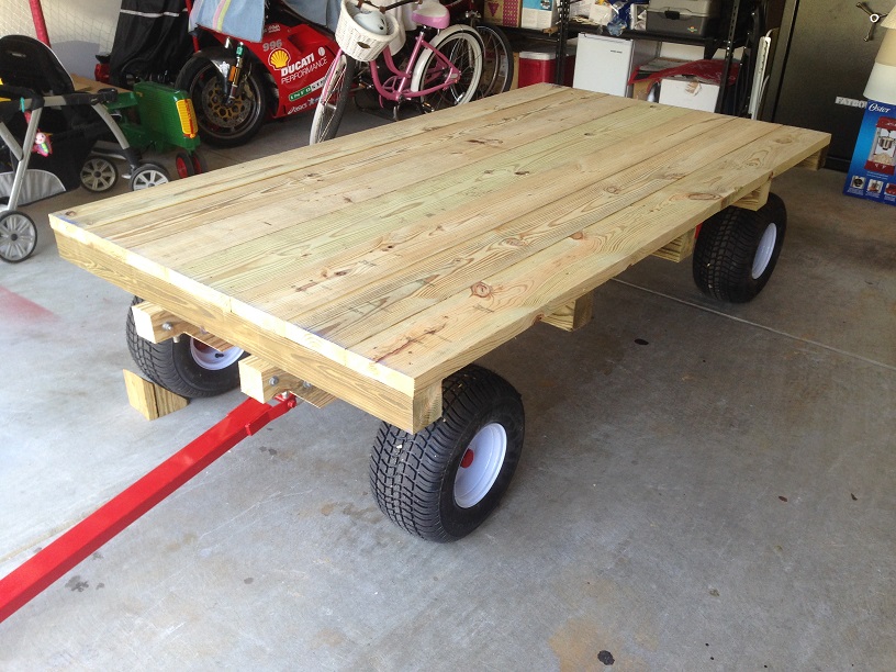

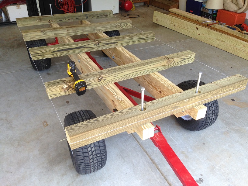

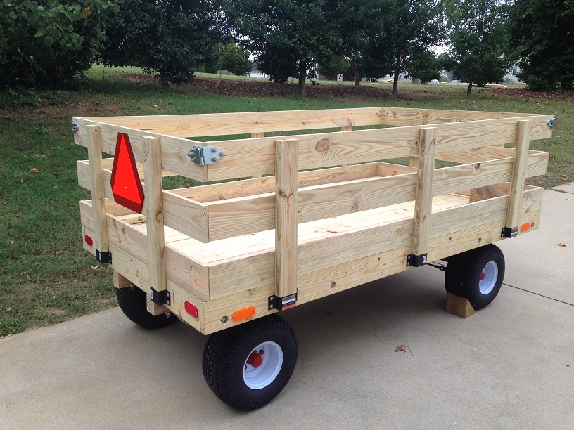

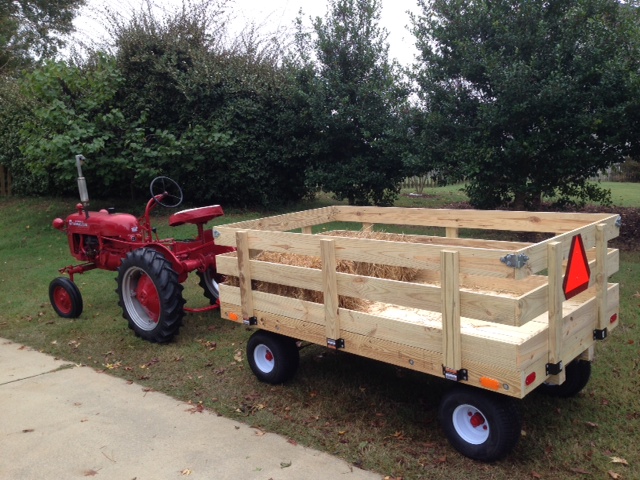

Here it is...the moment you have all been waiting for...the guys the helped me along the way at least...
Final dimensions are 4.5' x 8.5' on Kory 3000 running gear

That is one very nice looking wagon. Great job!
   / Ok...the finished hay wagon! #3
Looks great. What kind of wood did you use?
All pressure treated from lowes bolted together with galvanized hardware.

Looks great, I could use one like that. What is the weight capacity...2000lb?

One nice wagon mister. Its designed to last a lifetime.
Do you have an estimate of the cost of the materials? I am building a new leaf collection wagon to pull behind my John Deere 1026R and its kind of amazing how the material list gets bigger and bigger as one works through the project.
It is hard to say right now. I returned a lot of hardware I thought was excessive and had to buy some tools I did not already own ( bore bits for counter-sinking, other drill bits for the bolts, etc) but it was 986 for the running gear and somewhere in the area of 350-400 for lumber and hardware.

   / Ok...the finished hay wagon! #13
Hello,
Are those tires the same size as a golf cart uses ????

Excellent dimensions and looks perfect with the tractor. You got it exactly right and with clean construction.
Good job.

Hello,
MFWD
Pretty close...not at home right now, but the tire size is on Kory's website. It is a very nice size for the size of the wagon though.
Good job.
Thanks...I got a lot of advice and help from the guys on both tractorbybet and farmallcub forums. Took that and added my own flare and there you have it!
