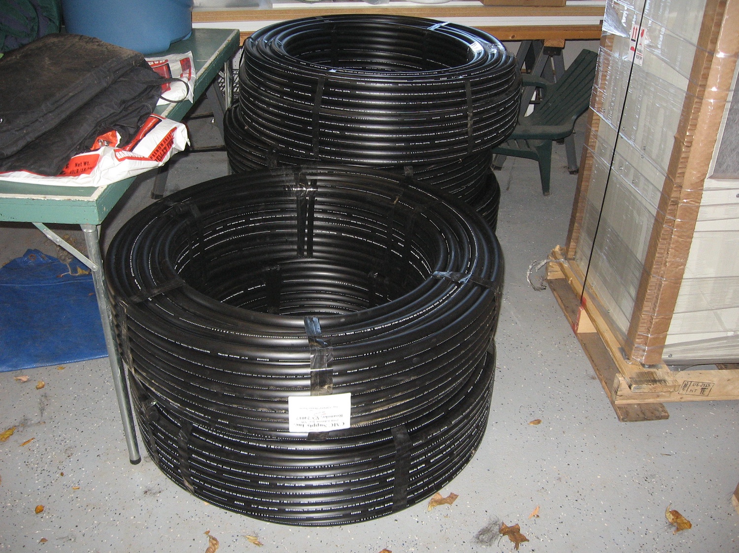

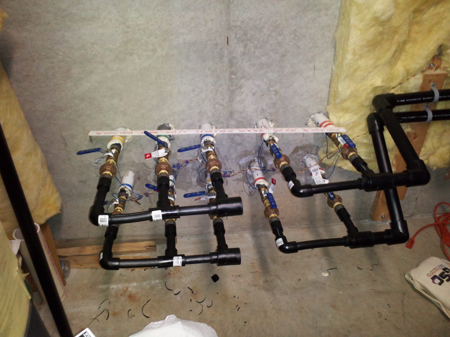

I have 2 units, a 2 ton and 3 ton. Here’s my quote for $45.5k before tax rebate. It cost me $14k plus a tractor, around $11k after tax rebate.
/ Oil vs propane heat #92
Are the left headers spare? Also, how many trench feet did yours take? Total pipe length if you have that? Sq footage of house? Sorry for all the questions.
The left is for my 3 ton unit that wasn’t done when I took the pic.
2ton unit $3940
3 ton unit $4292
Backup heat coils $158 and $189
Fusion kit $1100
7 x 500 ft roll SDR11 $104 each
Flow centers $624 and $949 (2 pumps)
Around $400 for propylene glycol
That’s pretty much all the costs except fittings.
Replacement flow center last yr was $760 for the single pump (2 ton) I need to rebuild the failed pump for a spare.
One 500’ of pipe per ton / loop for slinky plus 100 ft each way is to get to the slinky in the trench, so 700 ft per loop.
I put in shut off ball valves for each loop (allows you to purge each loop using the loop pump) and all the HDPE to metal fittings added up.
Their quote was to connect to existing ductwork. I moved my upstairs unit and totally redid my attic ductwork.
I also ran my own manual J to size the system.
Which I can’t find now. Close to 2700 sf. Plus basement.
Also bought manual j software and geothermal design software. Also took the IGSHPA geothermal installer course and was an accredited Installer at the time.
Slinky trenches are about 65ft long.
