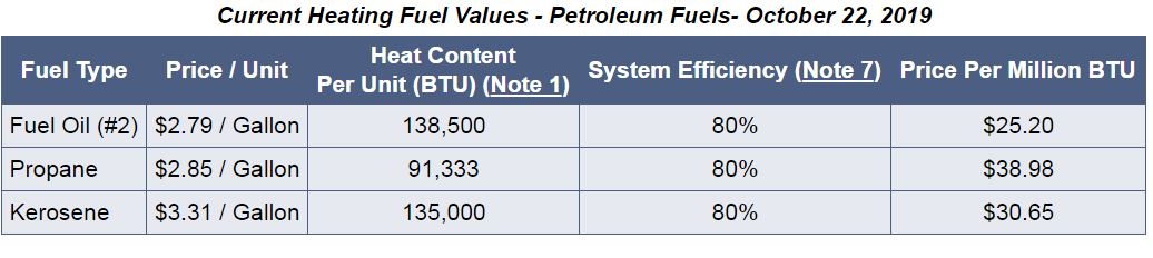

Prices vary a lot by region too, here are this week's average prices for kerosene, fuel oil & propane in N.H. As you can see, propane's no bargain here.
