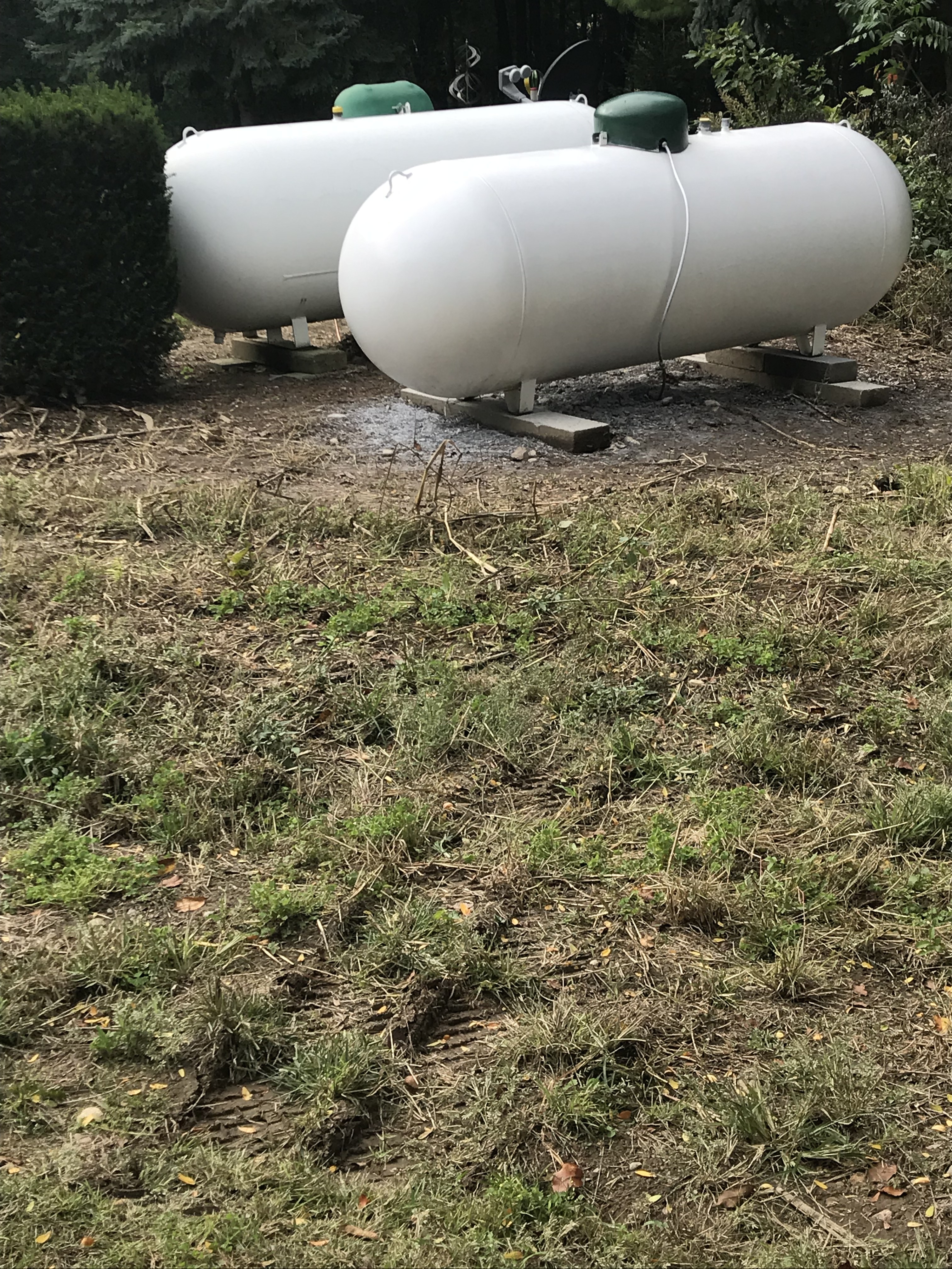

I wouldn't want anything Propane. I just like the flexability of oil. If push comes to shove, I can buy it anywhere and fill up my tank. I like that. Or, if there was a supply issue, you can call every oil dealer around to see if you can get some. Nobody will fill someone elses propane tank.
If you own your own propane tank anyone will fill it.The reason I purchased 2 tanks 500 gallon.I just filled up last week at 92 cents per gallon pretty cheap IMHO..
