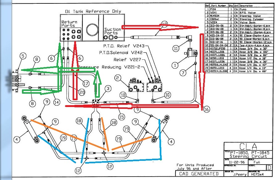

I always thought the joystick valve had a return to the tank and you would be getting the cylinders purged with use. Shows what I know.
Ken
The FEL valve does have a tank port and dumps the total flow, both expended steering cyl fluid and pump flow.
I an not sure you are replacing all the fluid when you steer, maybe a little at a time as you use the steering.
You would have to go left full steer and then right full steer to use all the fluid.
/ Oil Recirculation in closed loop system #42
I meant purged over time, not 100% each time the steering was used.

/ Oil Recirculation in closed loop system #43
opposite ends of the cylinders are tied together instead of the same ends.
That's the key.
In the FEL lift circuit, when both cylinder bottoms fill, both cylinder tops empty towards the tank. When both cylinder tops fill, both cylinder bottoms empty towards the tank.
In the steering circuit, when the left cylinder bottom fills, the left cylinder top empties towards the right cylinder bottom, not towards the tank. When the right cylinder bottom fills, the right cylinder top empties towards the left cylinder bottom, not towards the tank. Since both the left steer and right steer circuits are of equal volume, there is no need for the fluid to go back towards the tank, as it has to fill the opposite cylinder end.

Hi Moss,
I would agree with you if there was a mechanical force pushing and pulling on the steering cylinders but it is a hydraulic pump. There is significant flow required. If I ever think to do it, I will ask Terry what he thinks about that circuit.
Ken

Dear MR,
I hate to disagree, but to move a cylinder, there has to be a volume change. When you steer, you adding fluid to both the left and the right cylinder (opposite ends). That causes the cylinders plural to move. That movement dumps an identical volume to the tank. That volume is ~ 2x30=60cu inches per lock to lock cycle. I don't know if the analogy works, but it's like climbing on a teeter totter. You need a pressure (weight) difference to get movement. That movement does displace oil to the tank. As you correctly point out, in the steering circuit the cylinder ends are flipped, but just like the lift circuit, oil goes into one end and out the other. It is just that in the steering circuit, instead of having both bottoms filled, we are filling the left front and the right rear, while draining the left rear and the right front. (or vice versa).
Maybe this won't be quite so mud clear, but, feel free to point out the error in my thinking so that I can understand hydraulic systems better.

My simple answer is that expended fluid goes to tank from the valve and gets new fluid every time the cyl is activated.
I have stated how to check it, and that is using some hyd fluorescent dye in the cul to see oif it evere gets to tank.
The steering is not a closed loop system.
Cyl expended fluid is not normally reused, but can be used in certain circumstance.
There are two different volumes used when you steer. the base end holds a certain amount of fluid, and the rod end holds less.
The fluid does not bounce back and forth in the cyl circuit.

/ Oil Recirculation in closed loop system #54
The only way for the fluid to stay in the cyl and move back and forth is with a hose size and length that could contain the same volume of fluid as in the cyl.
Say you had one quart of fluid in the base end of a cyl. What would be the length of 3/8 in hose to keep fluid from going to tank. Other wise , the length of hose from cyl to valve that could contain one qt of fluid.
The volume of fluid in a 3/8 hose is .006 gal per ft.
A 30 ft hose would only contain about .18 gal.
One qt = 1/4 gal.
So every time you fully extended the cyl, you would dump some old fluid and add new when extended again
So the answer is that the fluid is always changing.

So I am still here, have been following this with great interest. But I am not seeing it the way you guys are so help me a bit cause I am, well, no scientist.
So oil goes to the steering control under pressure. If not assigned to a pipe it returns to a tank (pipe being the hose to a steering cylinder).
So now I turn the wheel, and oil is assigned down a hose, pressurizing that hose, and in turn pressurizing the hydraulic cylinder.
Now the Hose to the Cylinder is long (my magical hose chart says 37" for each hose) and the Cylinder is actually quite small. I guess in the end the hose has a quite small diameter so maybe this is where the logic fails me....
Anyway, cause the hose is so long, and the oil in the cylinder has no place to go, how is oil recirculating. Maybe there is some mix happening in the hose at the head as it is pressurized but I don't see how fresh oil is going to make it all the way to the cylinder. Fresh oil is only going to go so far down the hose until the Limit of Travel on the cylinder is reached.
Now my whole theory could be bunk because the hose holds X amount of oil and the cylinder requires Y amount so indeed the hose is being purged to the point of getting fresh oil from the steering control.

You can rest assured that a hose that short from cyl to valve is going to get a fresh supply of fluid each time you cycle the cyl.
The old fluid from the cyl has gone to tank after one cycle.
Hypothetically if you only use micro movements of the steering, the fluid might not exchange for a while, but I can bet that you do go full rotation sometimes.
I don't know if your hyd system is close to mine, but if the volume of fluid in the cyl is more than the volume in hose to the valve, it is going to add and exchange be it a little at a time if you.
It is not a closed loop system, and nobody would design it that way with a logical mind.
Say the cyl at full retract has 1 oz of fluid in the vase end, and say the hose to the cyl has 6 oz of fluid in the hose, then to fill a 32 oz cyl, you get to add 25 oz of new fluid from the valve which has new fluid from the pump.
Don't know more that I can say.
I would say that the dark fluid in your cyl was contaminated.
2 in bore
1 in shaft
16 in stroke
Volume extended .2175 gal
---------retracted .1631 gal
Your 37 in hose contains about .0176 gal
Can you not see what will happen?
Your cyl contains way more than the hose, so it is gong to exchange/add each time.
If your steering cyl is 3 in bore, the volume will be greater
