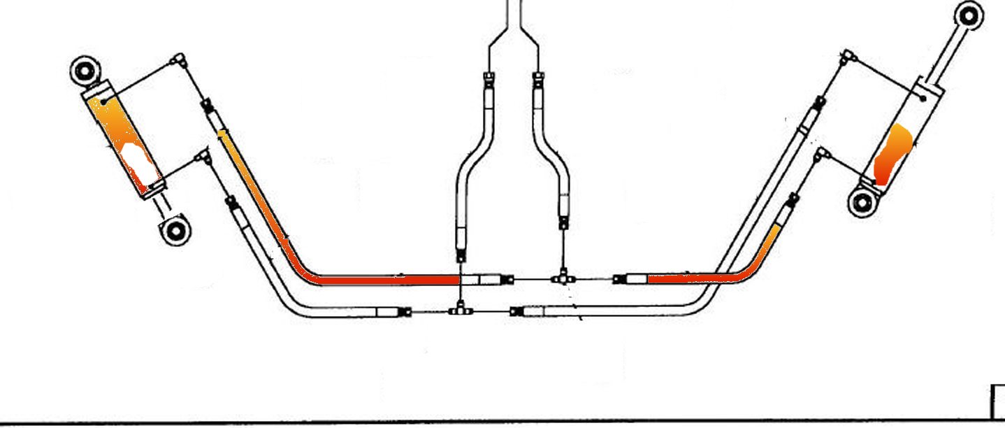

I'm gonna ask you guys one question....
Since the top of one cylinder is draining (flowing out) at the same time the bottom of the other cylinder is filling (flowing in), and the hoses are connected together in the middle with a TEE (which is the single point of fluid movement in that circuit), which way is the fluid flowing, in or out of the teed off hose?
Please explain to me how the fluid can flow in and out of that single hose at the same time.......
/ Oil Recirculation in closed loop system #63
You are filling the base side of one cyl and the rod side of the other side at the same time, using a tee, so the one cyl is pushing and the other cyl is pulling.
When you turn the steering the other way, it does the reverse.
It does not work like the FEL where you are extending both cyl or retracting both cyl at the same.
/ Oil Recirculation in closed loop system #64
Yes, but where is the fluid moving to in other side? If you're suggesting that when I turn right, the left side drains, you are mistaken. It doesn't drain. I guarantee it doesn't drain. Crank your steering wheel all the way to the right. Then drain your left circuit and right circuit. You'll get exactly the same amount of oil from both sides. If it was draining to tank, you'd get nothing.
And I agree that it does not work like the FEL circuit. That one drains both tops as you fill both bottoms and vice versa. The steering circuit does not drain anything. It just pressurizes one side or the other and moves fluid between the cylinders, but does not drain them to any significant level. That's why there's discolored oil in your steering cylinders.... it never leaves to any significant amount.

/ Oil Recirculation in closed loop system #66
My only input on this discussion is to remember that both sides of a double-action hydraulic ram/piston do not hold the same amount of fluid. The shaft/rod displaces fluid on one side of the piston...
/ Oil Recirculation in closed loop system #67
The fluid is still going to fill both cyl and both will have the same stroke.
/ Oil Recirculation in closed loop system #68
Moss, For a given turning direction, the two supply (extend) lines are tied together and ultimately get their fluid from the pump. The two return (retract) lines are tied together and ultimately send their fluid to the tank. You are letting the fact that one cylinder extends and the other retracts confuse you. The cylinders are plumbed in parallel, not in series. Mentally, disconnect the cylinders from the PT but leave the hoses attached. Flip one 180°. If you fixed the lower end of each cylinder, you would in effect have the equivalent of a FEL and you have not done anything to change the hydraulics in this scenario. The only difference is that one cylinder will be moving the rod up because the cylinder is fixed and the other will be moving the cylinder up because the rod is fixed. Switch the hoses on one and it would be identical to a FEL. The hose locations do not change the facts of where the fluid comes from and where it goes. It just changes whether the cylinder retracts or extends for a given valve lever position. Remember that the return on cylinder 1 is not tied to the pressure side of cylinder 2. Which side of the cylinder is pressure depends upon plumbing - it is not a fixed function of the cylinder. (And yes, to further complicate things, which side of the cylinder is the rod side changes how high of a force you can get but not the functionality of the cylinder).
This is sort of like a relay with normally open and normally closed contacts. Both take power from the battery and send it to ground when they function. You could have 2 relays wired in parallel to the same switch with the contacts tied together on the relays. Connections (Tee'd from the switch) to NO on both relays would be like a FEL, both relays would close when the switch was closed. Connections (Tee'd from the switch) to NC on one and NO on the other would be like the steering circuit - one relay would open and the other would close when the switch was closed. Under that scenario, you would not say that the switch is providing voltage (pressure) to relay 2 and that the current (flow) comes from relay 1.
Now that I have totally confused things for you, .......
Ken

/ Oil Recirculation in closed loop system #74
Here's the circuit with the left rod extended and the right rod retracted.
423755d1430958343-oil-recirculation-closed-loop-system-steering2-jpg

If I push that left rod in, where's the majority of the fluid going to go?
/ Oil Recirculation in closed loop system #78
Yes, the bottom of the cylinder contains more volume than the top of the other cylinder. I know that. The point is, the majority of the fluid just gets shoved back and forth between the two sides of the opposite cylinders. If the oil is getting exchanged completely, why is the oil in the cylinders discolored when the oil in the tank is not? It should be the same color.
And I know I'm sounding pissy, but I'm not trying to. I wish we were all sitting in a room together with some beers, some cylinders, some hoses and some pumps and having a good laugh about this. Typing does not show facial expression or mood. To me, its a discussion, not an argument. :)
/ Oil Recirculation in closed loop system #79

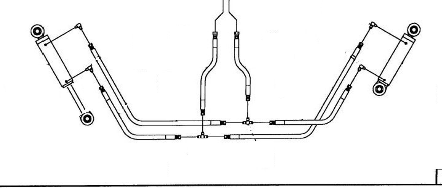

Moss,
If you trace the two vertical lines, one goes to the pump via the valve. The other goes to the tank via the valve.
In a hydraulic cylinder circuit, pressure determines the amount of force you can overcome and flow determines the speed and magnitude of movement. If there is no (or minute) flow to the tank or the return of the pump, then there is no real movement. You are saying no flow to the return of the pump/tank so there can only be minimal movement of the cylinders.
Flip the right cylinder 180° leaving the hose connections as is. If you now mechanically connected those two cylinders as is to your FEL, it would work appropriately except because the rod end are switched, the cylinders would not have equal maximum force.
In this case, I am afraid that everything I know about physics as applied to hydraulics says you are not thinking about this correctly. Doesn't mean that I am not missing something because I am quite capable of having a brain fart but in this instance I do not think I am. If I thought there was an even 1% chance I was wrong on this, I would ask in the hydraulics forum.
Ken
/ Oil Recirculation in closed loop system #80
Or is the schematic this way, which would make more sense?
423762d1430959785-oil-recirculation-closed-loop-system-steering8-jpg
