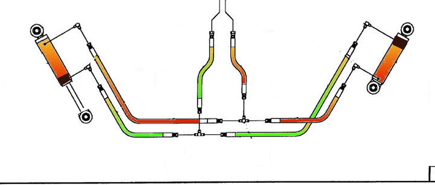

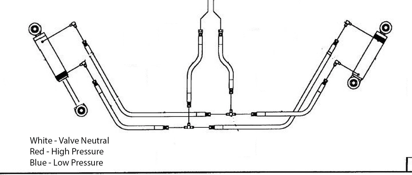

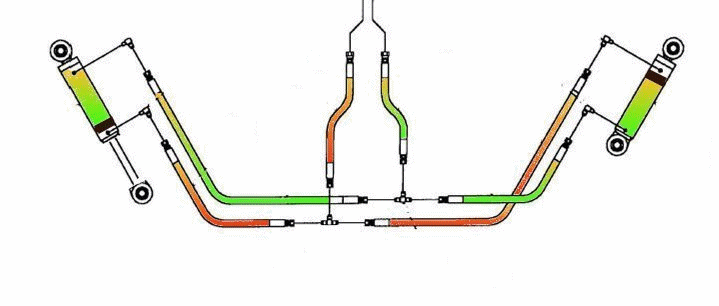

I hate to disagree, but to move a cylinder, there has to be a volume change. When you steer, you adding fluid to both the left and the right cylinder (opposite ends). That causes the cylinders plural to move. That movement dumps an identical volume to the tank. That volume is ~ 2x30=60cu inches per lock to lock cycle. I don't know if the analogy works, but it's like climbing on a teeter totter. You need a pressure (weight) difference to get movement. That movement does displace oil to the tank. As you correctly point out, in the steering circuit the cylinder ends are flipped, but just like the lift circuit, oil goes into one end and out the other. It is just that in the steering circuit, instead of having both bottoms filled, we are filling the left front and the right rear, while draining the left rear and the right front. (or vice versa).
Maybe this won't be quite so mud clear, but, feel free to point out the error in my thinking so that I can understand hydraulic systems better.
All the best,
Peter
Yes, you lose a little fluid back to the tank when steering, but it has to be an extremely small amount. Going full left and then full right moves most of the fluid between the cylinders, not back to the tank. Look at the schematic. If fluid leaves the bottom of one of the steering cylinders it has to be made up in the top of the opposite steering cylinder. Very little fluid will pass through the post of the TEE back to the steering valve. It has to go through the cross of the TEE to fill the other cylinder.
I'm saying the steering valve is pressurizing one side of the steering circuit while relieving pressure on the other, not flowing tons of GPM, just tons of pressure.

My simple answer is that expended fluid goes to tank from the valve and gets new fluid every time the cyl is activated.
I have stated how to check it, and that is using some hyd fluorescent dye in the cul to see oif it evere gets to tank.
The steering is not a closed loop system.
Cyl expended fluid is not normally reused, but can be used in certain circumstance.
There are two different volumes used when you steer. the base end holds a certain amount of fluid, and the rod end holds less.
The fluid does not bounce back and forth in the cyl circuit.
Can you not agree that if the base end is empty or the cyl is retracted, as the valve opens to extend the cyl, the pump is pushing new fluid in the hose plus the hose fluid.
