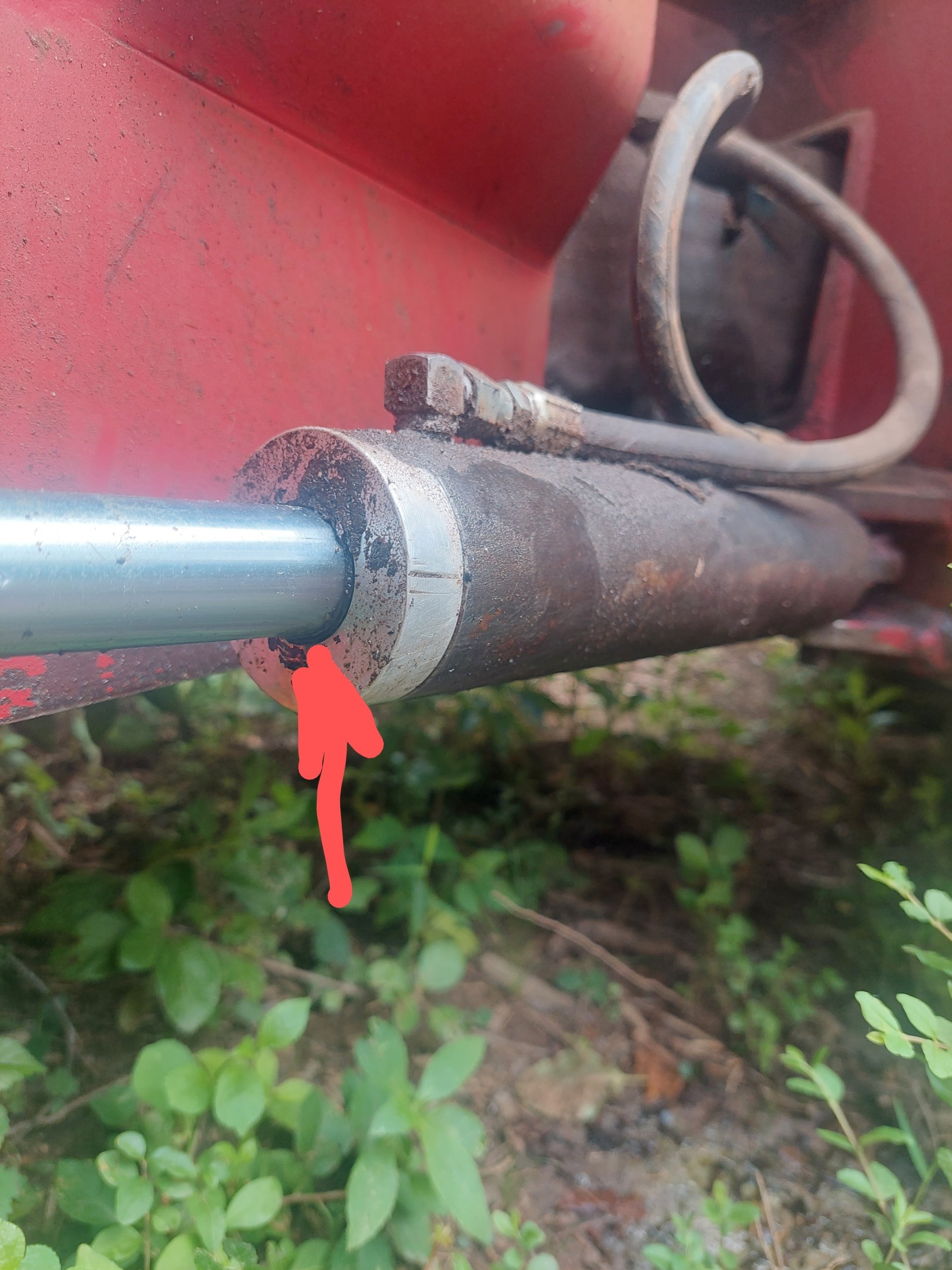

First cylindar issue for me.
What has been a slow drip has developed into a stream of oil. Coming from inside--the joint between the rod and the outer housing.
Looks like I will have to take it off and send it to PT for repair. I know PT makes there own cylindars so I don't trust a local place having the proper components? Maybe I am being paranoid.
I assume I remove the hoses and leave the fittings going into the cylindar casing. Guess I need to plug the hoses after removal so they don't continue to drain oil?
Does anyone know if I need to bleed the repaired cylindar/system somehow after I reinstall it?

Like any other hydraulic cylinder, you'd want to use the appropriate fittings to cap the hoses and the cylinder fittings so oil doesn't leak everywhere.
I'd be surprised if PT uses nonstandard seals on their cylinders because that would make it harder to source parts to build machines.
Besides rebuilding, there may be a new cylinder you could substitute instead of fooling with rebuilding yours. If there are nicks or burrs on the cylinder rod, you might be better off just buying a new cylinder.

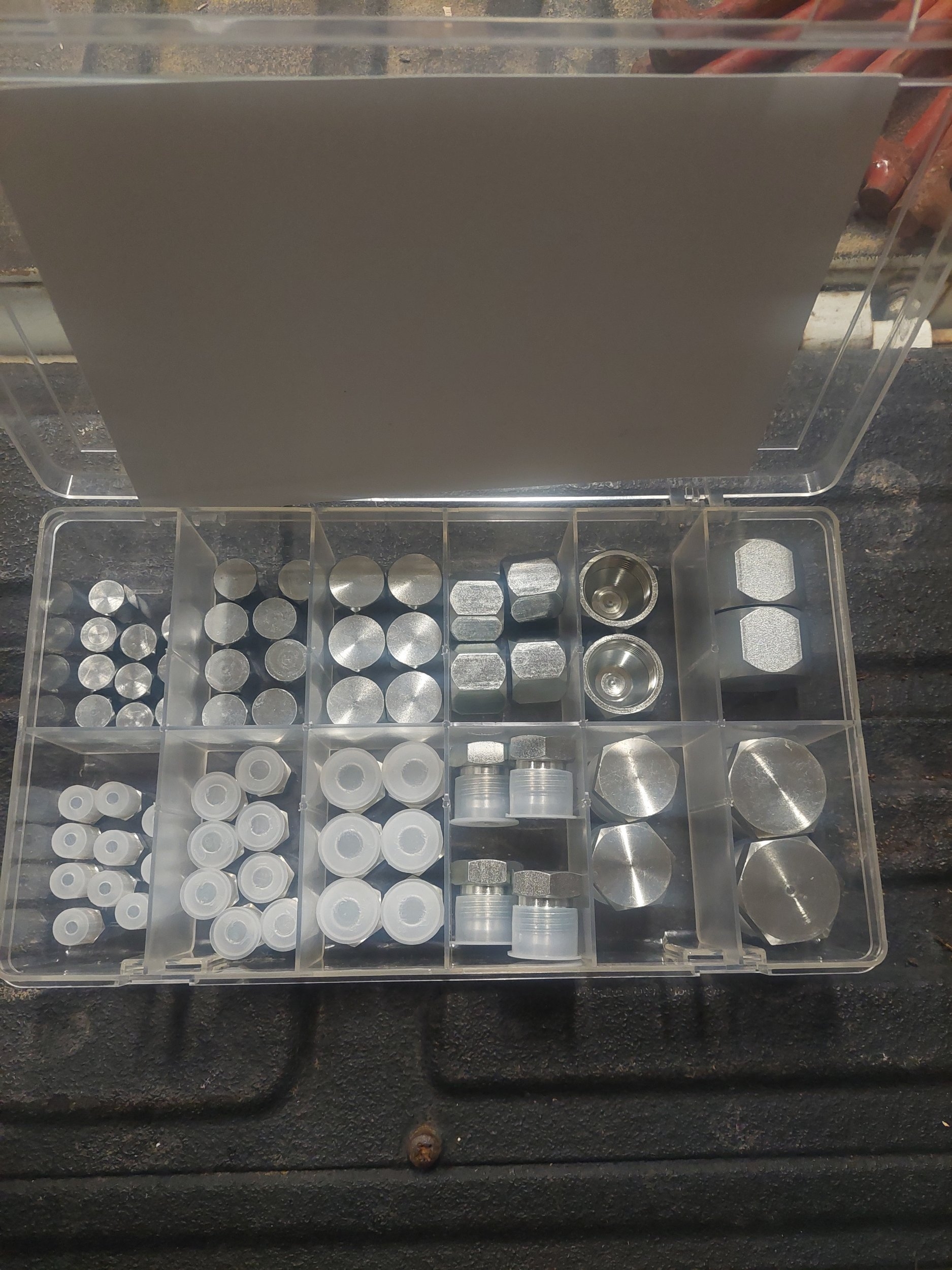

I recommend getting a set of SAE M/F caps and plugs to seal up your hoses to keep from getting dirt in and draining oil out of the tank. Plastic works, but I use metal ones. Remember to get every fitting super clean before working on them. I power wash the area first, then scrub them with a brush and soapy water, and follow that with brake cleaner. Dirt is the enemy of hydraulic components and the steering valve is $$$ pricey.
If you cycle the cylinder by hand after you remove it from the tractor, you can get most of the oil out of it before shipping it. After you get the new cylinder installed, you can crack each hose fitting one at a time to bleed the oil, but be careful with high pressure oil sprays! Given where the cylinders are the air will also move its way out of the cylinder system with use.

K, ordered a set of metal plugs and caps for the fittings.
Going to power wash it first and then move ahead when the fittings get here.
Appreciate the suggestions, Peter.

Received the hydraulic plug and cap kit yesterday.

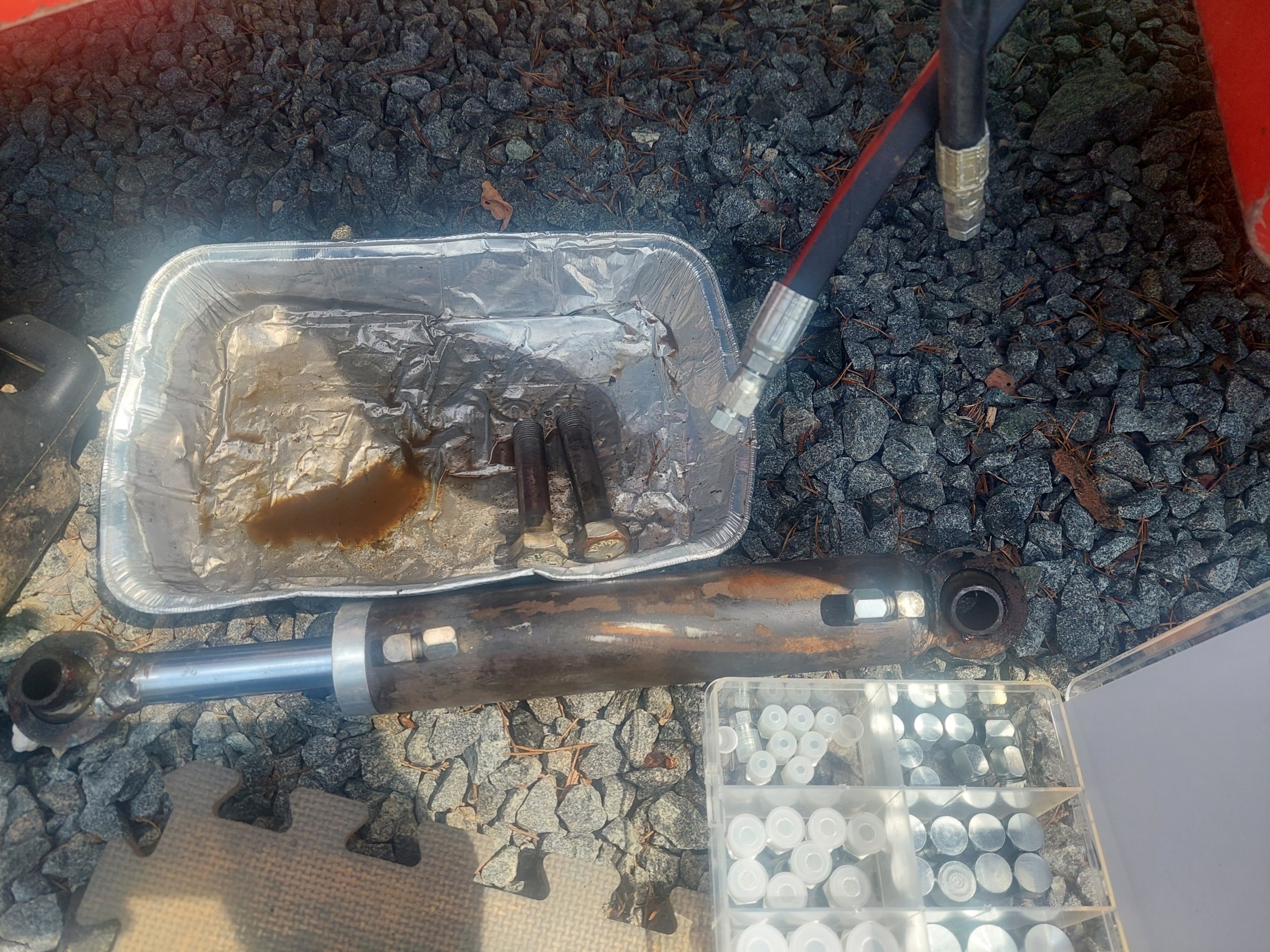

Took the steering cylindar off today.
Started by pressure washing then brake cleaner on fittings. That combo worked very well to get all the grease, debris, etc off the connection areas.
Then disconnected hydraulic lines. Thought hydraulic fluid was going to siphon out since they are located lower than the tank fluid level but that was not happening.
Capped the lines with my new metal fitting caps to make sure all is sealed up nice and took off cylindar.
Appreciate the help!
/ Steering cylindar leaking oil #10
Looks like the rod eye has been re-welded to the rod at one point, and there's a nick in the rod. Are you going to rebuild it yourself, have a shop do it or send it back to PT?

That rod could easily be original. Easy enough to compare to the other side. Power Trac's cylinders are hand made.

This is an original PT cylindar. They are the same on both sides. They sit low on the PT frame and I was actually surprised it wasn't more damaged.
I was also surprised to see that the holes on my frame that this cylindar attaches to were not egged out. I am trying to consistently lube things so that must be working.
I plan on sending the cylindar to PT because they make there own cylindars and I want them to see exactly what I have and either fix this one or send me a new one that is exactly the same.

Highly recommend the metal caps referenced earlier in this thread for sealing up the fittings on the loose hoses and the cylindar itself during shipping. I don't have a garage for the tractor yet and it was very nice to have all the mating surfaces stay clean for the reassembly process.
