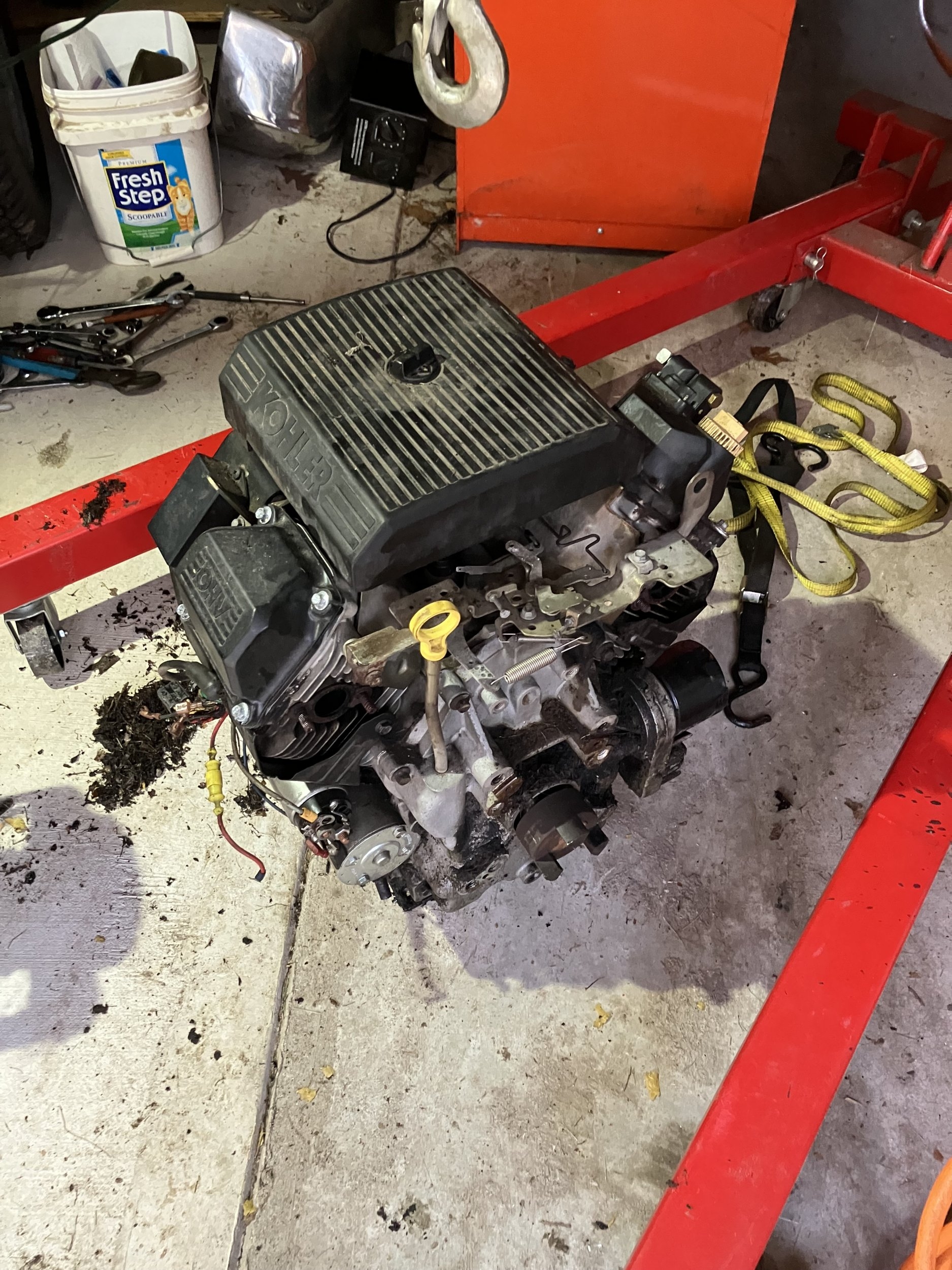

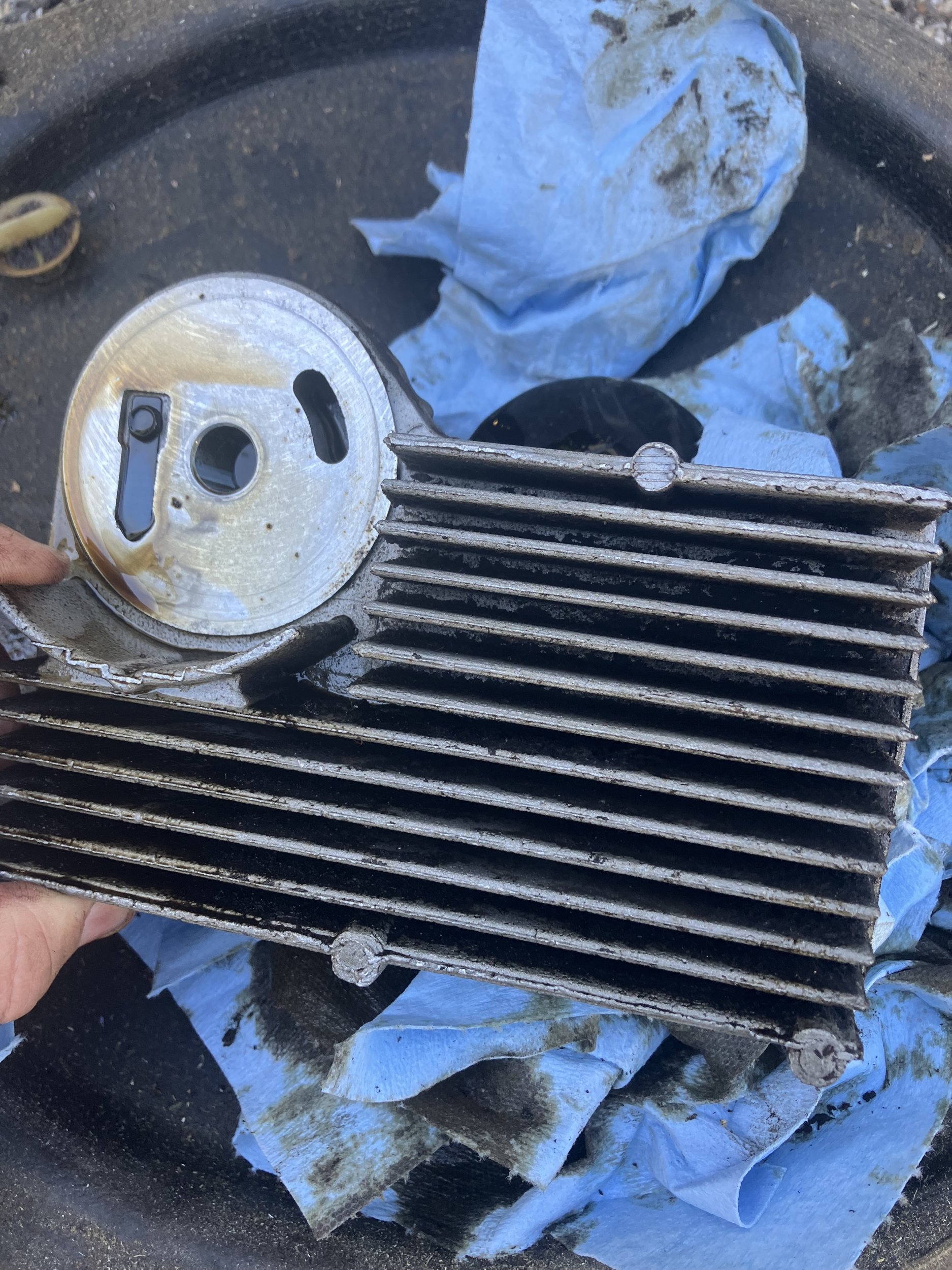

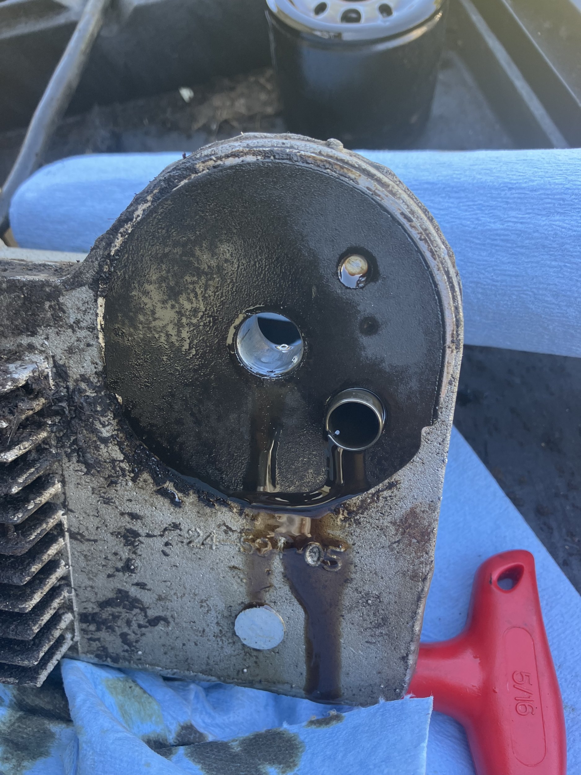

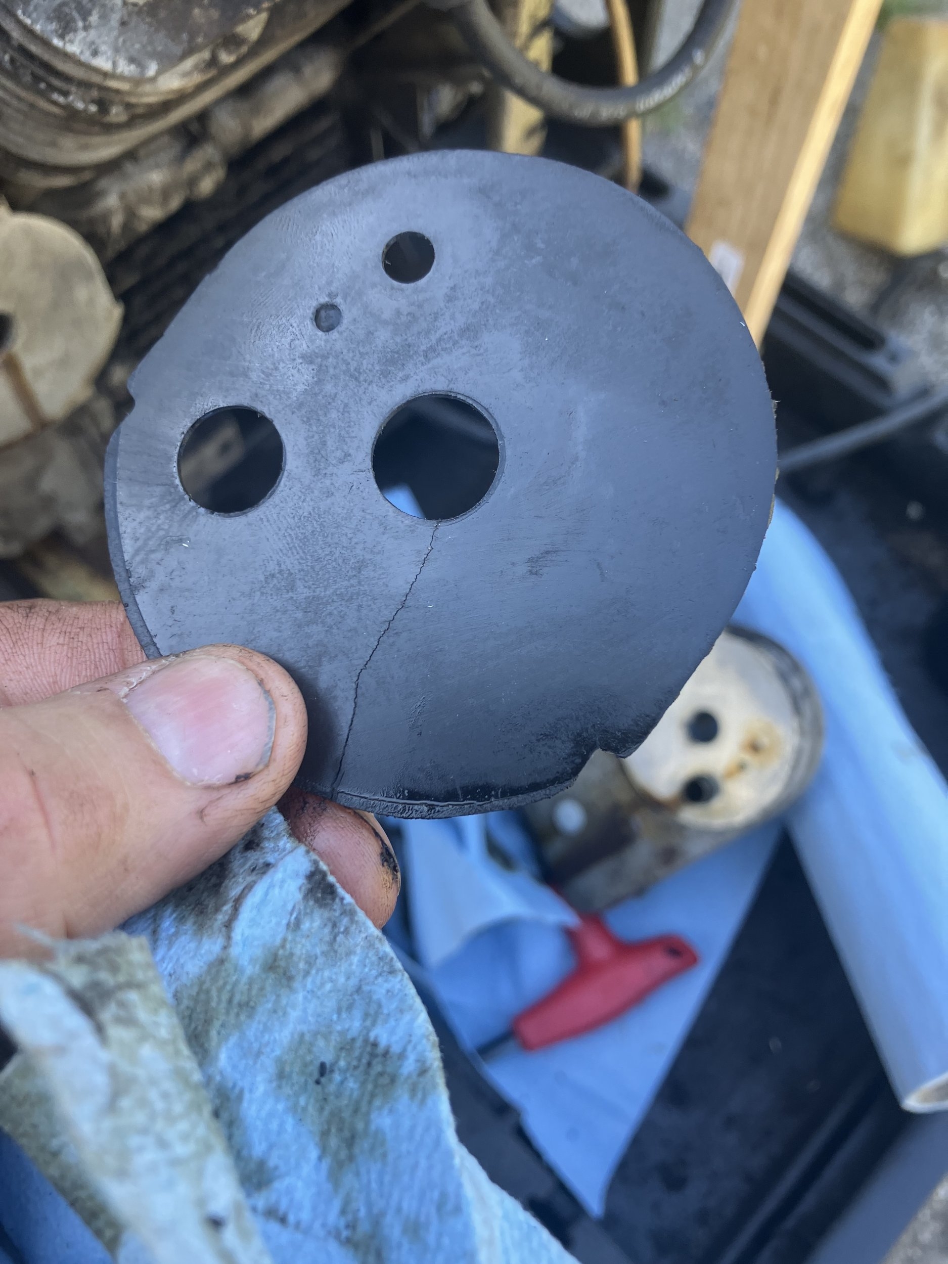

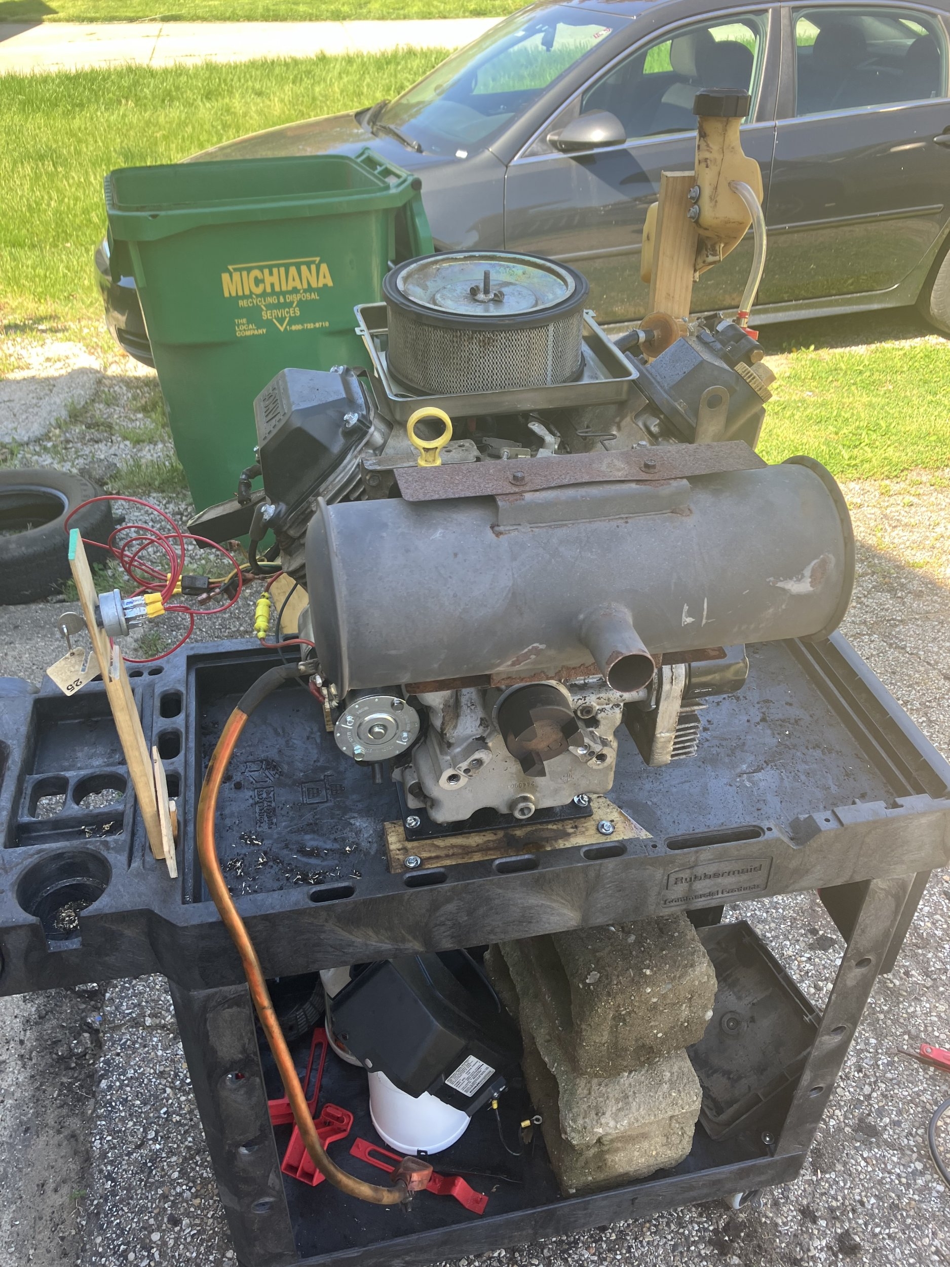

Finally got a few hours to put the engine on a cart, remove all the shrouds, find an incredible amount of oily dirt and debris packed in every crevice/fin possible, clean the heck out of it, figure out how to fire it up and had it run for about 5 minutes....
Found the oil leak! šŸ˜›
Saw the drips here...
Looked up and it's coming from a gasket between the block and add-on oil cooler.
Pulled the filter, pulled the cooler.
This gasket is the culprit.

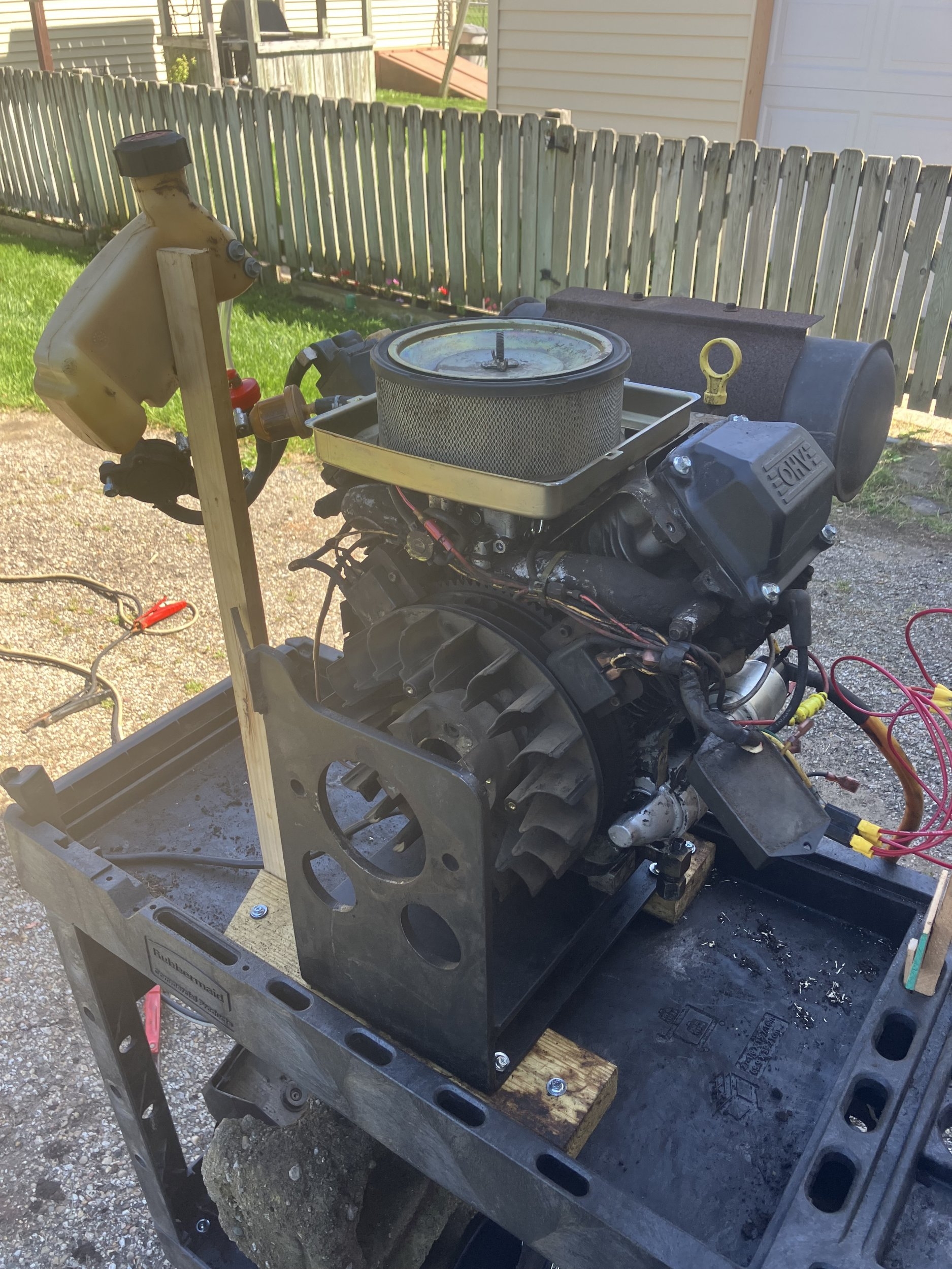

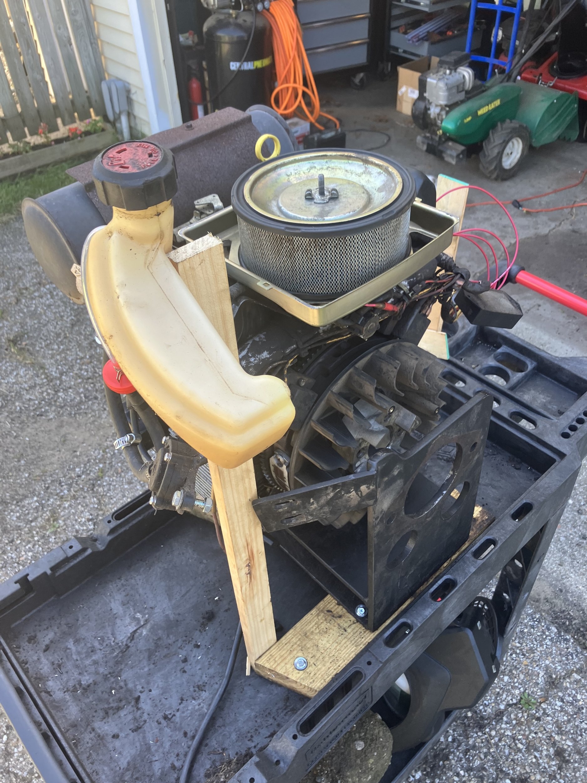

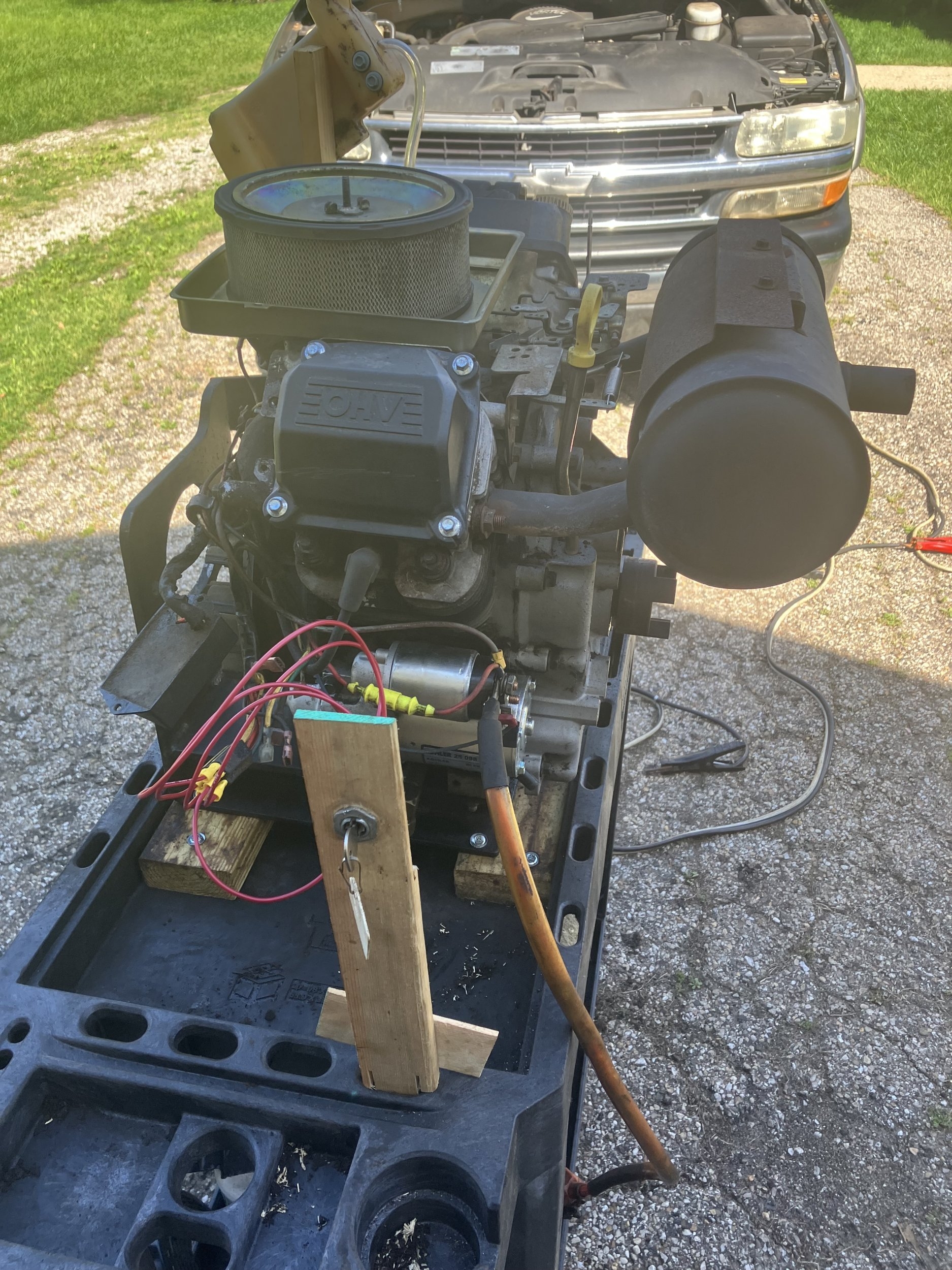

My engine cart.... hey, it works. :ROFLMAO:

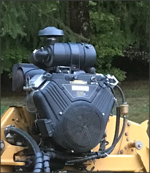

I have a very similar design Vanguard 35 hp engine in a Vermeer stump cutter and am very interested to hear where the engine oil leak was once you have located it?
The oil filter/oil cooler setup would be the first place I would take a look at, followed by oil pan & crank seals.
Winner winner chicken dinner! šŸ˜›

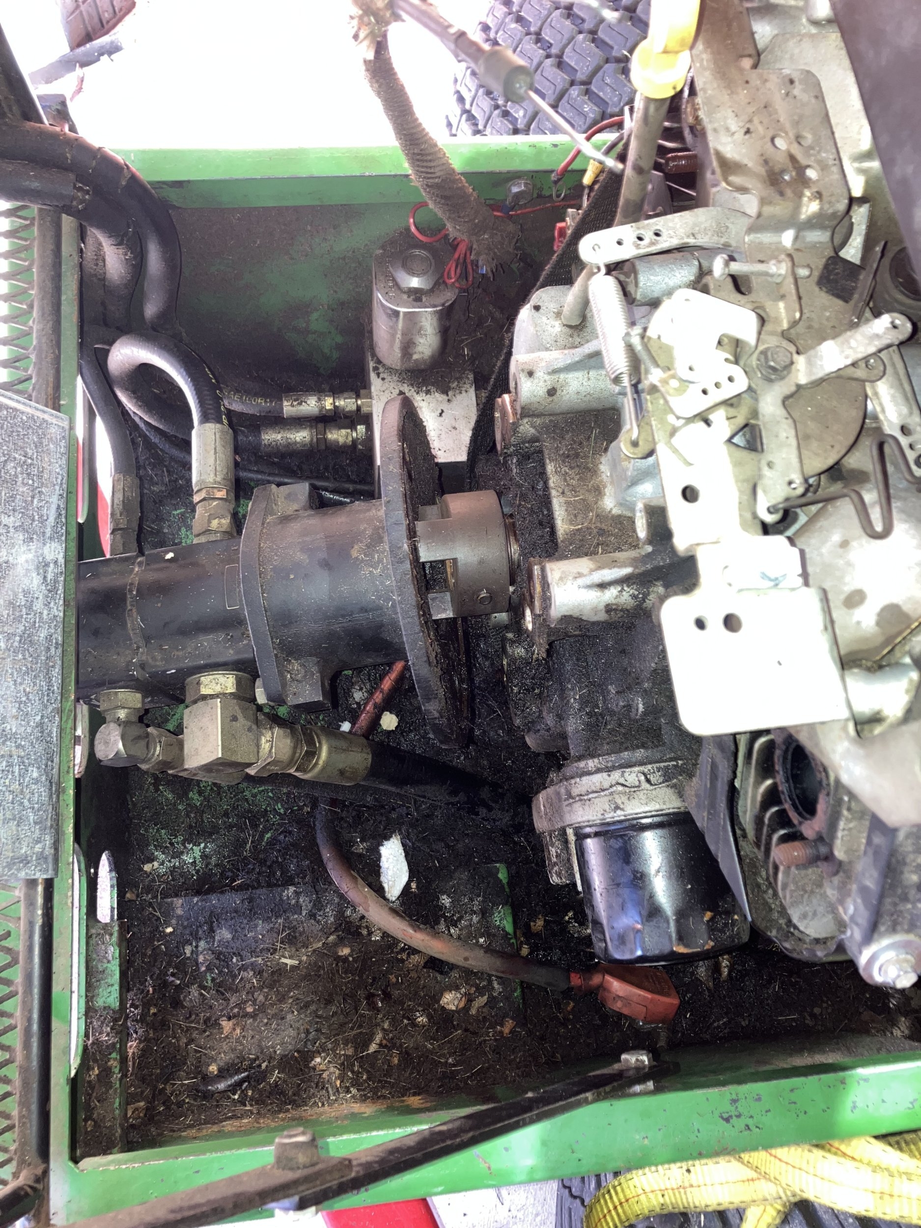

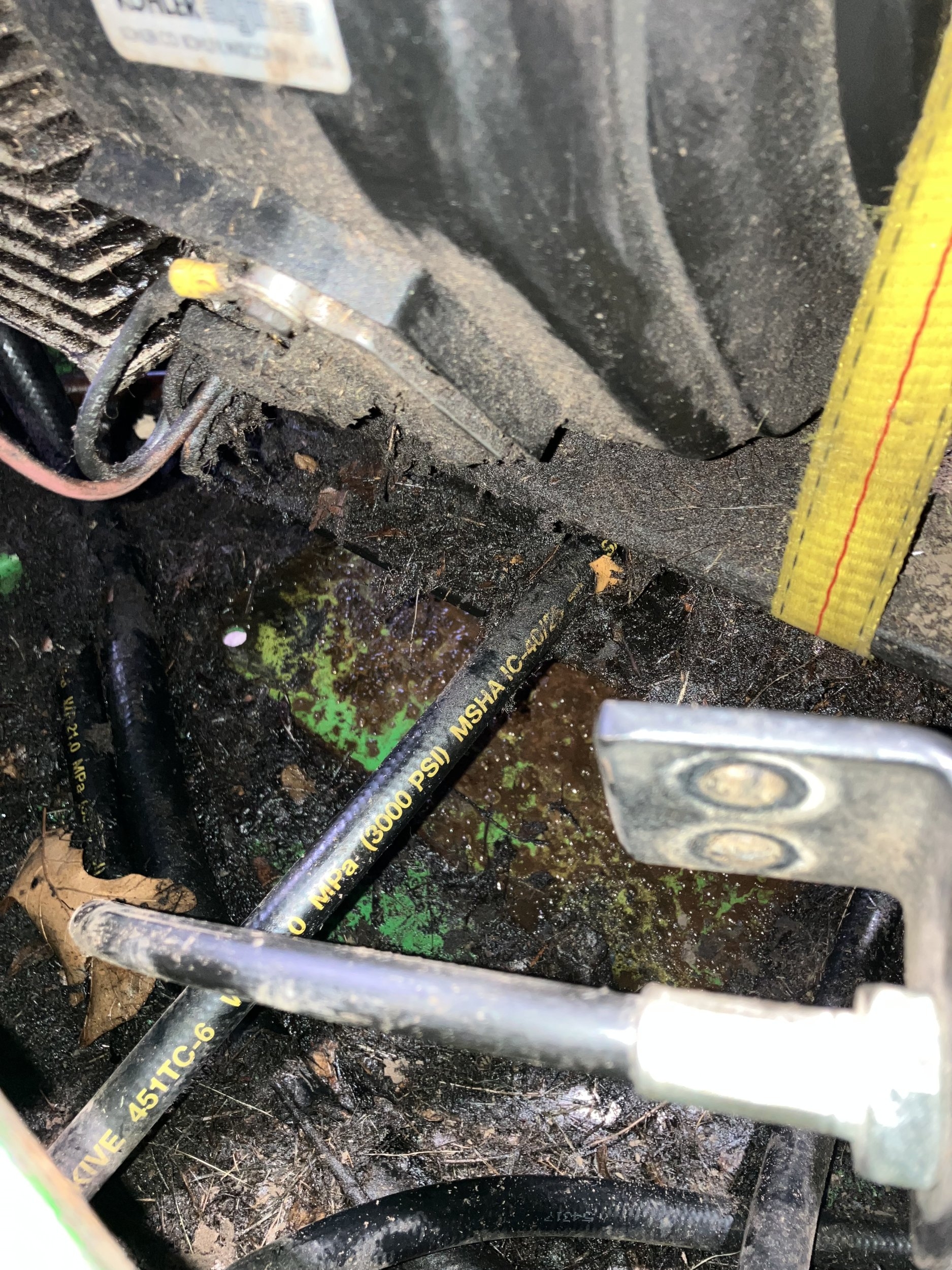

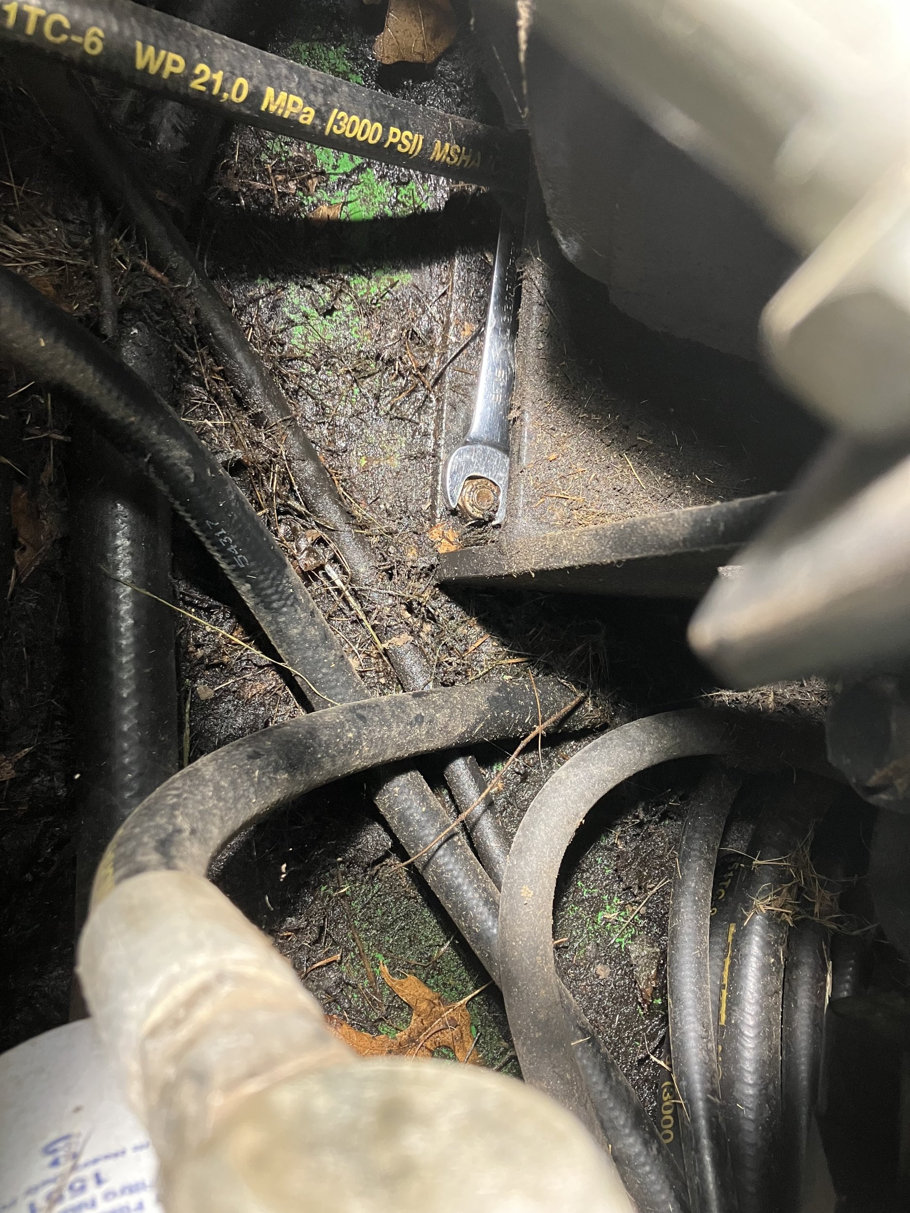

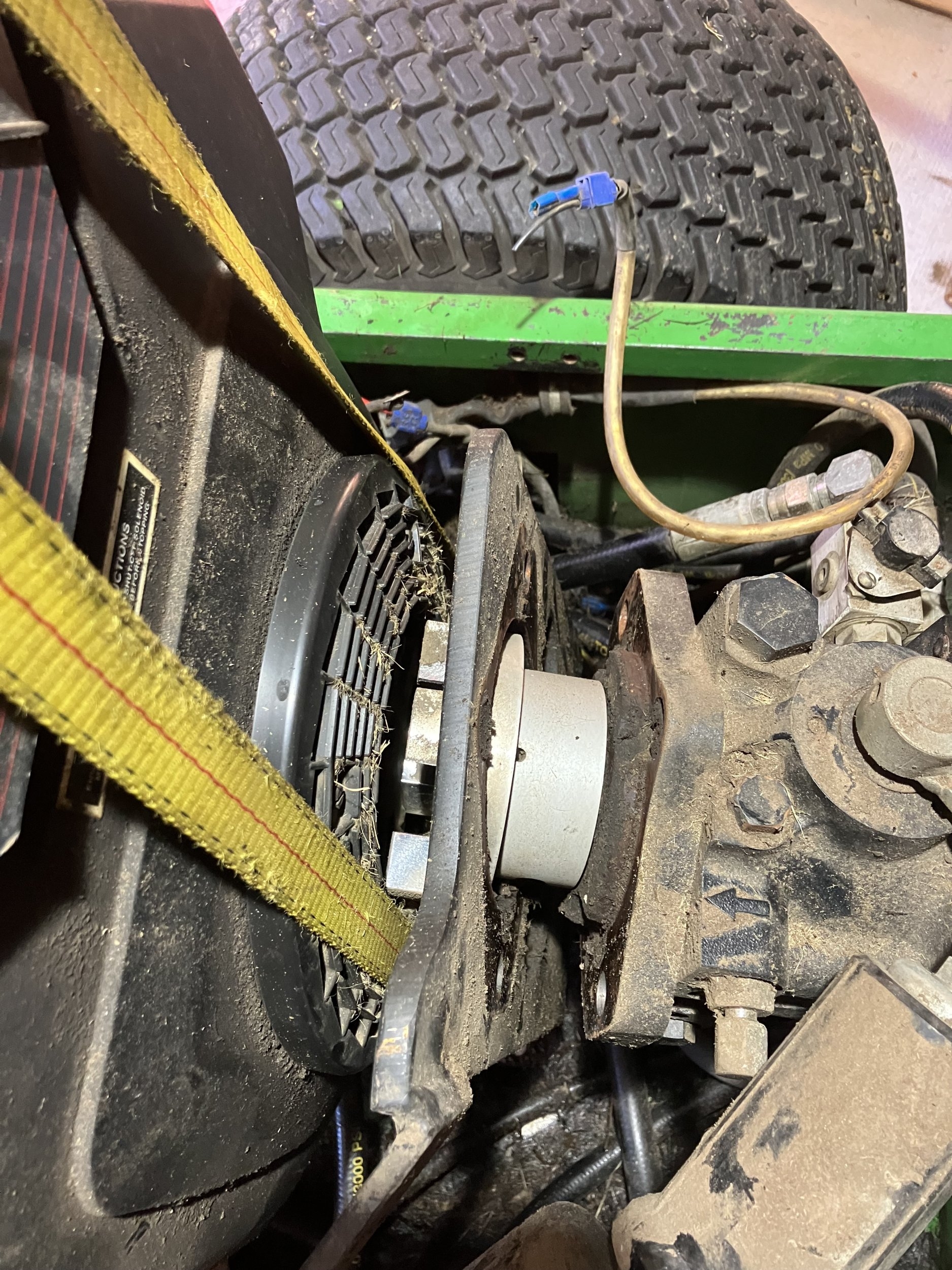

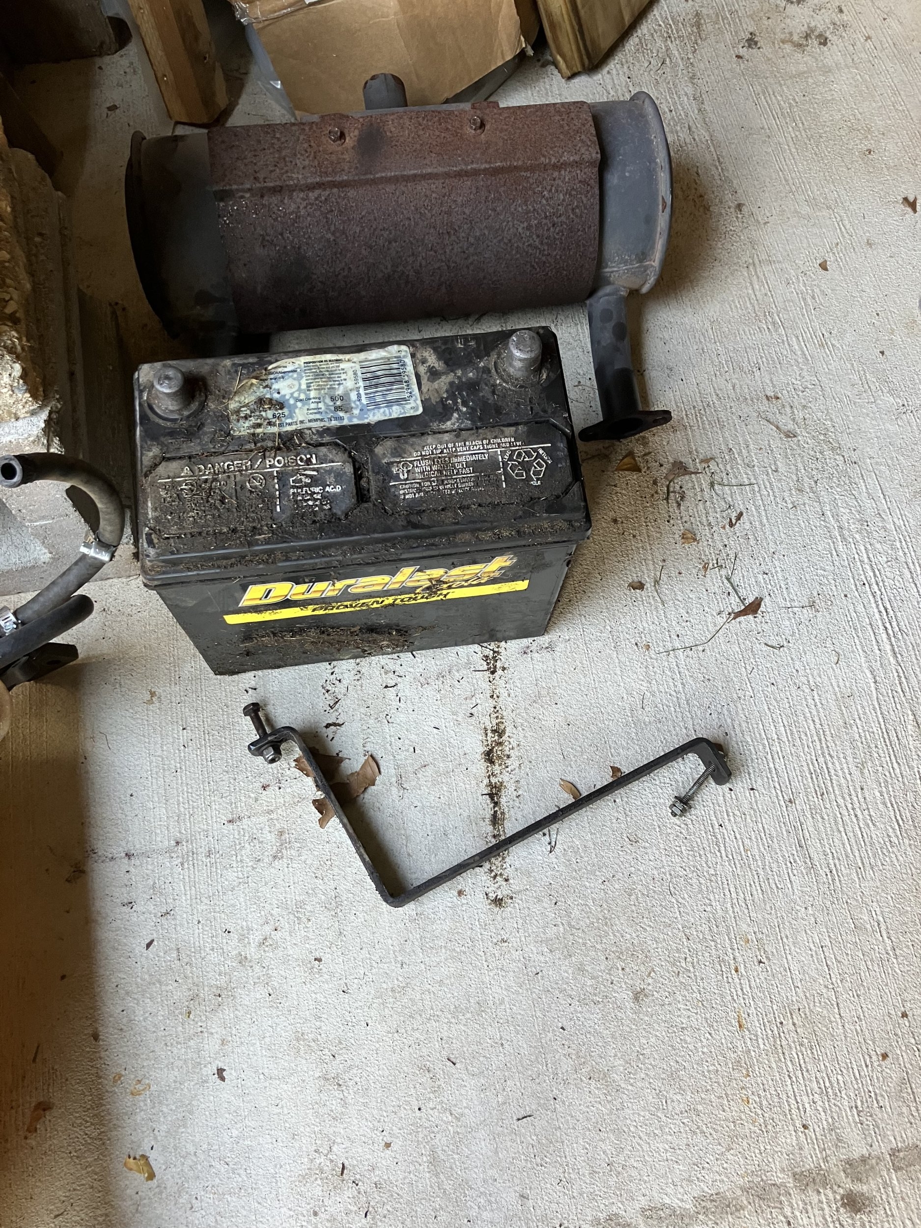

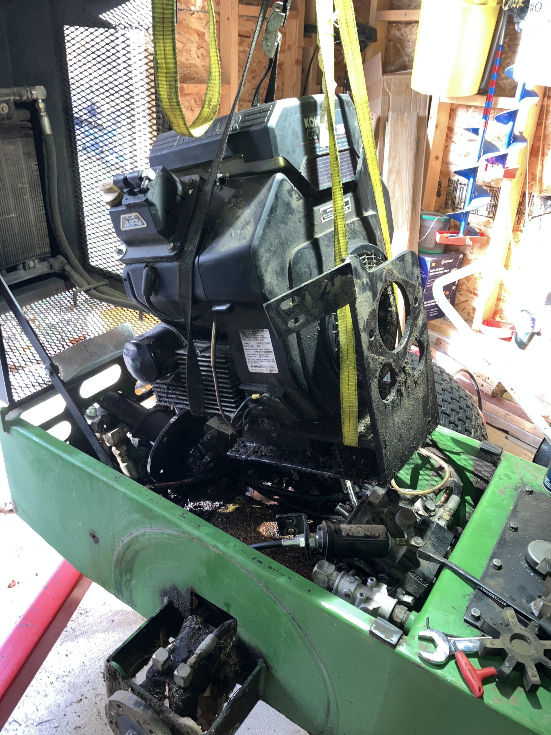

My 2001 PT425 developed an oil leak. About 1/2 a quart every 20 minutes. Can't seem to locate it, other than a pool of oil under the engine. So time to pull the engine, put it on a stand, clean it up, and run it to locate the leak.
Trying to avoid disconnecting hydraulic hoses.

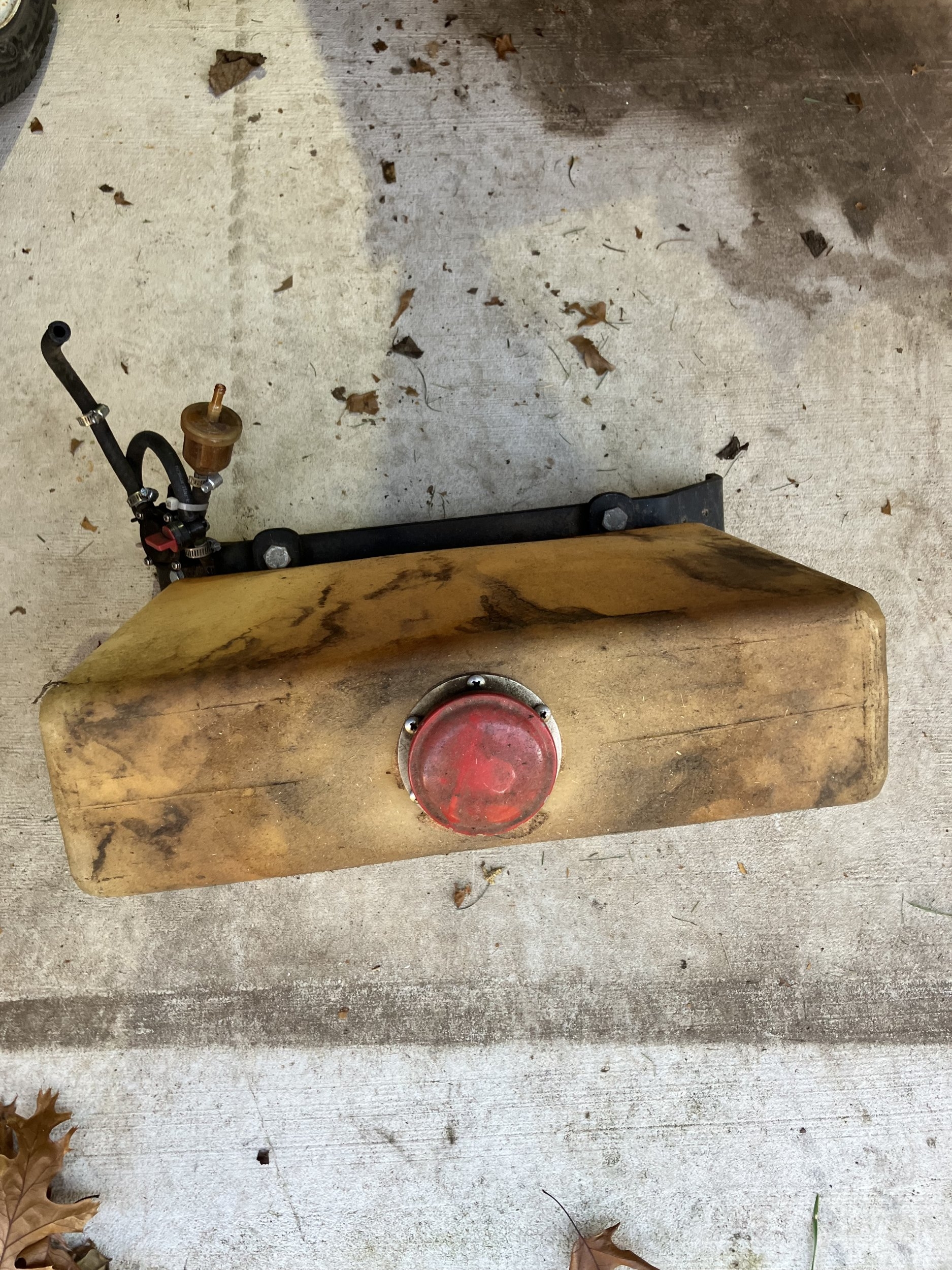

Pulled the gas tank and fuel pump all on the bracket. Just 4 bolts and a hose clamp.

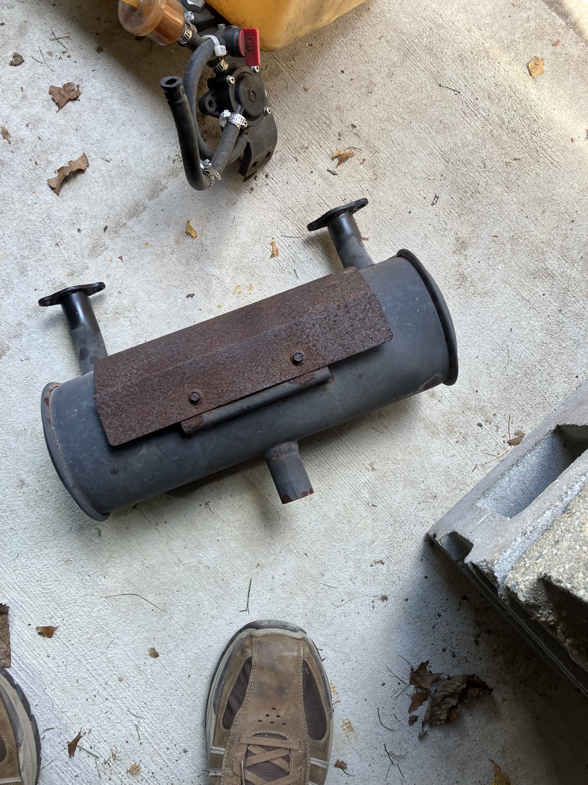

Pulled the muffler. 4 nuts. Didn't break the exhaust studs this time. šŸ™ƒ
Pulled the battery.
Unmounted the hydroback assembly.
Disconnected the wiring harness and positive battery cable from the starter.
Disconnected the tram pump from the mount on the front.
Disconnected the PTO pumps from the engine on the rear.
Removed the 4 bolts that hold the engine mount to the bottom of the tub.

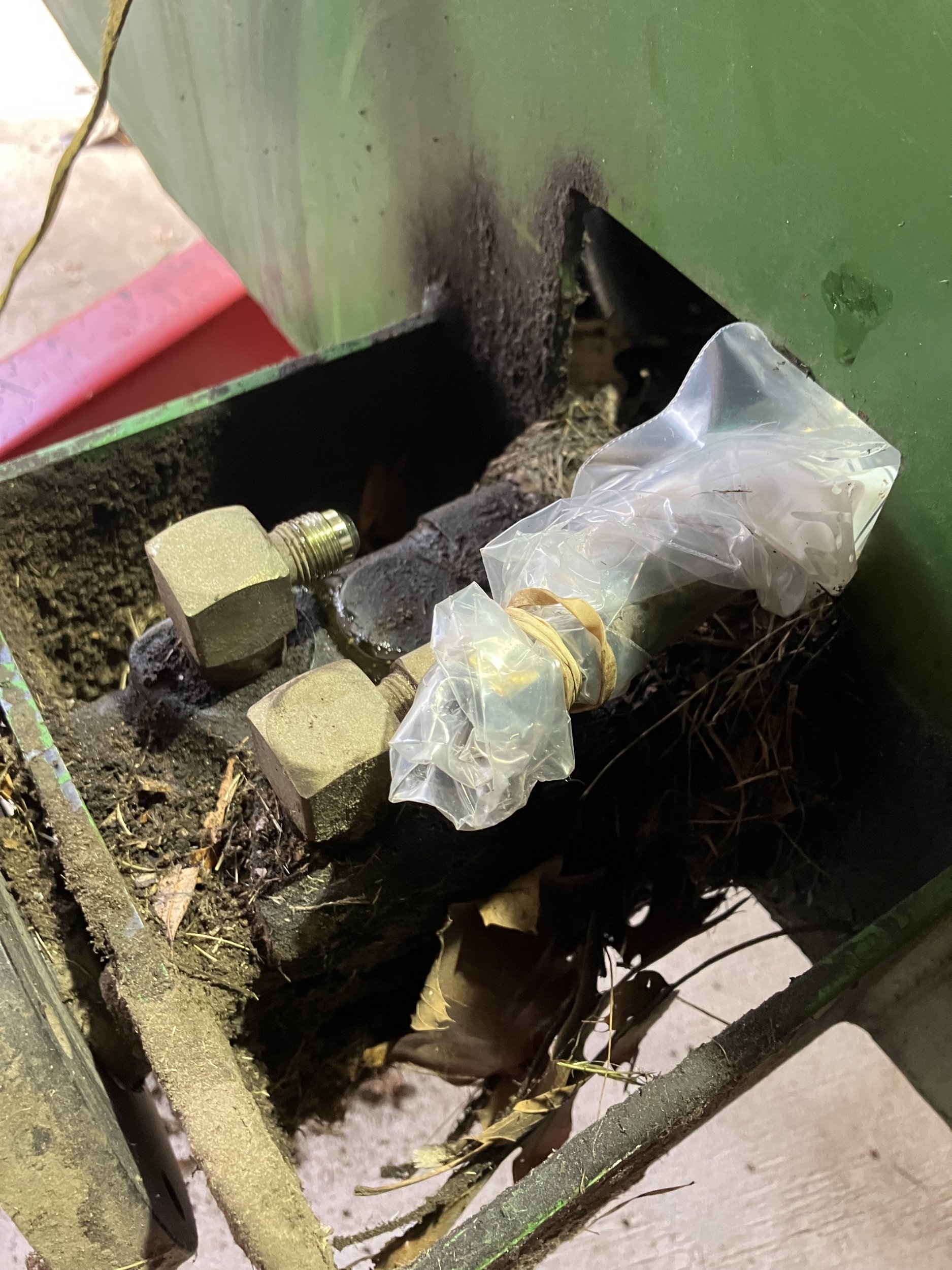

Started lifting the engine and found one (1) hydraulic hose that goes through the engine mount. Grr.
Pulled the right rear tire, cleaned the fitting, bagged it and pulled the hose.
Pulled the engine.
View attachment 831634 View attachment 831635
Took about an hour and a half. Overall, not too bad.
I'm going to get a cap/plug kit and pull the hoses off the pumps, reassemble everything after locating and repairing the oil leak, and put it all back in as one unit. That will be much easier.

Got the oil cooler back on with the new gasket. Started putting engine shrouds back on.
Pulled the tram pump out of the engine tub. Marked all the hoses and pump ports with color-coded zip ties. Will mount that on the engine once the shrouds are all on.
Went to remove the PTO pumps from the tub. I'm out of fittings and caps of the correct size. So I ordered a second set of caps and plugs. Will arrive Wednesday.
Used some down time to clean out the tub. May paint it after the other pump is out. Lots of surface rust in there, although the leaking oil did a good job of slowing it! šŸ™ƒ
