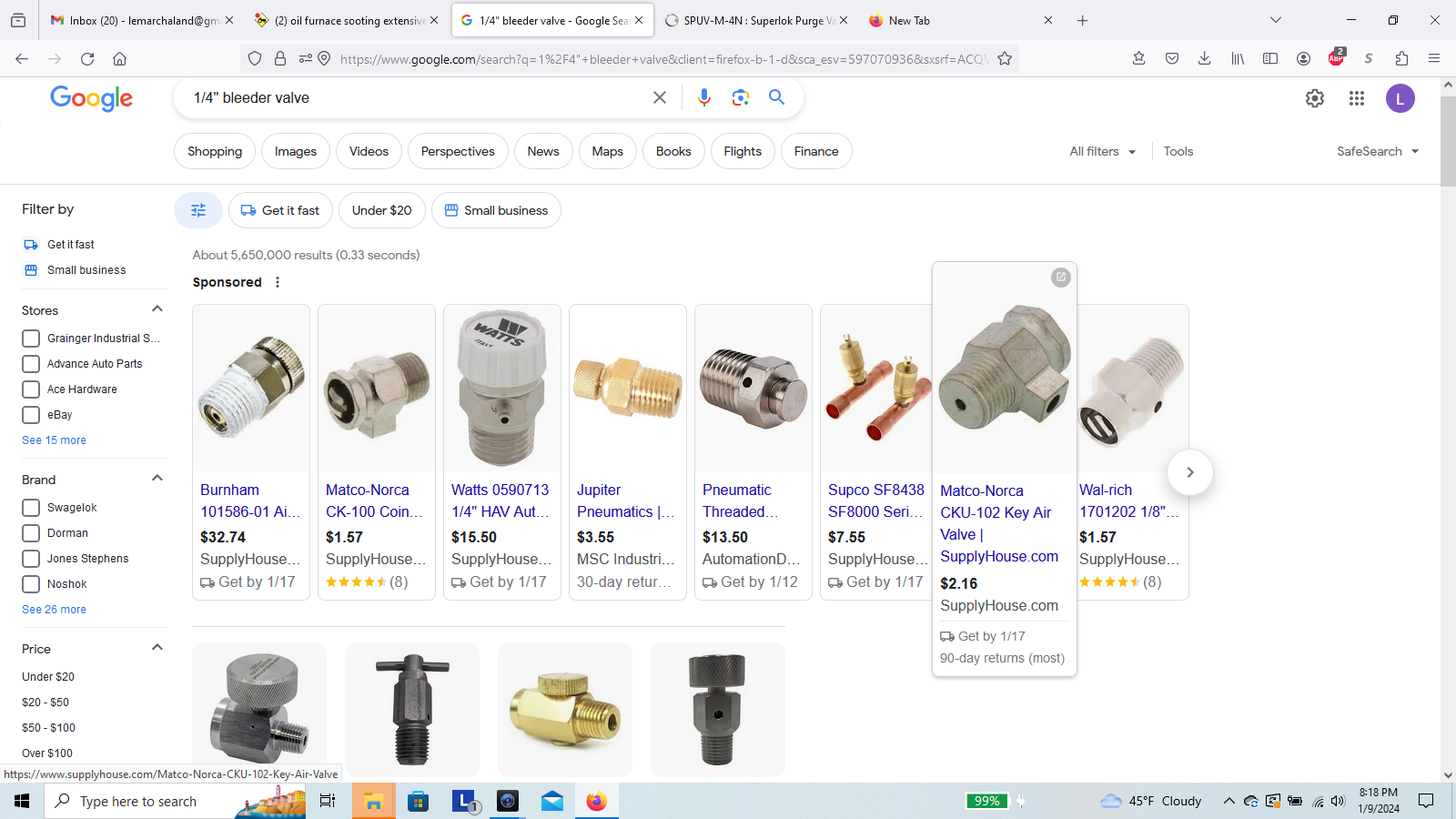

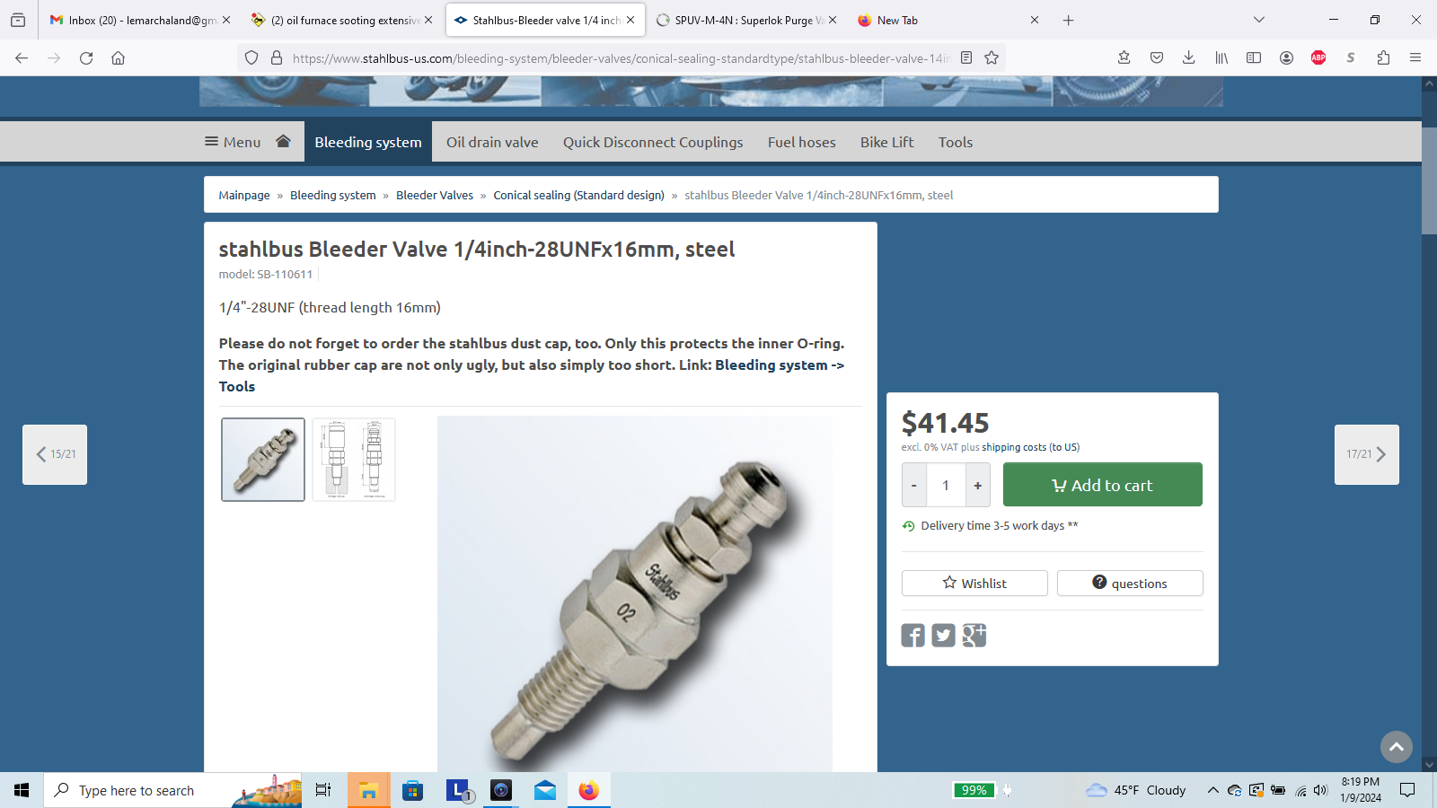

Because of clearance issues ill need a 4' tube between the pressure guage and pump. How do i get the air out of that?
/ oil furnace sooting extensively #9
You could carefully pour oil into the hose after it's hooked up at the pump end. Alternatively you could loosen the gauge a bit carefully with the burner running to bleed the air out.
It doesn't need to be bleed completely a bit of air will act as a pulsation dampener from the pump pulsations.
Or you can get fancy and put a tee at a high point and reduce down to install a bleeder valve,
