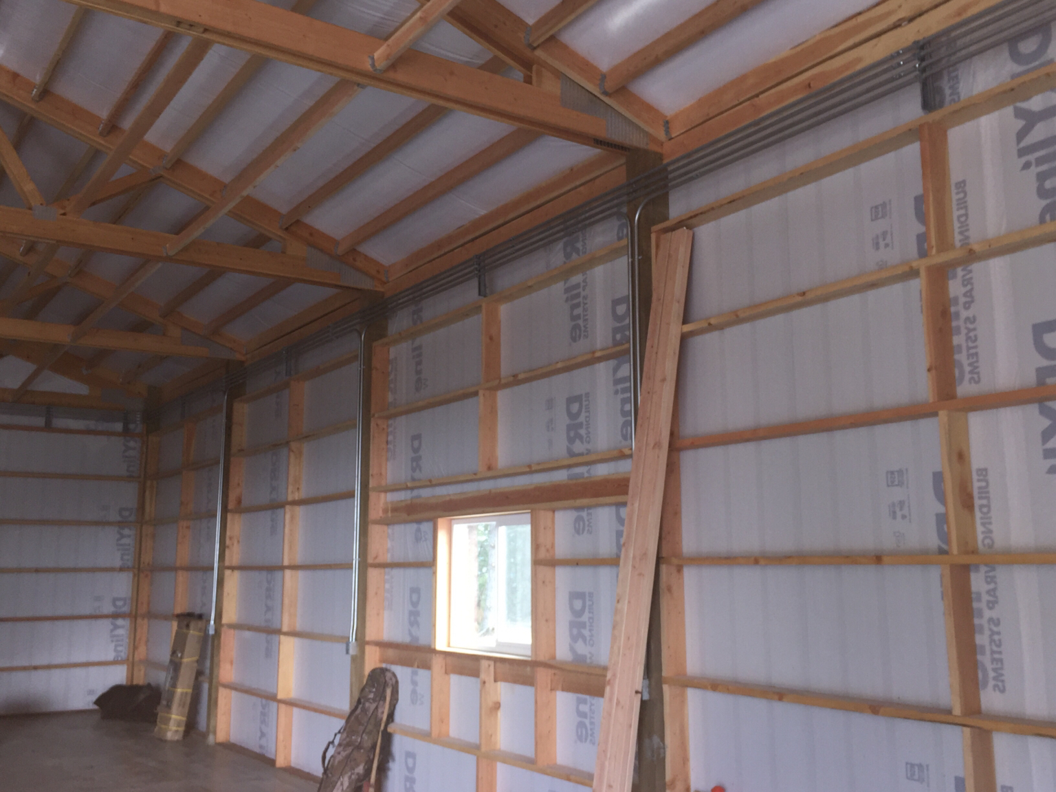

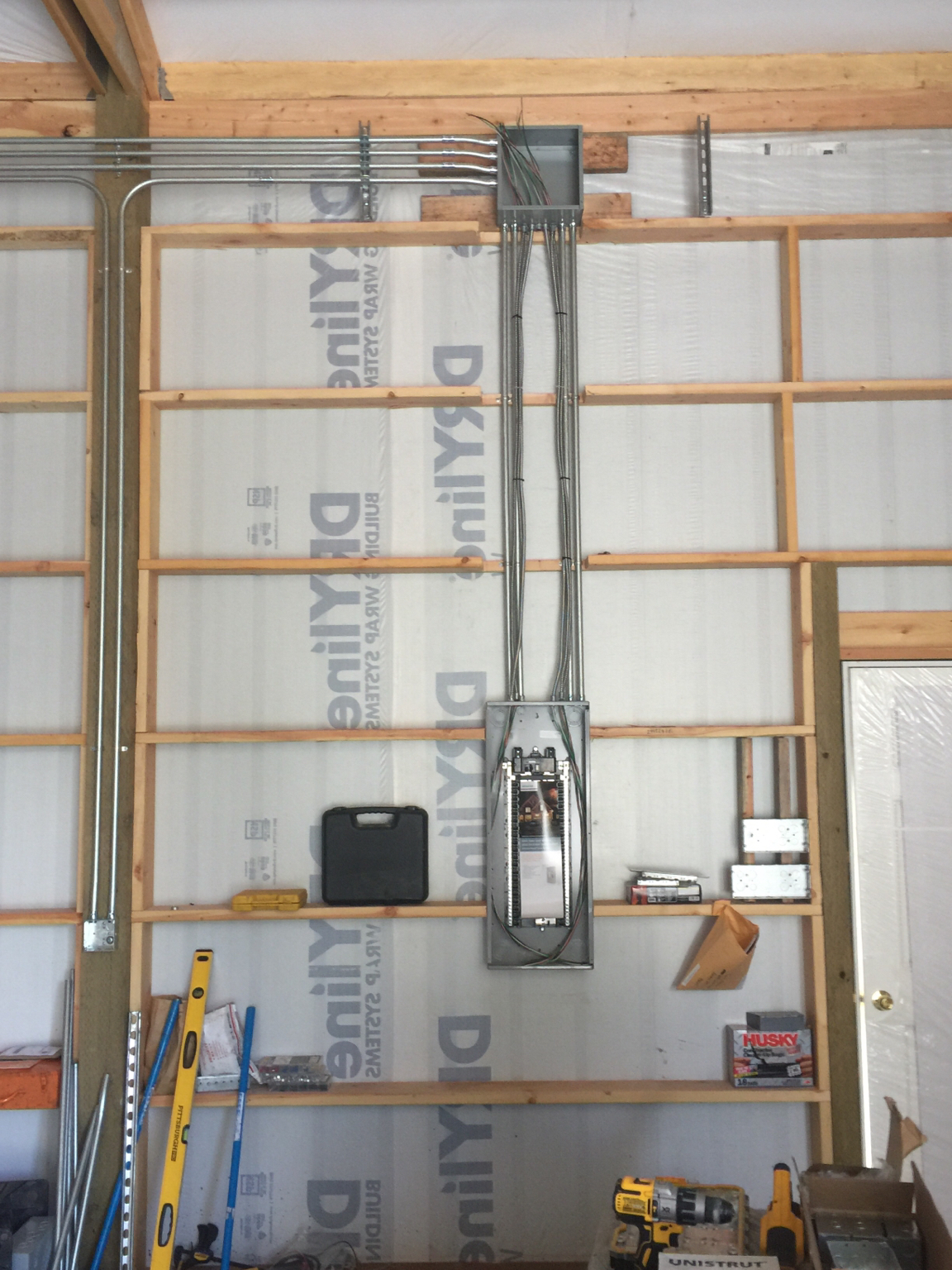

I went the conduit and up/over route- I would argue much easier to expand and or troubleshoot than buried but to each his own Image1534425939.602945.jpgImage1534426017.419790.jpg

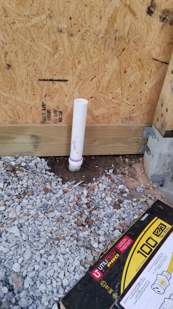

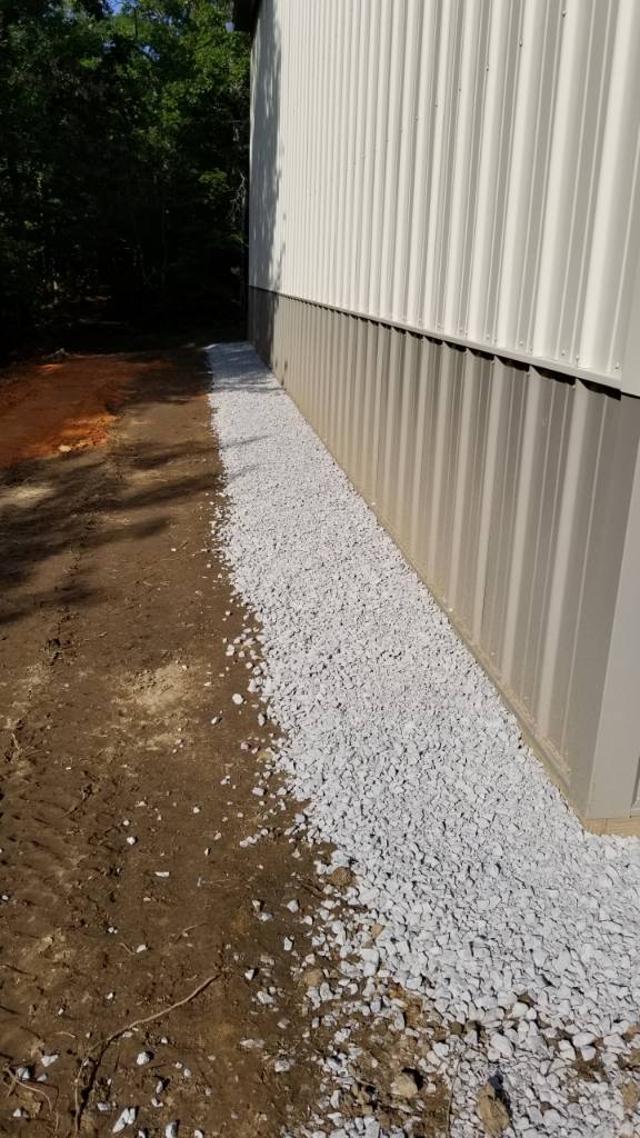

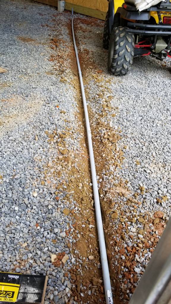

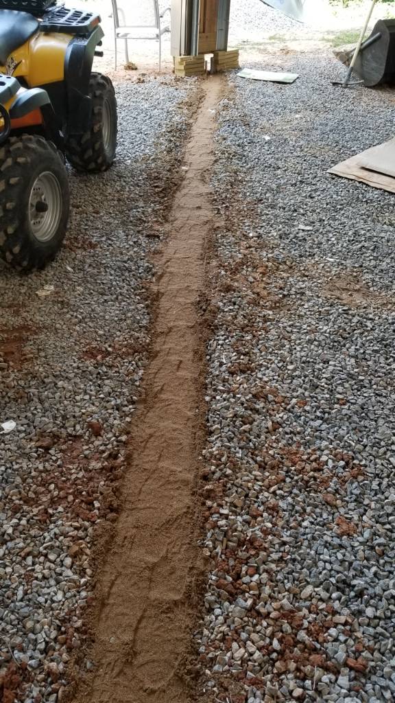

All stoned in on the outside. Installed sink drain and electical conduit for rv 50 amp service. Only conduit I will put under the slab. Since I am building a loft in the back I will use the floor joist to run the conduit to the other side.20180816_093208.jpeg20180816_134257.jpeg20180816_155745.jpeg20180816_165629.jpeg

Agree, very nice looking conduit. It even looks hard piped commercial. Nice.

It is commercial-decided that the cost differential wasn’t significant enough not to step up

Well, you will never have a problem with it, well protected. Well worth it.
