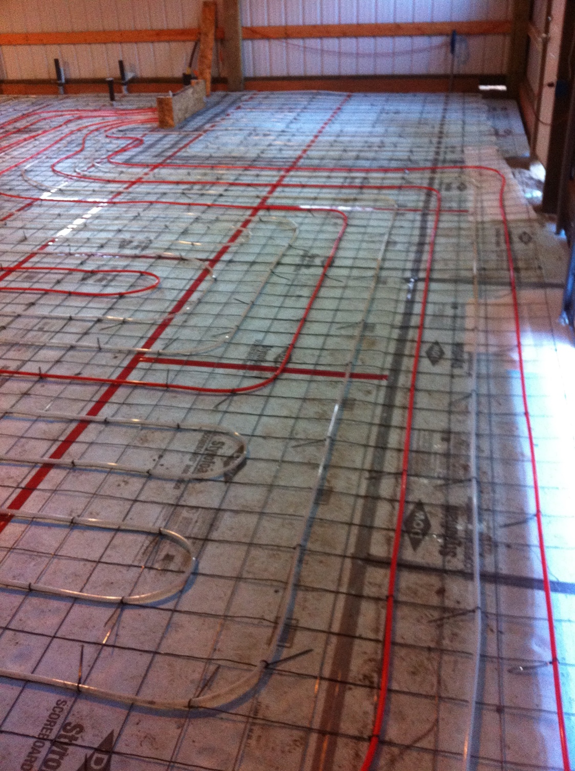

My concrete guy says rebar or mesh doesn't stop concrete from cracking. They help the two pieces from drifting apart.
Says slowing the cure process can improve your odds in limiting cracks. Cracking is caused by water evaporation which shrinks the concrete.
Expansion cuts are to control the cracks. If you haven't filled your cuts you might look closely at the bottom of them for hairline cracks. That's their job.
A solid base holds the pad at whatever elevation and grade it was poured at.
I asked a lot of questions. :)
Of course, I’m sure that there may be cracks in the control joints. It still looks perfect as the day it was done. It could be possibly related to the fact that it was poured & finished when the temps were in the low 30°’s, allowing concrete to cure slower than usual.
The mesh was there primarily for the tubing to tie into.
   / Now ready for the concrete in the pole barn #46
My existing shop floor is nine years old. I caulked the expansion cuts for easy cleanup. I don't have any visible cracks. But I know where they are hiding. :)
Nice radiant heat setup ! I see you only used wire mesh, something I am leaning to . Don't care for the fiber mix.
   / Now ready for the concrete in the pole barn #50
The wire mesh was primarily for tying the pex to. I’d still recommend the fiber mix for a stronger concrete and it barely raises the price anyway.
