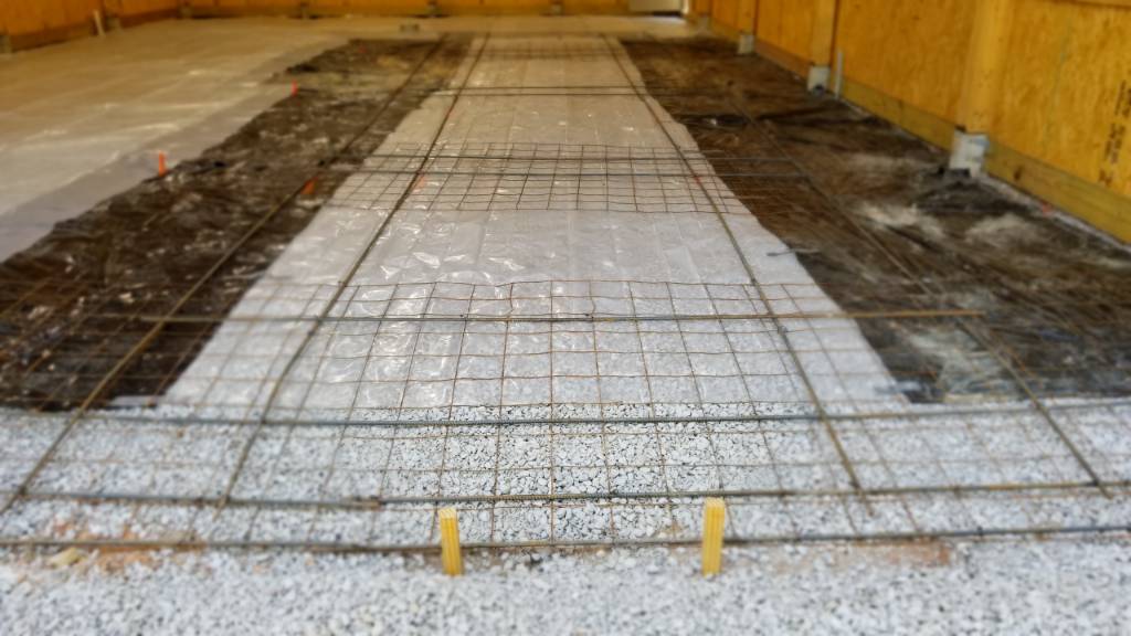

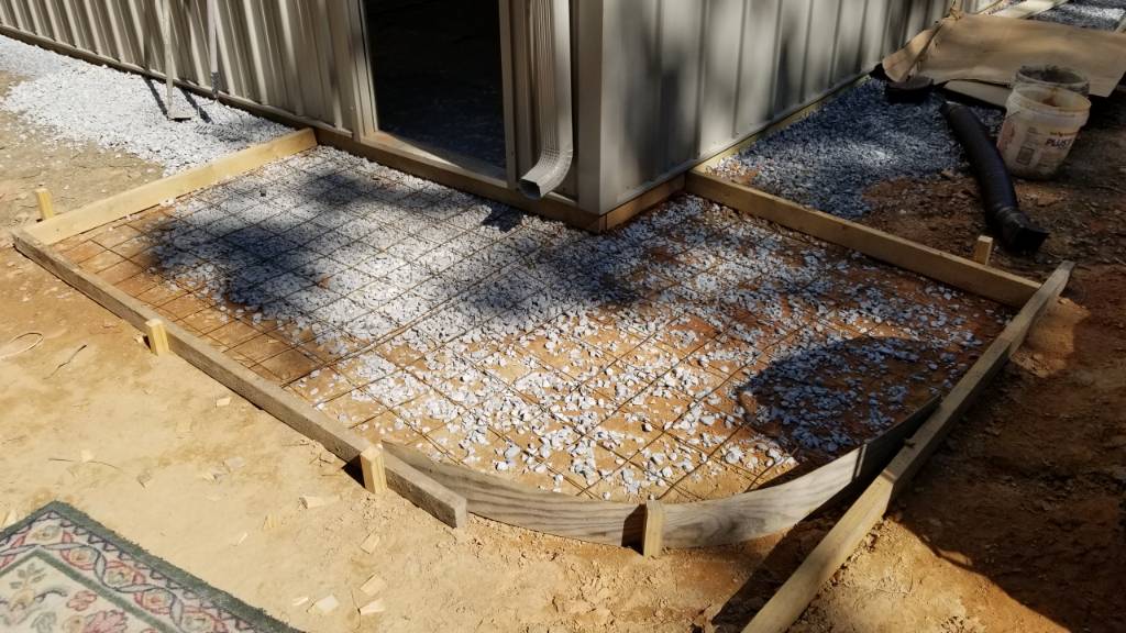

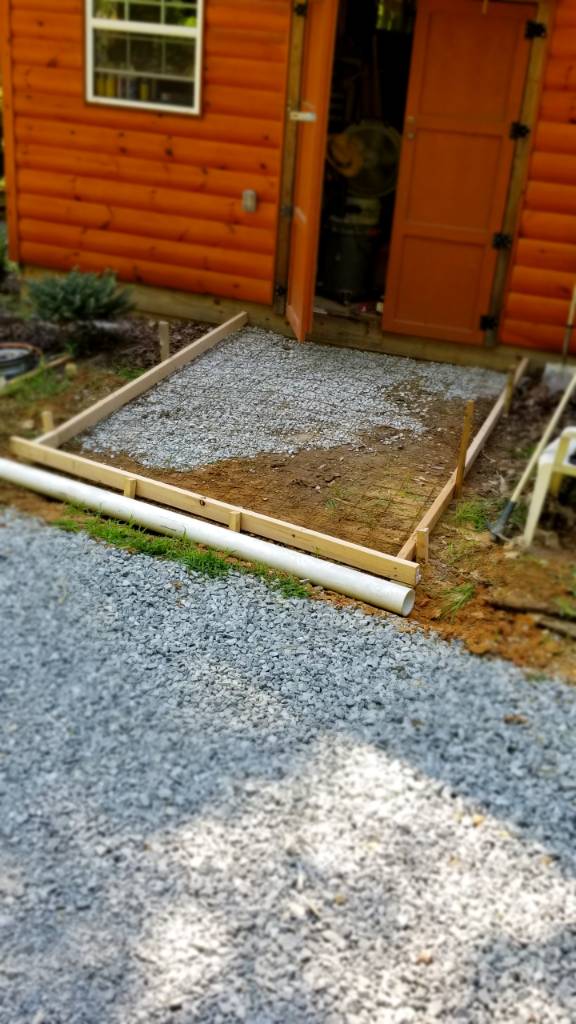

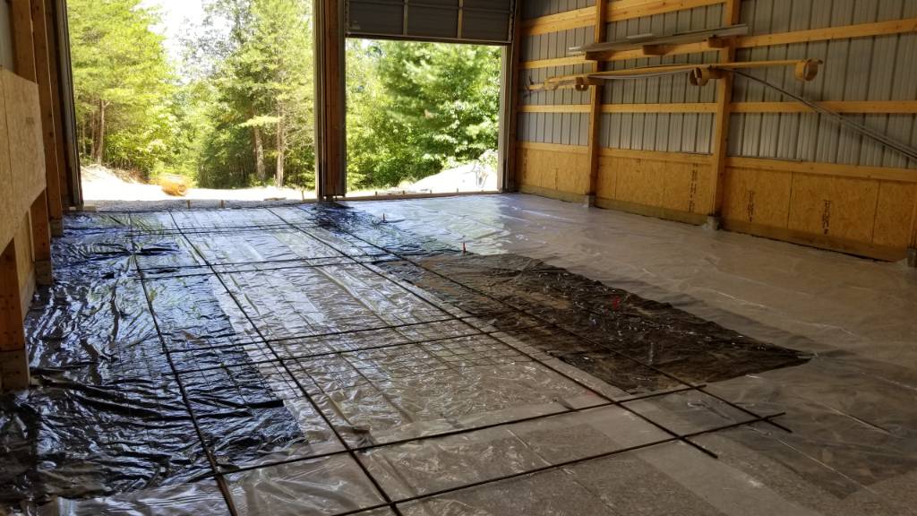

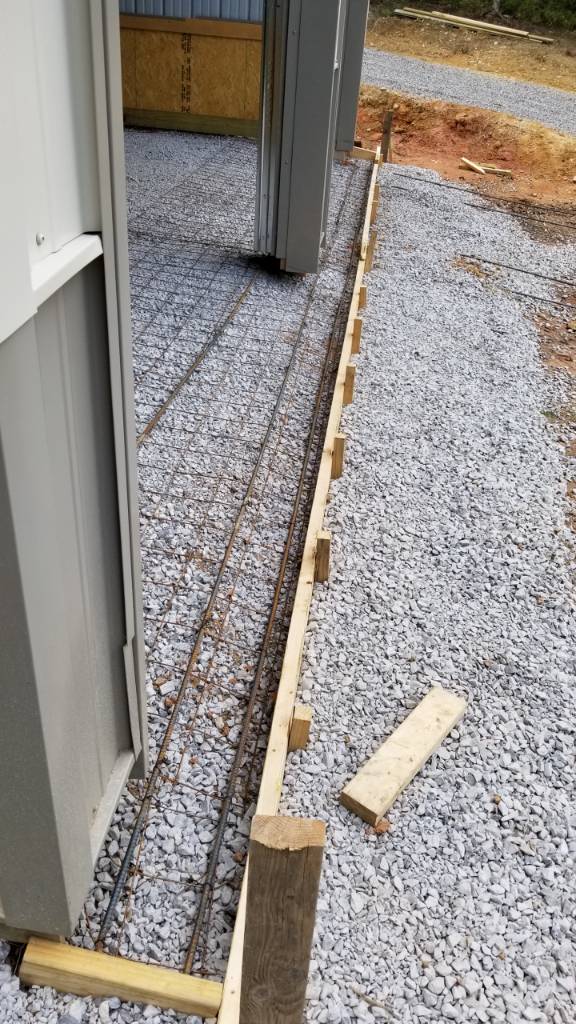

Everything is ready for 26 yds of concrete tomorrow! I only put rebar and wire mesh in certain spots where the rv will park. Plus extra rebar in the apron. entrance. Will also have fiber mix @ 4000psi. 2 extra areas for extra concrete left. I always use plastic for a condensation barrier.

I’d dowel those two outside pads back into the inside pads.
Didn't give it a thought ! Good tip. I will just drill through the grade board and run some rebar between the 2 pads.
