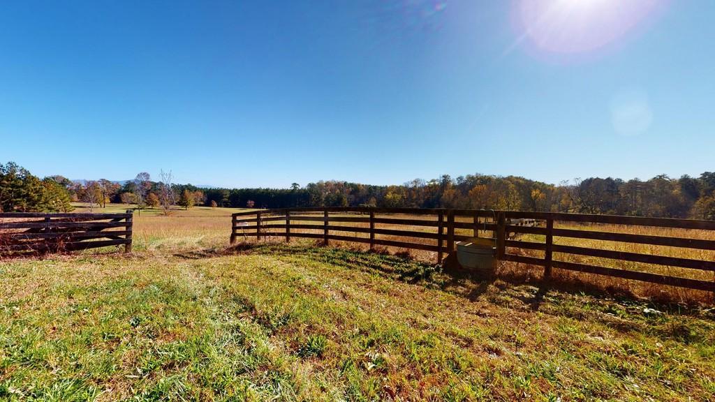

So my wife and I are moving to Tennessee. As many have done lately it seems. Problem is we went from .7 acre to 80 acres :eek: if the deal works out
There is absolutely no equipment at the property now so I have a large portion of my move budget earmarked for a tractor and related items. Problem is I am pretty much a beginner as far as these things go. I have no brand or color preferences and I realize that all the companies make decent stuff.
My problem is sizing, I have no idea what is going to be adequate. I need to cut grass but also plan on planting some trees, not an orchard but some fruit/decorative and maybe more. I also in the future may try my hand at a .5 acre garden (or more who knows). I also have plans to do a meadow and wildflowers if possible, also in the future after I get more experience.
Most of the land is cleared but there are some wooded areas, also some of the acreage has the possibility of getting wet.
It is outside of Chattanooga for reference.

That looks beautiful. With that much acreage to keep in check, I'm guessing you will be using a rotary cutter. I think you are definitely in the 50+ HP area.
Can you check with the current owner and find out what he has been using?

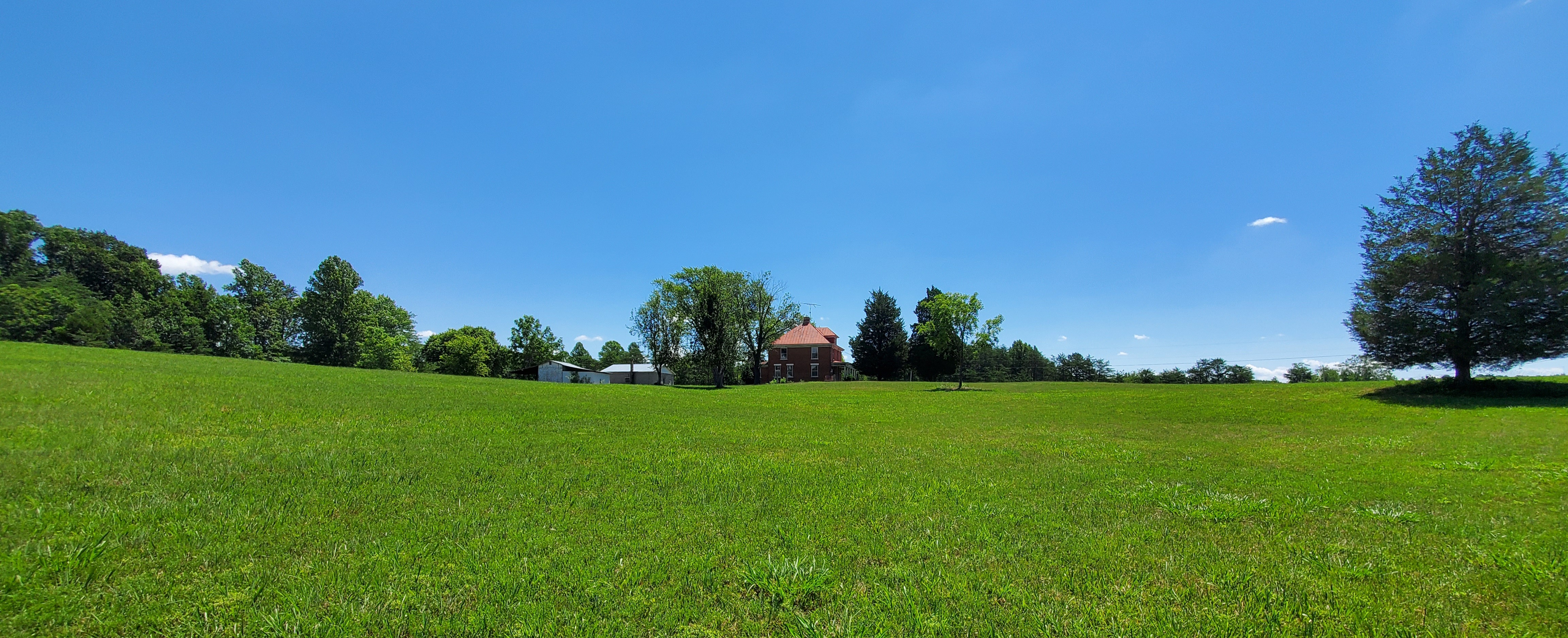

Congratulations on your property purchase, the pictures look like it has been well maintained and offers some great potential.
As far as your future equipment needs/wants I would start with a new (or newer) hydrostatic drive tractor with 4 wheel drive in the 50 HP range. Add a step in step out front end loader with quick attach capability’s, a third function hydraulic system, and independent PTO. This unit becomes the backbone of a your material handling needs, depending on future attachments, from dirt and gravel to pallet forks and log handling with a grapple. Rear end (three point) attachments become more job and seasonal specific from rototillers to snow blowers and beyond.

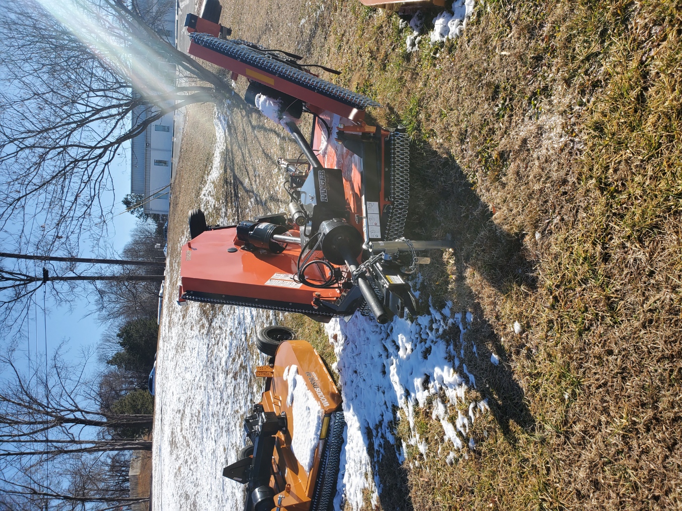

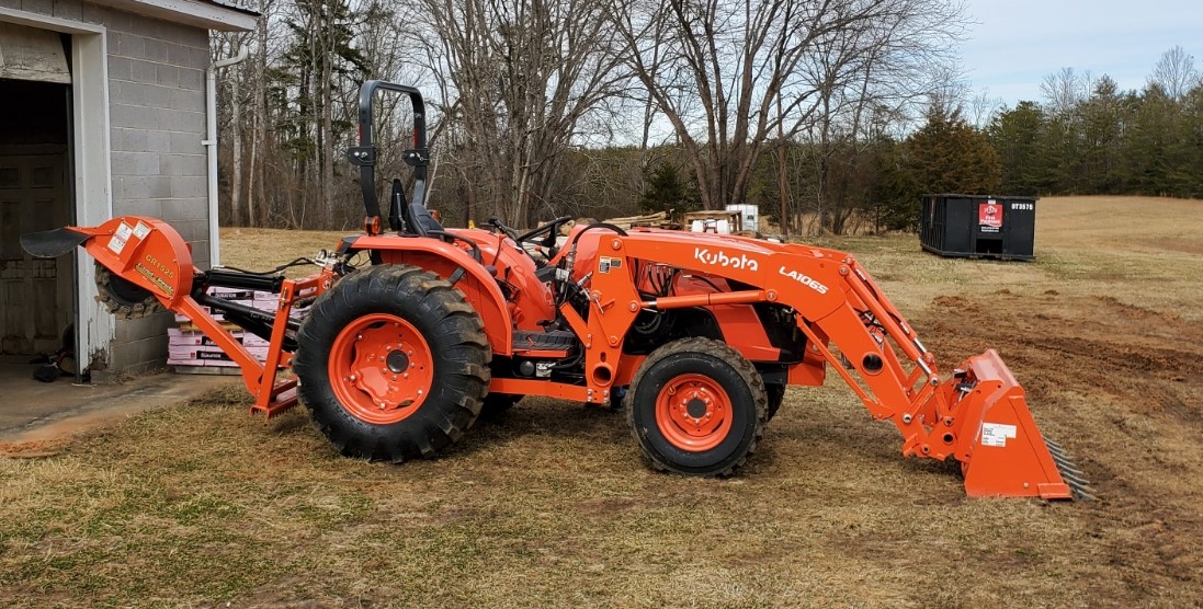

Your in the same situation I was last year. Bought farm property that also has 30 acres to mow. My solution... Kubota MX and a Land Pride 12ft rotary cutter...
