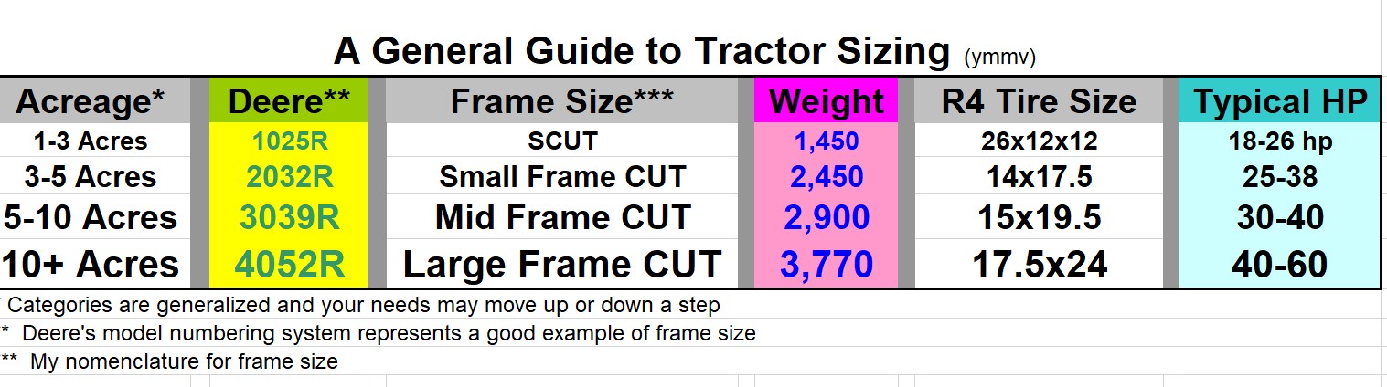

Do not rush to buy. Decide the work to be done. Select the implements to accomplish the work. Then match the tractor (weight and horsepower) to the implements. Tractors are always a compromise. You match the tractor to the primary tasks and usually make do for other jobs. I strongly recommend a front end loader, four wheel drive, and a cab.
   / Now I stepped in it, I need everything #19
I agree with everything above, but am ambivalent about the cab. I kind of like being out in the open air. If I was in TX or FL, I would want a cab and air conditioning.
Your property looks beautiful and well kept. Not sure what your budget is, but TBNrs are always happy to spend other people's money. It looks like mowing will be a large part of what you will be doing. What kind of equipment did it in the past? You are actually going to enjoy doing it, so it's not the end of the world if it takes a little longer. You can manage it well enough with a 5' or 6' rotary cutter. You can obviously do it faster with a 7', 8' or 12' mower but that is going to cost substantially more for tractor an that and other equipment.
If you are new to Compact Utility Tractors (CUTs), I Would take the time to test drive several different brands and models first just to get the (zen) feel of things. John Deere would be a good place to start because their Model numbering system has a certain logic to it.
1xxx series - Sub-Compact (SCUT)
2xxxx series - Small Frame CUT
3xxx series - Medium Frame CUT
4xxx series - Large Frame CUT
If I was lucky enough to have your property, I would be looking at a 40-60hp Large Frame CUT with a 6' rotary cutter (or 7' flail mower).

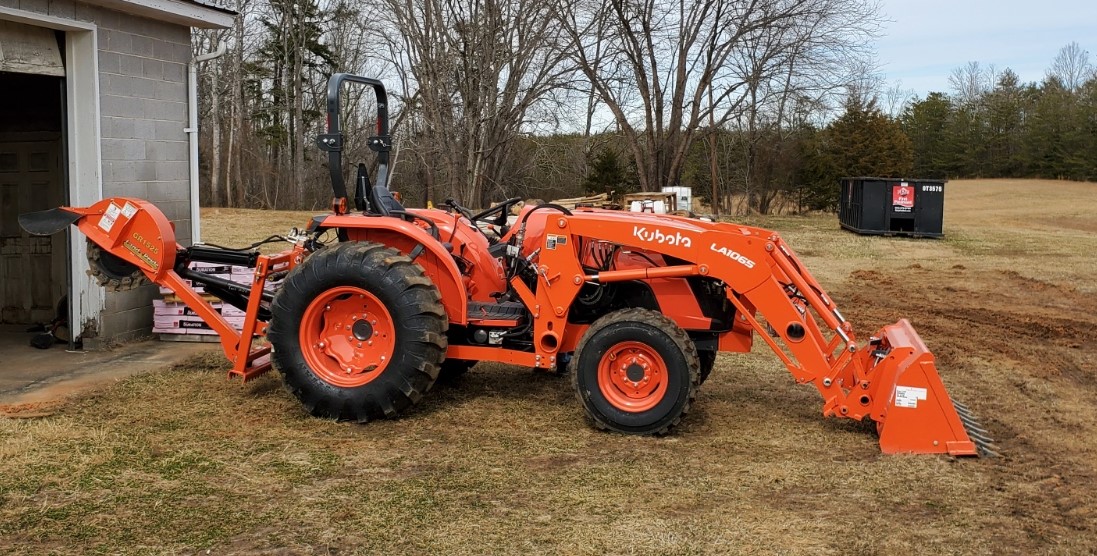

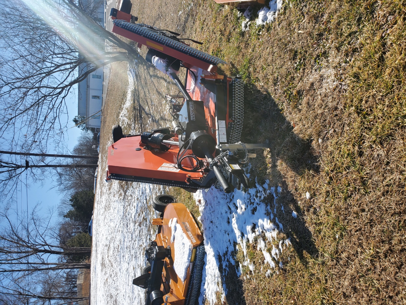

Your in the same situation I was last year. Bought farm property that also has 30 acres to mow. My solution... Kubota MX and a Land Pride 12ft rotary cutter...
