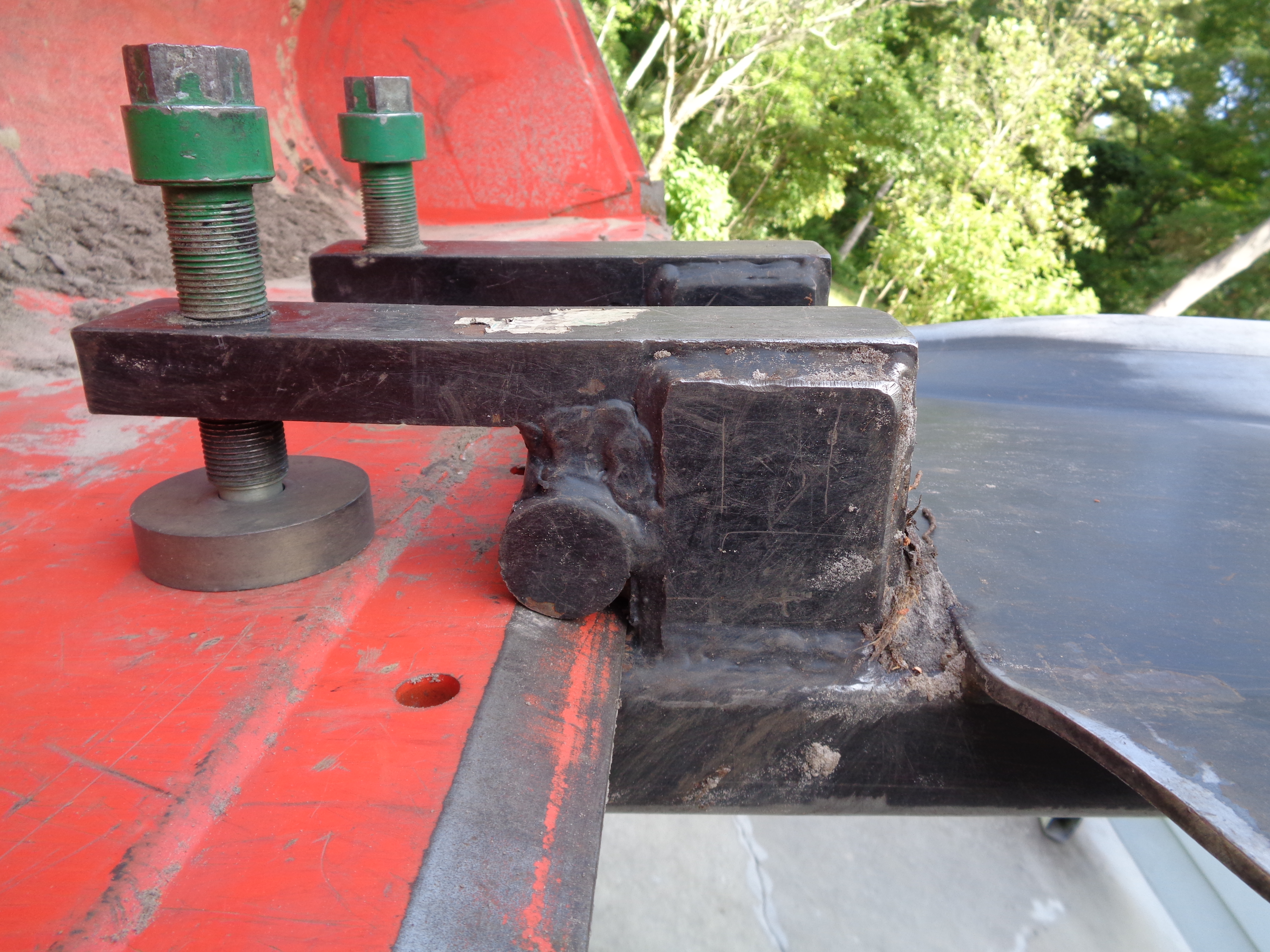

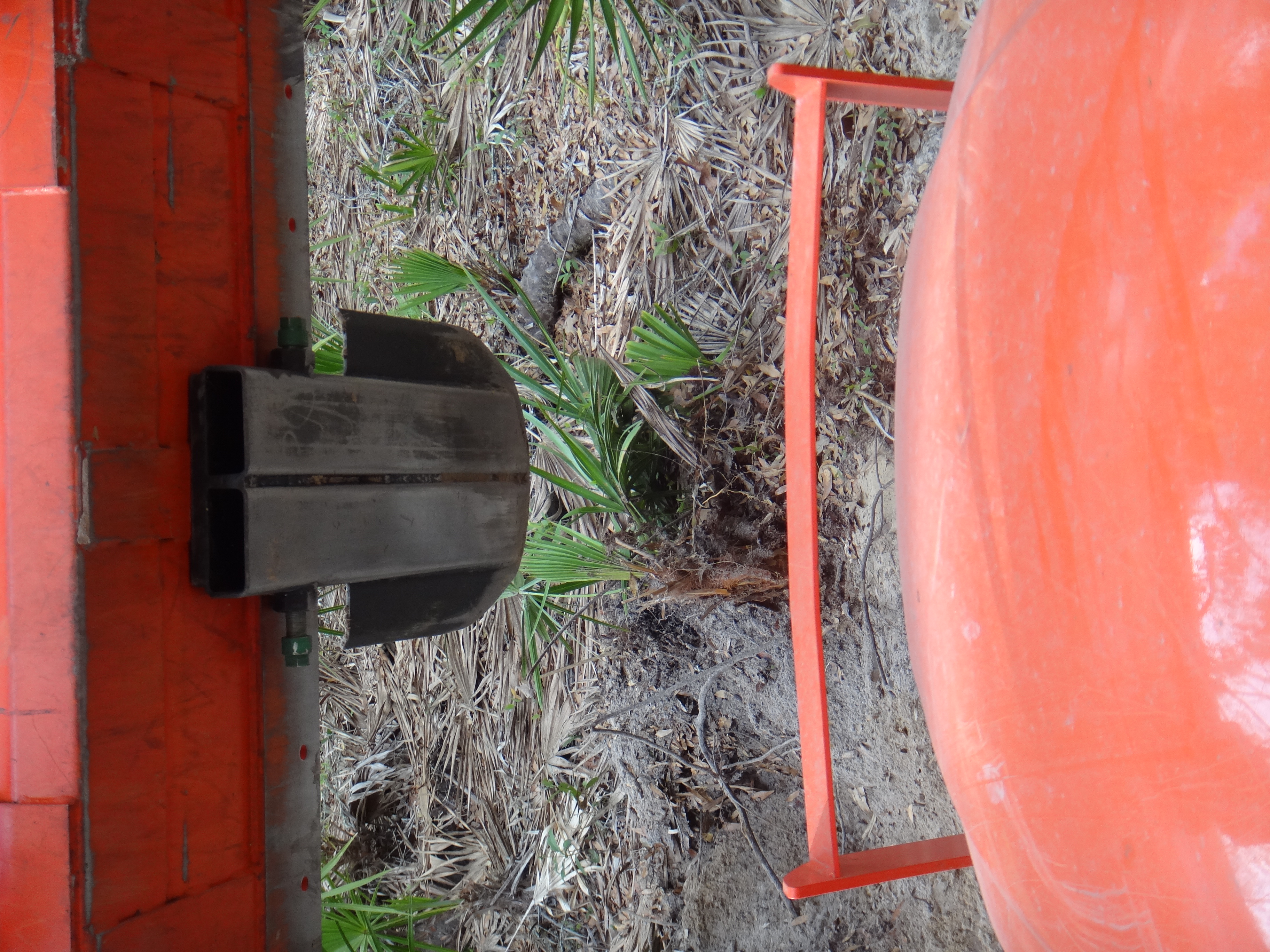

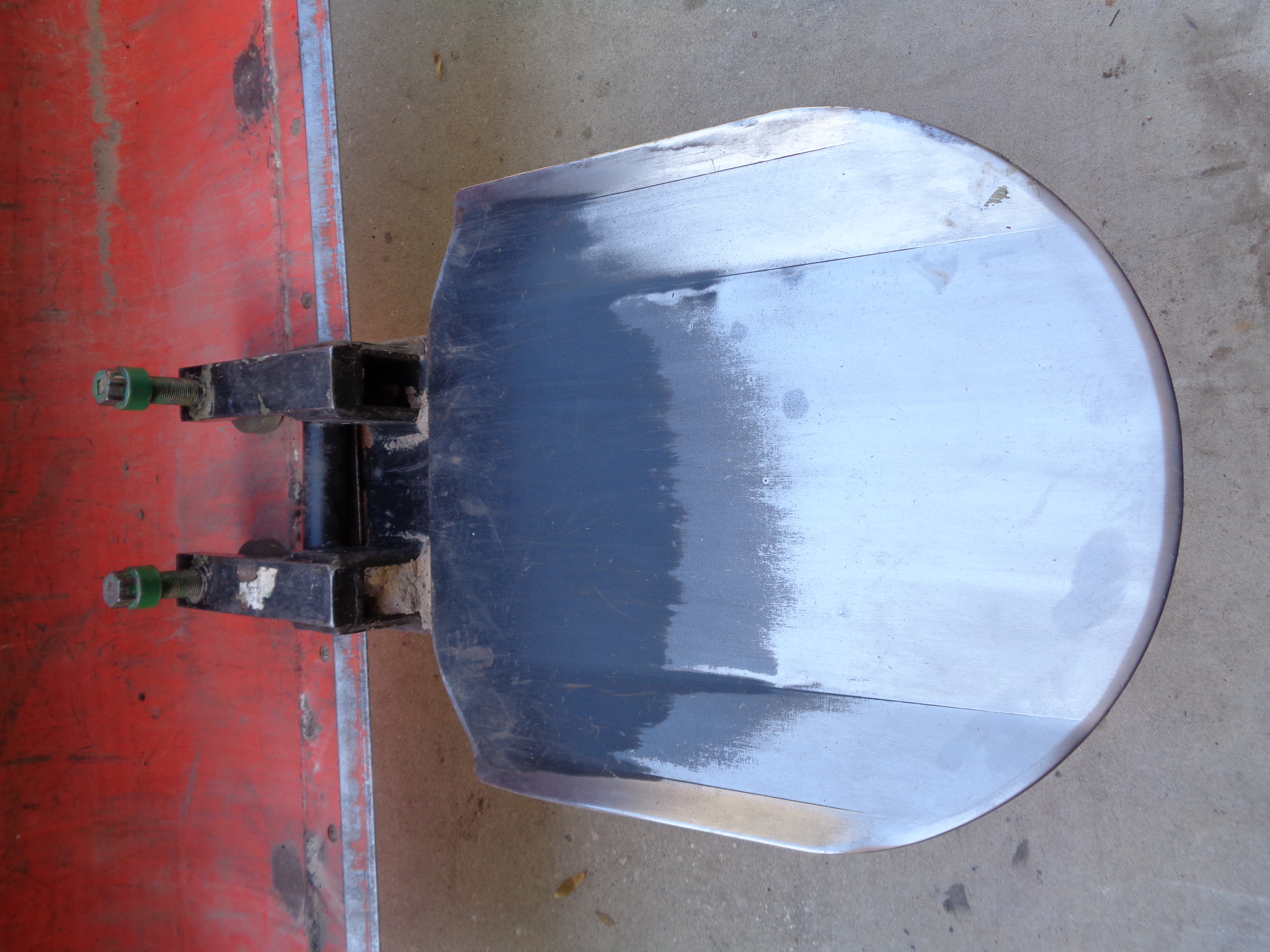

the implement pictured below would last about 10 min on an M series. maybe ok for sub/CUT but worthless imho for any serious tree planting. there are other options.
I purchased the Bucket Solution's (brand) Bucket Spade ten years ago for use on my first Kubota, a B3300SU. Sold the too light B3300SU two years later and purchased my Kubota L3560. I have used the Bucket Spade for planting trees and excavating Palmettos, other palms and grossly overgrown twenty-year old Blueberry bushes for eight years on the L3560 bucket. Certainly at least 1,200 in number. The Bucket Spade appears as new. The bucket has minor paint scuffs where the spade pads compress.
PHOTOS #10 - #11 - #12 were taken during March 2020.
My L3560 is 3,700 pounds bare tractor weight. The Kubota Ms are 5,000 pounds bare tractor weight. In my opinion the optimal bare tractor weight for utilizing a Bucket Spade is 3,700 to 5,000 pounds bare tractor weight, a range which includes Kubota Grand Ls, MX series and M series. Hydraulic power is of secondary importance in operating a Bucket Spade. Tractor weight is the most important factor as the spade is driven into ground with tractor wheel power. After first insertion the ground is loose.
The spade is 18" wide, billet forged, not stamped; weighs 130 pounds. A little ponderous for my 73 year old body to attach.
Minimal storage space required when spade is off the FEL bucket.
Being able to excavate in front of the tractor and move the tractor normally between digs is effecient.
Bucket Spade opinions posted on T-B-N from those that own them and use them are favorable. I seem to be the most experienced Bucket Spade user posting here.
MORE: https://www.tractorbynet.com/forums/attachments/328798-bucket-spade-today-fel-bucket.html
