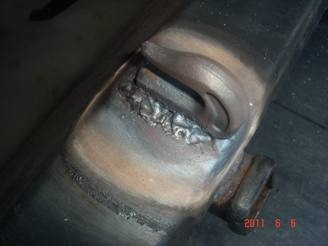

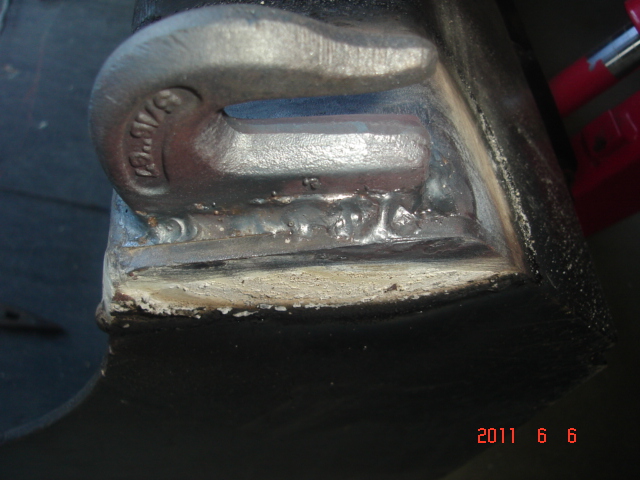

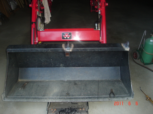

Didn't know if I wanted to put a pic of my welding on here, I'm strictly a beginner!
But I decided that I just couldn't live without hooks on my FEL any longer, and I don't have a large arc welder so I grabbed my oxy-acetylene set and started out....
Did the first hook (center) with my right hand on the right side, then tried the torch in my left hand for the left side; won't try that again. Not pretty, but I think it'll hold OK. Second hook went better, had a better idea of how much heat to use. One more hook to go.
Any comments? (How'd the student do?)
Should I even bother to try the wire-feed I have, or would that just not be up to the task? (It's a Lincoln 115V SP-125 PLUS with no gas, just flux-core wire.)

Don't know if the Lincoln would be up to the job but I'd say your welds look good for O/A.
They should certainly hold.
When I have ****** welds I smear some "No More Gaps" in the cavities prior to painting - no one will know!

Oh sure, let our secret out to just everybody!:D:D
Really I think most of the welds look pretty good, the left handed one is not as pretty, but you knew that. I bet they stay stuck!

I have a Lincoln Pro 100 wire welder and I use it for everything (including my bucket hooks). I have welded 1/4" and even thicker with it using multiple passes and it works, although I throw the breaker a lot on thicker metal. It's what I have so I use it and so far all my welds have held!
I'd say give yours a try, but make sure to use good wire in it (like Lincoln-branded wire). It makes a big difference. And for the record, your torch welds probably look better than my torch welds would...

With a little grinding and a cover pass of flux-core that left side weld might look better. You might even use it all around to spruce things up.
/ Not pretty, but... #6
The first picture looks the best, but you need to add more filler to the crater. All the other welds I'd grind out and do again! ;)

I second that !! Cleaning it up & knowing it won't fail is better than hoping it won't fail & being wrong. MikeD74T

Thank you all for the great suggestions! I really hadn't thought of adding wire feed as filler before painting.
HiTechTed, thanks for the tip, though I have no idea what brand the wire is- bought the machine used, for a great price.
I, too felt it was more important to get deep penetration (don't we all wish for that- oops, sorry!) than to have it look good, though a smooth appearance is nice. I made sure metal was good & hot and almost melting as I was adding filler; that much I learned --the hard way:laughing:-- from the class I took a year or so ago. Saw a couple of my "jobs" pop right apart with a moderate hammer rap.:ashamed:

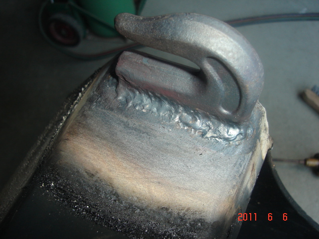

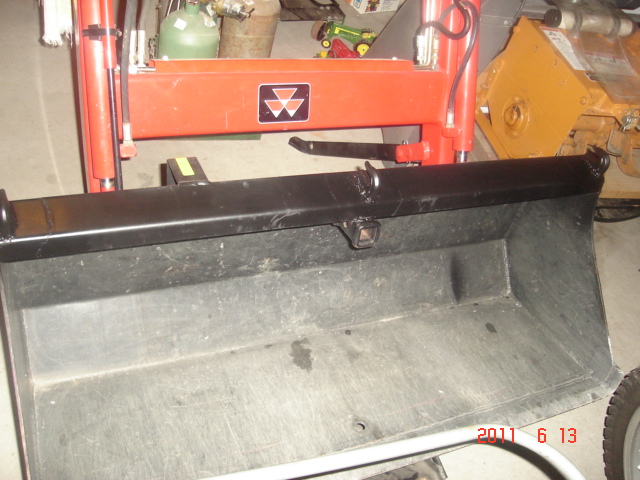

OK, last hook is done, some paint sprayed on...
Decided to stick with the gas welder. It came out much better than the other two, here's a pic of the "bad" side. Practice does help!

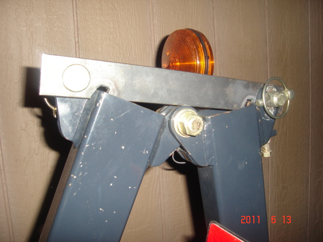

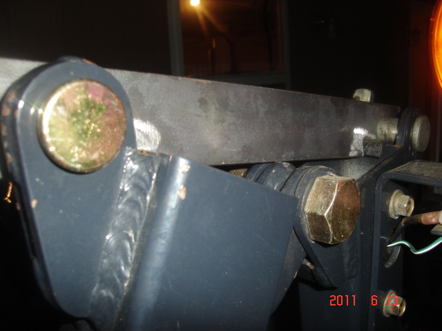

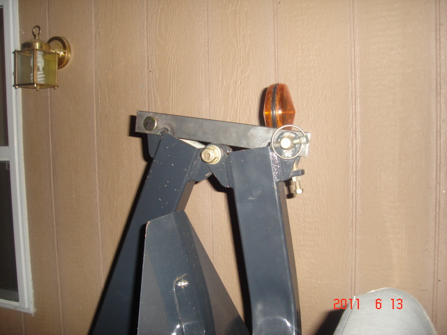

While I had the torch out, I threw on the cutting tip to notch a couple of bars I made up to hold the ROPs in a sort of half-way position, so it would stay out of the way of the 3PH while not having to raise it, lower it, raise it again, etc... (Did I mention I crunched the garage door opener last week with the ROPs up?:ashamed:)
Seems to work quite well! Holds the ROPs at about a 40-degree angle.
Thanks again to all for the tips & advice!:thumbsup:
#13
"You're satisfied with that?"
To quote Arlo Guthrie, "I knew that it wasn't the best song I ever wrote..."
I think so.... though I'll admit it doesn't look it, it did melt up & into the hook.
(Why- does it look that bad?:()
And here's a question for you welders... I was wondering if at least part of my problem with cratering was a result of the force of the gas flow out the tip. I used the biggest one I had, but that was a Linde #15. I had to really crank up the flow to get enough heat. Would a larger tip have worked better? (Same heat, but lower gas velocity?) It seemed that the puddle was often blown away by the jet of flame.
/ Not pretty, but... #14
That could be, I know a few times I've O/A welded with a large tip and I had that happen.
In my opinion you're on the upper limits of O/A welding!
Personally I wouldn't trust that hook with much of a load, if you were closer I'd re-weld it for you for free! But then again you may not trust my welding! ;)
#17
I probably spent less than ten minutes of actual welding time on each one, but did end up using about 5 feet if 3/32" filler rod. But keep in mind- I'm slow!:laughing:
I think one of the reasons the last pic (last hook) looks so flaky is that the only spray paint I had around was Semi-Gloss-- too shiny!:p
That Linde #15 I used has a hole in the tip that's about 1/16" --maybe. I think it may have been a bit small for the job- any thoughts?
