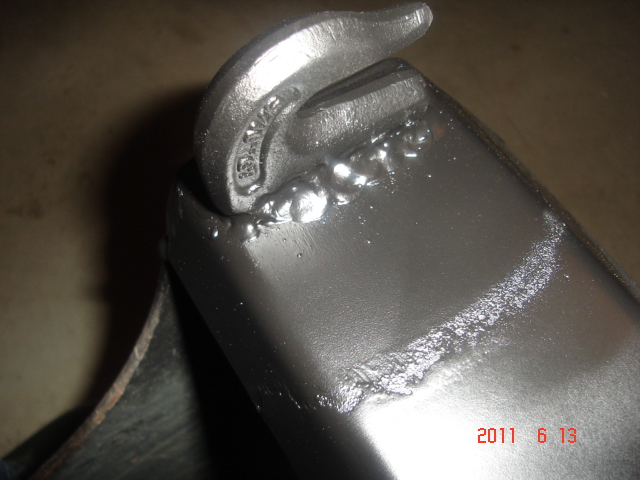

So O/A welding is suitable for structural work??
I think of it more for sheet metal, light gauge etc. never would of thought of O/A for install a chain grab hook.
I have a O/A set up for cutting, and I even have the brazing torch head but have never even tried it. My buddy borrowed it years ago to do some auto panels on a restoration and left me with a couple large packages of brazing rod with white flux on them. wonder if they are still good?

I sure ain't no expert, but I do know you can melt steel with O/A. If that's possible, you can definitely weld.
When I took my class a year+ ago I concentrated on that, as that's what I have, and got to be fair at it, with no filler. Those hooks, however, are angled at the base and require filler.
If you can get everything to the melting point and add the filler, it works. I was given some "plain" mild steel rods for that use, and they seem to have worked OK.
The trick (as I understand it) is to get both pieces at the melting point (3 pieces, if you include filler) and allow the steel to flow together, forming a monolithic bond.
At least, that's my understanding- in practice, well, it just takes practice:cool:.... I'm sure not saying my joints are great- but I think they'll hold.

Looks good enugh for the job.
/ Not pretty, but... #30
what type of filler rod do you use for steel? also I have a brazing tip I assume this would not work for steel,...:confused2: or am I wrong?
Jeff you can use rebar tie wire, or steel coat hangers. Or your local welding supply will have O/A filler rod. Yes your brazing tip will work to weld steel.

Any steel wire will work as a filler. Old coat hangers were a little fatter than the new ones. Bailing wire (re-bar tie wire), coat hangers are all fine. No flux is needed. Welding flame is important, you want netural or a tiny rich, never and oxidizing flame, it will ruin your weld.
