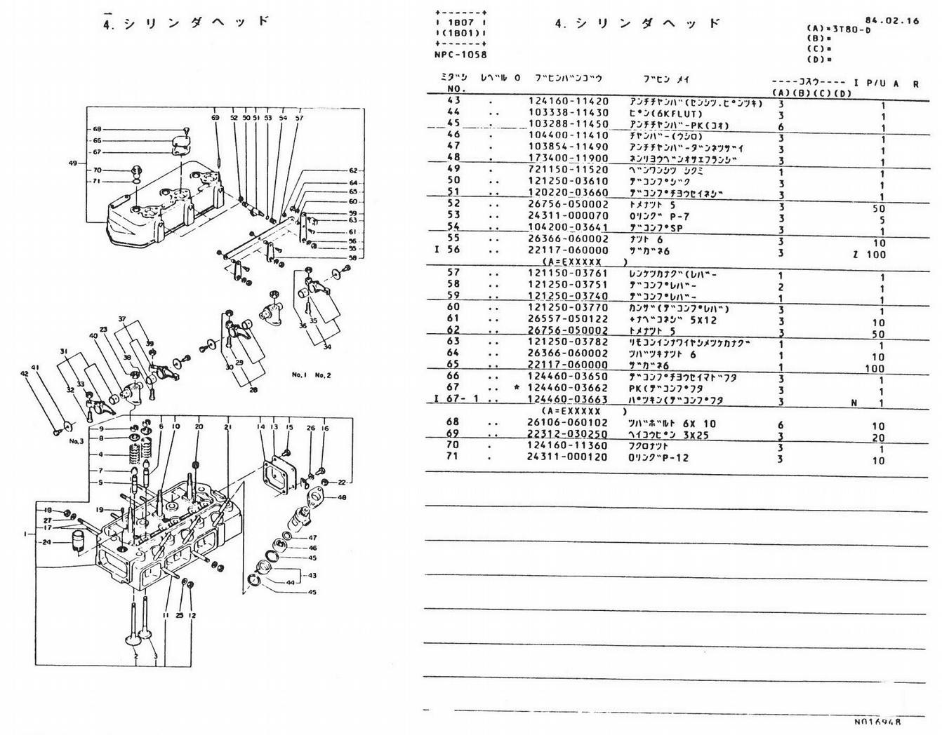

Your regulator shows on page 14. If you look at far right hand side you can see the edge of the regulator.

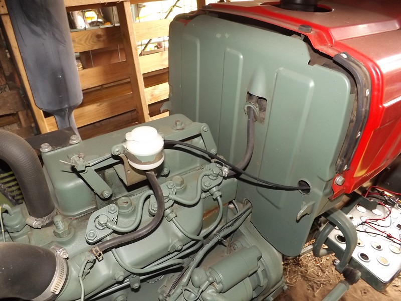

ah ha, that isn't a YM2610, that is a YM2500 setup. The thermostart reservoir has 2 hose connections whereas the YM2610 has only one. I have nothing on the engine side of the firewall either.
(Grabs camera, walks out to tractor shed, will be right back.)
/ Not Charging #31
That is a slick firewall. Old age is hampering my abilities. That was a picture of a 2310.

My bad, drawing #14, page 28. I edited last post.
Nice.
So, it does show up in the manual, but not displayed for it's location. Item-9 124550-77710 and the description does have this; TL1Z86 Which in turn is a Ford tractor or old Ford truck VR made by Hitachi. SpareX on Amazon has it for 1/2 the price of Fredricks or Hoye even. AND it looks like the modern solidstate version Fredricks shows on their site.
No problem. :)
If you look at the bottom of the FW, you will see on mine the wire-harness going in the bottom horseshoe cut-out. It then travels back up to behind the dash panel and the VR sits in there. I'll have to browse the JD850/950 manual too. IF the VR sits in the same place, then I know it's a JD requirement that Yanmar didn't typically do. Thus, it makes the Yanmar/JD models more similar than I even thought.

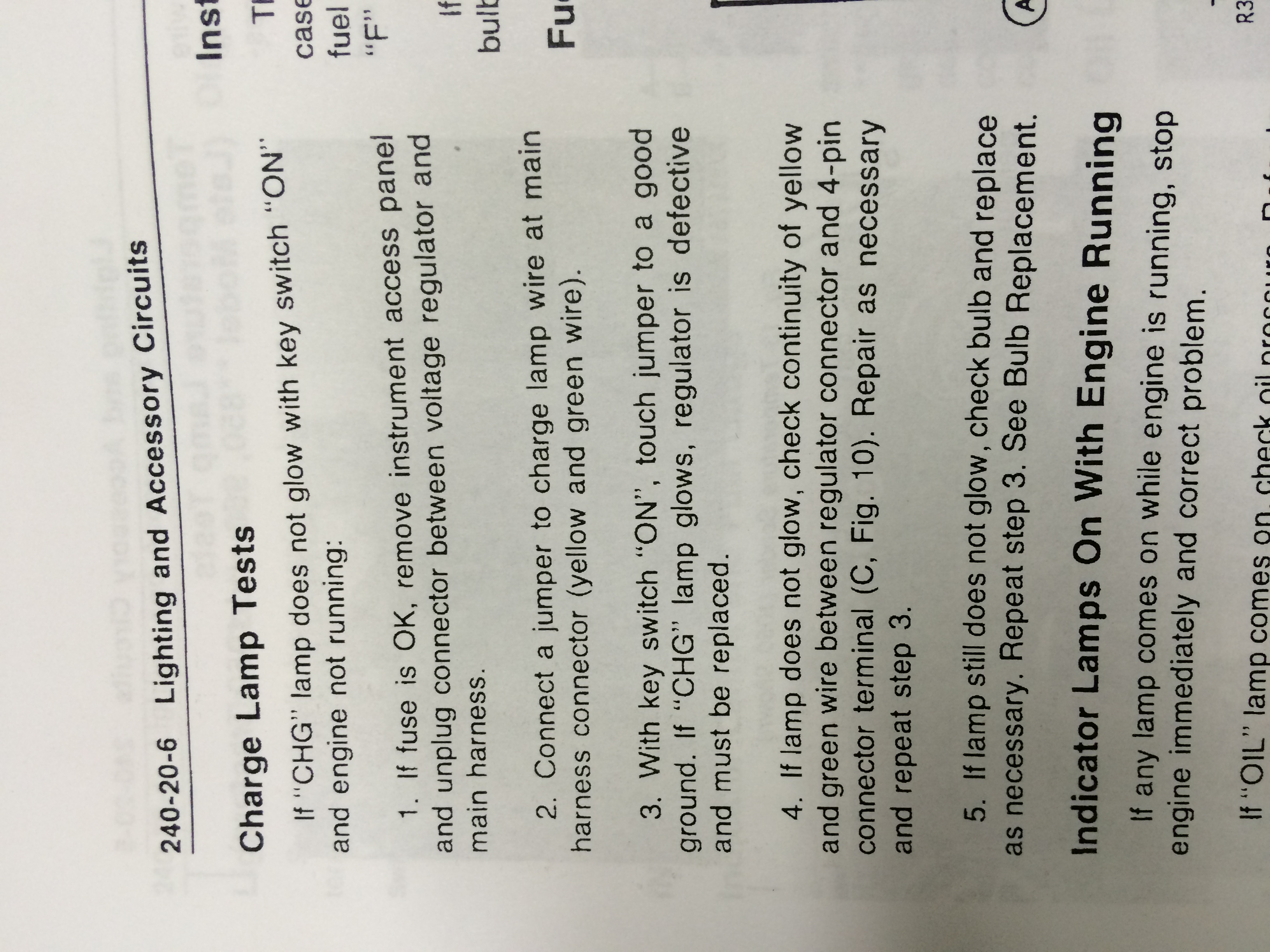

Ah ha, my hunch was right. To keep the complexity down and things common, Yanmar made the YM2500/YM2610/YM4300 to align with JD 850/950/1050
Clemsonfor,
The above also mentions how to test the alternator on the tractor. See if that applies to your model too.
/ Not Charging #36
Found a neat method to test the VR vs. the Alternator from the John Deere side of things.
/ Not Charging #38
Those two scans are excellent information!
What's your source? Is that the Deere version of the IT Shop Manual?
It's from the official TM1192 John Deere Service manual for the 850/950/950C/1050. PDF alone is over 350Mb. HUGE.
