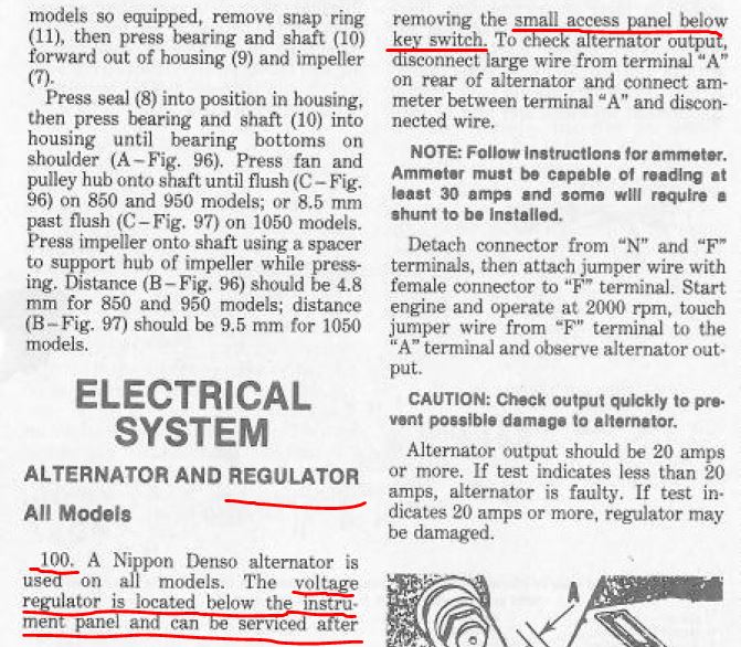

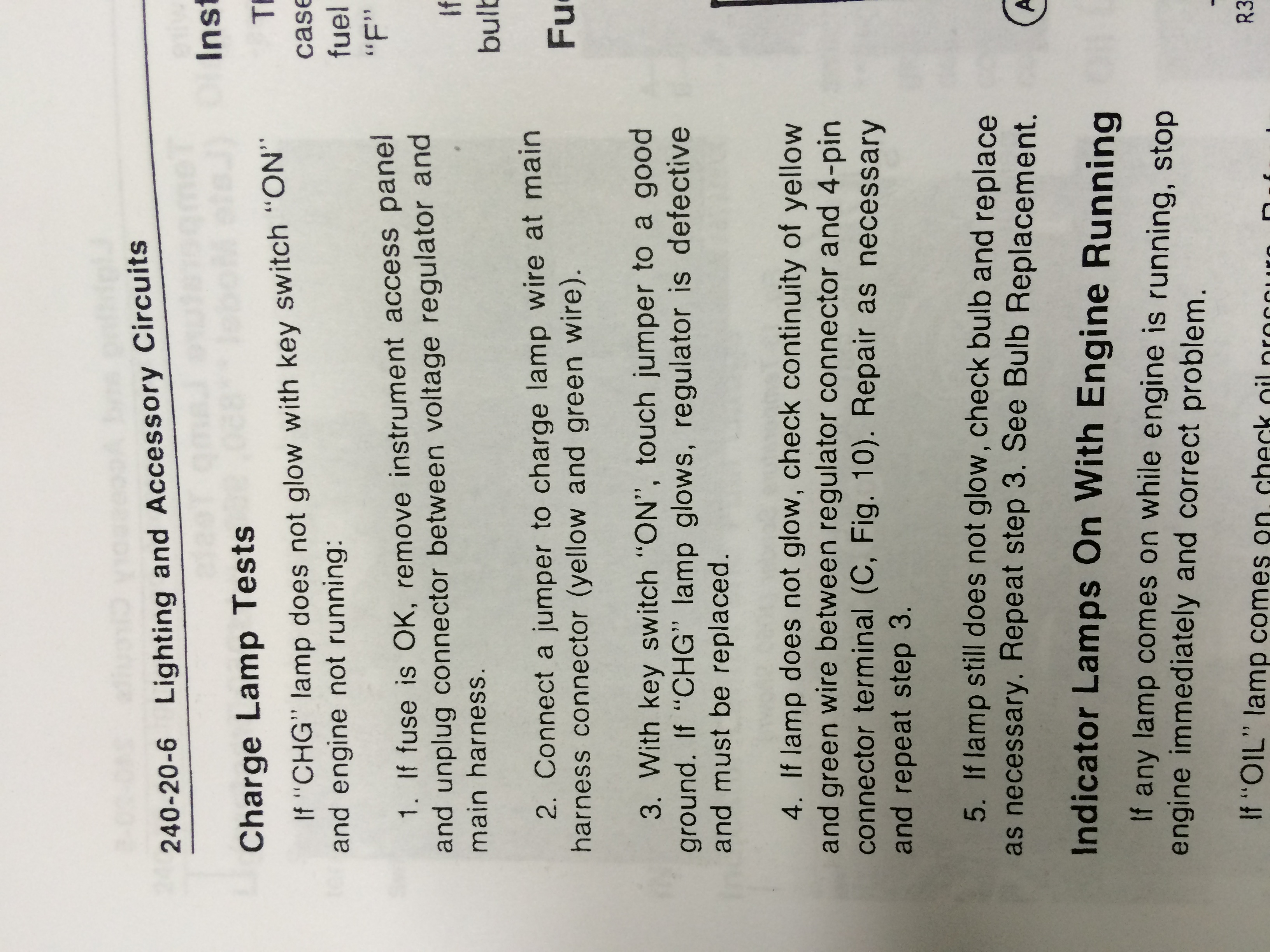

Ok we can bring this to a conclusion. New AC Delco reman arrived yesterday. Swapped it just now. Swapped pulleys from my original because it has a smaller diameter. The alternator was bad. From high idle all the way through working RPMs I now am showing 14.01 or so at the battery right after startup. Must have been like someone said a busted diode or something in the alternator. One oinnon the old one would show up to 20v or so but it must not have been turning it into voltage to send out of that alternator cause at the battery connection at the alt all I got was battery voltage and at the battery while running I never got more than battery voltage. I can bring this long drawn post to an end.
Anyone searching for parts see a few posts above where I listed the application. I got it shipped to my house for I think just over $40. I can't remember all the numbers right now. I think the alternator was $32 it so. There was a $6 core or something on it and an instant $7 rebate from AC Delco. And I paid10 to ship it and a set of spark plugs for my old truck to the house. I am pretty sure I have to cover return shipping for the core so it really doesn't make sense for the amount of this one to return it. But I will check for sure.
Thank you again to California for his excellent knowledge and documentation of the parts that swap.

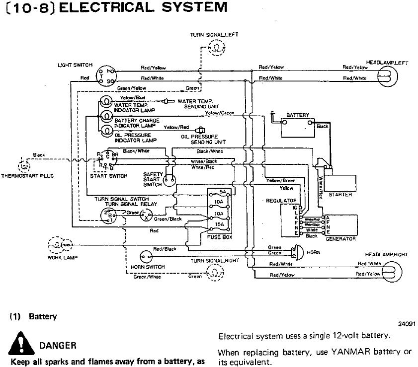

And here is the YM186 wiring diagram, that uses that alternator. The diagram is likely applicable to similar Yanmars.
/ Not Charging #78
Pretty straight forward still on a YM 2000. My dash light would flicker!! Chased that for months and finally stumbled into it. Loose bad connection on my fuse panel. More corroded than I would have thought. That was more of the problem. Still ? how I found it!!...... Drove me nuts... Here is the 2000 dia. I just had out for anyone who may need it!!!!
