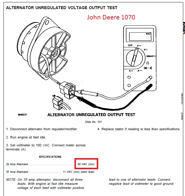

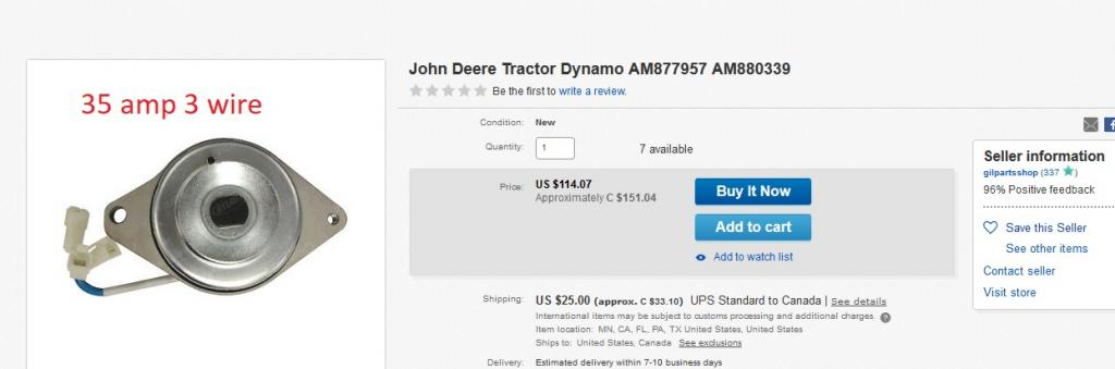

Soooooo, with this DYNAMO can the Yanmars UPGRADE from the 15A to the 20A version ???
Description: This permanent magnet alternator (Dynamo) is an externally regulated 12V, 20 Amp, Kuksan Denki Type. It is used on John Deere 670, 770, 790, 870, 970, 990, 1070 and 4610 Compact Tractors. It also has applications in John Deere lawn and garden products. It replaces original part numbers; SE501822, SE501843, AM877557, AM876055, AM877050, AM879144, MIA10338
Alternator Part Number MIA10338
The question is the cross reference and mounting holes. hmmm
A whooooping 5 more AMPS !!!
/ Not Charging #109
Found these Deere p/n too for a 12VDC 35Amp version !

Congratulations on getting it running!
If it is a dynamo with brushes, shorting the wires may have "arc cleaned" the brushes/commutators. I don't know this model, but if it is serviceable, I would consider lightly cleaning the brushes and commutators. Fine emery paper is all that you need.
FWIW: A second thought. I would also consider sanding the mounting holes / bracket to make sure that you are getting a good ground. Ditto the negative cable on the battery and the voltage regulator mounting/ground. I have found lots of electrical gremlins that were traced back to poor grounds due to rust, corrosion, and loose screws. For the major ones; the mounting bracket, battery ground, I put a thin film of copper dielectric grease on. (Fix once, and forget school of mechanics)
