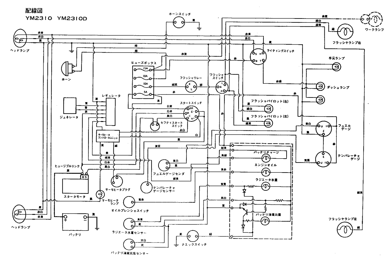

Okay, update now. Put on a new regulator from Hoye/ASAP tractor parts. Didn't change anything. Any suggestions on next troubleshooting steps? Looking at my wiring diagram it looks like I have two wires from the dynamo to the regulator, one wire that goes to the battery connection on the starter and a ground wire. Two other wires appear to go to the dash and fuse block. Dash light doesn't come on

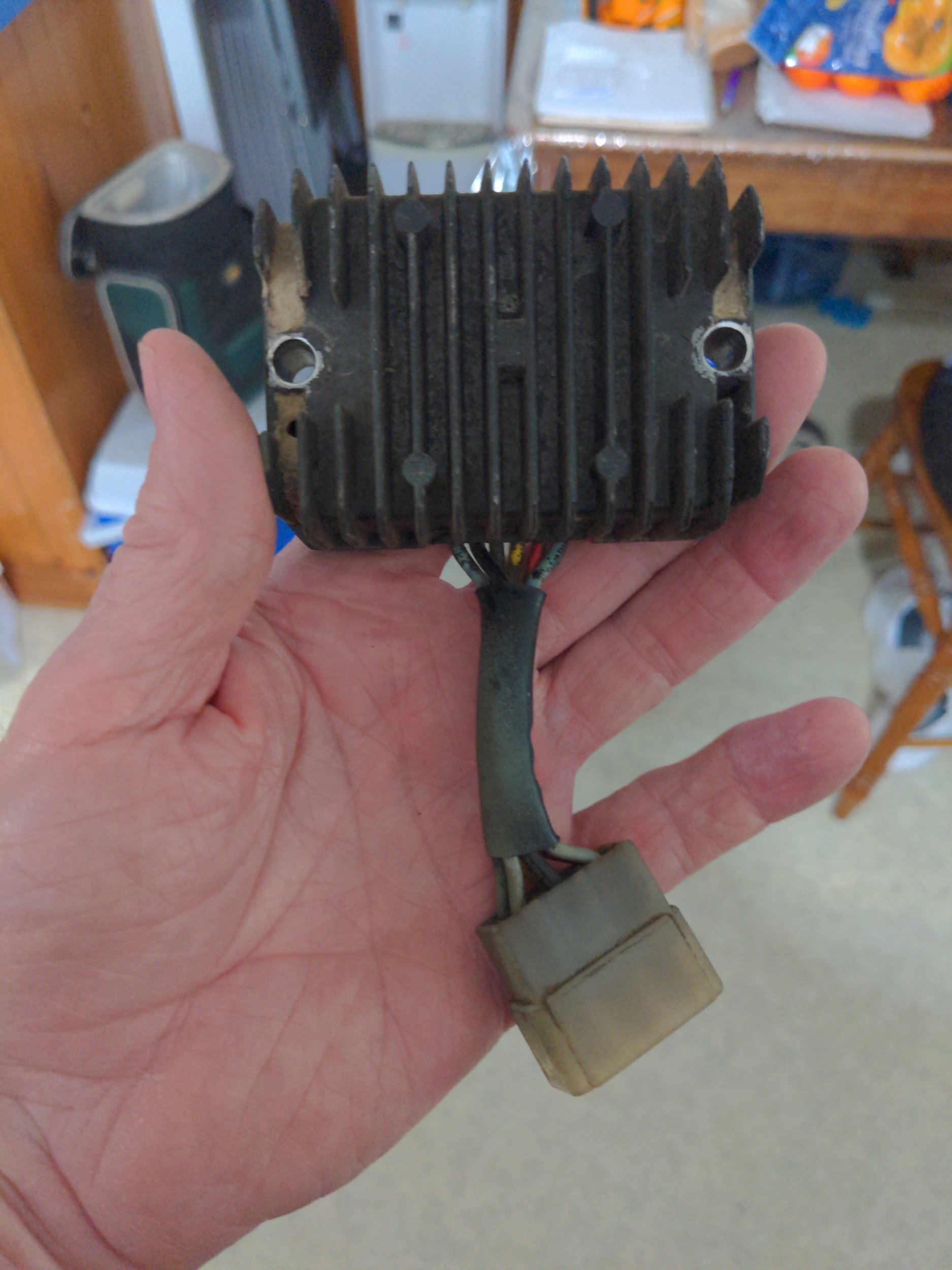

I'm guessing this is solid state. 17143456002113067640985890249233.jpg17143456174061390352271403900404.jpg

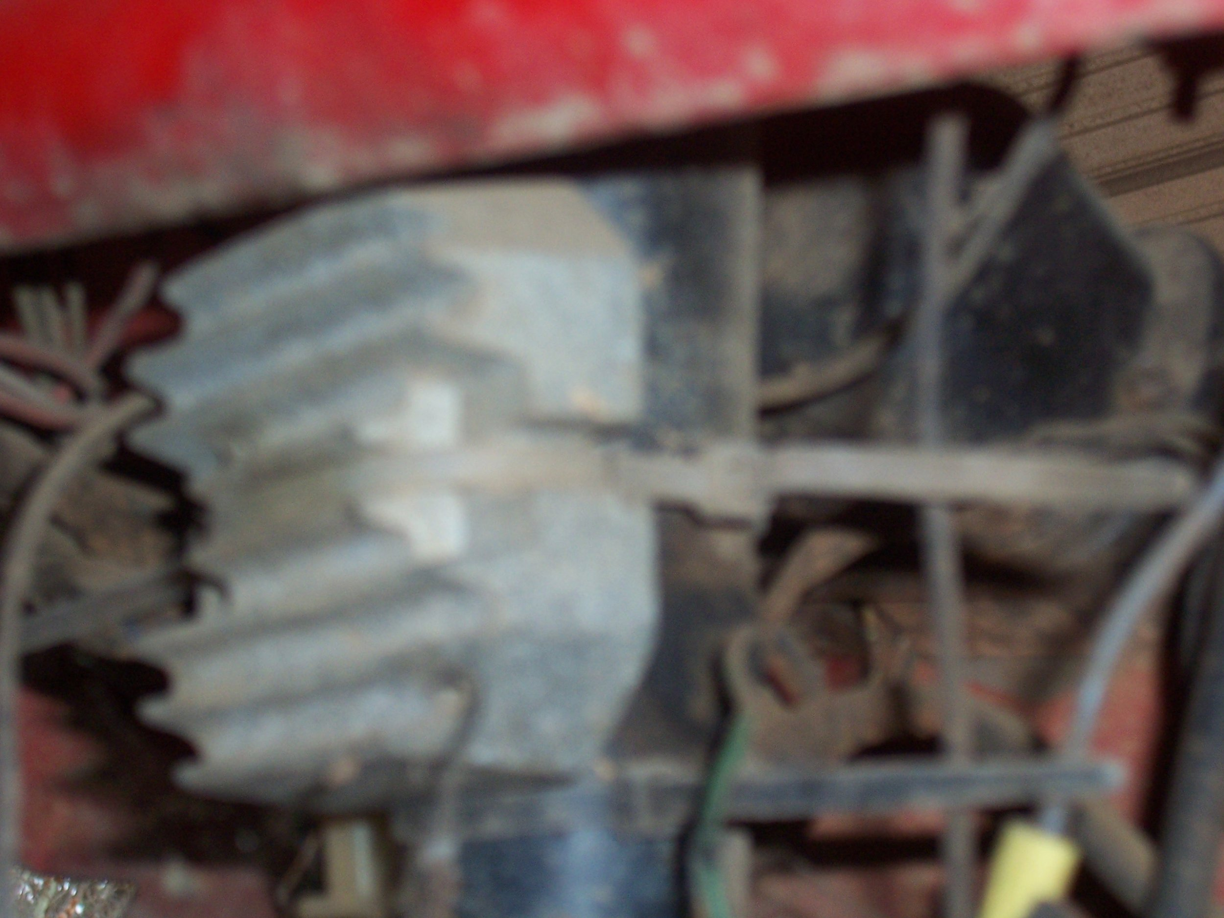

The Solid State on the shaft and the old style is the black box just behind the steering shaft! They both work. Bad connections on the fuse panel. ;)

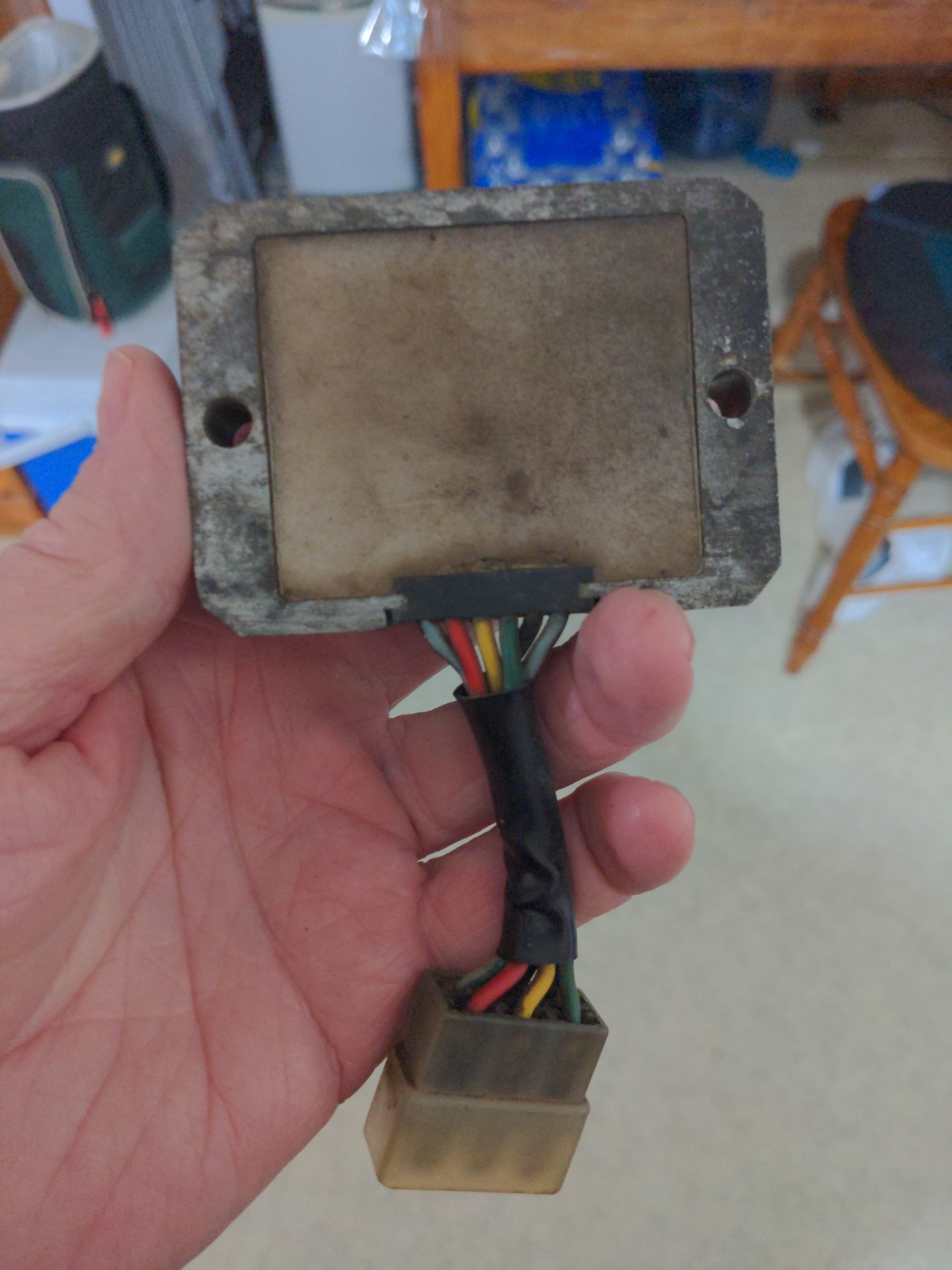

I understand that a 40 year old regulator will fail, and that is what's in the picture. My problem is the brand new one that doesn't work. In most of my experience if you have two apparent failures of old parts and the replacement parts, you have probably missed something in the diagnostics. I took the picture of the old regulator because the new one is boxed up for return. They look identical though.

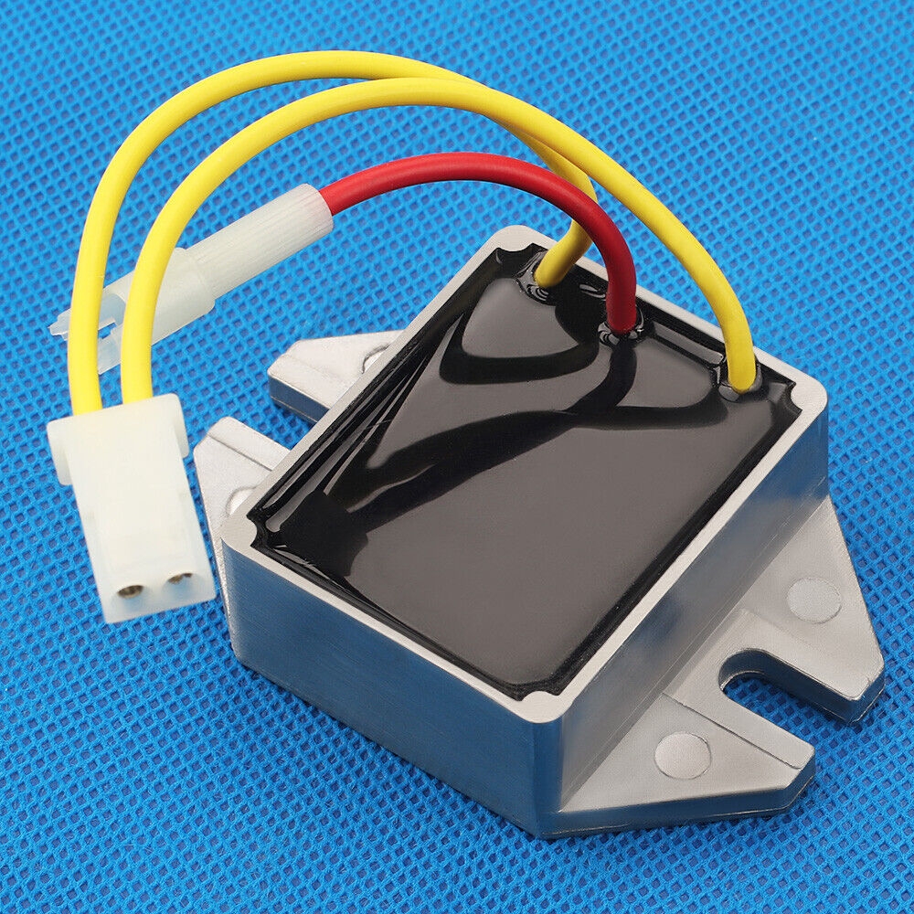

I have been having the same problem,and after 2 new junk voltage regulators,I cut the plug off of one of them and wired it to one of these briggs voltage regulators. 2 blue wires to two yellow and red to red.It even fits in the same place on the fire wall. Just fixed it today and so far charging good. Neither one of the two new regulators worked at all. I robbed the briggs one off an old lawnmower. On my YM186D

Thanks for the help everyone. Barry 1, that Briggs and Stratton regulator looks like a awesome idea. I could buy 10 of those for what the other one cost me!

Just to follow up and put this to bed. My experience echos the experience of Barry1. I exchanged the new regulator for another new one from the same place. After installing it I still had no charging voltage to the battery. I ordered the regulator that he showed in his post from Amazon and installed it last week and low and behold, I now have 14.2 volts DC to the battery. Thanks again everyone and maybe this can help someone else down the road.
