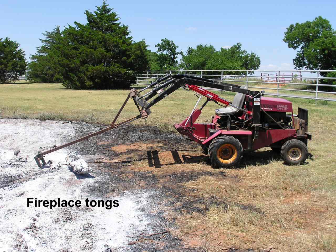

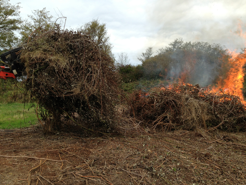

Holy smack0 there Xfaxman - that is a real pile of brush. You know its kind of strange - I know I don't have that much brush, in total, on my 80 acres. A lot of Ponderosa pine - big & small - and a lot of open grassland.
Yep, and this is why I don't add slash to a burning pile.
Same pile, pictures from June 2006.
/ Not another grapple thread!?!? #26
Wow. That one has to be in the 2000 degF range.
As you said, I also would not drop wood onto it, if the tractor were to stall, Diesel spontaneously combusts at 410 degF, plastics melt way before that. Usually when my fire gets big is when I do clean up, sharpen the saw, whatever allows me to stay busy but keep an eye on the fire.

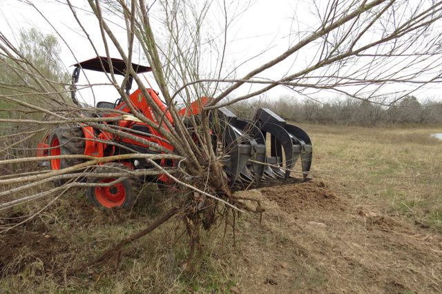

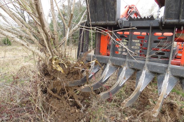

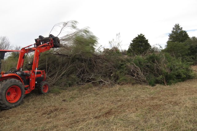

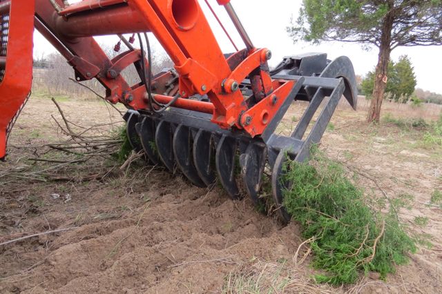

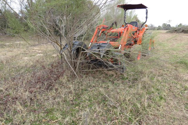

TXDon, I knew at one time but I've forgotten. What brand of grapple is yours? It looks extremely well built.
Yep, it is a "The Rake Shop grapple". From their standard grapple I added an extra tine to make the spaces in-between smaller and I had them build it narrow - just enough to fit comfortably on the quick attach. I also had them add a backing to the grapple to protect the tractor. The open tooth slightly curved tines are what I was looking for in my grapple. Kind of what your hand looks like when you pick up, scoop out, rake, or grab.
If there is a choice on lids - the dual lids keep big logs/limbs from moving when the brush pile is a long distance away in a bumpy field. I also can push trees over that fit between the lids.
www.TheRakeShop.com / Root Rakes Grapples Attachments & Skid Steers
I never get the tractor near the pile once I start the fire.
