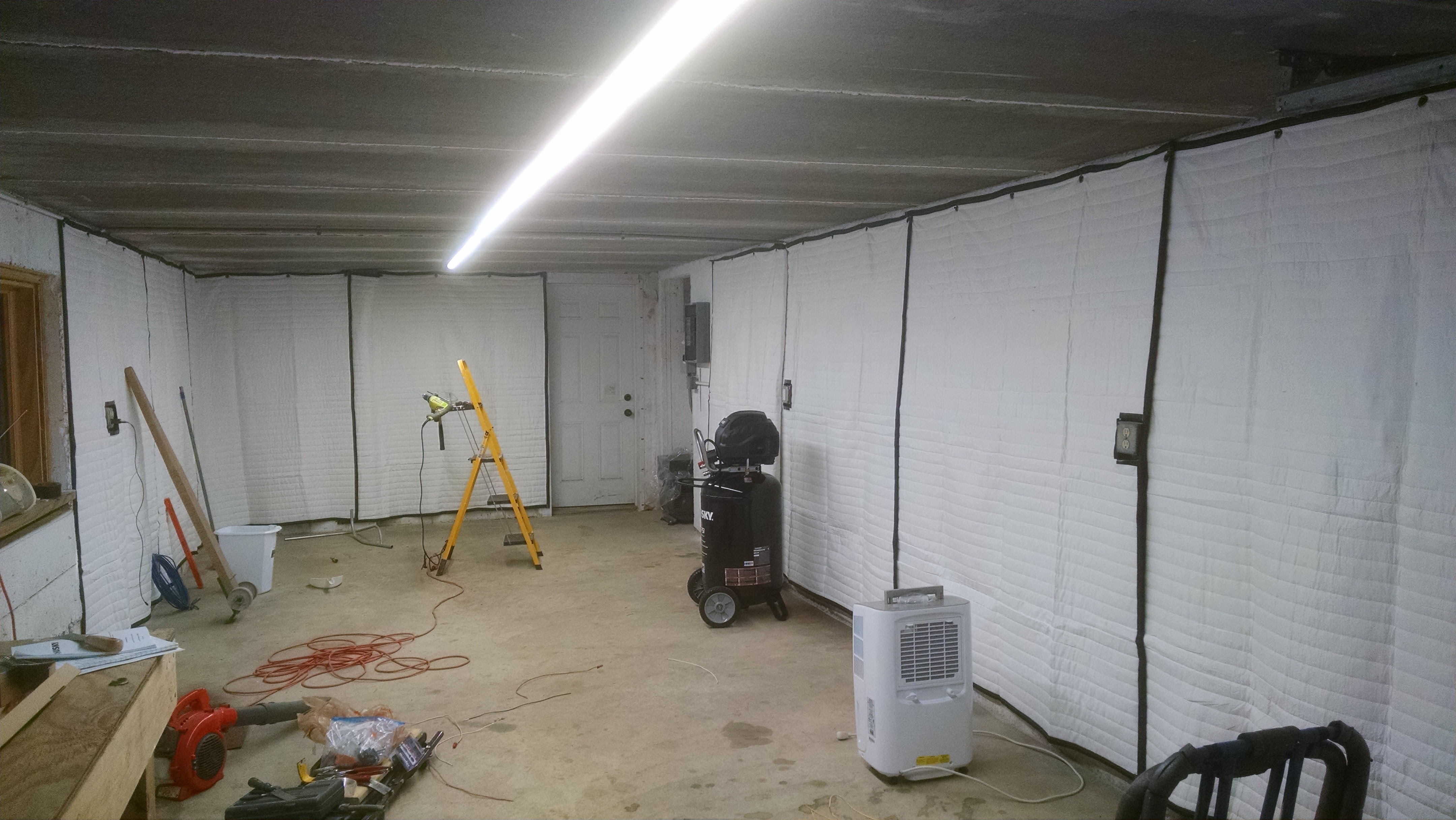

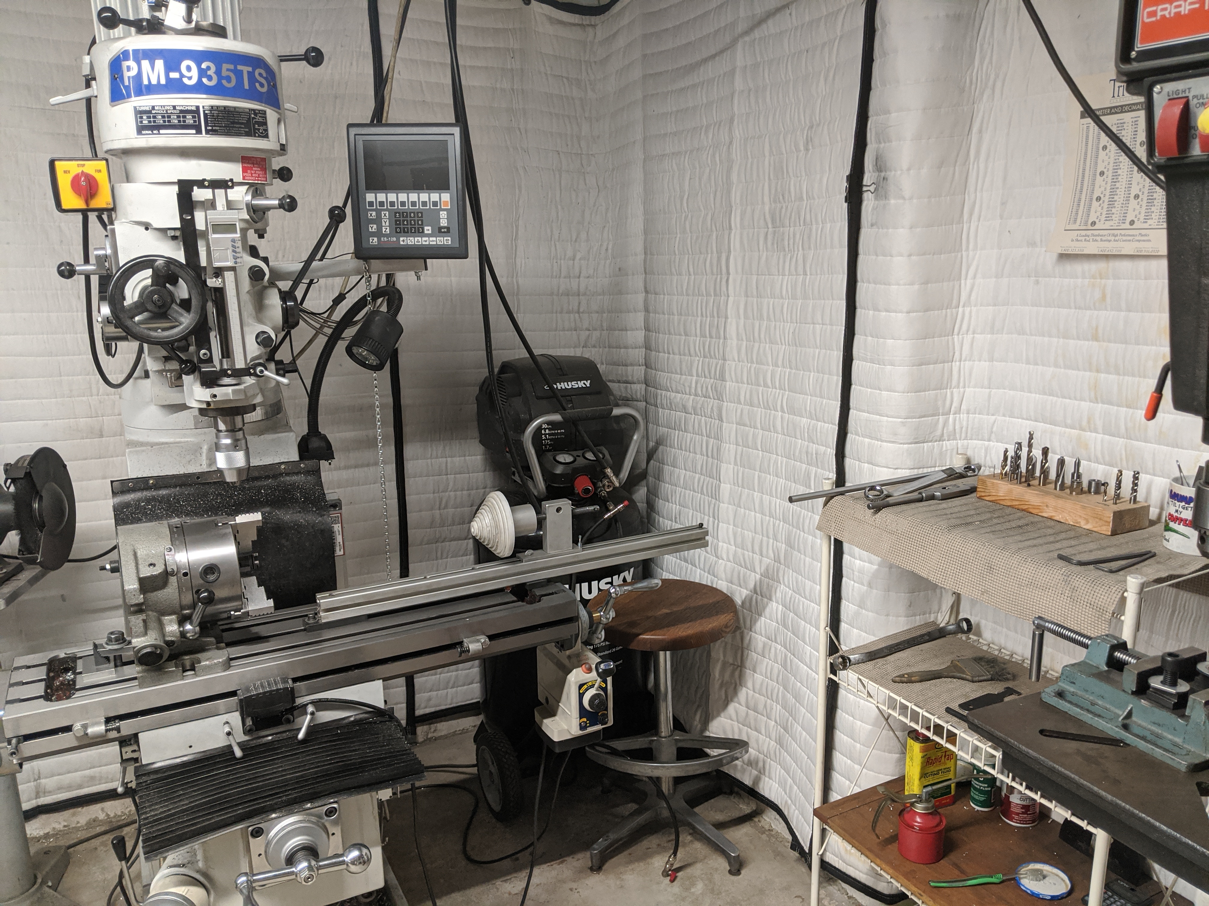

Dragoneggs, like I was telling you in the other thread, the acoustic blankets. Here's the ones I bought: Acoustic Sound Blankets Producer's Choice: Size 8" x 8" - VocalBoothToGo.com
My shop is a long 1-car garage, concrete everything including ceiling. Before I put my shop in there, it was a virtual echo chamber, so I knew running machinery in there would be ridiculously annoying. So I looked up what people where doing, and somebody mentioned these blankets.
Here's me hanging them and installing the overhead led lights:
I have a husky 30 gallon compressor tucked away in the corner.
It gets a little loud, but not too bad...the blankets absorb a whole lot of noise. If the compressor bothered me more, I would just build a quick frame around it, and line it with the same blankets.
