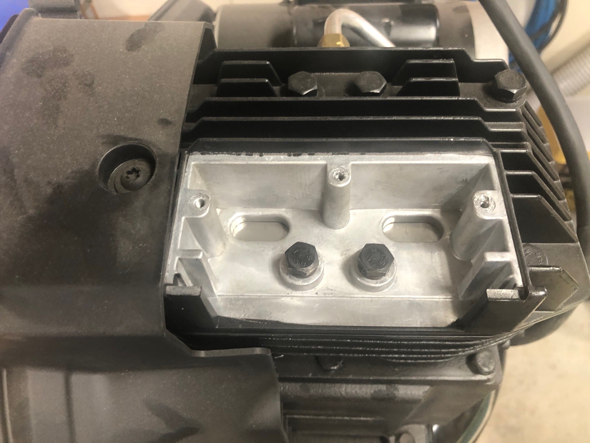

So I looked into mine a bit more. Here it is with a look at the air intake. There is a pleated paper element like an old style car engine air filter and a tube sticking up inside the housing for some reason. This doesn't look far off what the "mufflers" that you see from a web search show.
Then I used an app to measure the sound level via my phone. It averaged out around 68.5 dB at ~3'. But yet it seems louder than that to me. I'm not sure if this thing is at all calibrated, so maybe I will check it vs a sound meter we have at work. But if that is correct, then you guys with the 80+dB compressors must be in a world of hurt!
I'd borrow the meter from your work and retest. Phone apps are not very accurate as far as dB readings are concerned. I'd bet you are 80-85dB at least. 68dB is not much louder than normal conversation.

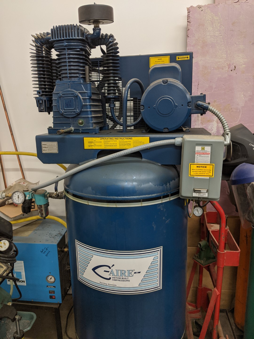

The specs on my Quincy 20hp screw compressor is 70dba at 1meter, it's mounted high enough that you really don't even notice it.
I couldn't find any specs for the 7.5hp Ingersoll Rand reciprocating compressor, but its pretty loud/obnoxious.
Can't wait to finish hooking up the Quincy so the Ingersoll can go to backup duty!

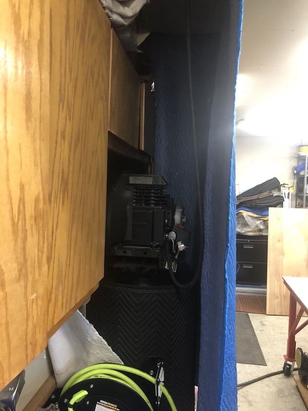

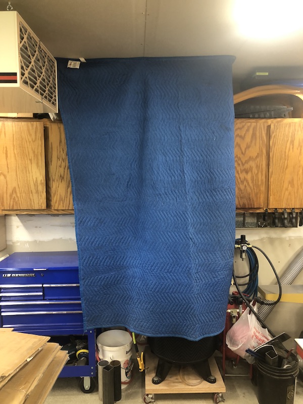

Tacked up a cheap HF moving blanket to serve as a curtain so now enclosed on all but one side left open for air/ventilation. A face on view and a view 'behind the curtain'.
Noise from front (w/ some back and side insulation along with wrapping the tank with HF moving blanket)
87dB @3ft
84dB @6ft
Noise from front (w/ added hanging blanket partially enclosed)
84dB @3ft
82dB @6ft
Some definite muffling going on. The frequency seems a less piercing as well. Still louder than desired but this is encouraging. Now I am on a pursuit for a heavier/thicker blanket that could be a short term solution. It isn't ideal from an ergonomics standpoint though. I can't easily see my on/off and pressure gauges and it is kinda in the way of things.
Have dropped the levels by 4dB so far but I am running out 'in place' ideas other than a heavier curtain. I could move it to the far corner of the shop but that would be a real pain to move other shelving and reroute the plumbing.

Okay, for chits and giggles, I tacked up a second HF blanket, this time closing off the open end and wrapping it most of the way around giving me a double wall facing the shop. Now the only fresh air will pull and escape from the 24in gap at the bottom.
84dB @3ft
82dB @6ft
Noise from front (w/ added 2nd hanging blanket and fully enclosed except for bottom)
81dB @3ft
79dB @6ft
A further 3dB drop! :dance1: For a total loss of 7dB. I think that is pretty good.
Again, noticeable and even more pleasant sounding (muffled) if that makes sense. The higher pitches are welcomely absent.
Now my concern is the temperature of the compressor head. I would like to know if with repeated cycling, the temp is much hotter than the default. I should have measured that before I got started with this MacGyver project.
