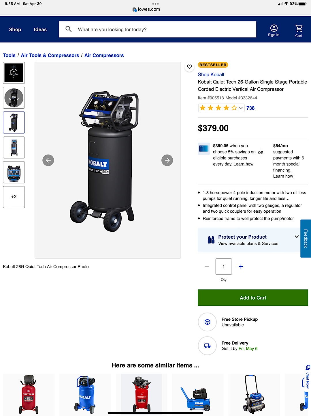

/ Compressor for a shop #10
I bought this one last year when on sale for $329 or $349. It runs what I need ok and when the big garage interior is finished I’ll move it there and have my son (sprinkler pipe fitter) plumb it in. It is amazingly quiet. I debated between this one and Harbor Freight quiet model.

Unfortunately it seems Northern Tool may have discontinued the unit I bought recently but the super quiet feature is great. You can stand next to it and have a conversation. Mine is 120 volt, about 20 gallons and made in Taiwan. I compared it to the similar HF model and it is much better built.
