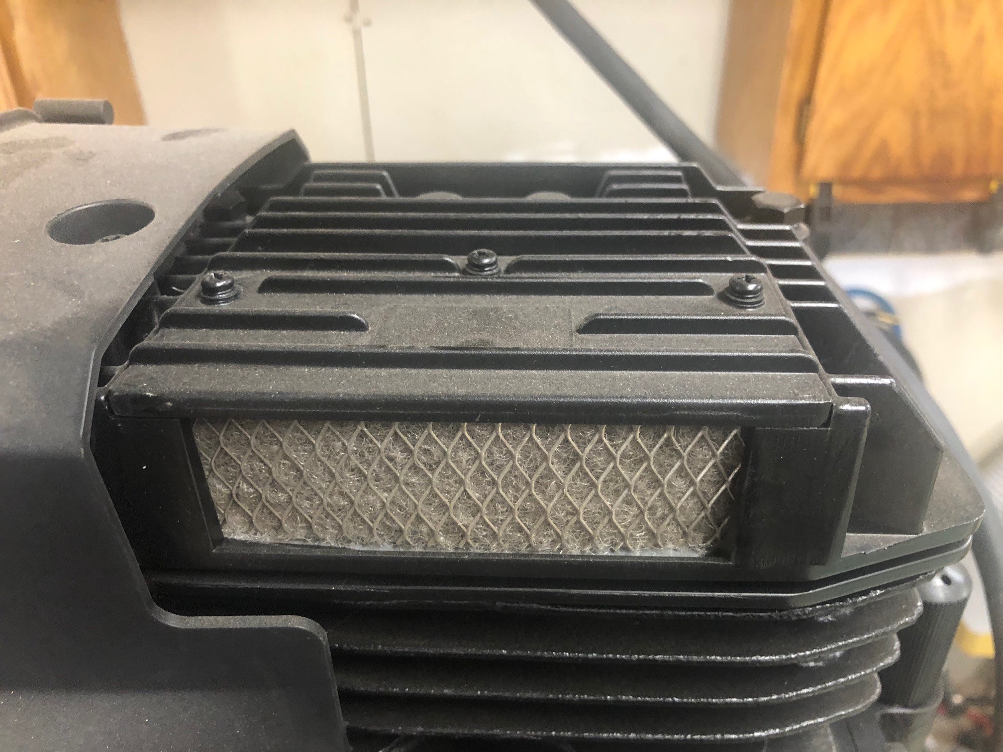

Okay a bit deeper dive into my Husky 3.7hp 60gal compressor...
Pulleys
Motor = 4in
Compressor 12in
Centers 10in
Motor = 3450rpm
Compressor = 1150rpm
Compressor is mounted on double sheet of 3/4in plywood and HF 3in polyurethane casters.
Noise (pretty much against wall)
88dB @3ft
85dB @6ft
Noise (compressor 3ft from wall and rotated 90deg so front/back not facing wall)
86dB @3ft
83dB @6ft
Compressor intake on top with filter on side. 2 intake ports about 1.25in by .5in (a little smaller but couldn't fit my calipers)

Informative write-up. My silencers should be here later this week so I will be experimenting to get the decibel numbers down. I am glad my intake is tapped for pipe behind that ridiculous plastic box. At least yours has something that actually resembles an air filter.

Yeah adding a muffler on mine looks to be a challenge. If anyone has any bright ideas I'm all ears.

Hard to know if it is worthwhile, maybe the existing setup is attenuating the sound pretty well. You could test the db with and without.
But it could be done simply I think. Make a replacement top plate of 1/4" aluminum, drilled to take one or two of the standard air cleaner/mufflers. Screw on with existing screws. Then block off the existing opening with whatever is handy and set in with some adhesive. Might be worth an hour or two to do that.
It does look challenging. It appears like the reed valves are right there with no pipe fittings to use. Interesting. I will know if the silencers are worth messing with later in the week.
