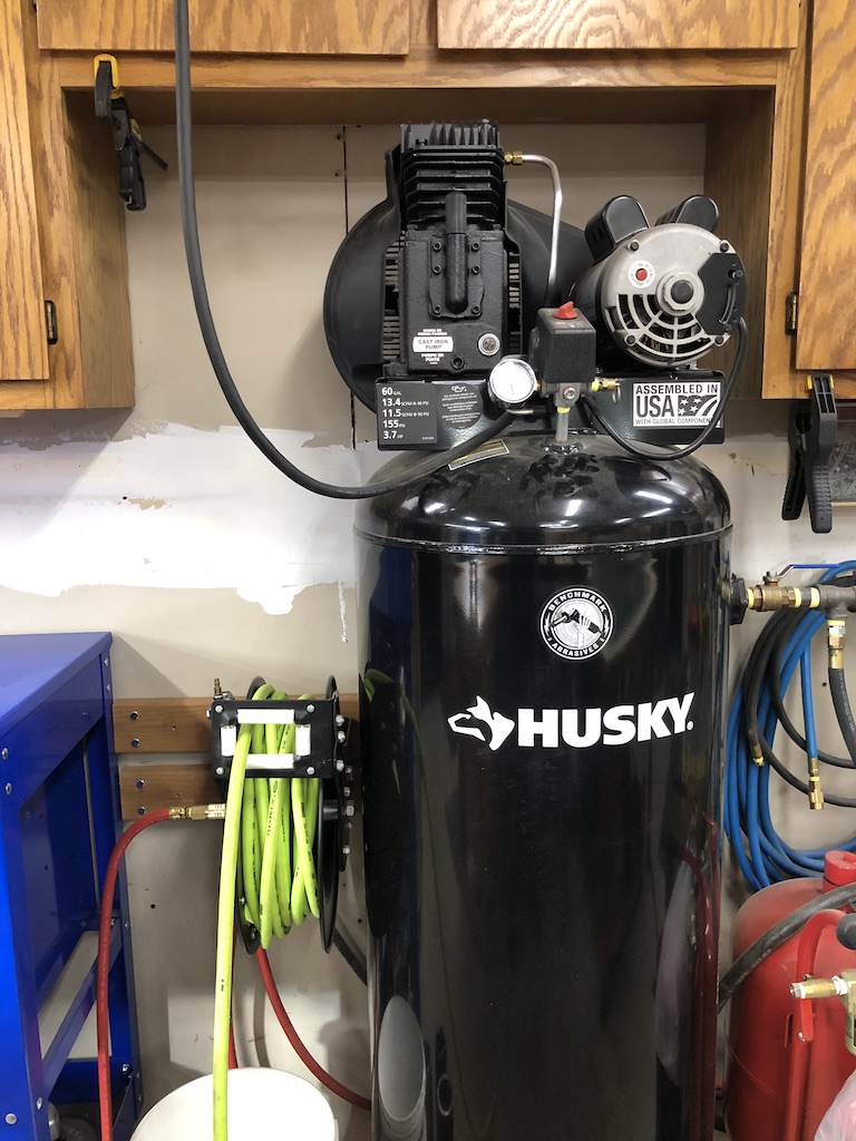

I have a 5hp 60gal upright compressor in my shop. Wondering about trying to knock down some of the noise.
One thought is to build a little outhouse attached to the back of the shop but I am concerned it will be louder for the neighbors. Also it would be in unheated space but I suppose I could vent some shop heat if necessary but this build could get a bit. expensive for what it is. If I new it would be just as quiet as now for the neighbors, I might do that as it would be definitely quieter for me and gain some valuable shop real estate!
My other option is to try to build a sound deadening enclosure and keep it inside. But this will take even more real estate and I wonder how effective it would actually be in reducing noise.
Looking for opinions, what others have done, etc.
I would go with the outhouse........AND install rockwool insulation for a sound deadner....
and the vents for cooling and look at installing a modified intake with a long neck, running it outside with a foam filter........:drink:

An enclosure lined with old carpeting will do wonders.
Easy to wire a computer type (muffin fan) to aid cooling. (wire thru the pressure switch)
Dense rubber under the compressor feet will also help kill vibration type noises.
Lead sheeting is good for high pitched noise.
If in an enclosure, thicker denser wood will help.
The felt type under carpeting used in cars will kill lots of sound.
Never tried it, but I wonder if wrapping the tank with a felt blanket would help some.
A thought: wrapping the tank with self adhesive roofing membrane! (should kill the 'tinny' sounds.)

I am also going to try anti-vibration pads under the compressor feet. Sitting on concrete just amplifies the noise and vibration.

Sorry to be a pessimist but my guess is that it will not help much. My compressor is just dang noisy and any deadening of the feet I can't see helping. I did mount it on a homemade dolly with hard rubber castors to move it around. Can't say that did anything for sound.

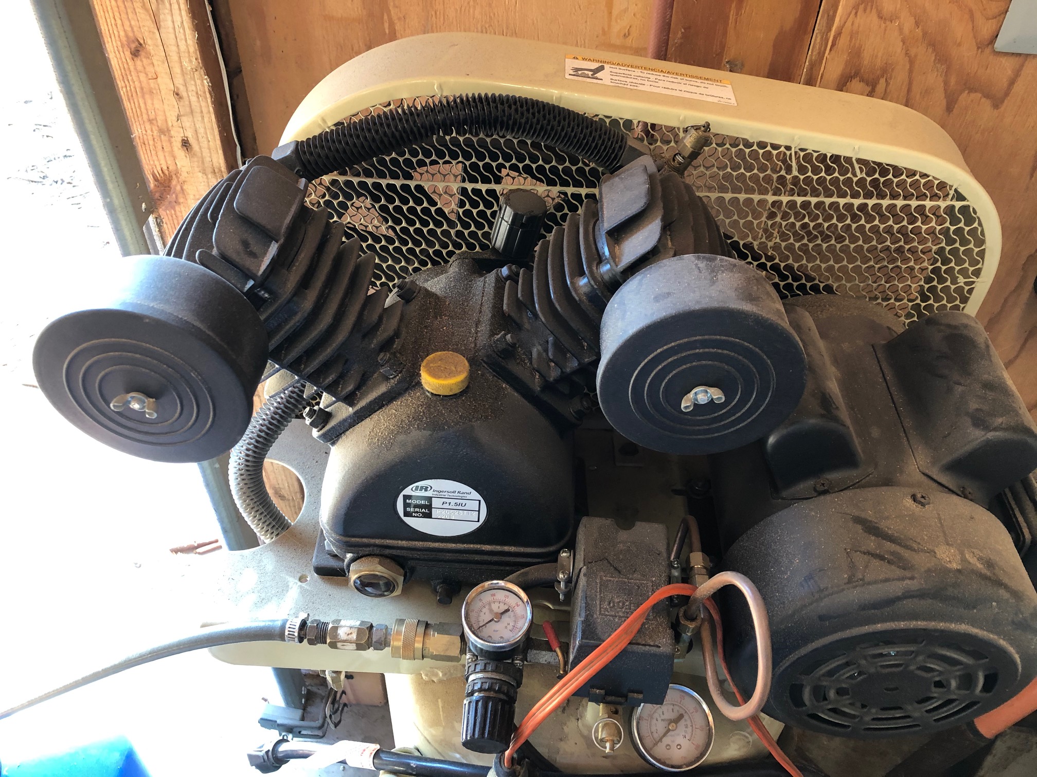

OK, several people keep saying intake silencer/muffler, but nobody has pointed a link to anything that I noticed. I could use a bit of noise reduction on mine too. It isn't the worst, but mainly because it is in the front half of the shop and most of my work is in the back half where the wood shop is (with a wall in between). When I am working in the front half, I have to use muffs when it is running or it drives me bonkers. I measured it one time with my phone but forget the decibel level. I picked up a California Tools portable compressor that was said to be very quiet for finish nailers and it is great. Very easy to live with that right next to your ear even. But that is a whole different world from the big one in the shop...
So if anyone can point to a source for these mufflers (ones that actually work!), I'd appreciate it, as I'm sure would others.
