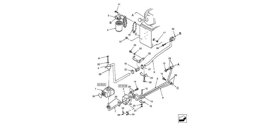

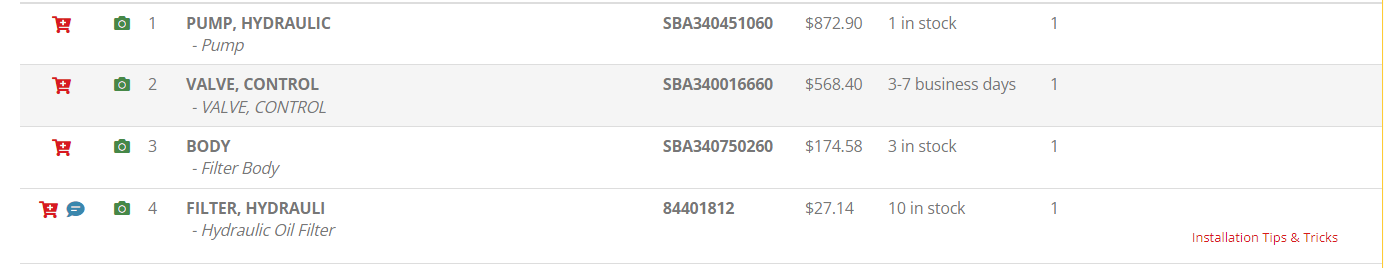

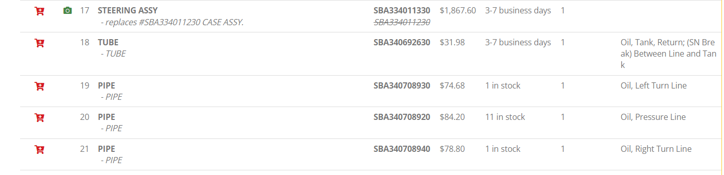

Was looking at some diagrams on messicks site. Can anyone confirm if part #17 on the diagram has a fill cap to check for fluid? I wasn't aware of it till I looked online. Going to check the tractor later today when I get home. I'm wondering if that can be low for some reason.
/ NH T1510 Steering Problem #11
Changing oil and filter won’t fix tractor. Are you sure it don’t have a separate tank and pump for the steering?
Can’t see what 17 is on parts list.
/ NH T1510 Steering Problem #16
No you don’t check or fill there. It’s either the transaxle or separate tank. That appears to be the steering valve.

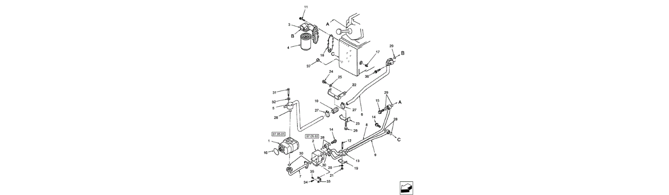

Thanks. I came out to the garage to check some things. Main thing I notice is that whenever the steering gives me issues it makes a noise, kind of like a loud higher pitched humming sound. It also does it every time I raise the 5ft brush hog. Won’t do it when I lower it. Sounds like it’s coming from the area circled in red. Looked on messicks but didn’t see that part. I’m almost certain it shouldn’t be making that noise.
I checked all the lines and hoses and don’t see anything wrong.
