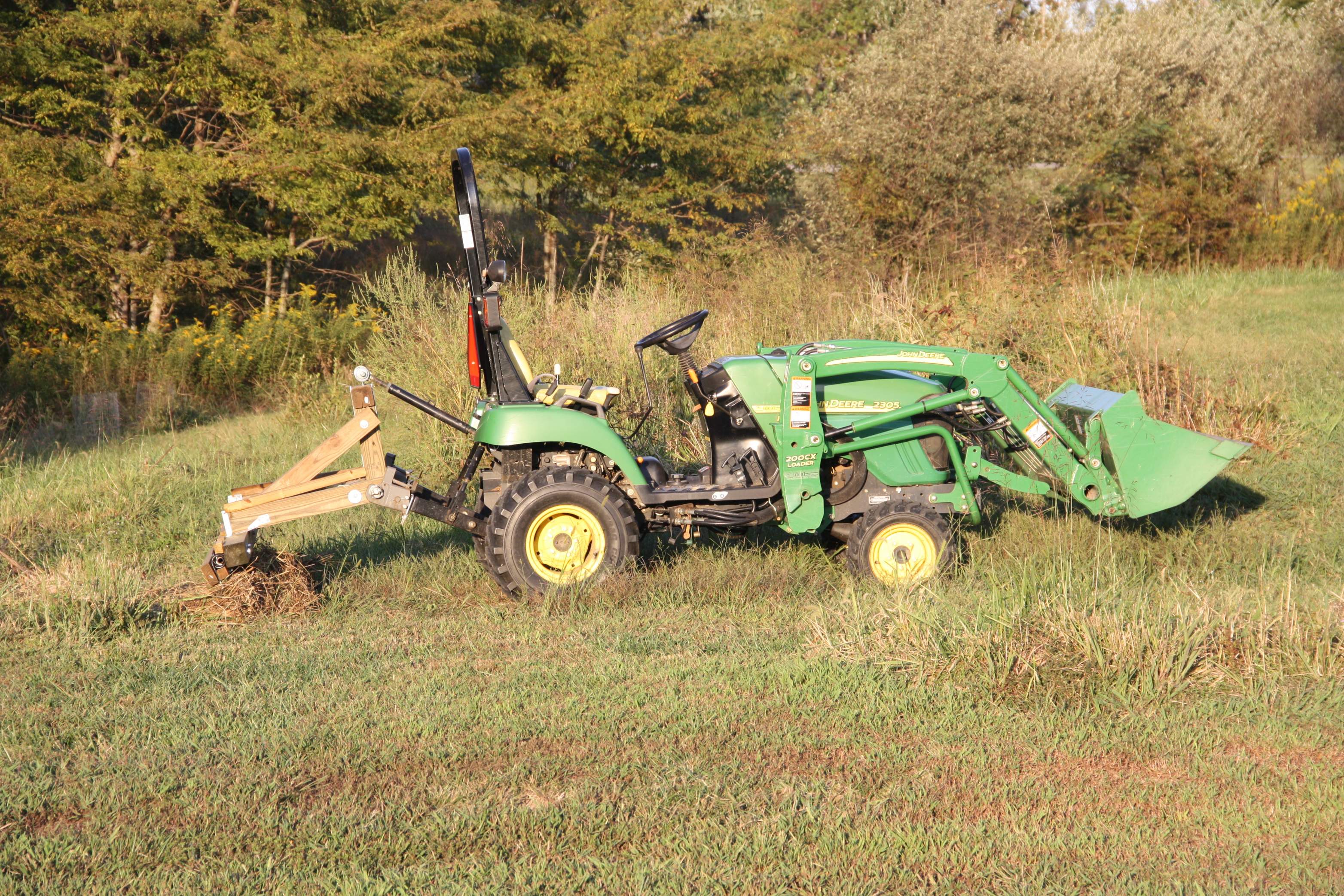

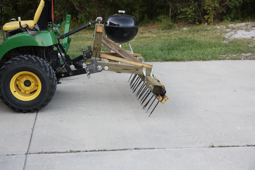

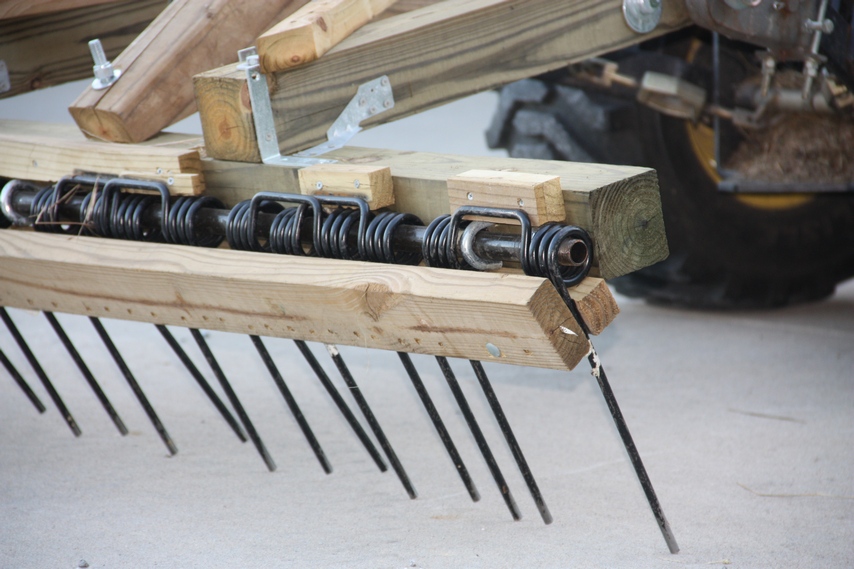

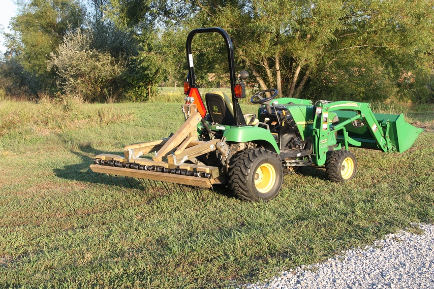

Here it is, the rake in its almost new configuration in action. Sorry if this was a thread violation rule, but I was having trouble getting my posts on the 4th page. Hope you enjoy.

Top arm looks too long. Looks like you will soon tear it apart with fingers pointed forward like that.

It does indeed look like a rake! Very similar to the pine needle rake that jenkinsph's got - only it's a treated 4x4 configuration.
As beenthere pointed out - that's a pretty steep angle - likely poke something's that's not gonna give... and the teeth or the frame will!

to be honest, I don't know why I was having difficulty posting either, all I can honestly say is that when I did click to attach the files, nothing would happen. Can't say I understand, but can only say that it did not do what I wanted it to do.
As for the steepness of the angle, I agree. My next step in refining this is to cut down that top link by at least 4 inches, maybe more and reduce the tremendously steep angle that sits there right now. Although the rake is very usable, one difficulty I have is that it does not raise up very high causing two problems:
1) sometimes I rake up enough material that I have difficulty getting the tines out (I role over them in those cases)
2) on rough terrain, I have to take extra caution so I don't get the tines stabbed into the ground accidentally.
I did want to post a couple of pics though in its functional if not finished condition. The picture I posted here was only about 10-15 feet of raking in an area that did not need it too badly. I chose the area because of the good sunlight and I was in a rush to get my camera.
As it stands now, in its present condition, I typically rake over an area twice. The first time mostly roughs up some of the long clippings that are on the verge of turning into thatch. The first pass loosens them up and in the process, I try to keep my hand on the 3pt lever to constantly monitor and adjust the rake so it is just barely touching the ground.
When I back up and rake over again, the loosened grass now easily collects under the rake and forms some nice, big windrows. I think if I were to just drop the rake and run on the first pass I would seriously dig into the turf.
One aspect I had not anticipated. There are some surprisingly tremendous forces acting on the entire assembly. I have looked back and noticed especially as I first start moving that the 4x4 is undergoing torsion--it actually twists for a moment and then springs back into normal position. I would have thought that the torsion springs would have been sufficient to take this stress, but I guess not.

The Toplink looks too long... Shorten up the toplink will help with raising it more and also help with the angle, too.
   / Newest addition to my family of tractor implements #38
Re: Final pics of new rake
In looking at that toplink, I noticed a couple of things, One you do not have it adjusted in as much as possible, so that is a 15 second fix, but I also noticed you have a set of Pats Quick Hitch on which normally adds a couple of inches to your lower links, which usually means you need to lengthen your top link, But that top link looks really really long, I am starting to wonder if that is the original toplink? Or did that come off of a larger tractor? Shorten it up as much as possible, and see how that looks/works but maybe go get a shorter one if that does not get you where you need to be?

You are absolutely right about the length of the top link. When I was making it, I was just not certain how high up it needed to be. I took some rough measurements from my middle buster and deliberately erred on the long side. I can always cut some off, but putting new material back in place is not going to work. By having it long, I can take off bit by bit until it is just the right length.
Also, one mention about the teeth. They are deliberately pointed forward. In a previous test, I found that if they were simply pointed straight down, as they made contact with grass and ground they all too easily bent back as their torsion springs were designed to do. In this version, they point forward and I can use the 3pt control to "fly" the tines just under the layer of grass. Naturally, the tines will eventually come into contact with the ground, a thick tuft of grass or even a rock or lump. In this case, because the teeth have built-in torsion springs, they simply bend backwards easily, slide over the object and continue on as before.
Thanks for the comments, they are quite helpful, in large part because they are confirming what I was already thinking about doing. This is a work in progress--a functional one, but incomplete nonetheless. Right now I am trying to rig up a system that will allow me to disconnect the top link, rotate the rake 90 deg and use my miter saw to make quick, precise changes to get just the right amount of top link off.

....use my miter saw to make quick, precise changes to get just the right amount of top link off...
The metal toplink is a screw (the piece of metal attached to the tractor), just twist the middle section to make it shorter! No need to make any cuts!!! Screw it shorter and see how the tines looked....
