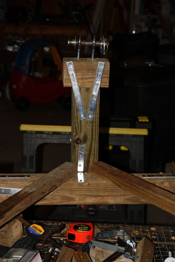

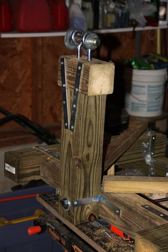

I apologize to everyone who was confused by my multiple threads. This is my first time working and reporting on an on-going project. This fact accounts for two of the threads. worse, each time I tried to attach pictures, I failed to get them attached properly so I started a new thread to get the pictures out there. This doubled my threads. I was not trying to be rude, I was just an little inexperienced.

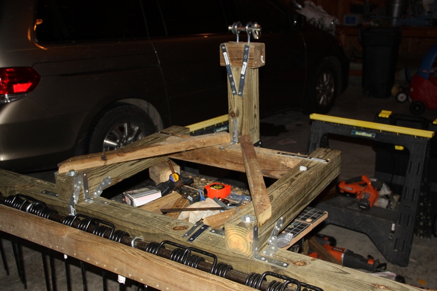

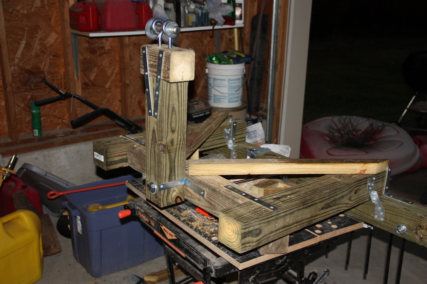

I am, however, going to attach some pictures of my most recent modifications. I substantially redesigned the toplinK connector and I think it is much more secure now that previously. I added a lot of metal strapping to keep everything in place. I also added angle bracing--thanks to all who recommended this--and now all I need to do is to attach the link pins on the lower arms. My plan for this is simply to measure VERY carefully and bore a hole to allow the link ping to fit in. This hole will be drilled from the inside to allow for the rather large nut that attaches to the link-pin. I bought an extra long link pin (extra threading) to ease the drilling. I want to make certain that the pins are perfectly square and even with one-another.
Anyway, here are my most recent modifications. It should look considerably better than it did on the last post. As always, I welcome any insights that I overlooked, missed or just plain forgot.
Thanks in advance,
SI2305

Thank you everyone for putting up with my multiple threads. I hope to do things right this time.

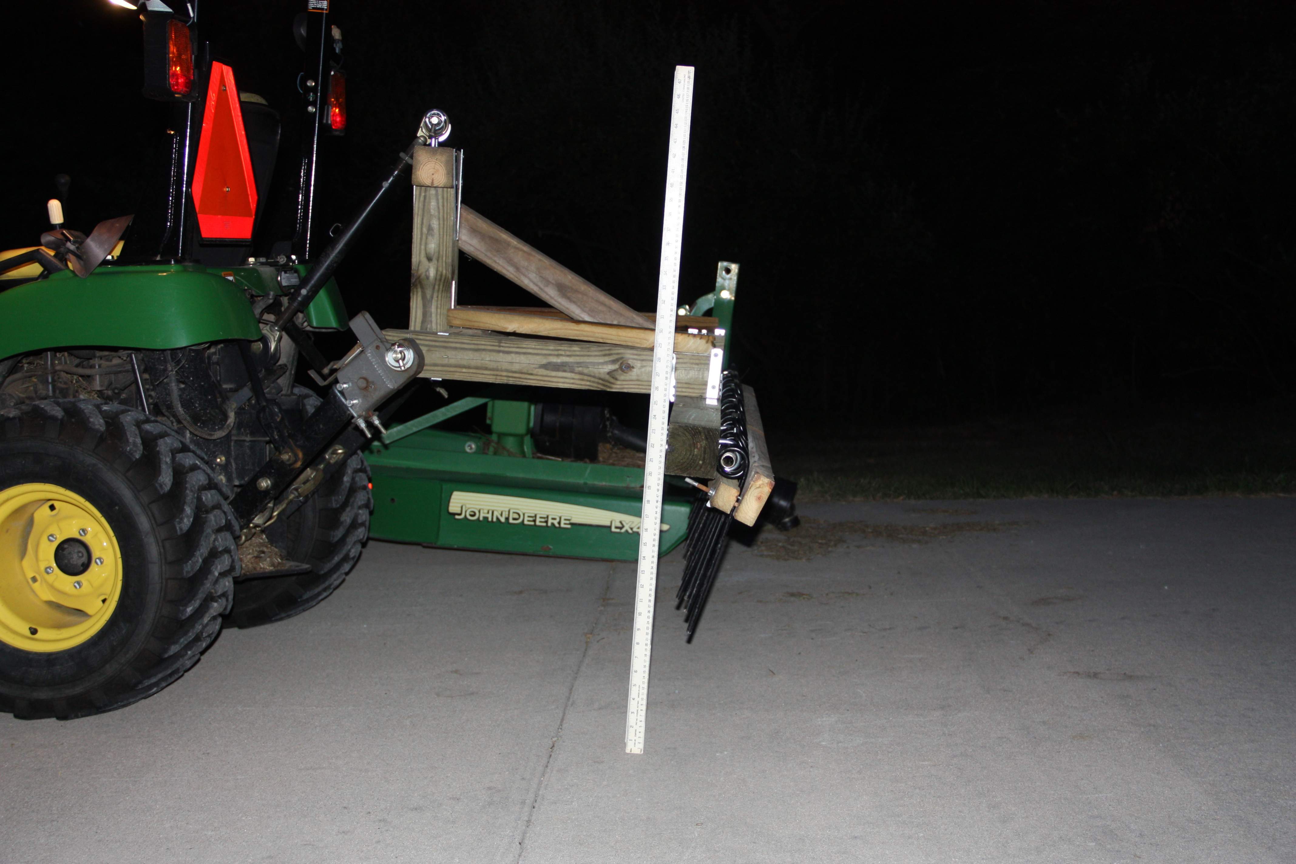

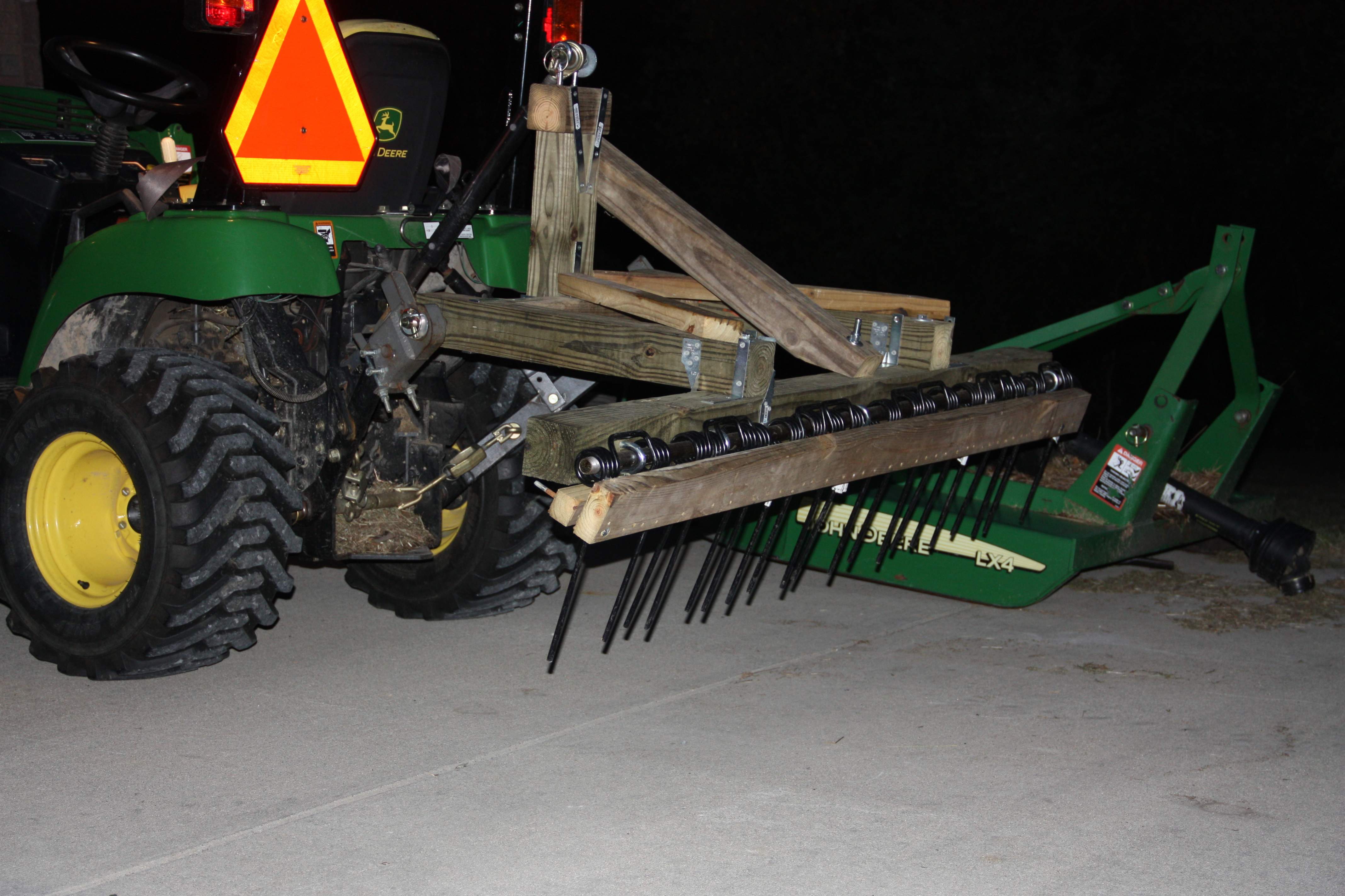

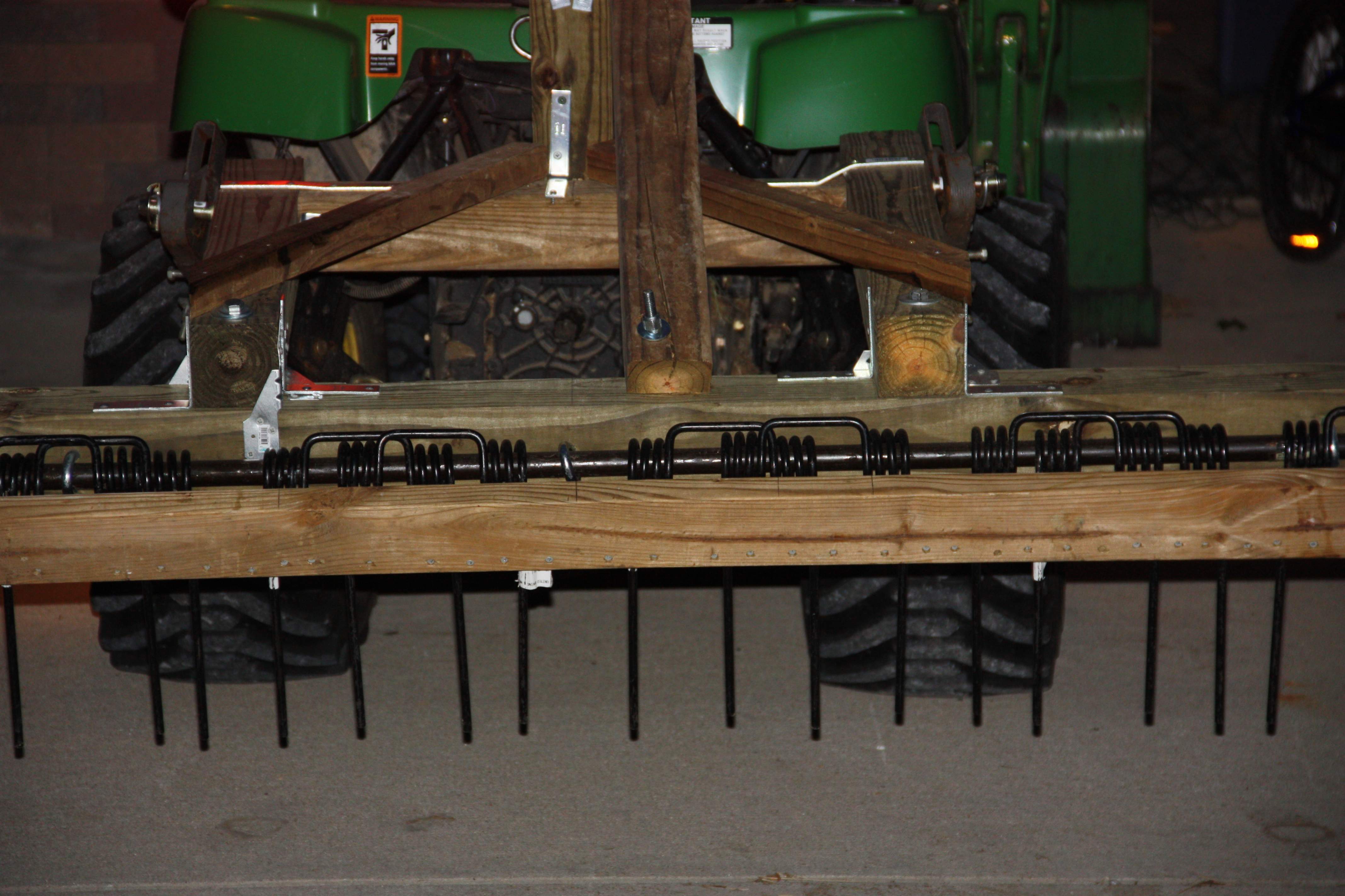

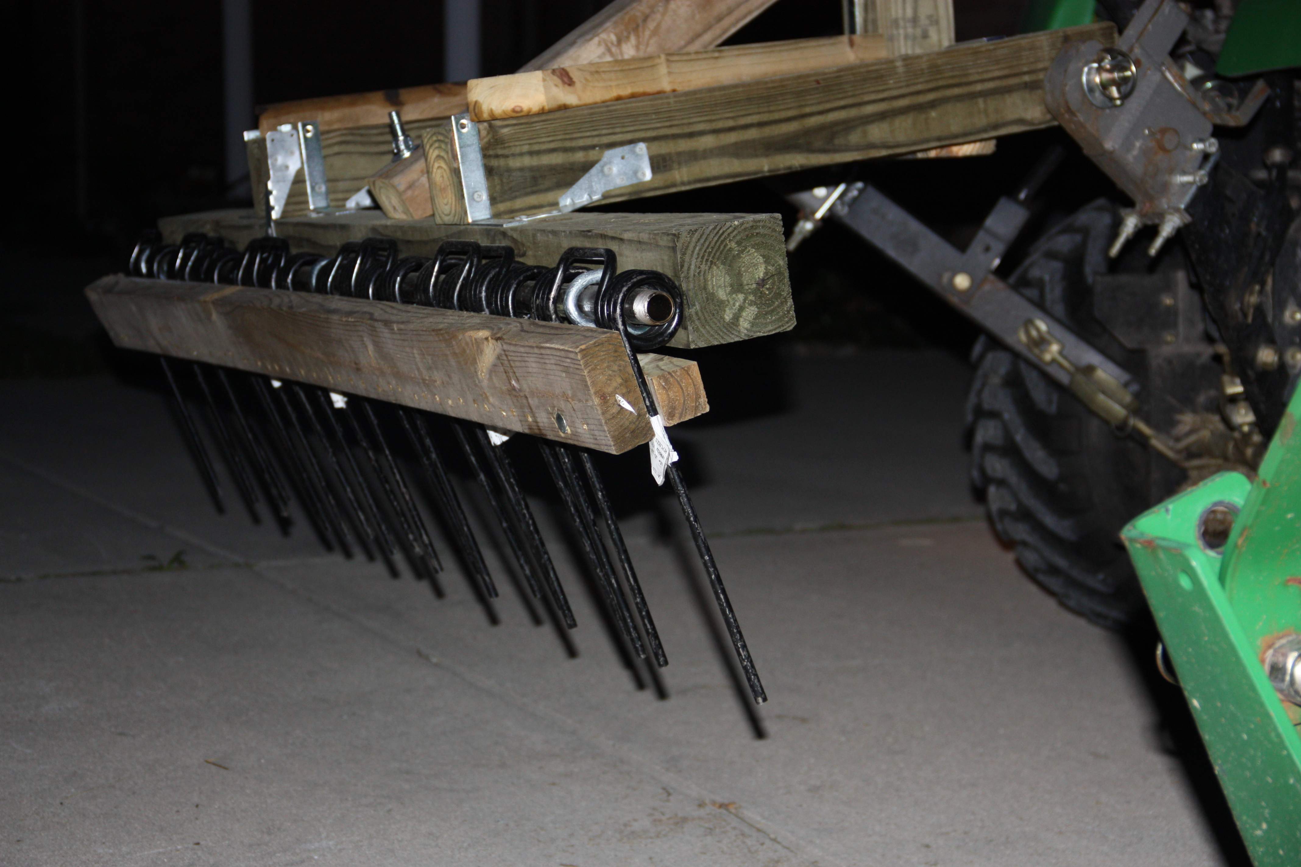

I finished my prototype yesterday and gave it a whirl. Unfortunately, those of you who commented on racking forces were more accurate than you may have realized. The simple act of raising up the rake pulled the 3pt connector back a good deal so I quickly lowered it, made some quick re-adjustments, added some more metal, and most importantly, I added a 4x4 connector from the upper top link to the 4x4 that houses the tines. While I still have some more modifications to make, this was satisfactory for the moment.
I then went out to the field, dropped the rake--and actually raked up a small windrow! Not quite mission accomplished, but at least enough to know that the concept works. With more attempts I heard something horribly frightening--a screeching/cracking sound! At first I thought I was pulling apart my 4x4's, and if those don't work, nothing wooded will (foor any reasonable price that is)! Turns our the sound was a much more benign issue. The tines, which are held in place by steel piping, were rotating to face slightly backwards. I noticed that the pile I was raking was not growing quickly and I needed more downpressure which exacerbated the tine issue. While building, I thought these were so tight that nothing could move them, but apparently a few inches of loose grass will do it.
This morning, after taking out the trash, I restored the tine issue. I found a nice, flat spot, droped the rake solidly into the ground, and gently backed up in low gear. At first, nothing, the tines bent as they are meant to. But after several inches of backwards movement, the screech returned and I looked down and was pleased to find that the tines now angle forward about 20 degrees. I gave a few more pushes back to even out the tines and then returned home. I plan on modifying to see if I can maintain this configuration.
I attached a couple pictures to show the current configuration--it will be modified again shortly.

No, I have no plan on adding any weight to it as its wooden construction is plenty heavy. On the other hand, I do plan on removing the center 4x4 angle support and replacing it with a metal counterpart, perhaps even a cat0 toplink. This would allow me to dial in the perfect amount of strength to the vertical support. I do plan on adding some metal strap support underneath the tines. If you look closely, you can see that the tine support is arranged in such a manner that a metal strap could easily connect to the 4x4. I also plan on slipping some 2x2's into the space between the top of the springs and the 4x4. This would help prevent the springs from rotating backwards. I may even lower the hight of the toplink to make overall attachment easier to manage. Right now, the toplink is dangerously close to its maximum upper limit. Please let me know what you think, and thanks for the comments as always
