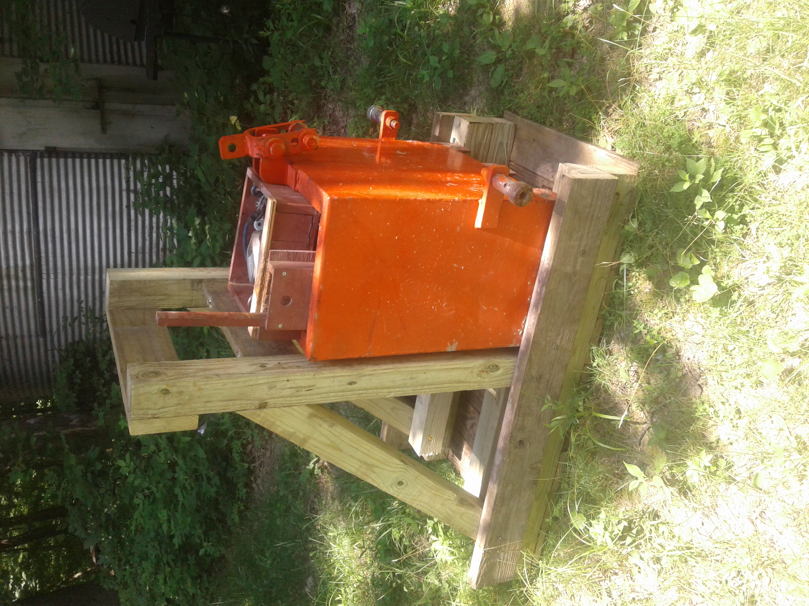

My property came with truck and car hoods:D That's how I came to use them fairly extensively (see my avatar). Much easier to skid stuff.

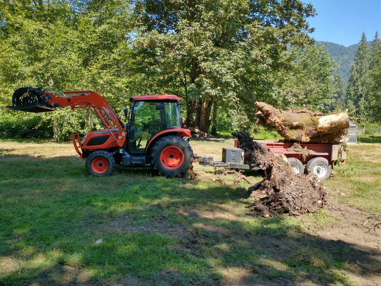

Another point is that having a lot of weight on the front wheels, REGARDLESS of how much ballast you have, can be problematic on/over varied ground surfaces. I've sunk my front wheels with lots of weight in the bucket: this sucks not because of the terror factor, but because it's a mess to dump everything, get the tractor unstuck and then get the stuff rounded back up.
If one has a lot of work to do in which a given machine is going to be straining then consider renting more power. I regularly rent excavators; these are great for setting large rocks; not great for moving stuff very far though. No longer car/truck hoods, but the principle is the same (loaded using a 19k lb excavator; had to have been close to 3,500 lbs as the excavator strained and it's max lift is 4k lbs; note that I have a grapple on the tractor- when you're towing a trailer you're NOT able to tow a trailer AND have extra ballast on the 3pt! [I made a quick shot at picking up a big chunk of root and the butt end of the tractor lifted; that's when I decide to use the excavator- I'd already had it packed up to be picked up]):
