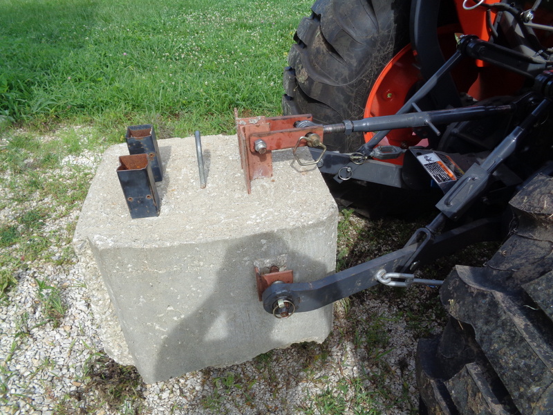

DO NOT buy ericm979's ballast box, it's on clearance for a reason - it's not quick hitch compatible, this one is
Ballast Box 3 Point Category 1 Tractor Attachment | Quick Hitch Compatible | Titan Attachments
If you load it up, it will be heavy and hard to connect when needed. You will want to make a "parking stand" for it to raise it off the ground and make it easier to hook up. This can be as simple as cement or wooden blocks in front of a tree or something that can be moved around.
This is the non QH compatible box, bought it off Amazon. The top link needed to be lower and moved forward. Since I lack welding skills, I'm happy with my mod.

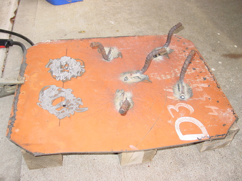

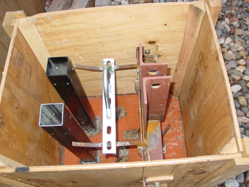

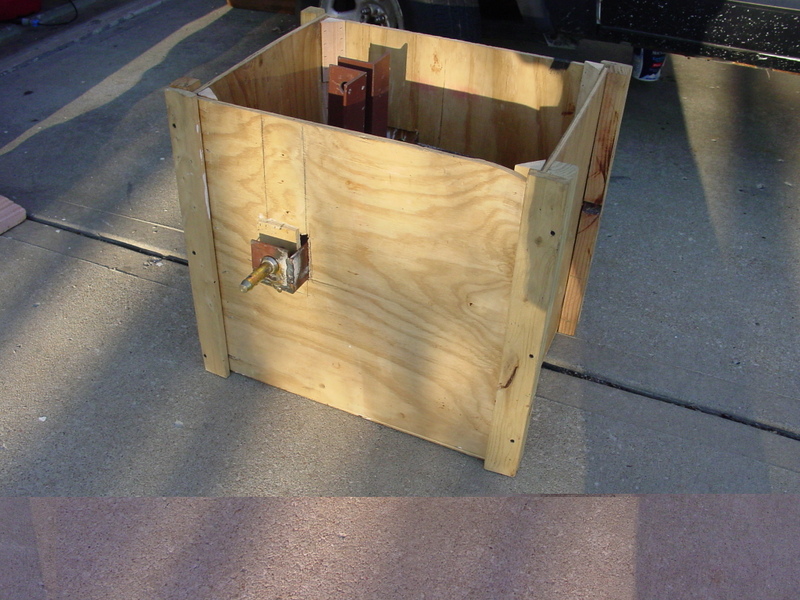

This is the counter weight I made during building my new house. I build a box as pictured and had them dump leftover concrete in there rather on the site. It is about 1000 lbs and it is nice and compact and close to the rear so it make turning and backing out a bit safer. Like everyone said, never lift for more than you need for travel and higher if needed only when tractor is stopped.

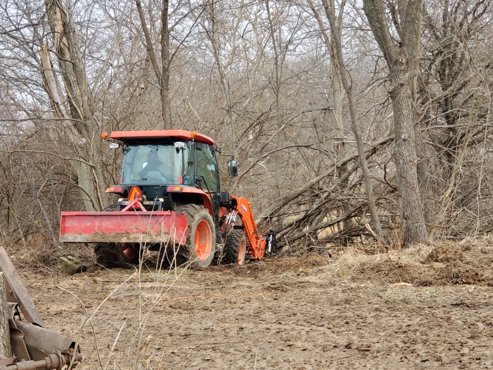

Small tractors and large rocks do not play well. You are smart to be wary. I am careful lifting even 2000 lbs with my tractor and it weighs 4500 lbs, has loaded oversize turfs, and over 800 lbs of counter weight on the carry all.
Just looked up your specs. Your tractor is half the weight with half the FEL capacity. A rock 2x2x3 is way too large for you to handle safely...it will weigh about 2000 lbs.

Mixing your own concrete is inexpensive and easy. Knock a box together from scrap lumber, put a strategically located pipe of sufficient diameter to slide a drawbar through, and a vertical flat bar protruding from the top to attach a top link bracket. Go to any hardware store and you can pick up premix for under $4 for a 60 lb bag... in the long run probably cheaper than chasing around at construction sites.

There are lots of threads on TBN about homemade ballast boxes. If you're clever, you have a receiver hitch sticking out the back, embed PVC pipe to make carriers for long handle tools, something to carry your chainsaw, logging chain, etc. Think of it as a heavy carryall.

A handy thing to add with your ballast box is to put some 2 inch PVC sticking up in the box than pour the concrete. It is very useful for handle tools. Sure it takes a bit of the weight out, but more than makes up for it in utility. If you carry a chainsaw a lot, a chainsaw scabbard can be "molded" in also. I also have some 4 inch short PVC on top to hold chains with their hooks hooked on the inside rim of the PVC. Even your little tractor probably needs an additional 600 to 700 lbs on the 3 point. The feelings you will get in the seat of your pants will be sooo much better than what you are feeling now.

My Kubota M6040 weighs 10,050#. A lot of that is due to the HD Rhino 950 rear blade and the RimGuard in the rear tires. Yet - I can still attempt to lift a large rock with my grapple and feel a rear wheel begin to rise up. This is my signal. Do I really want to move this rock and do I want to go to all the trouble of chaining the rock up and dragging it.
My Rhino rear blade( 1015#) is ALWAYS on the 3-point. Or, in the spring, it might be my Wallenstein chipper. I never run the tractor with a bare 3-point unless I'm pulling my farm wagon.
I suggest you consider a useful 3-point implement as counter weight. Maybe a rear blade, box blade or LPGS( land plane grading scraper ). Why put something on the 3-point that will only serve as counter balance.
