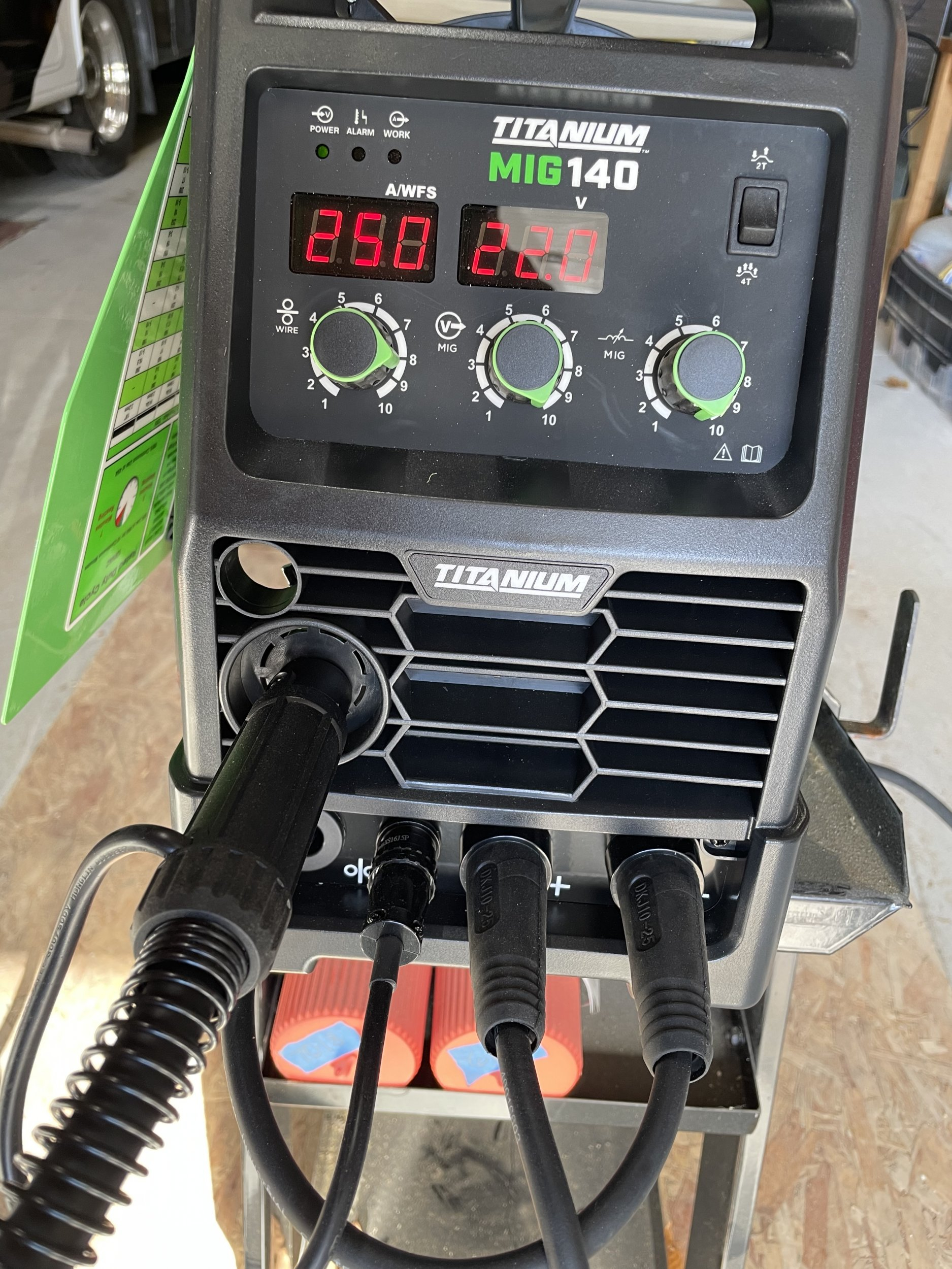

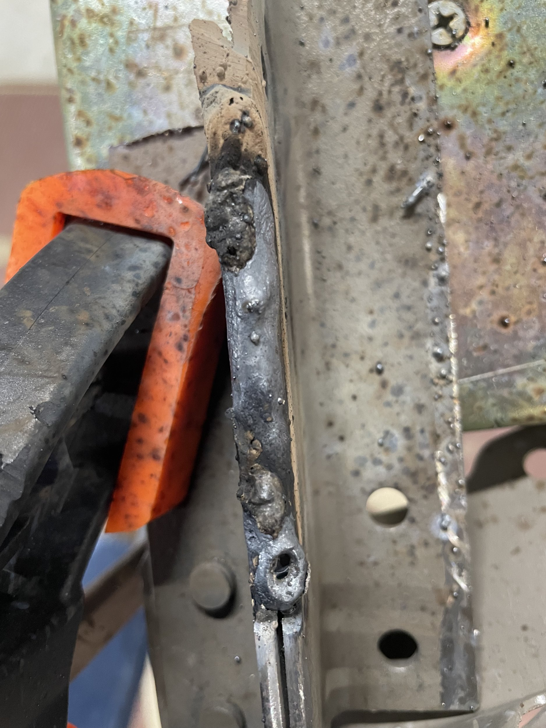

View attachment 719445View attachment 719446
Here's my latest "welding" two edges of angle iron and the settings. Still lousy.
i guess I need lots of practice
You certainly need practice, but everyone does. And that weld doesn't look that bad. Now that you are using the right wire and the right polarity there are some other things to consider. First of all, the flux in your wire is there to protect the hot weld from oxygen. It is not meant for cleaning dirt and oxides from the metal to be welded. So always start with clean and shiny metal. Grind the metal surface to be welded as well as the metal surface adjacent to the area to be welded. Though good ventilation is important for your health and visibility you should avoid welding in a strong breeze. The breeze will tend to blow away the protective gases emanating from the burning flux. Make sure you look at the weld puddle, not the arc. Our eyes are naturally drawn to the arc because it is the most visible thing to see when welding, so you will need to be aware of this and concentrate on the puddle. Finally, it is easiest to weld a horizontal and flat surface. So just run a bunch of beads 4 to 6 inches long on a plate laying on the bench.

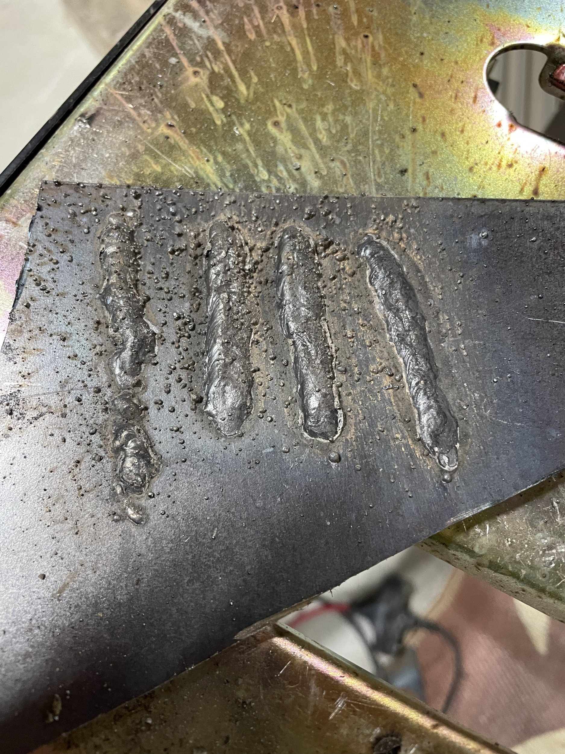

Yes, I have cleaned off the plate before any welding and I've tried to chip off any slag but nothing really chips off, til today.

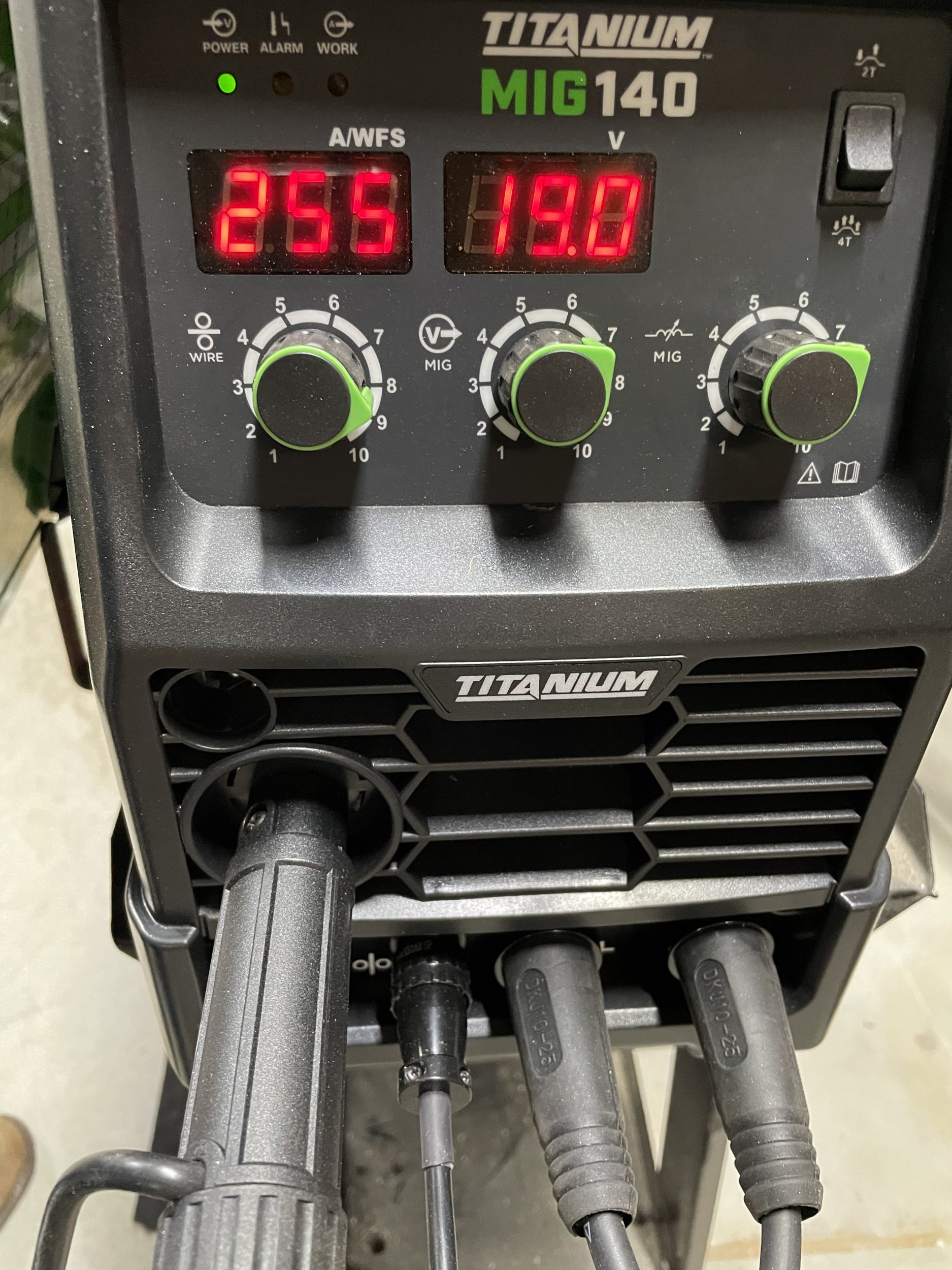

here are my practice lines today starting from the left. I raised the speed and heat at first and then slowly lowered both as it looked like there was a lot of splatter.

It is really best to change only one variable at a time. Your post makes it appear that you are changing two at a time. Your welds are improving though. Practice, practice, practice.

I suggest you keep a record of settings. As etpm said above change one thing at a time. Write down the type of material, weld, thickness, settings and result. When you make a change record that as well. Over time as you figure it out you will be able to get to a proper setting quickly, but for now you will have a reference and not be saying, " What was that combination I tried a while ago that worked so good?"

Sort of the nature of Flux core. you can use some of that spatter spray to make it easier to clean up, or use a grinder/flap wheel to clean up what the chipping hammer or scraper can't free up. But you will get spatter unless you switch to MIG (pure CO2 will spatter too). Those last 3 welds look better than what you first posted, & the spatter on the weld beads is coming from your next over weld so you are getting better. Keep practicing so you learn your welder on different materials. It's coming along better than when I first started wire feed. After you've burned up a few rolls of wire you'll see. There is NO SUBSTITUTE for actually running the wire & laying down beads so you can see what does & doesn't work for you. The welding videos on Youtube can help a little (What not to do/bad welds & why/Bad welding habits to avoid), but watching someone with 30 years' experience lay down perfect beads through an iffy phone camera/shield set-up never did much for me. Get set up in a comfortable position & spend a few hours laying bead after bead (after bead) & next thing you know, you'll have skills that will serve you well during the zombie apocalypse (assuming you have electricity). At a minimum, you'll be ready to tackle the tractor projects you said this was bought for. They say it takes 10,000 hours of "doing" to become an "expert", I'd say you can become "proficient to fair" in under 100 hours, but "good" won't come till around 1,500 & "consistently good/confident" is somewhere between 3,000 and 5,000. That's why they have welding schools & certification requirements for structural welding. Repetition yields repeatable results, which yields confidence and safe outcomes. Nothing we do on tractor repairs rises to the level of pipefitter or bridge construction requirements, but at the same time I wouldn't want a home-built/repaired implement to take out my or the neighbor's dog/kid/wife because my weld failed. No big deal if only I am at risk, it's the others I worry about.
