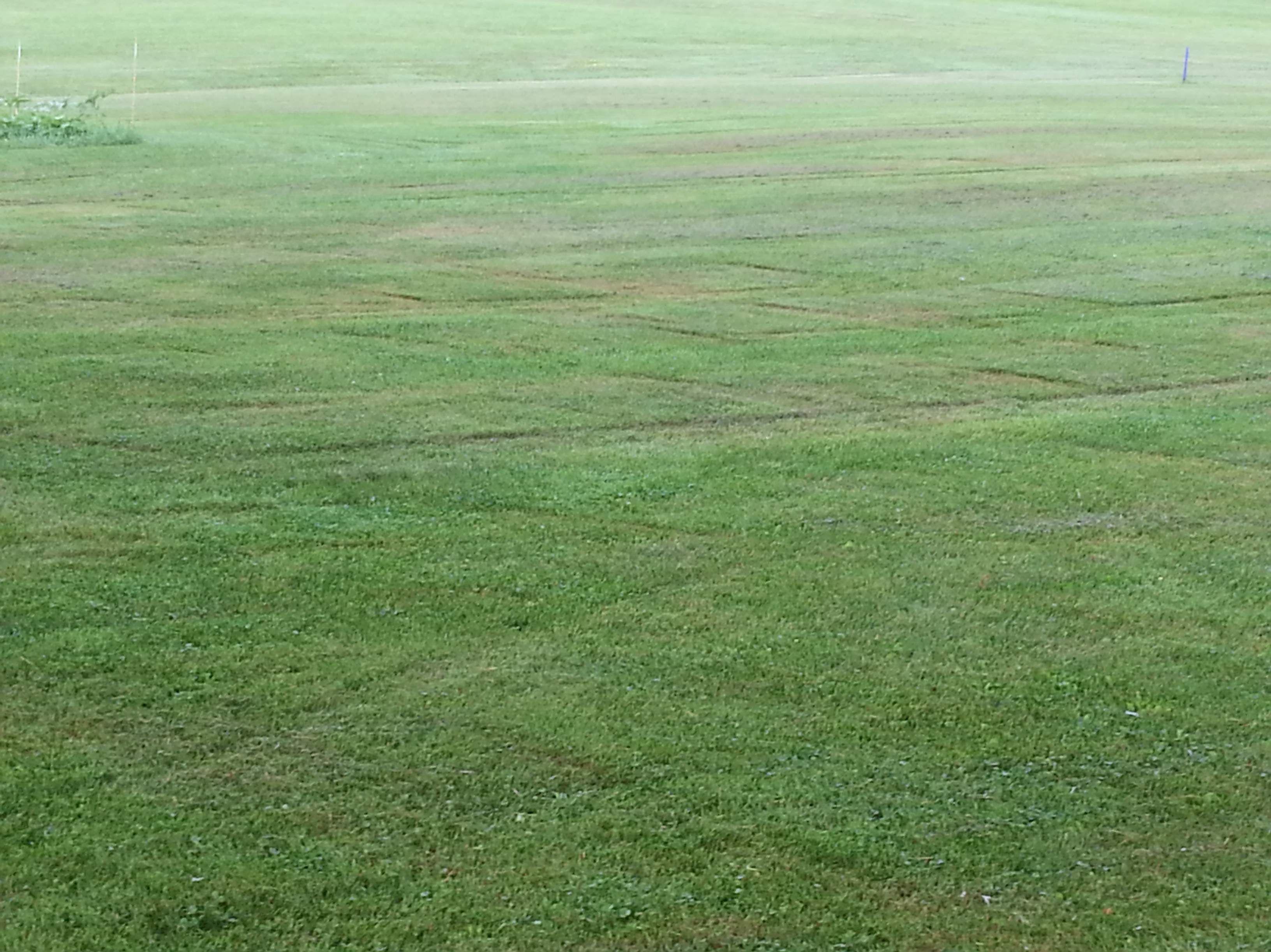

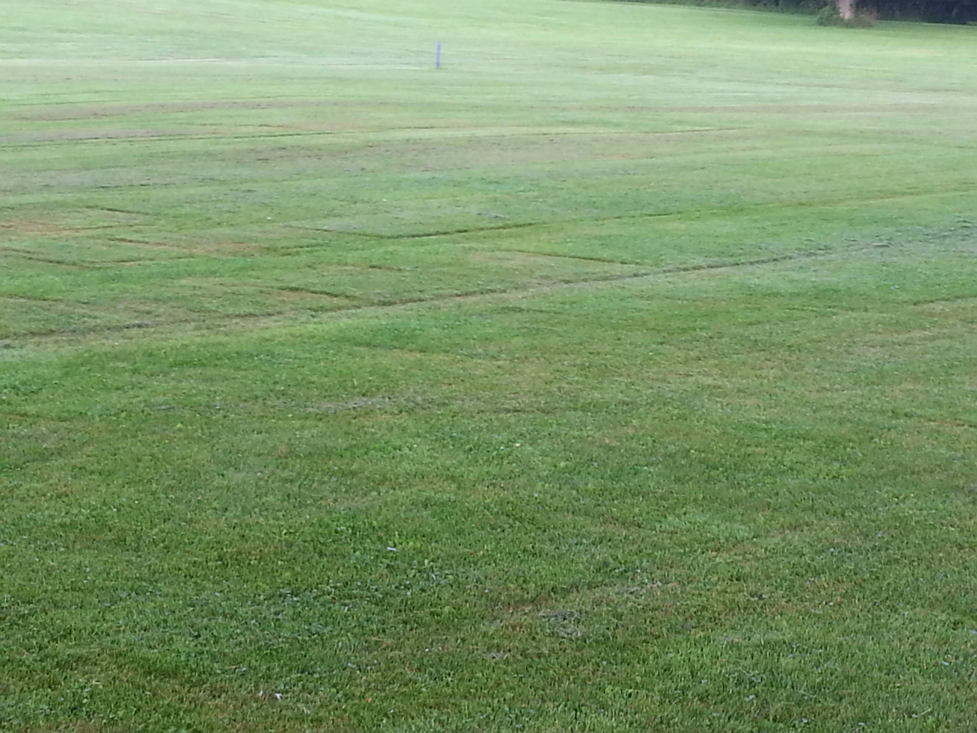

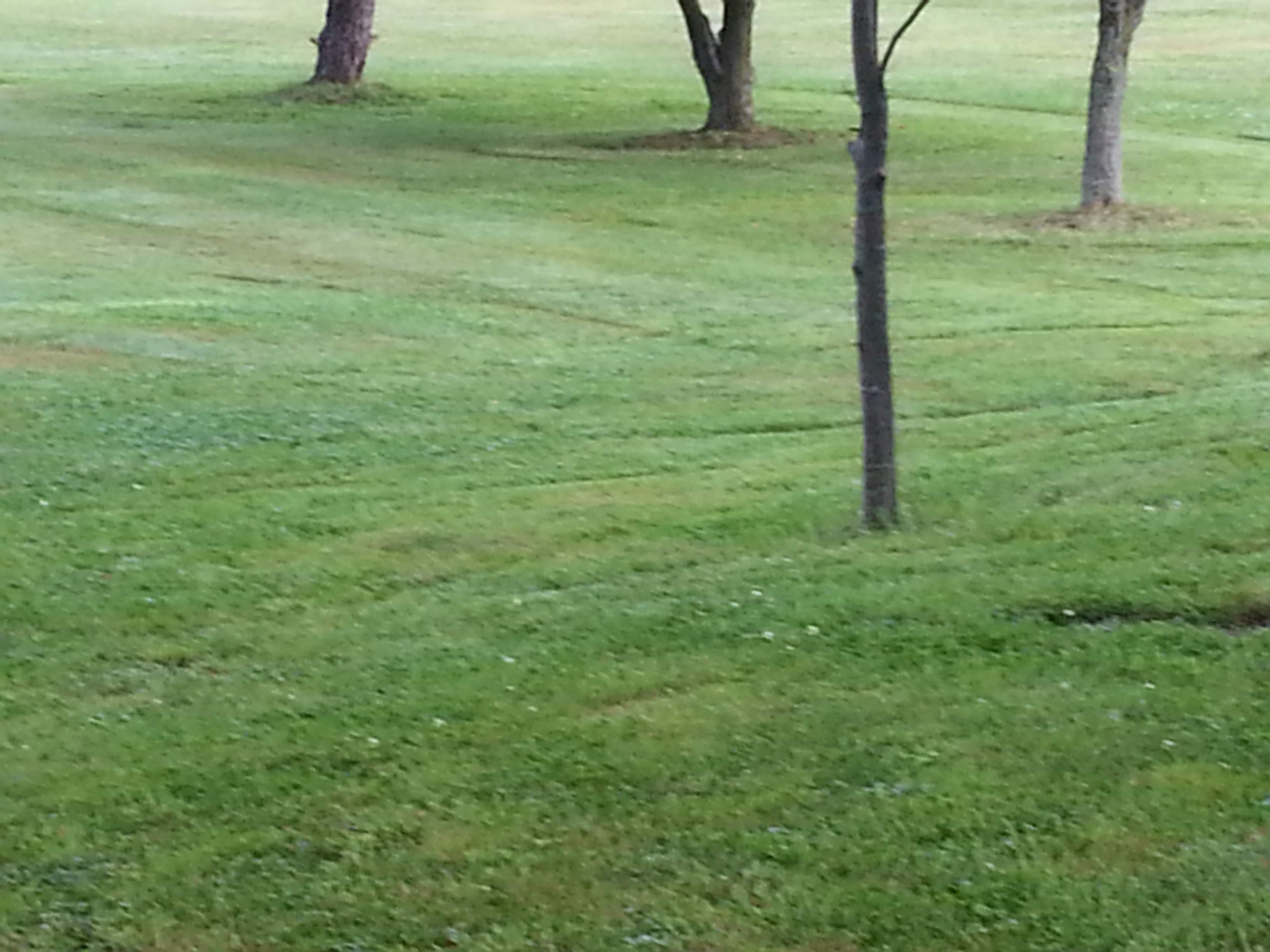

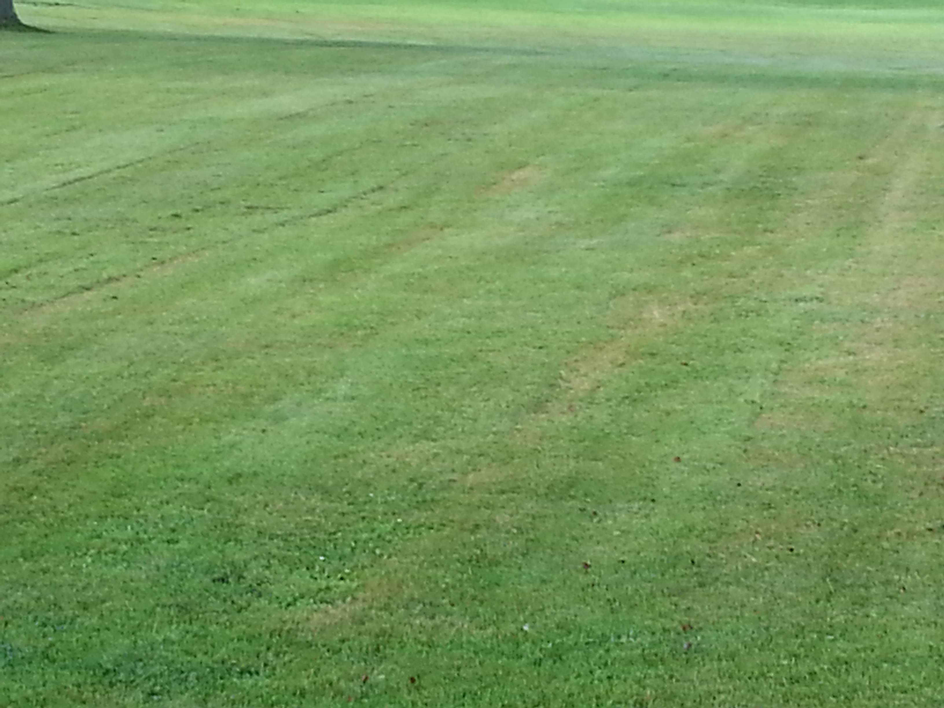

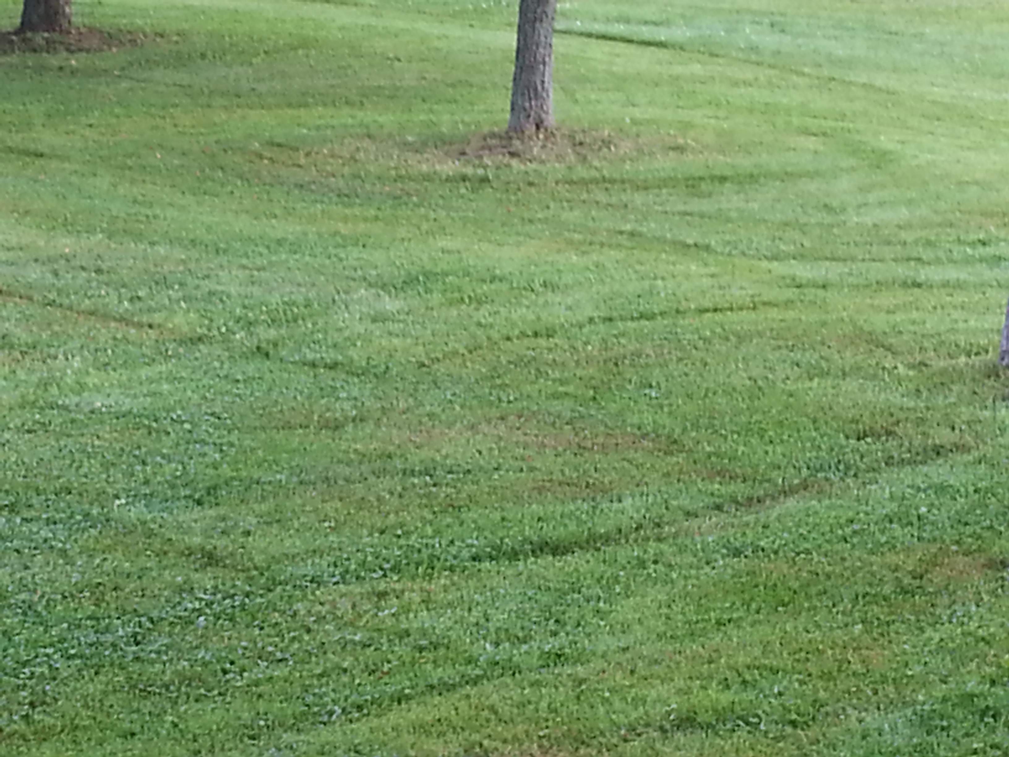

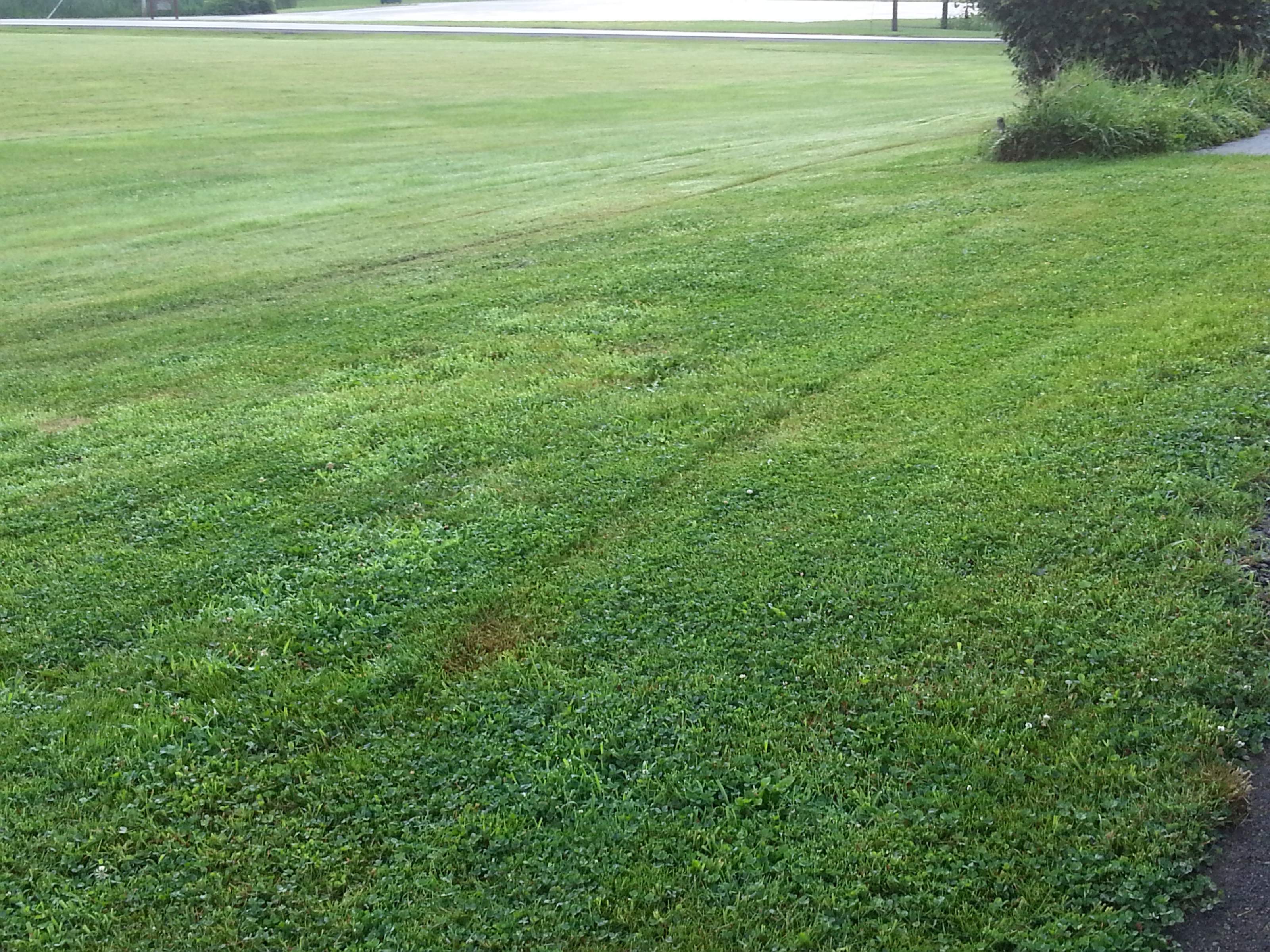

Unfortunately, I would have to agree that the cut quality on the JD X7xx series does suck compared to other mowers I had. The Scag Tiger Cat I had put the JD X748 w/the 60" 7-iron deck to shame. I think it is mainly because the deck on my JD X748 is rigid and does not float like the Scag's Velocity Plus deck, which the Scag used chain links to make the Velocity Plus deck float across bumps and etc. The JD cuts well on the flat areas of the lawn, but when you hit bumps, hills, banks and etc., the mower digs in as shown in the picture I attached. Unfortunately, my X748 has been back to dealer to check this issue and they said it was the tire pressure, but when I got it back, the tractor mowed the same way. Heck my Woods PRD8400 mower on my JD 4520 put the X748's deck's cut quality to shame when cutting the same area, but again the Woods deck floats. I think if JD would make the deck float on the X7xx tractors and put an anti-scalping roller in the middle of the decks, it would improve the cut quality of their deck.

That is a terrible cut in the pictures. I have a x720 with a 54" cut with gator blades and my cut isn't like that. I can't understand what the difference could be.

Man that is absolutely terrible. My Ferris will scalp a little on the low side like that when mowing on a slope, but never on flat ground. I have some pretty good slopes and no matter which direction I go, I either get the ledge cut like in the photo if going parallel with the slope or scalp the top of the hill when the mower breaks over the top and leave it a bit long when leaving the slope at the bottom. If I raise it to 3" height, it isn't as noticeable but its still there. Yours seems to be doing it all the time. Have you put the mower on a flat concrete slab and checked the side to side level? Tires exactly the same pressure?
