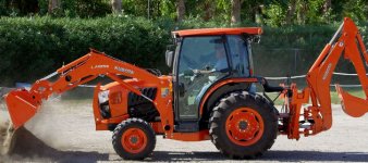

Picking the right backhoe for a cab tractor can be tricky. Most cabs are not designed to accommodate a rear-facing bh seat. Some subframes extend the BH out for clearance, making the tractor back-heavy.
In my opinion a cab adds considerable stiffness to a tractor and a 3-point backhoe isn't automatically a structural threat to the machine. As always reasonable operation is key. Mounting and removing the BH is quicker/easier with a subframe type.
BH digging force is the same with internal or external hydraulics. External hydraulics offer shorter cycle time (faster digging speed). For the occasional user speed isn't a big deal. Take care, Dick B
