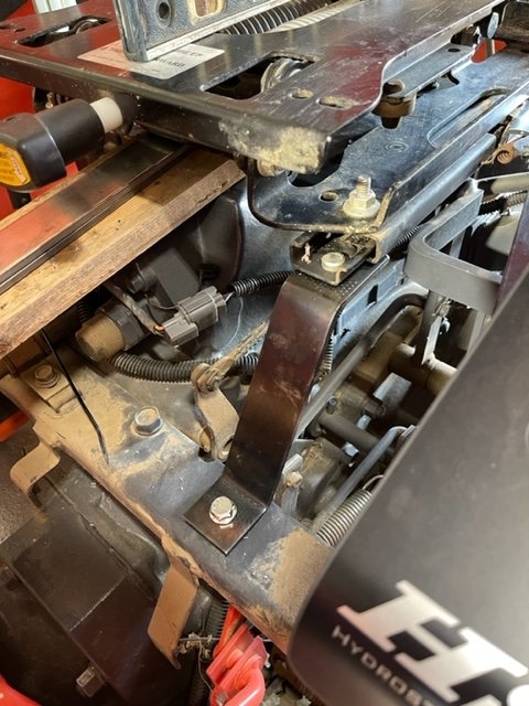

How did you add "better suspension"?

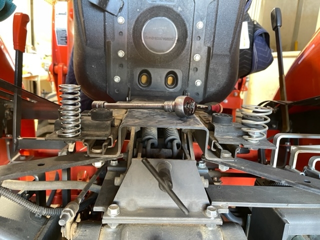

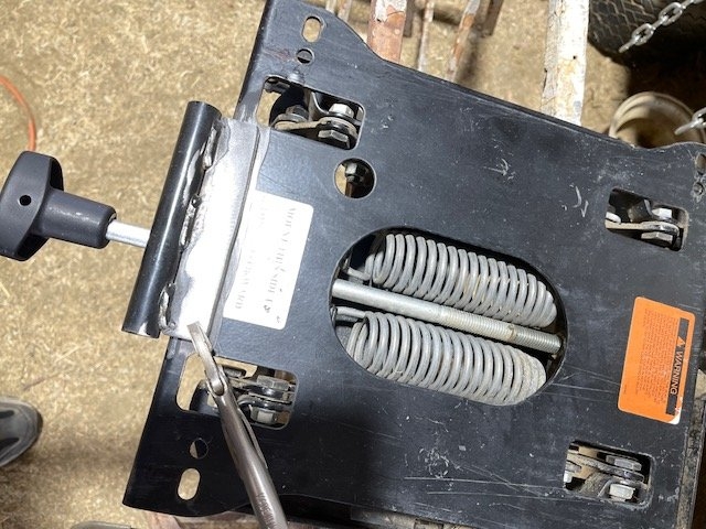

At first I tried some spring changes, different lengths and rates. Not much improvement... so I bought a better seat suspension base and adapted the OEM seat, the unit I bought online had a swivel feature which I liked from my previous tractors. The 45º giving a better position for gannon work. Unfortunately this feature does not work in this tractor because the station is so narrow my knees were in the draft control so I had to use just the suspension half of the seat mount I purchased. It's better, still not all I want but that was that.
